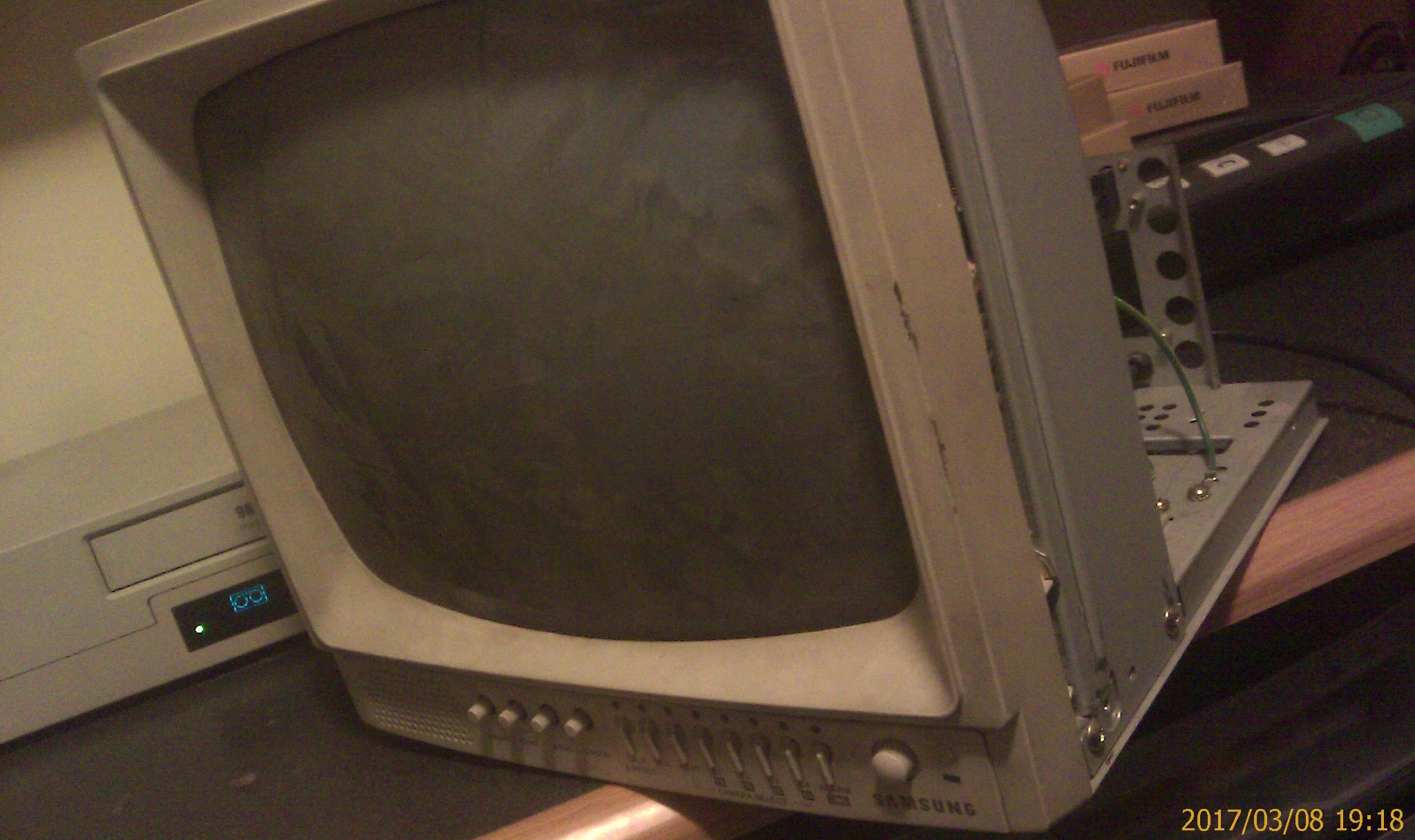

    hi
    i have an old school black and white samsung crt security monitor that will not power on..its a 4 camera monitor with auto switching built in
    it made in 2003
    a couple years ago the display was going real dark on it but would power on fine...and now it wont power on at all..no power light ..nothing...dead...
    not sure if these are both from same issue...but i would like to repair if possible as its a specific onior that i cant buy anymore and be compatible with my cameas
    i dont want tyo install a new system right now...its too much work
    i want to fix if possible...

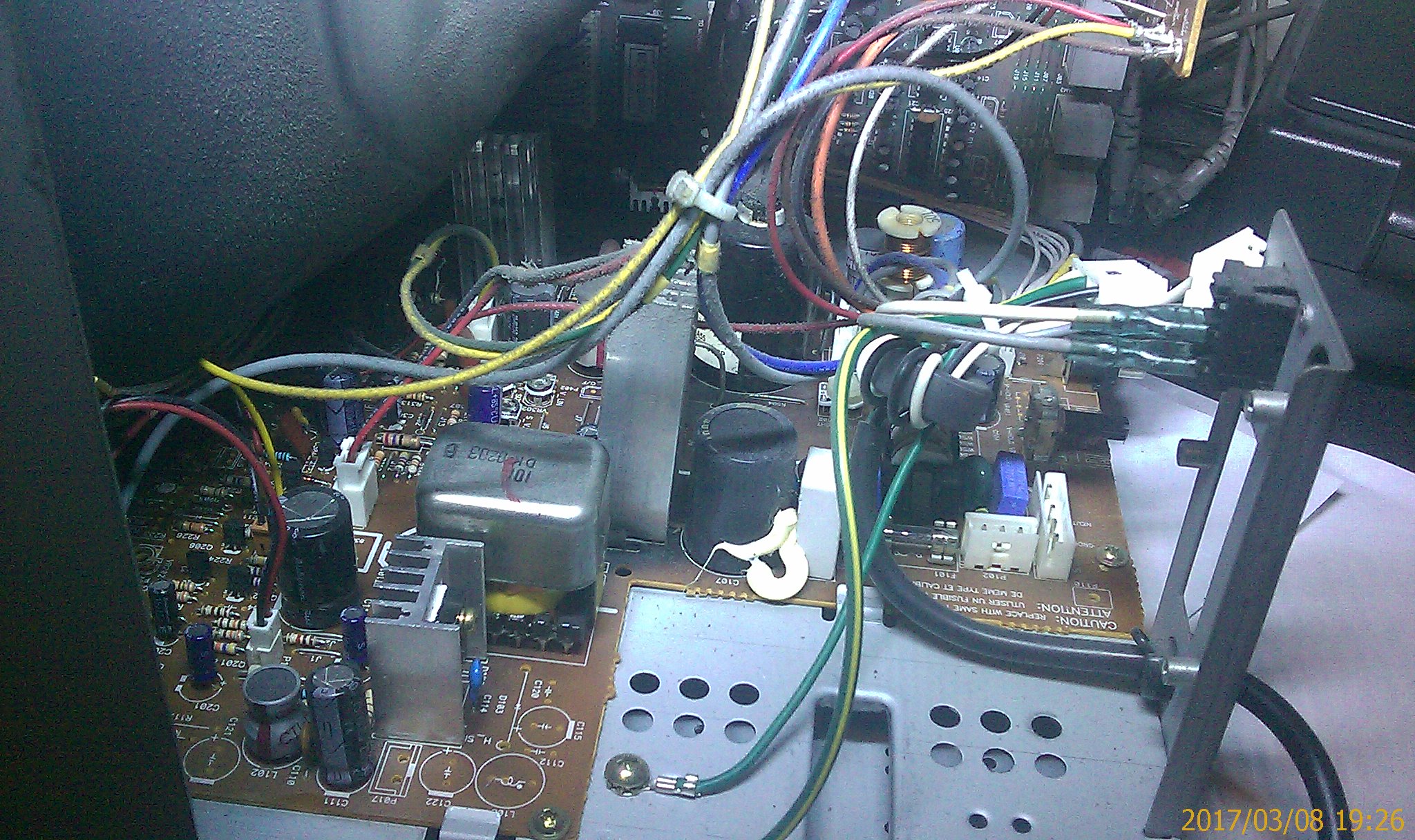

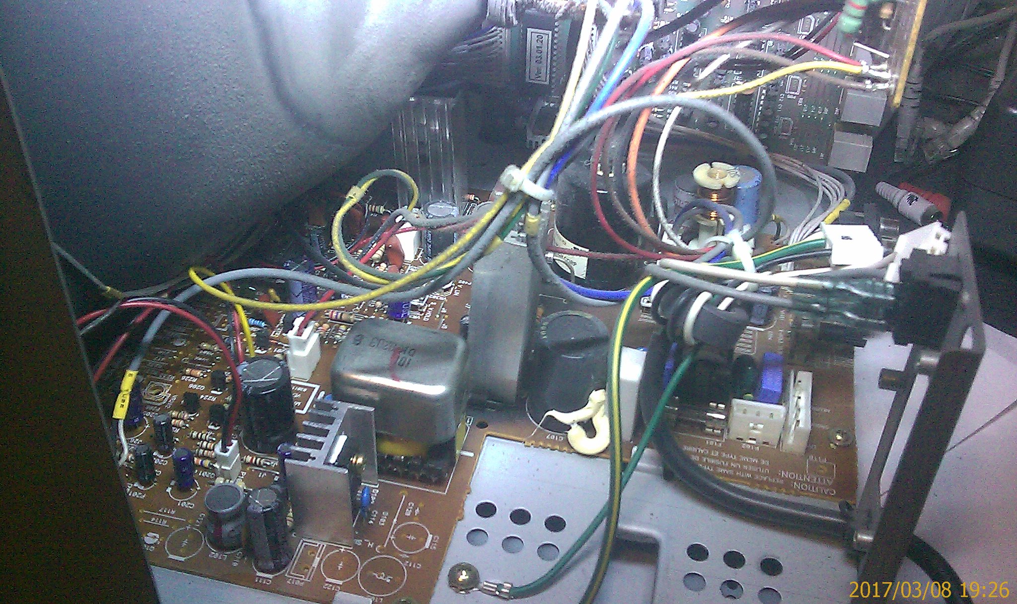

          Re: samsung CRT security monitor wont power on model ssc-12
          thank you

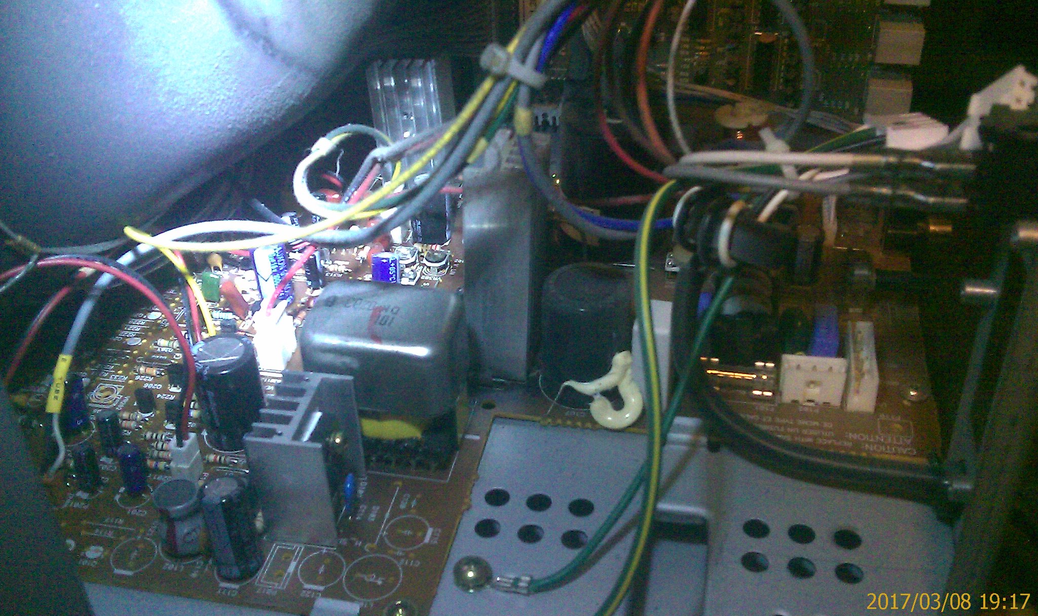

          here are some photos..

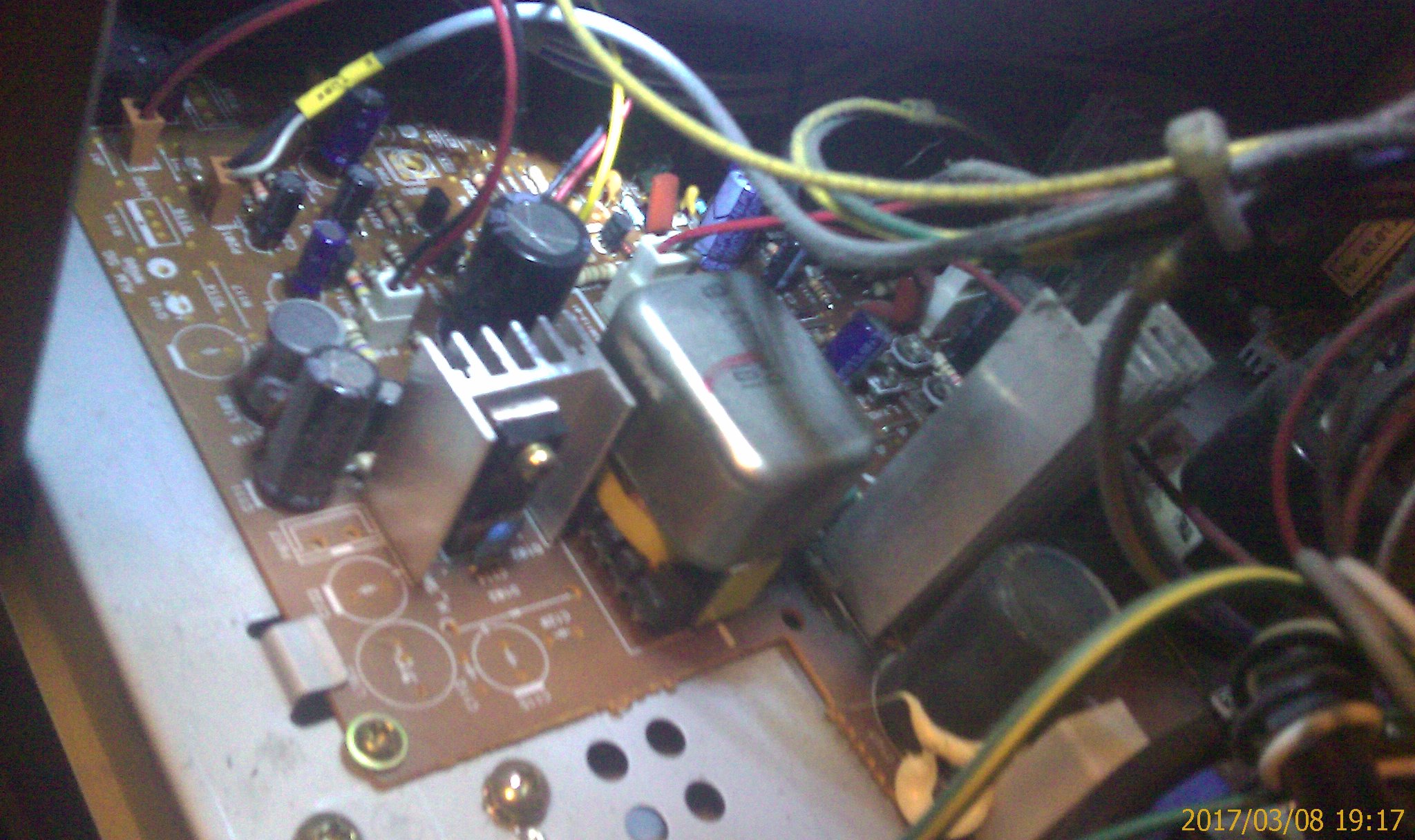

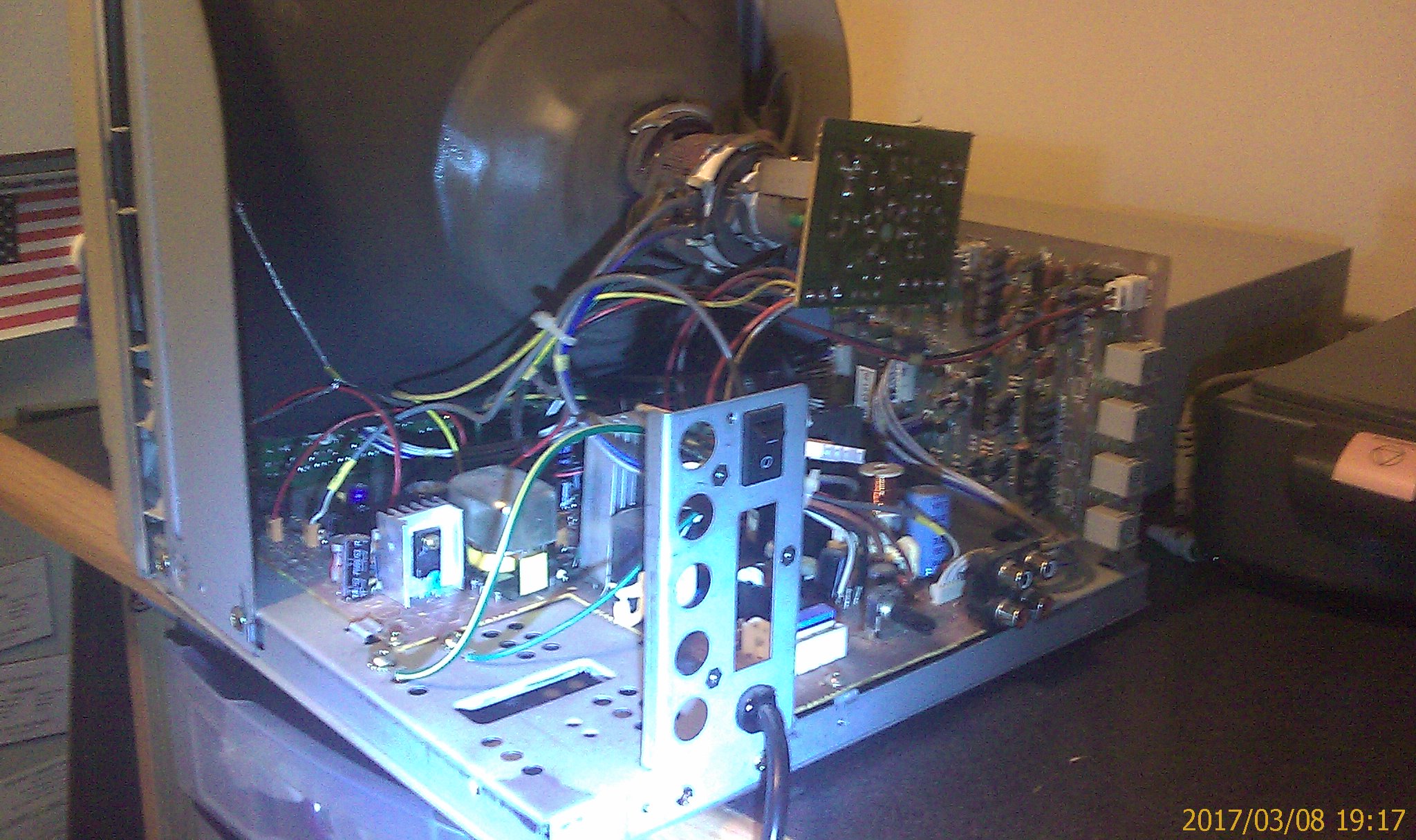

            more pics.....

              i am novice

                im looking at power schematic and i see the main fuse i see the c101 and i see the sw101 switch they are referring to...i can see them all on my unit...

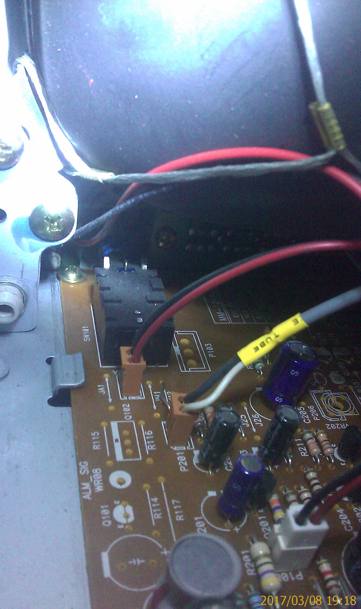

                        even though the monitor does not power on i am going to check and see if i at least got 12v going to the board for the cameras...
                        • shelby5041
                          • Feb 2009
                          • 1505
                          • united states of america usa
                          ok i dont even have 12v going to the camera board....which should have power all the time regardless if monitor display is on or off....
                              actually i get 2.5v to the camera board not 0v
                              and i power monitor on and off from the back power switch and voltage does go to 0 when off and about 2.5v when on ...it should be 12v
                                sorry for the responses but im just sitting here looking at the boards and thinking out load....i see 2 caps that are slightly bulged but they are away from the power switch they are in middle of board C501 and C502...right next to the large black cylinder looking part that has a single wire coming out of it going into the crt....i doubt these caps could have anything to do with the monitor not powering on?
                                  It's probably a good idea to replace them as they may cause problems later in life.
                                  The black cylinder part [i think] is the flyback transformer.
                                    thank you and yes i understand but right now all i want to do is to get the monitor to power on and get power to the camera board...anyhting else im not worried about at this point
