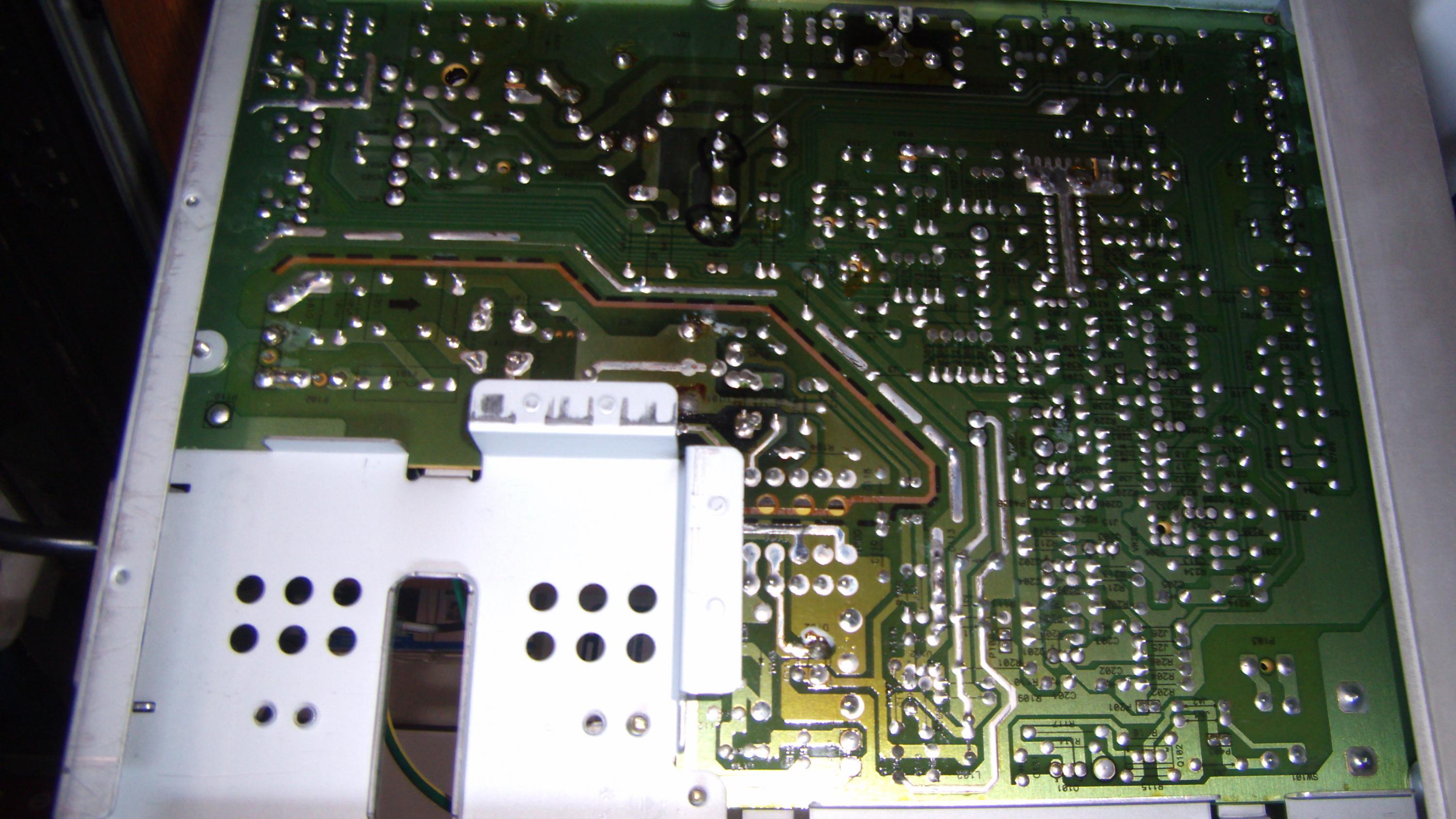

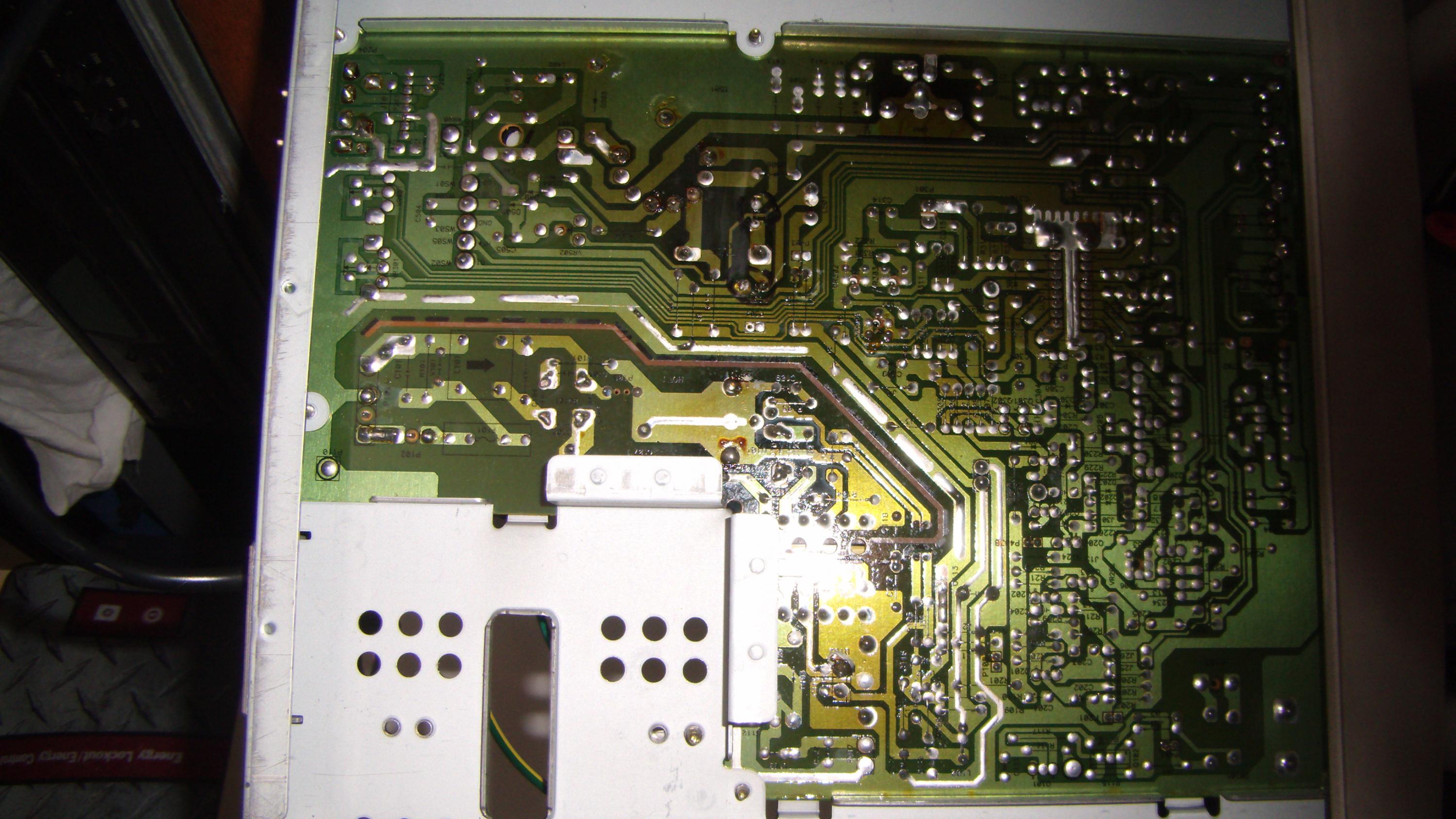

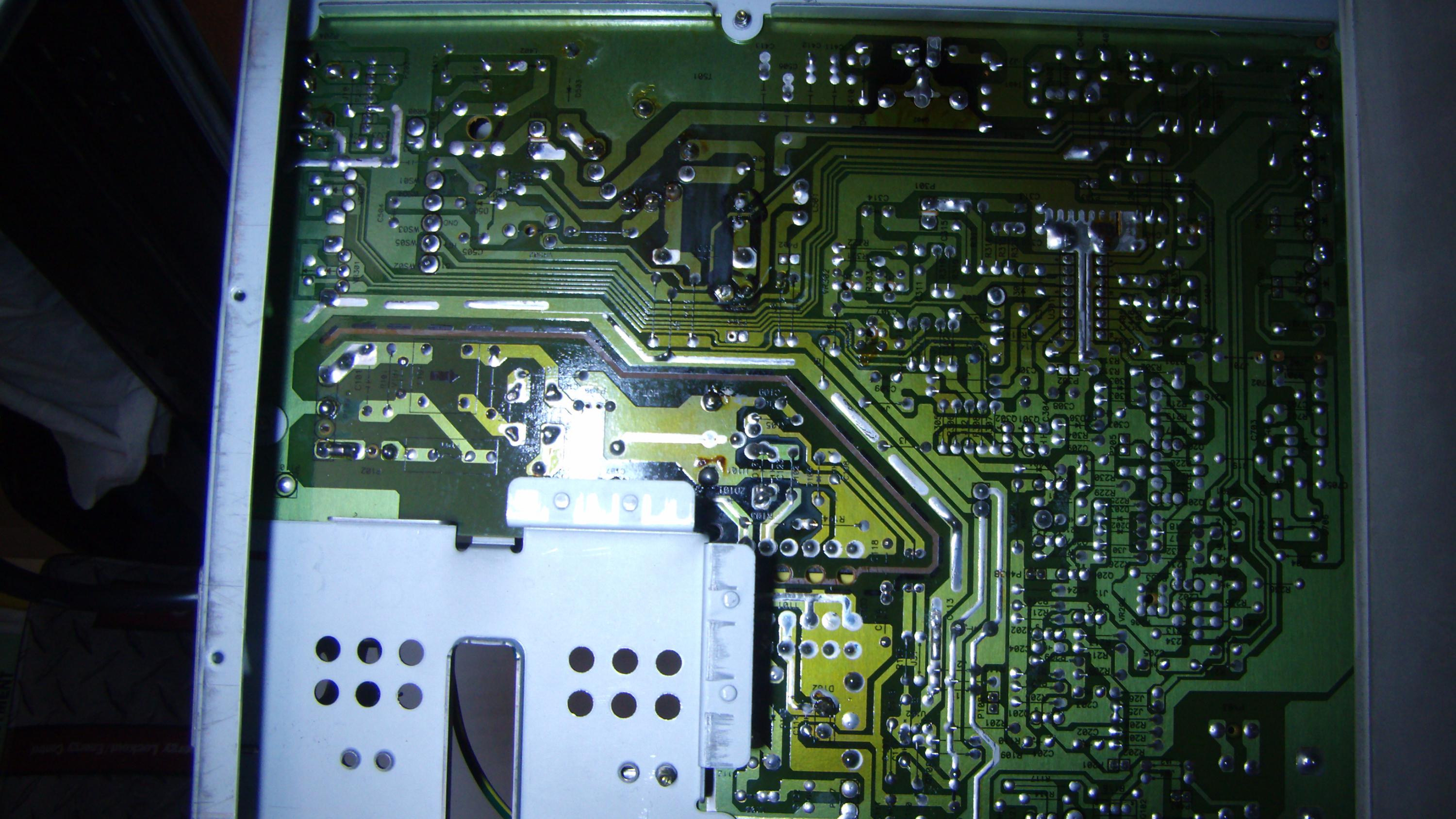

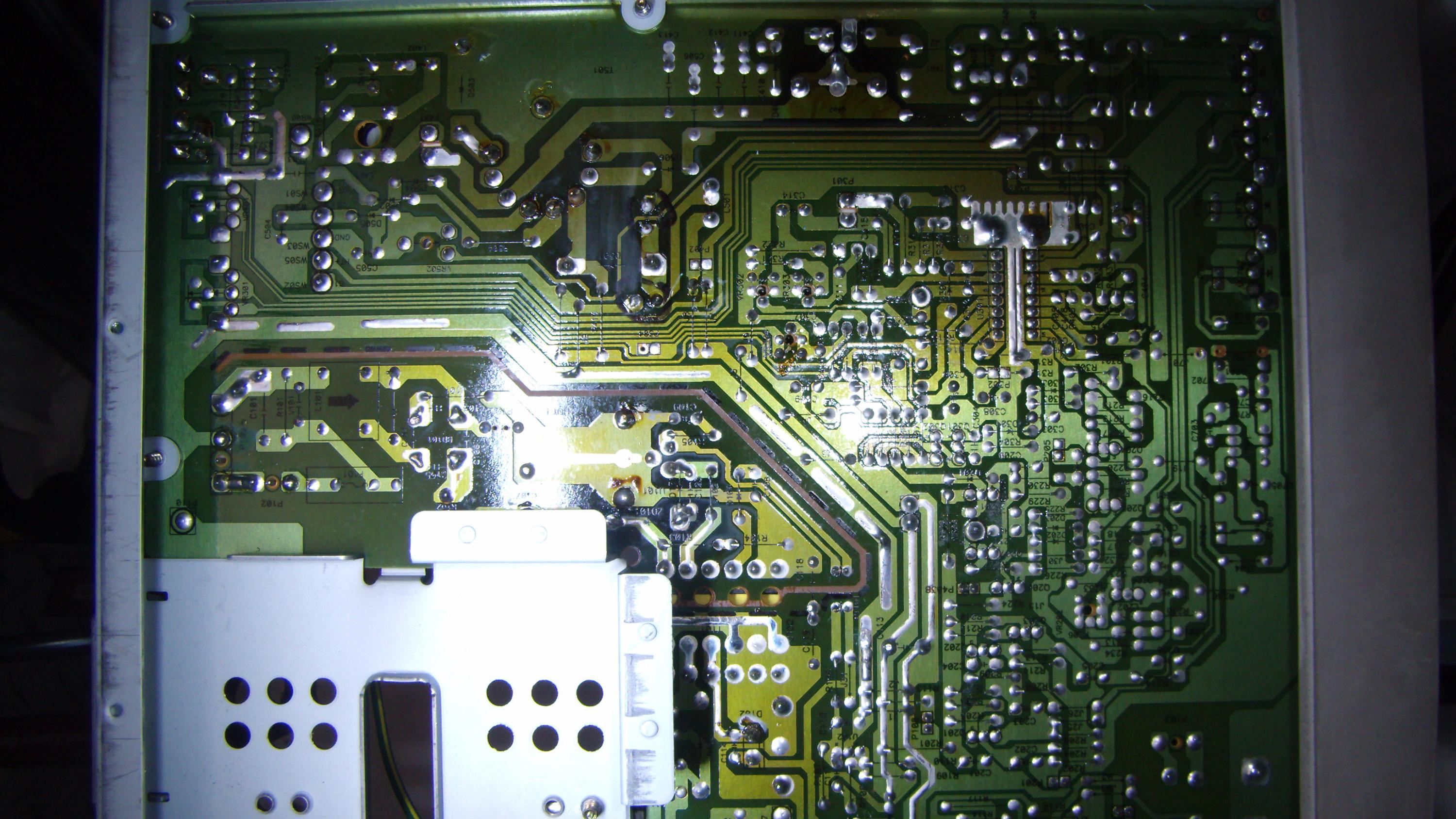

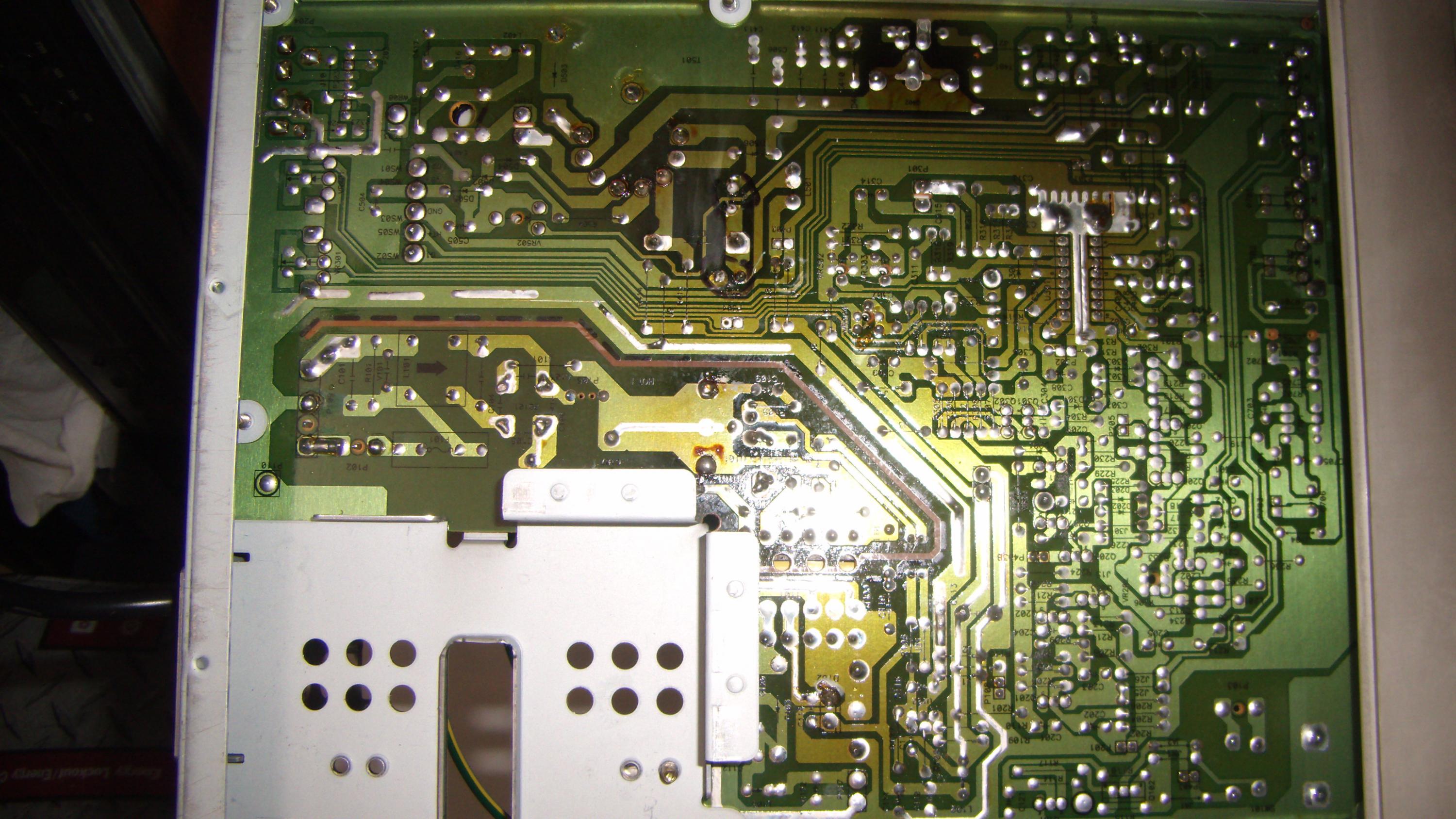

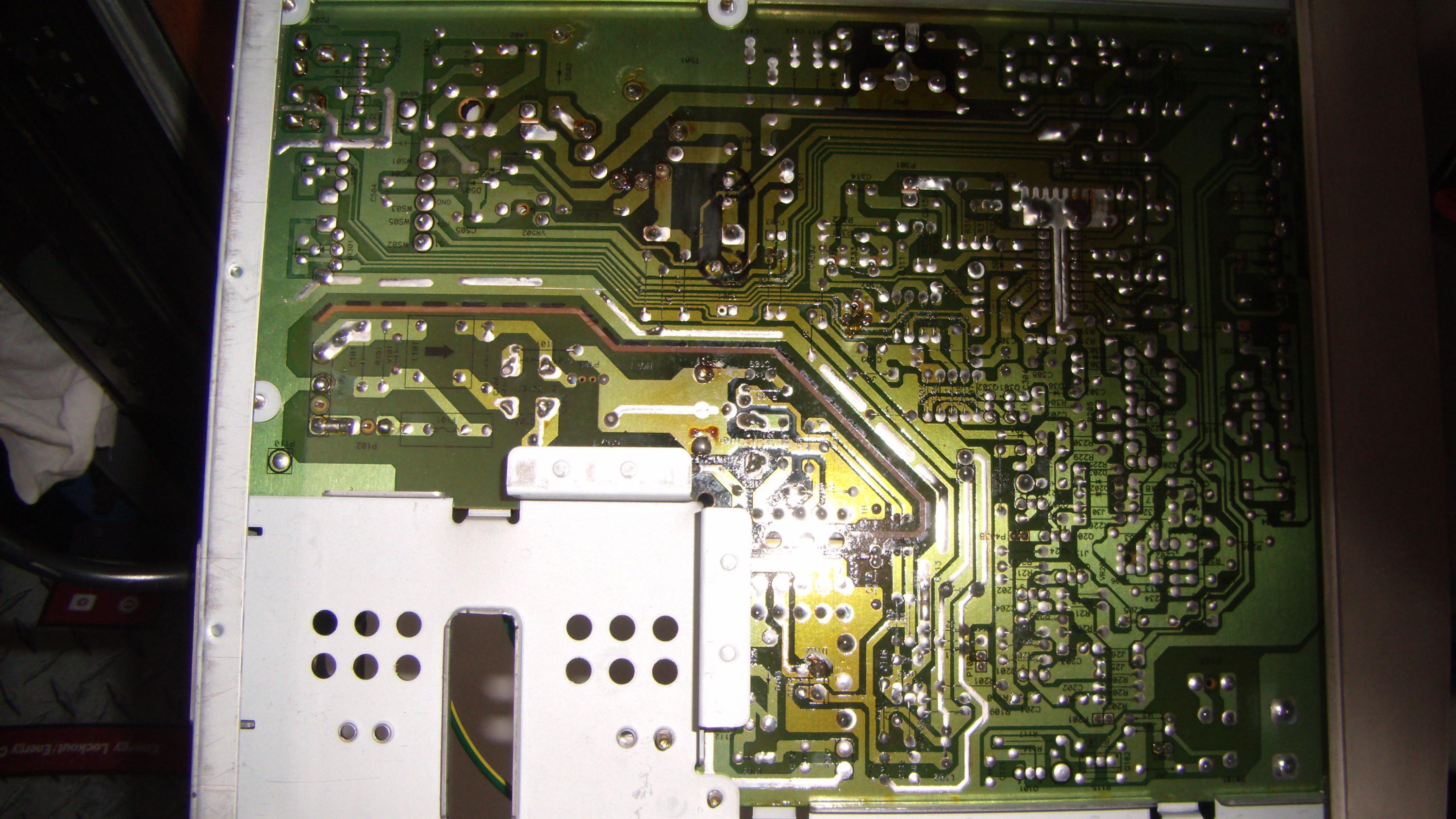

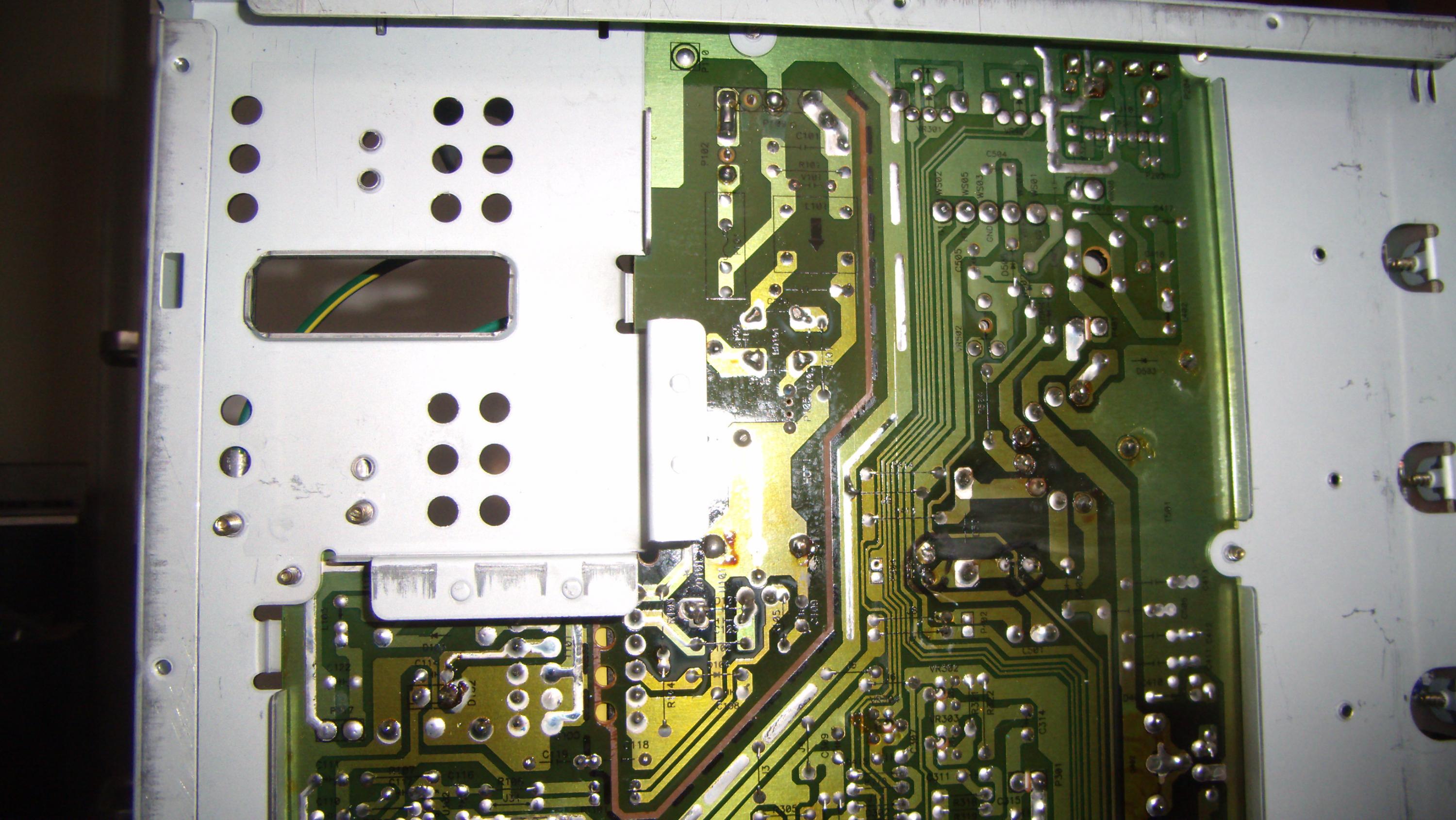

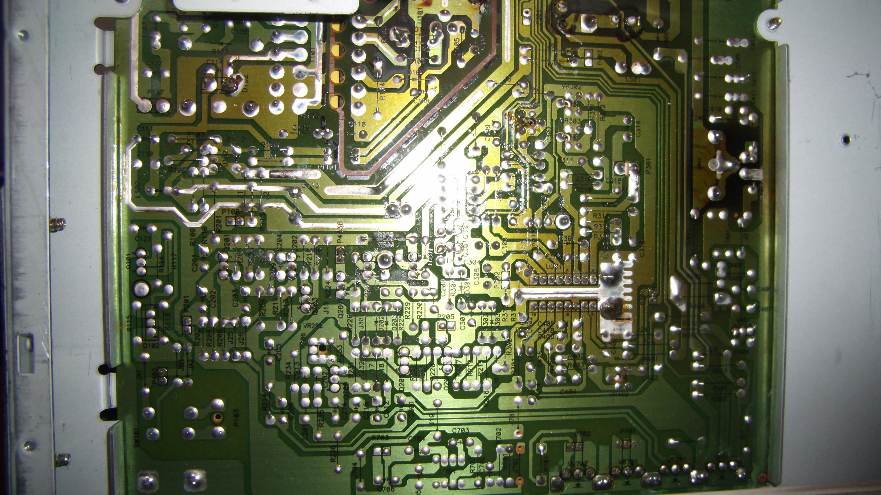

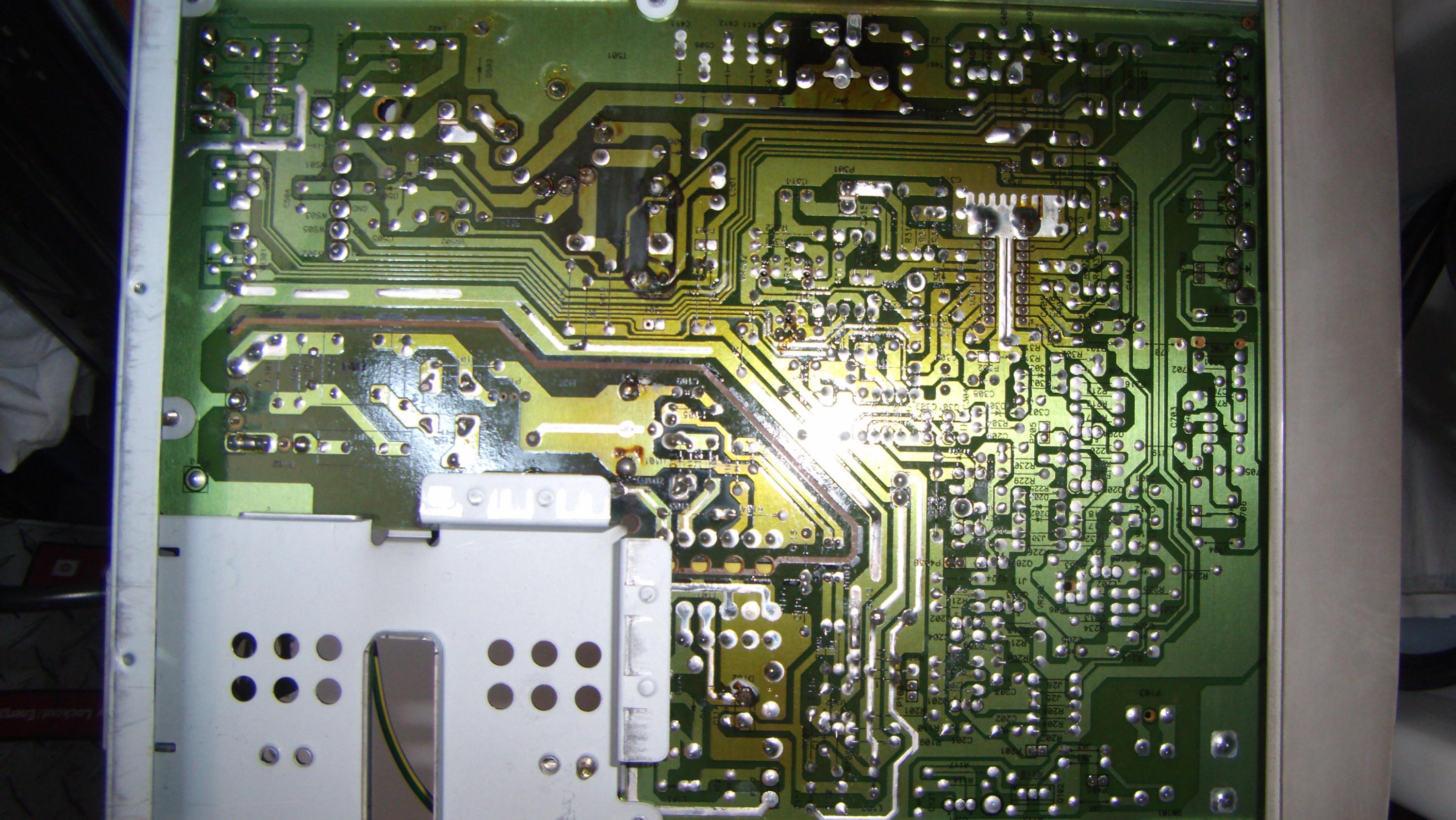

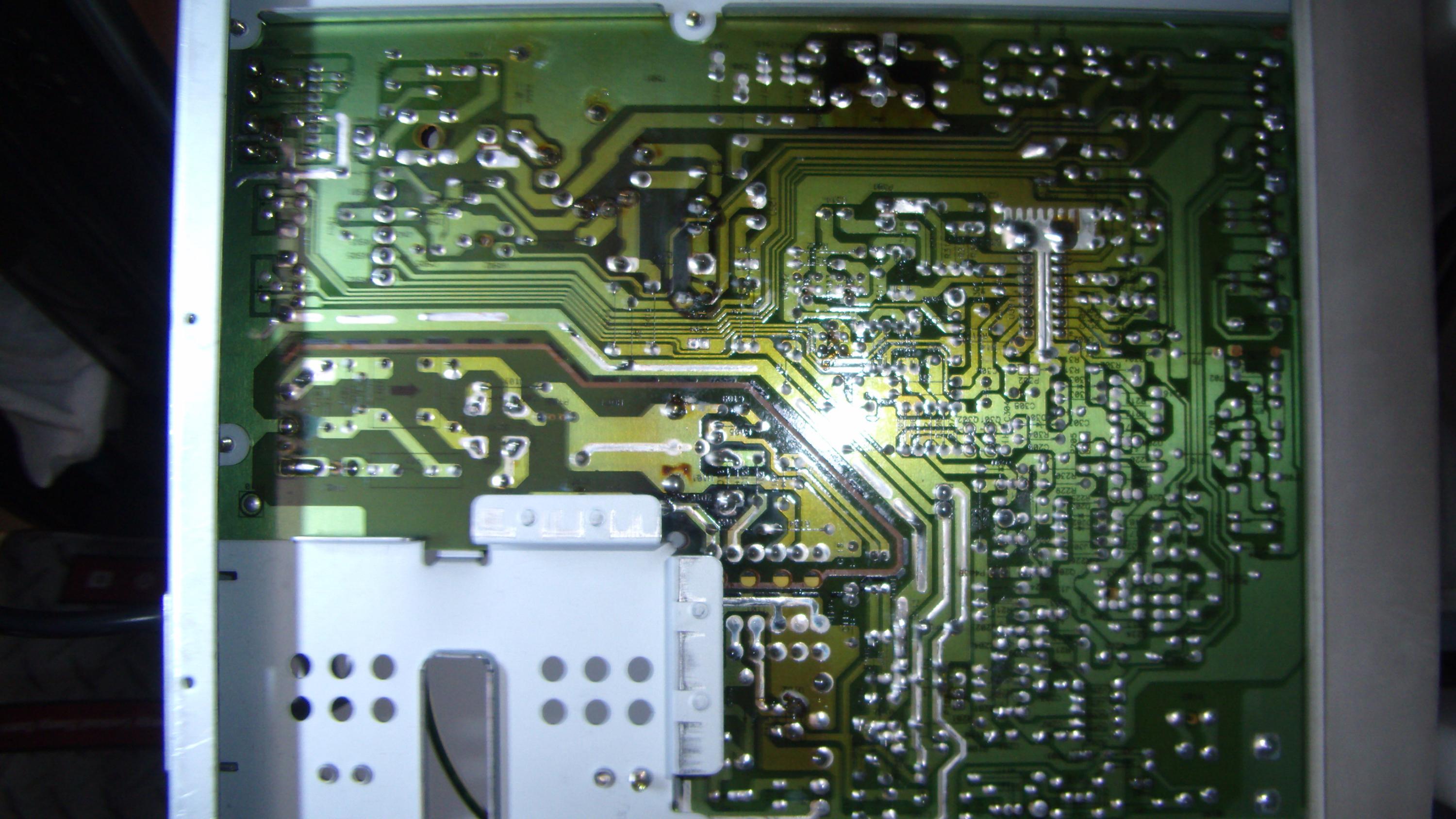

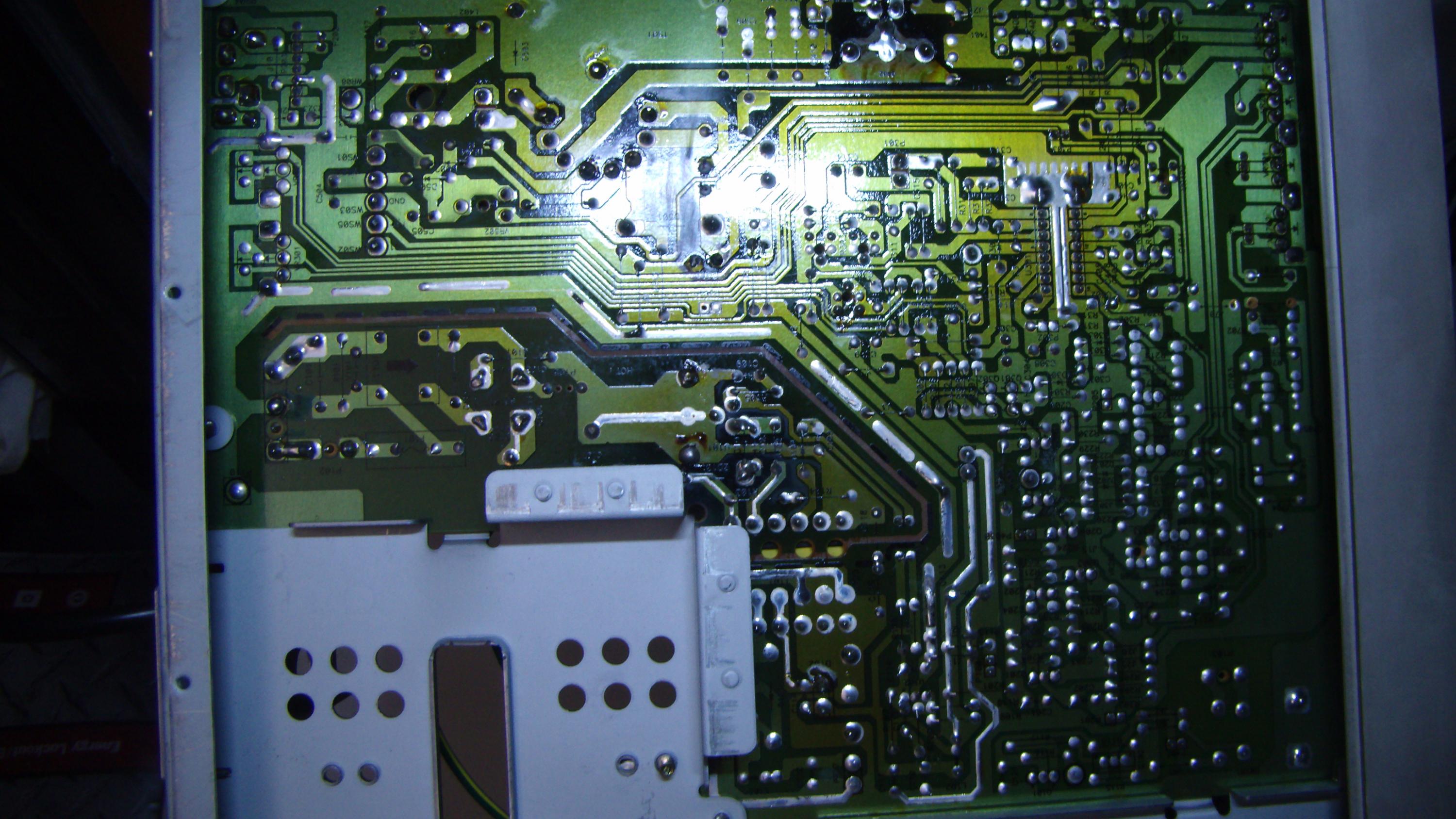

              #66
              Re: samsung CRT security monitor wont power on model ssc-12
              here are some photos of bottom of monitor board
              • shelby5041
                • Feb 2009
                • 1504
                • united states of america usa
                #67
                more photos...
                the board is all thru holes..so im thinking if directed i should be able to repair this monitor..i hope
