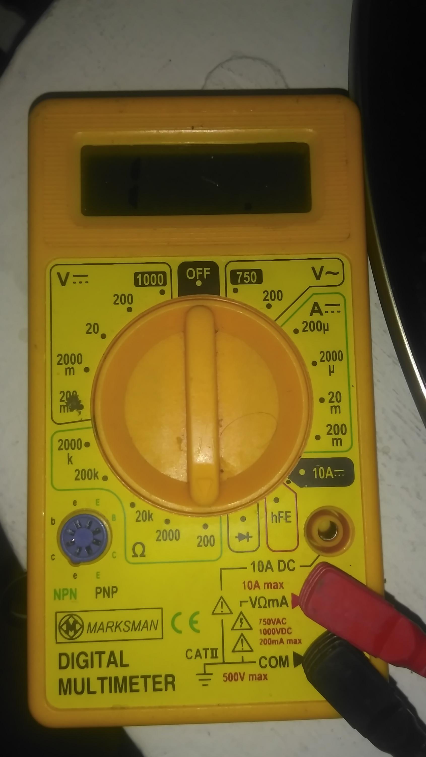

                              ok on SC2 no movement on 200 ohm,
                              on Q661 get 0.14 on one leg and 15.6 on other
                              not that i have any idea what this means lol

                                neither do I. Sounds like a cheap meter not digital auto ranging.
                                What meter is it? Does it have a diode check or continuity check beeper or buzzer? Just probe two legs on that Q661 see if it beeps constantly. 0.14 ohms is a short But since you don't understand the meter fully makes it hard for me to say with confidence.

                                  You are absolutely right it is a cheap meter,

                                    It doesn't have a buzzer but it does check for continuity, the display changes across all 3 legs. Which it does if I touch the 2 probes together so I assume means that there is continuity same applies to SC2

                                      Sorry mate but yuck. Good for maybe a little tinkering on a car.
                                      stick it on diode mode , touch the probes together and note the reading then probe the legs on that Q661, have someone take photos of the reading but I'm not going to waste too much time figuring that meter out . I find they are good at confusing everyone.

                                        Re: Panasonic TX-P42GT20B - Stuck Stby
                                        Touching the probes together reads 001
                                        Probes on middle and lower leg reads 014
                                        Probes on middle and upper leg reads 001
                                        Probes on upper and lower legs reads 014
