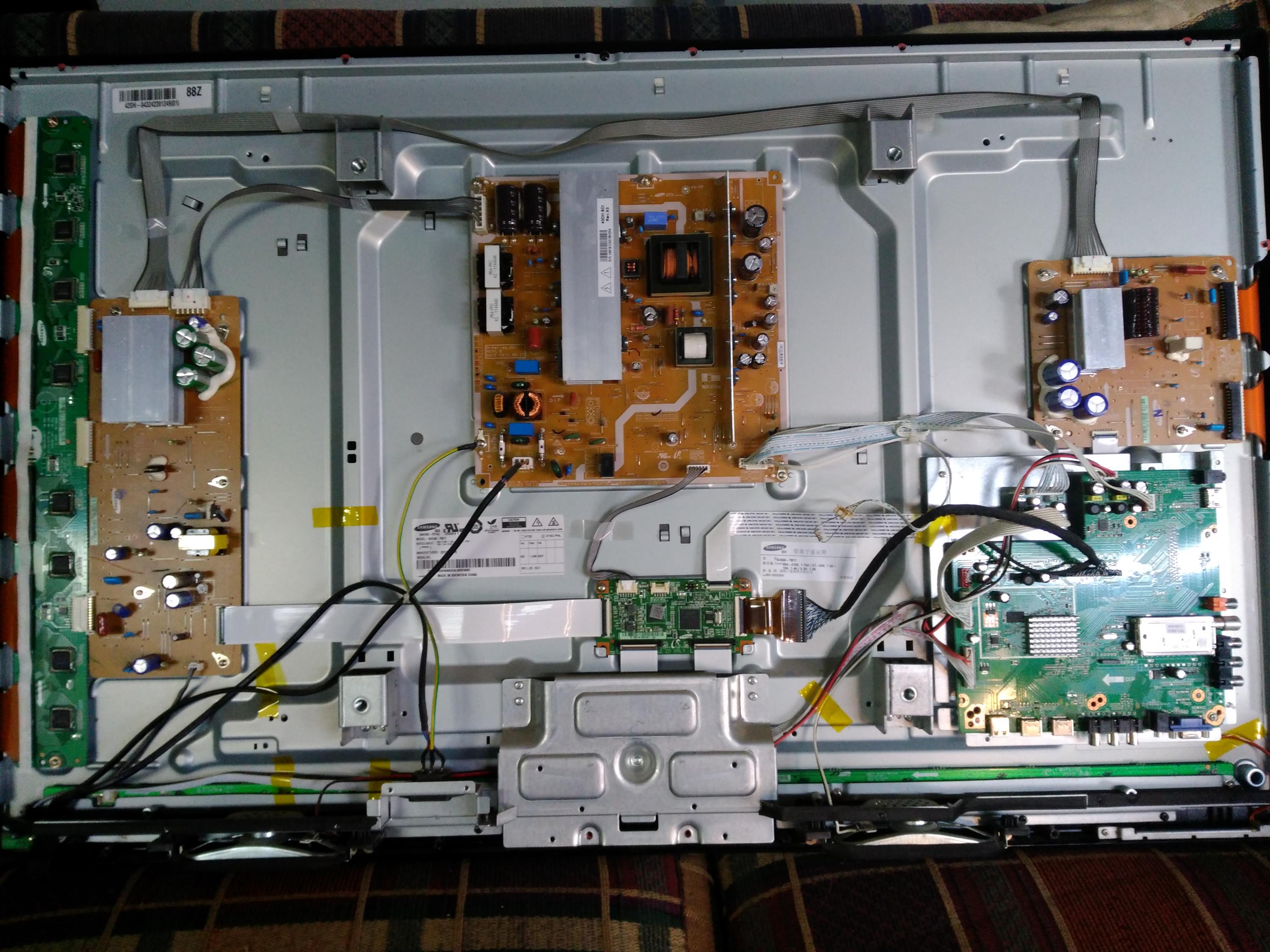

    VIVO PTV43HD no PS-ON signal
    These were a badge engineered TV sold by Dick Smith Electronics in Australia. Inside all Samsung parts. Maybe somebody can recognise the actual model?

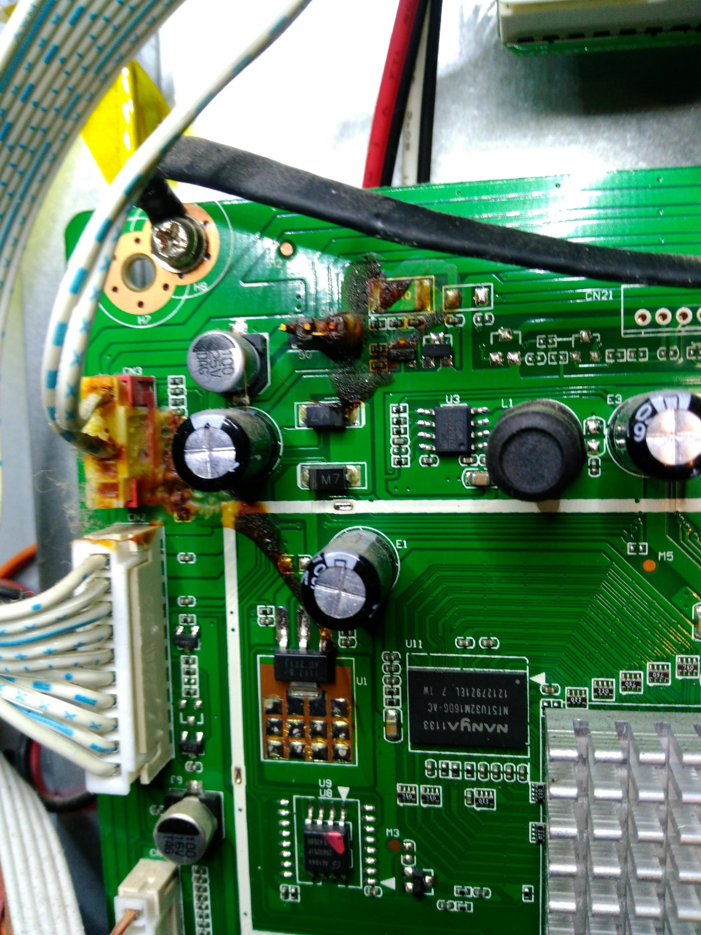

    There is no PS-ON signal being generated by the mainboard. When the PS-ON signal is jumpered to earth the power supply fires up and all voltages are spot on (Vs, Va, Vsc etc).
    The mainboard had some sort of brown goo on it (as shown in images). Has the consistency of contact adhesive. No signs of any spill on the external back cover. I couldn't shift it with methylated spirits; I had to resort to carefully removing with a very small blade screwdriver. Anyway, that didn't change the situation.
    So any hints to progress from here. Do people agree it appears to be a failed mainboard? I can get a secondhand mainboard for about A$100.
    The TV appears to be 2012 model, and it's in very good external condition. I'm reluctant to canabalise a good looking set, but then again it needs to be economical to repair.

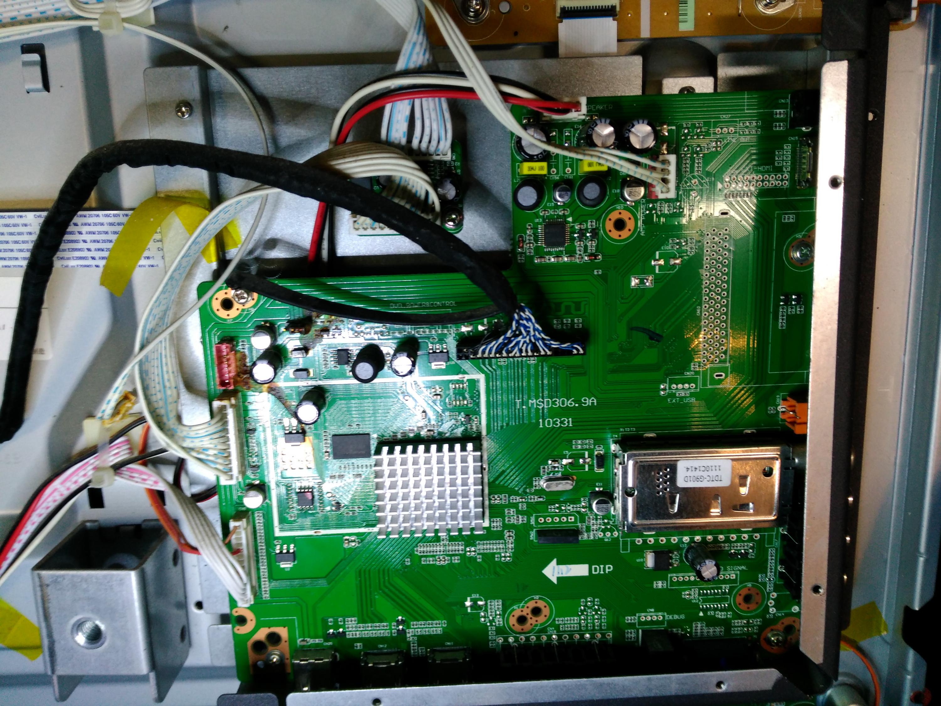

    The board number T.MSD306.9A 10331 appears when googled to be a generic number used in Bush & Technika.

      Thanks Dick. Yes, I too Googled the board number and saw the overseas models it is used in. Main boards tend to be country specific even when they have the same model number. In Australia we don't use the scart connector and instead they bring out rca sockets. The firmware seems customised for our channel allocations etc. I can only see one main board for sale here in Australia, from a seller I've dealt with before. I might have to see if I can negotiate the price down to make it economical.

            Yes, I agree. It certainly looks like the PN43D450A2D in sheep's clothing. The mainboard in my Vivo appears to be configurable for a range of TVs, including LCD models.

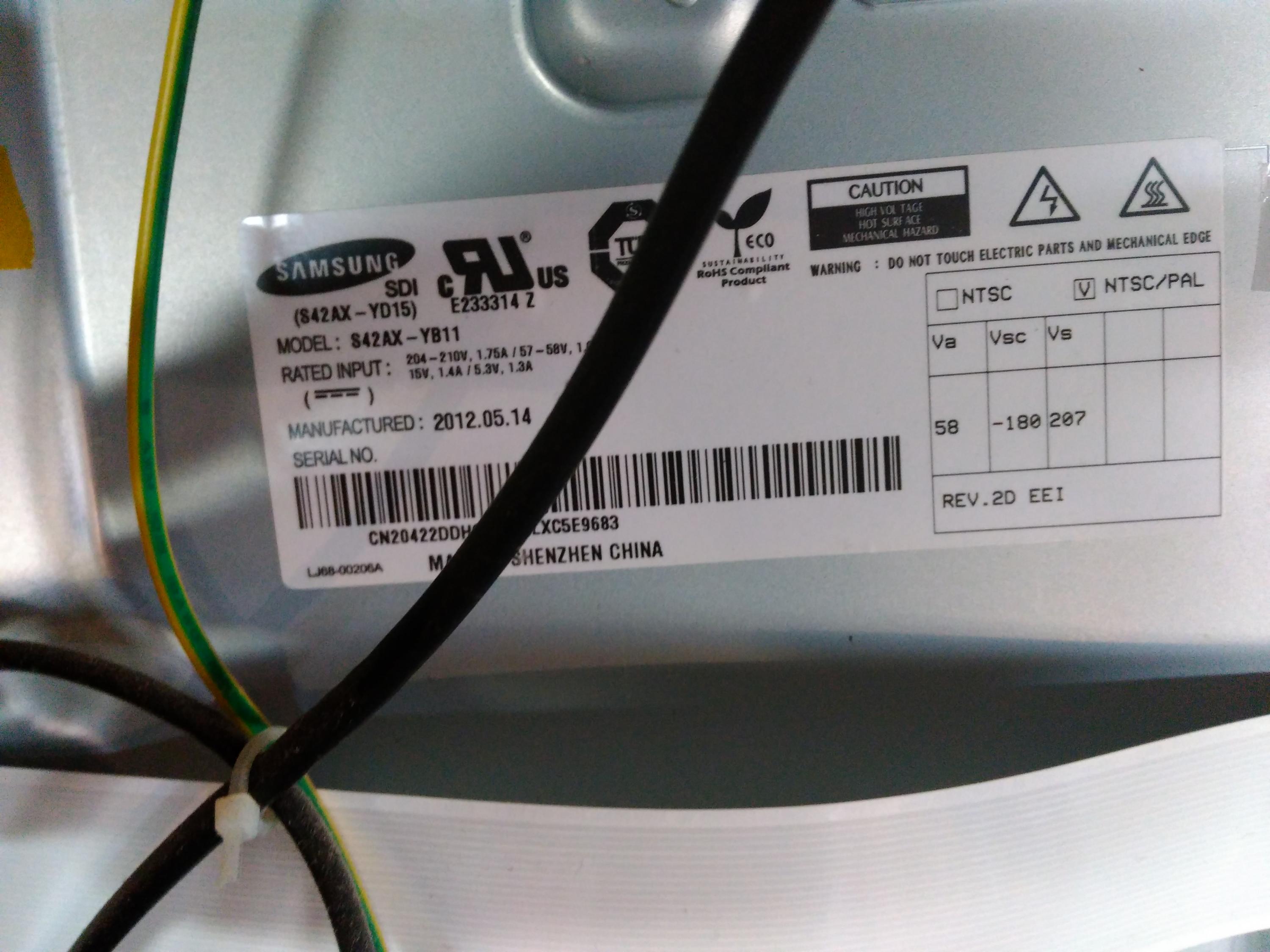

                    Thanks to TW2005 I've been able to confirm via the test pattern test that the panel is operational along with all associated boards. So it does appear to be mainboard, and I'm very suspicious of that brown goo I first saw on the board.
                    Does anyone know if Samsung maainboards have a history of failing and whether there is a repair pathway? By the way, I'm still to check the on-switch for voltages back to the mainboard. Will report any findings of interest.

                      I think it's worthwhile cleaning all thatbrown muck away. Looks like glue that has gone off, may have turned conductive. I just finished getting a Projecta IC5000 battery charger going again, the glue in that was yellow like contact glue which had turned black and corrosive.
                      Etched the board away and ate the legs off an optocoupler and corroded a Viper22 plus diode.
                      May need acetone or carefully chip away at it, looks a bit nasty

                        It's good to see the manufacturers are still ensuring failure by the addition of these glues which are now known to become conductive over time.
                        This has been discussed many times on the forum so surely if we know, then they know.

                            I scrapped most of it away but couldn't find a solvent to shift it. I have acetone, guess there's nothing to be lost? I'd considered using acetone but was concerned about potential damage. Those very small SMT components near the red socket are covered in the stuff and it's difficult to see if they are damaged. Anyway, I think from what Dick says, especially about it being a point of often discussion, then I have my smoking gun. Mxmee (seller of reclaimed boards here in Oz) is offering to lower the price of a mainboard to A$80 plus postage. I need to find a buyer before I can justify the repair, unless I can get the mainboard going again.

                              From what I've seen Shopjimmy uses acetone for clearing the flux away after soldering so I cannot see that it would be a problem using it on your board. Try it on a small area and see if it can remove the glue.

                                  The mainboard model appears to be near identical for both the lcd and plasma sets so I would suspect that they also have their EEPROM problems.
                                  https://spares2repair.co.uk/bush-bpd...sd306.9a-10331

                                    maybe worth freezing it then with proper freeze spray if set starts up ok maybe remove ic and freeze again and to read ic data and reprograme one.

                                      Doesn't seem any doubt on mainboard at fault but that is a strange number. The Vivos I had 2 plasma all had Samsung board numbers LJ....... or whatever. My view is a going set not worth more than $99 and what warranty can one offer!
