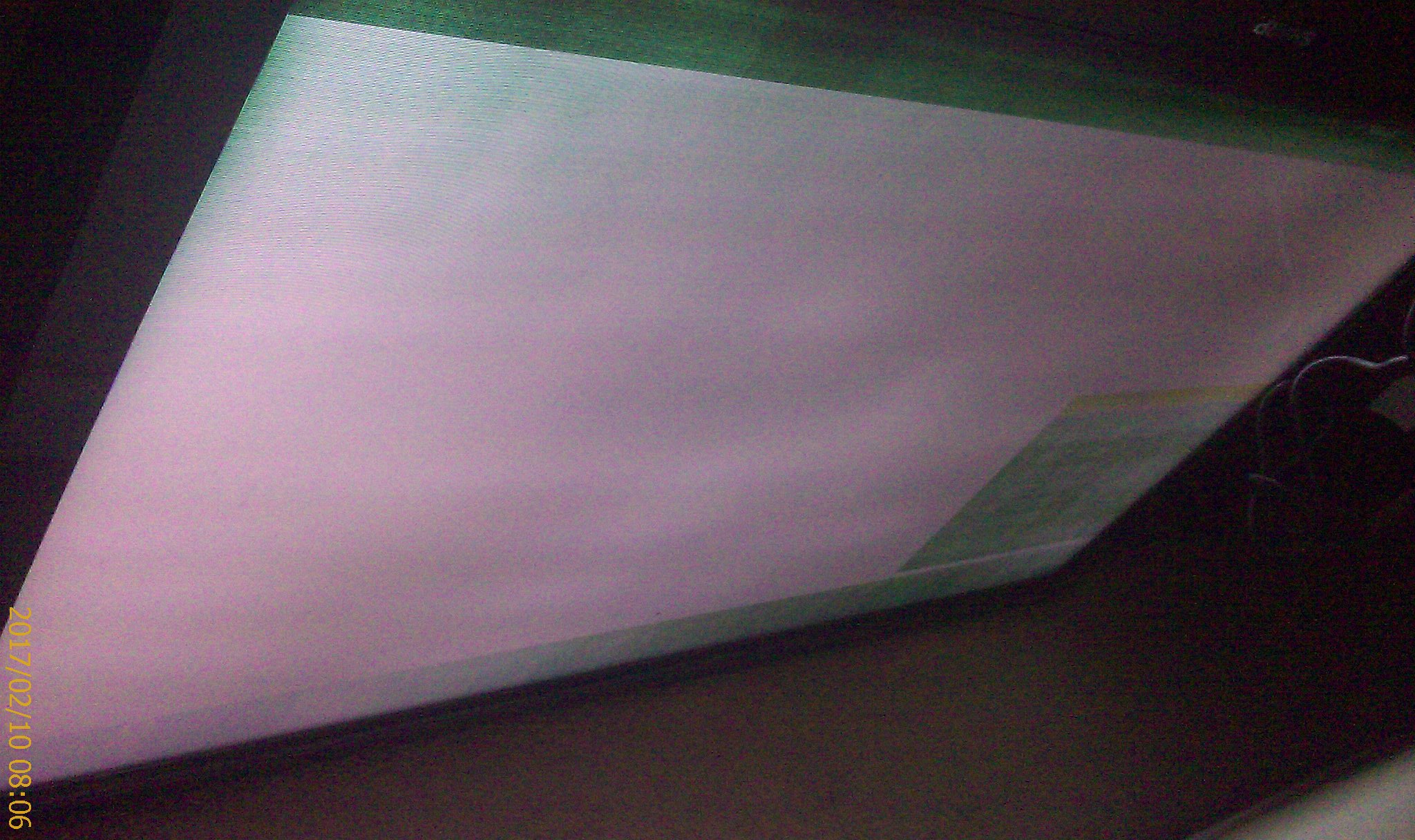

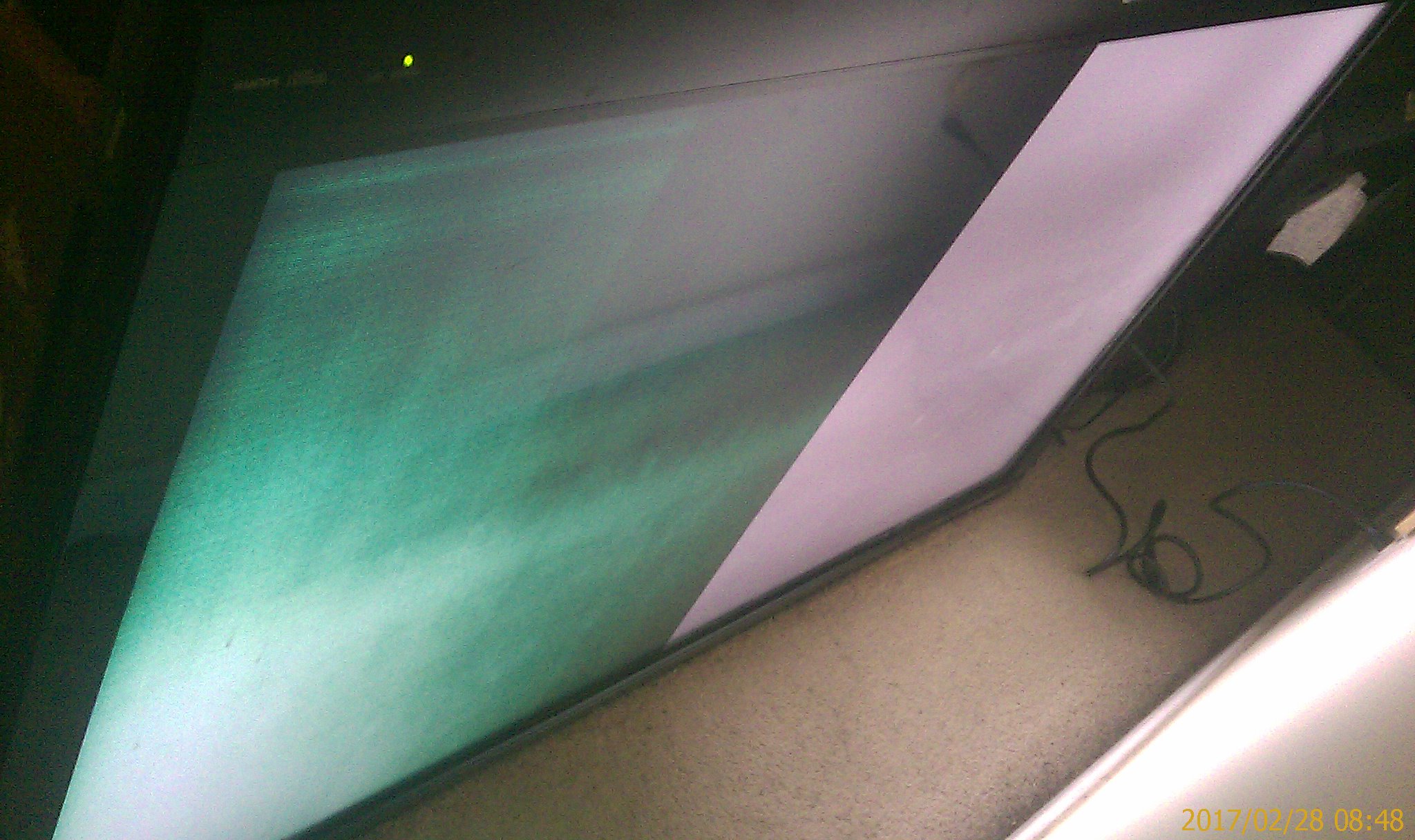

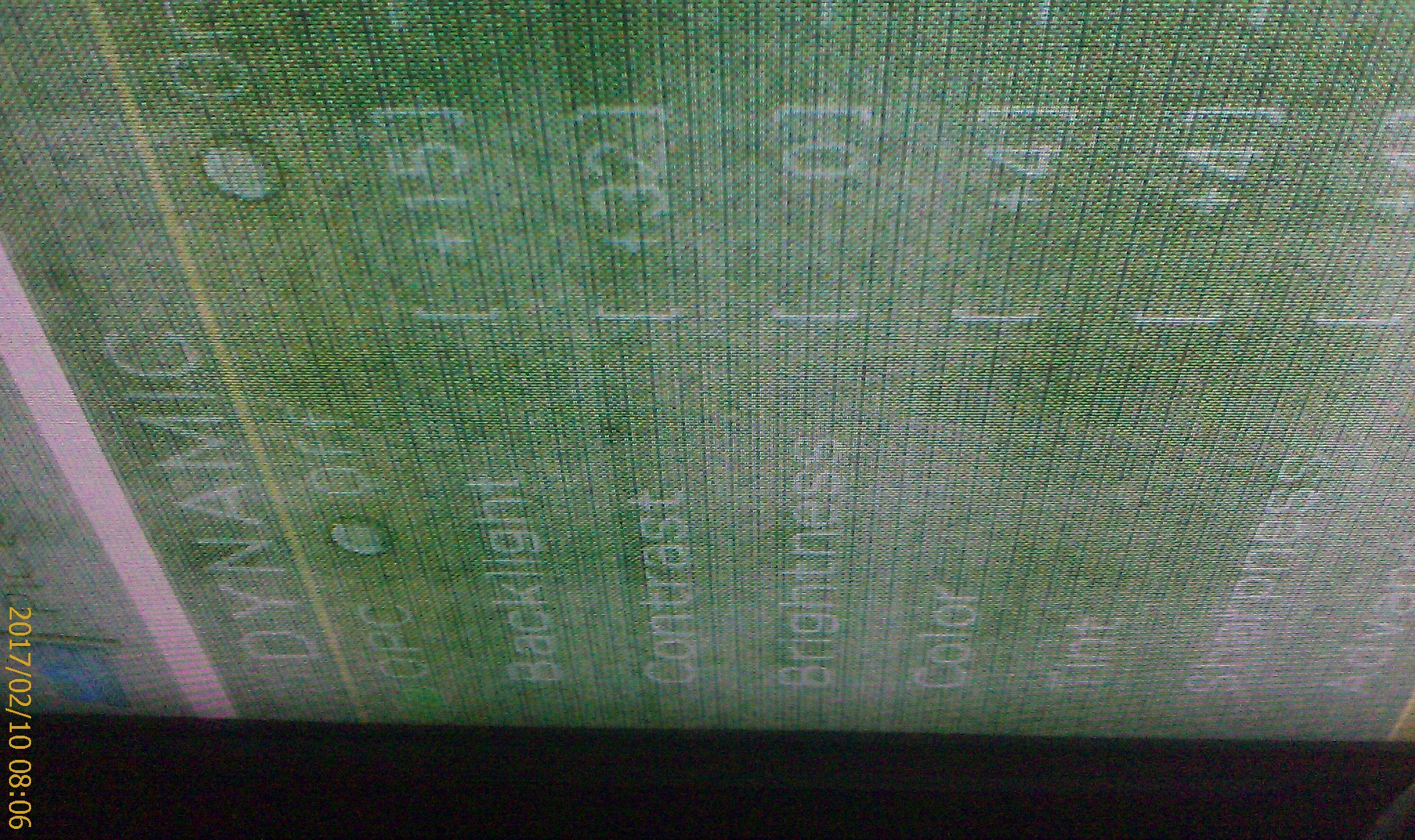

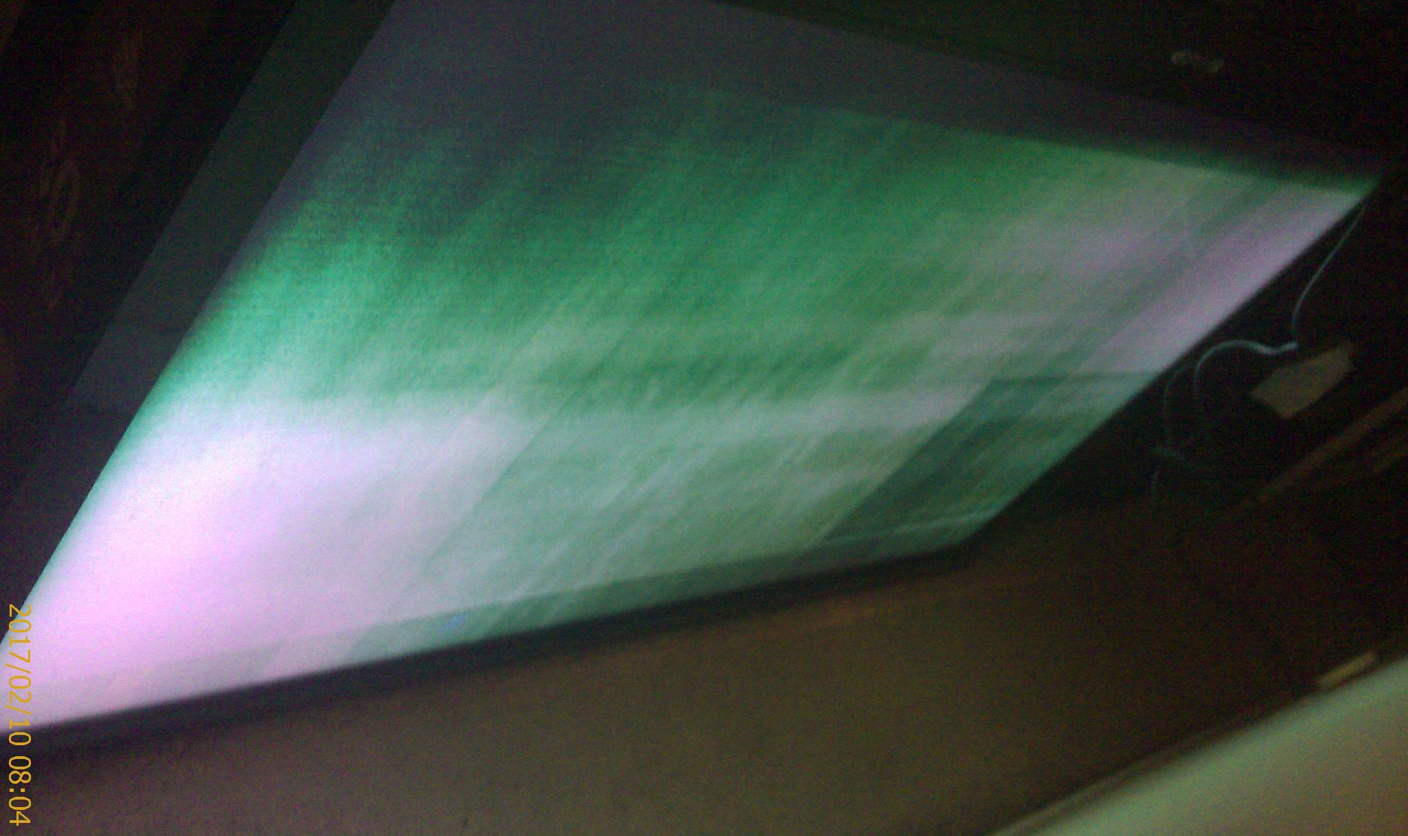

    i have had this tv for a while ....am finally getting to trying to repair
    when powered on the tv powers on fine but the display is totally washed out...and you can barely see the image and then the screen eventually goes to almost all white
    any ideas?
    i have been told it could be the lcd screen boards shorting on metal frame but when i look it seems its not touching frame at all
    fyi i replaced with a used tcon board but did not change anything but board was used so no guarantees it was a good board
    and there is power going to tcon board i tested it a while back
    before i toss out tv i want to make sure its not a bad lcd panel.....if it is bad lcd panel of course tv is worthless and would toss out
    see photos
    any help would be appreciated

    T-con made no difference? Does unplugging one ribbon cable at a time make a difference?

        It would tell you if the panel is bad or not. However, from the pics it looks like bad panel. Make absolute certain you reseat the cables properly and they aren't twisted/crooked or anything.

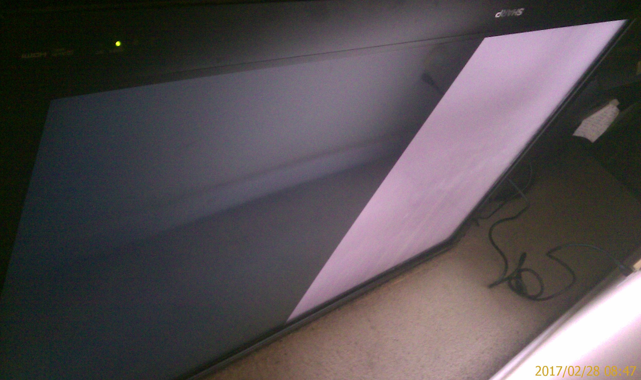

          hi i removed the left side cable
          and here is the pic
          the tv is upside down in the photo so the right side of the pic is the left side cable i removed
          all i want to do is see if the panel is bad....if panel is bad then i will obviously toss tv
          but i have seen people say that the panel boards short out against metal and that can cause the symptoms i have
          tjhe side of screen i left plugged in starts pure black and then gets this funky colorization but the colorization fills more and more of that side of screen as tv warms up and the side of the screen i removed cable starts off white with a few random thin vertical lines and then after a few seconds goes to all white
          i do appreciate all and any advice
          thank you

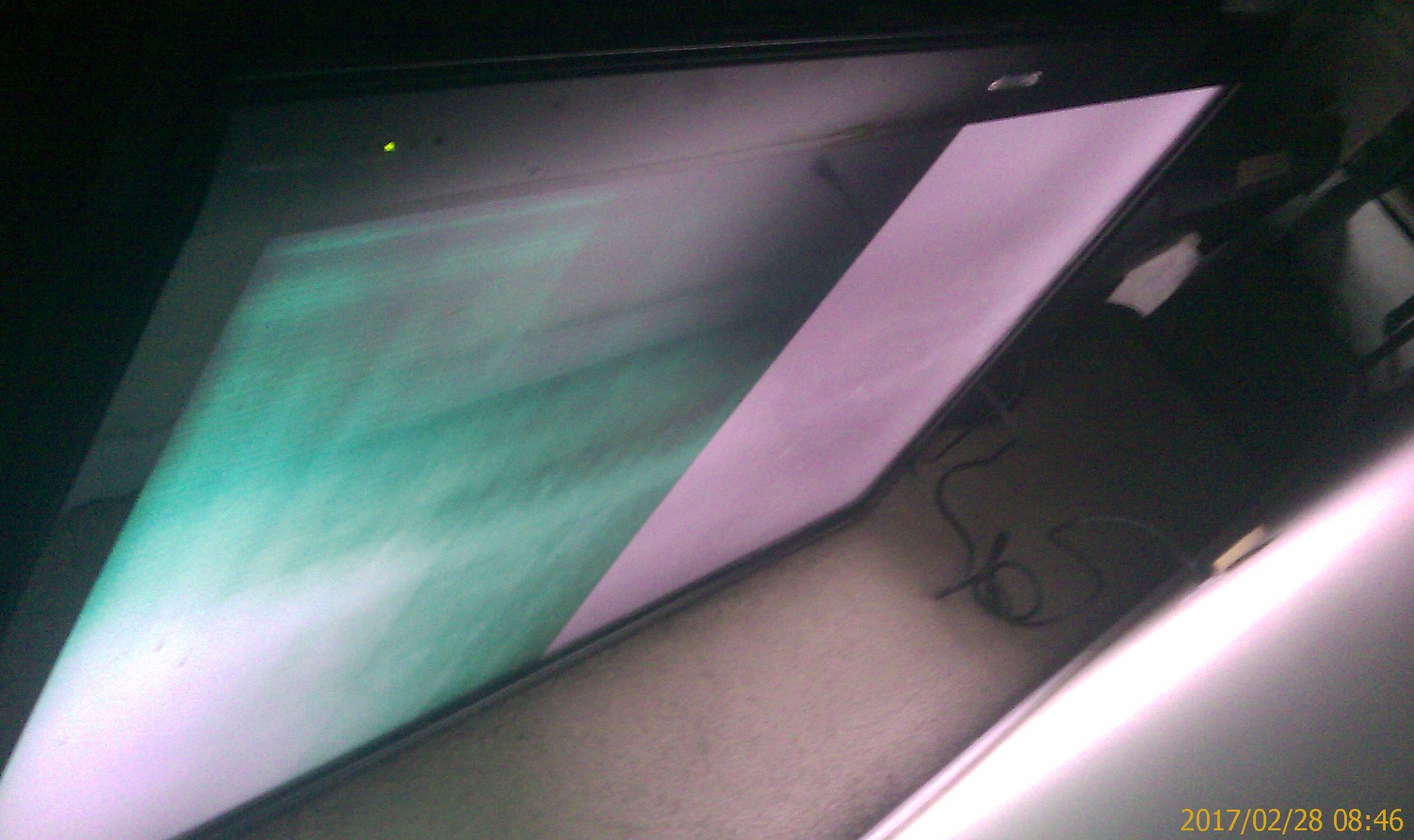

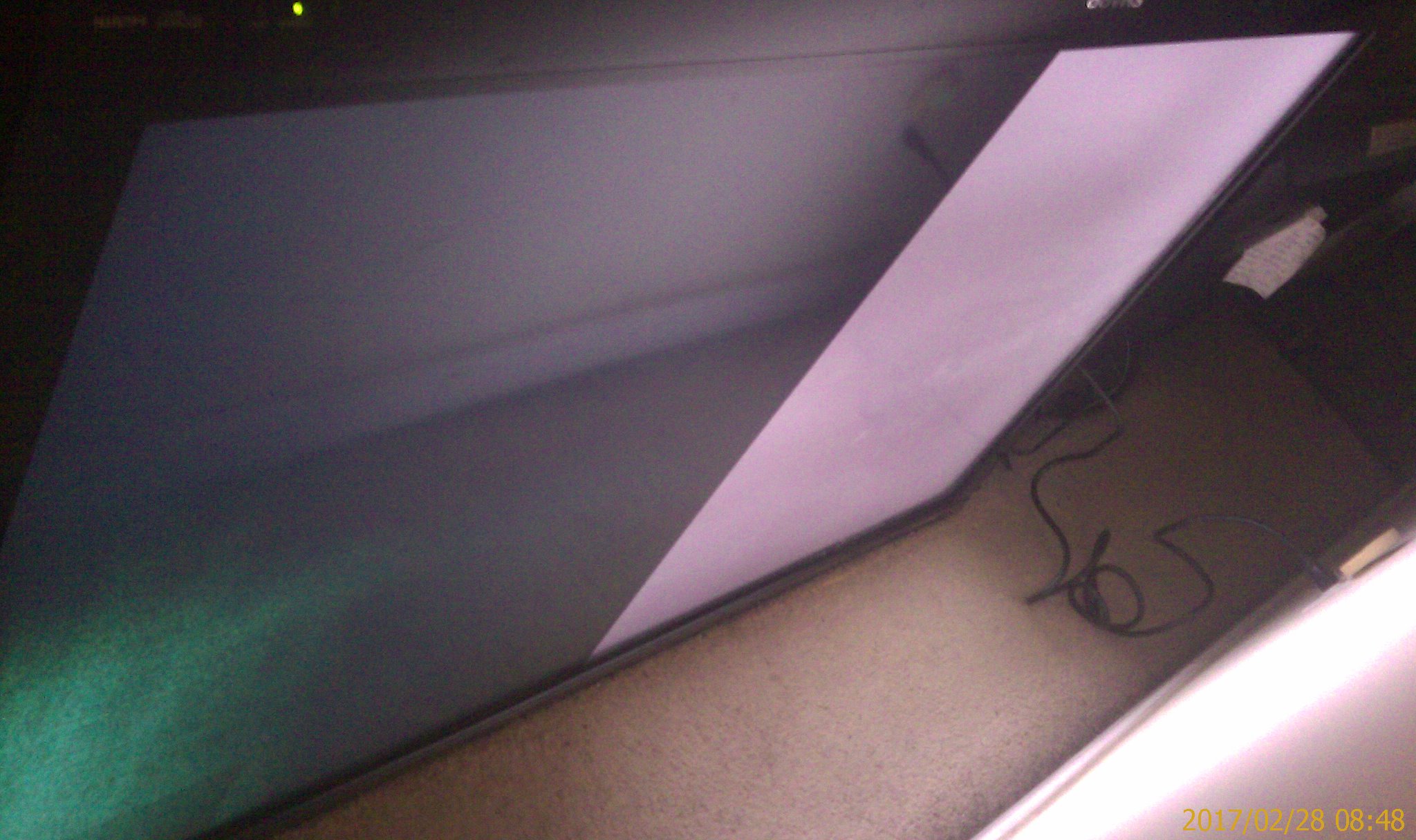

                    ok if i connect left side cable and disconnect right side cable
                    the left side is black but then after a few min it starts doing the weird colorization like other side did
                    and the right side is all white...with a few very faint vertical patterns but they go away after a minutes to pure white
                    pretty much mirrors what i did earlier

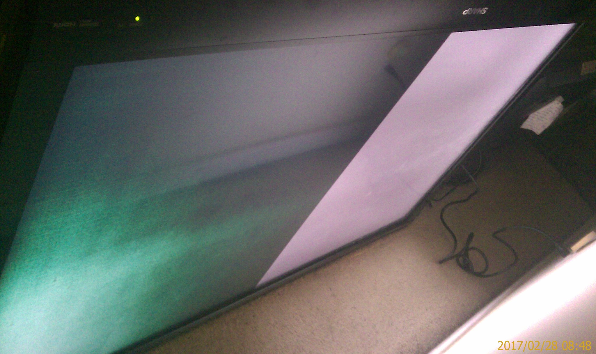

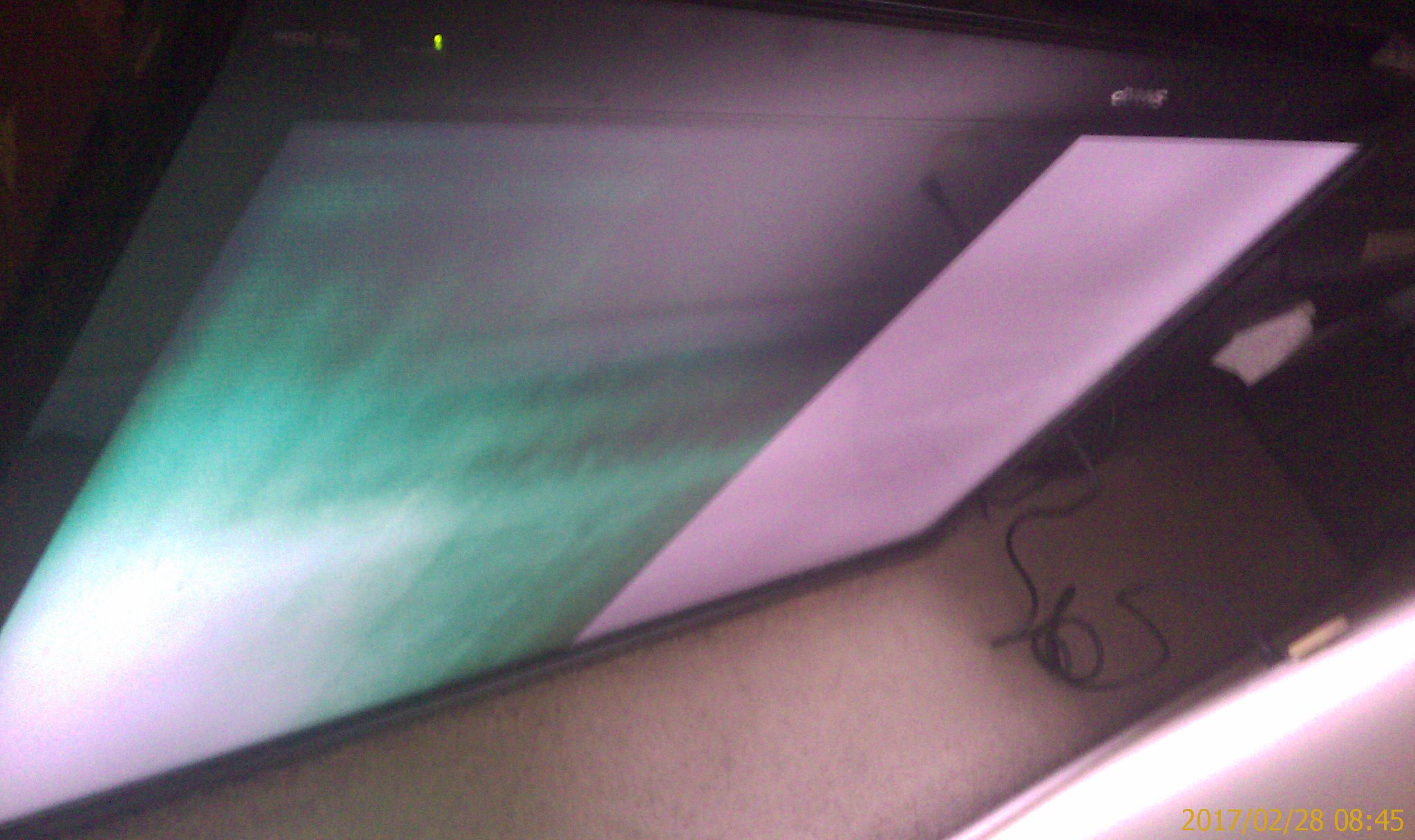

                      actually after even more time the left side goes all black....after some brief weird colorization that it does...reddish
                      and if i hit osd...nothing appears on left side of screen nor did it on the right side when i had right side plugged in....
                      when i had both cables connected i would faintly see images and osd....but eventually they disappeared
                      • shelby5041
                        • Feb 2009
                        • 1505
                        • united states of america usa
                        Re: SHARP LC-60E79U display goes from washed out very grainy to white
                        and if i remove both cables the screen is not black black but actually just dark and you can see that the backlights are on but screen is dark.....

                          The thing about the board touching metal can be that like many the band boards on top of the screen (on the profile's face) with the time can dilate, make a curve and touch on the bezel metal frame, so you have to dismantle that frame to see that and aventually loose the screws that firm that board to plastic chassis.

                                An lcd screen unpowered shows only white (all pixels off).
                                For the type of defect it seems to me a panel power supply problem, for example the lack of pixel's source or drain signal, you'll never discover nothing if you doesn't dismantle the bezel.. have you done it? Since the substitute tcon is used, you have also to test power supply test points, like AVDD, VGH, VGL, VCOM, V3D3, V1D8, VGMA's or similar names.. Has to be checked with and without flat cables connected..

                                    The panel is bad.....Part out and sell the Main Bd and PSU while you can still make a little money.

                                      let's back up a bit...
                                      you said
                                      "and the right side is all white...with a few very faint vertical patterns but they go away after a minutes to pure white"
                                      I said a disconnected panel (implied side) would show a STABLE white. How are "very faint vertical patterns" a "stable white". I don't think they are the same. Is it a problem? Potentially. Does it show EXACTLY the same with the cabling "reversed" (ie. the other side unplugged, and the previously unplugged side plugged back in)? Yes, if both tcons cables are unplugged at the same time, the screen will not go white as there will be no power to the panel.
                                      The purpose of unplugging cables is to detect whether there is a possibility of a bad panel as doing a lot of voltage measuring won't really tell you much about a bad panel. The measuring will give you some understanding about the supporting circuitry but it is not without hazard.... hence, trying to do some "high level checks" is usually good especially with sharp panels which seem to have some issues around the tab drivers.
                                      Anyways, I wouldn't give up just yet on the panel even if it is a bad panel as you will find a few threads where people have saved the 60" sharp by removing the bad tabs.
                                      However, it does potentially appear to be a bad panel as some have suggested. Its whether you can determine what is bad about the panel... and whether it can be saved therein.
                                      Still further, as suggested, if the bottom edge boards / tabs have been "wetted" or otherwise, then these will corrupted the display in various manners... have you checked these?
