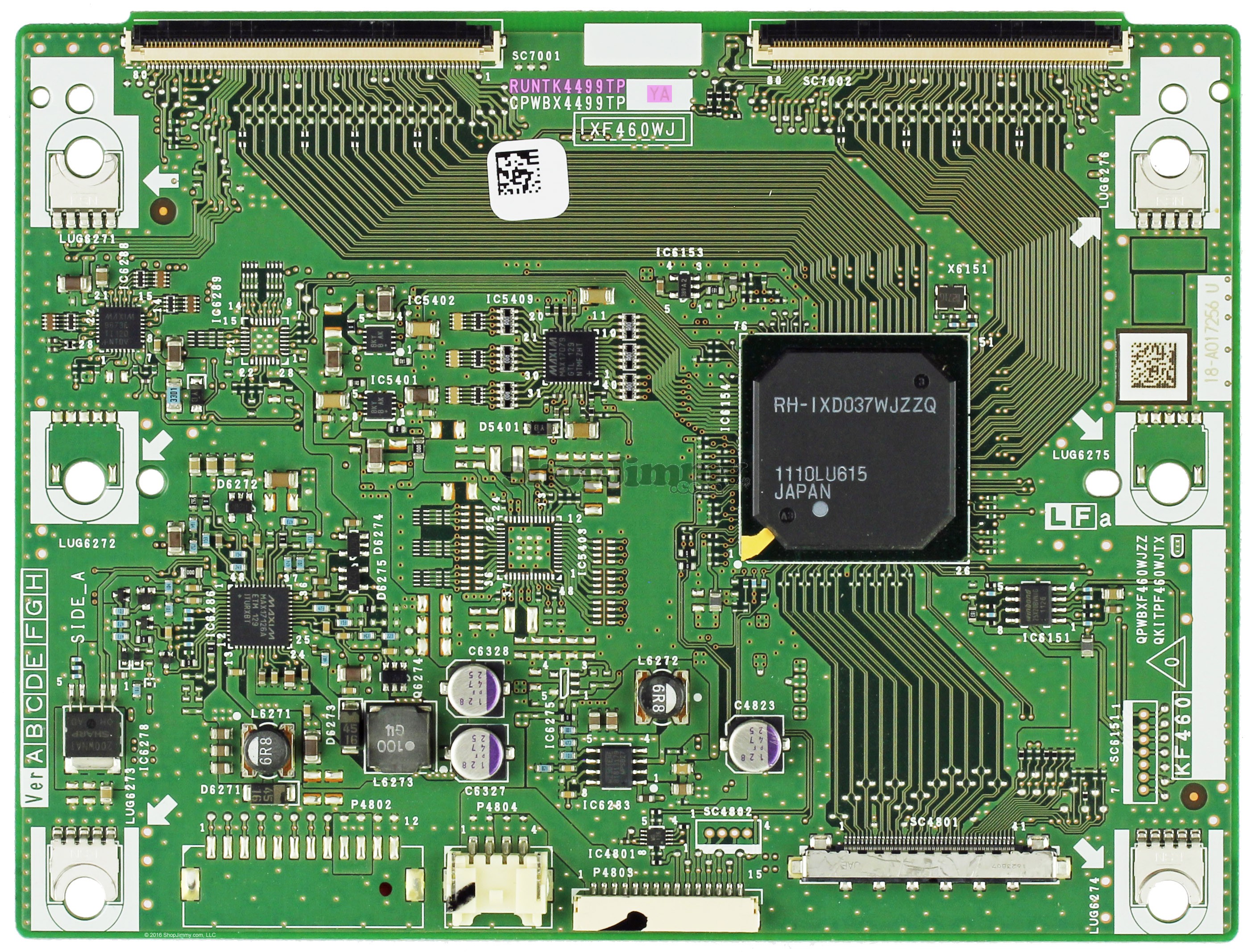

        i believe 2 yrs ago when i last worked on this tv i did look at the boards that are on bottom of tv and they were not touching any metal ..i think i even put some material in between to make sure and it did nothing....and i believe i did test power from ps going to tcon and it was good..and thats why i bought the replacement tcon board....which was used.....but we all know that buying used boards does not mean they are good....what i need to do is test the test points like the other guy said and if they seem ok then that would rule out tcon board
          Re: SHARP LC-60E79U display goes from washed out very grainy to white
          here is a photo of tcon from online ....what would i test and what voltages am i looking for...if anyone knows
            Without a circuit diagram you could look at the voltages on the level shifter MAX17079 and see if they match or at least follow the expected voltages. Eg Vcc, VH1, VH2, Vcom, VL2, VL1, VLS as shown on the datasheet.
            Also Sharp 200WNA1 regulator

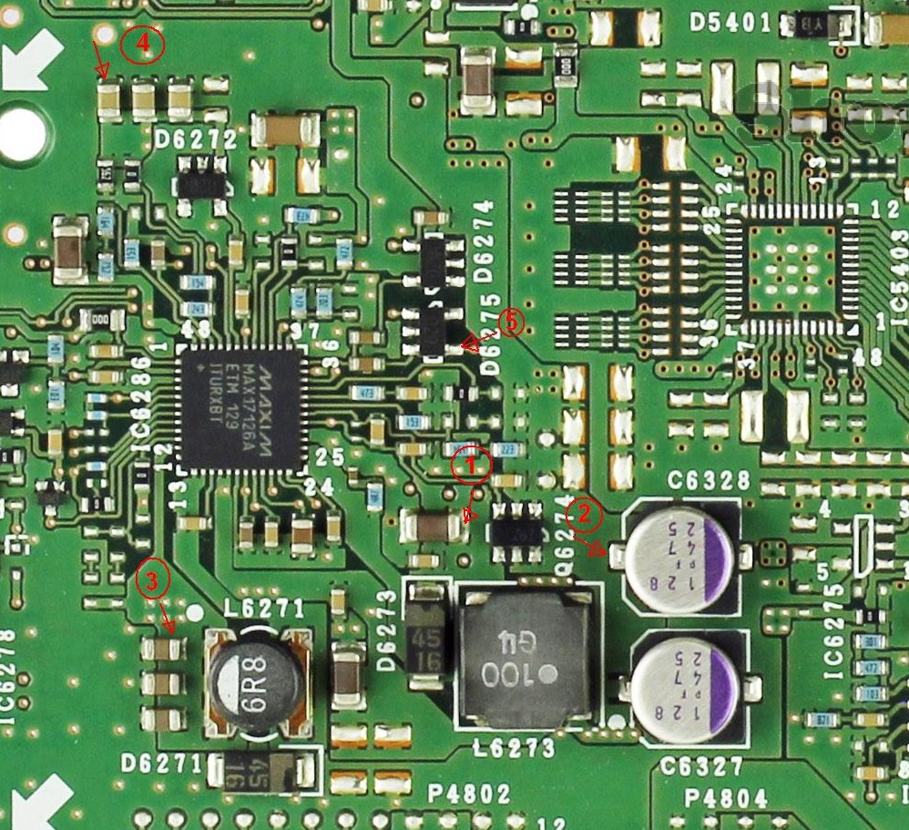

              The card has no TP marked so has to be put a little patience, i have to read the MAX17126A datasheet, the voltages generator, i don't know the function of max17079... the other Maxim chip is difficult to read.. which one is gamma correction?
                Anyway, (1,2) have to be around 16V, (3) 3,3v, (4) -6V (i have indicated the other terminal that is at gnd, sorry), (5) 27V...
