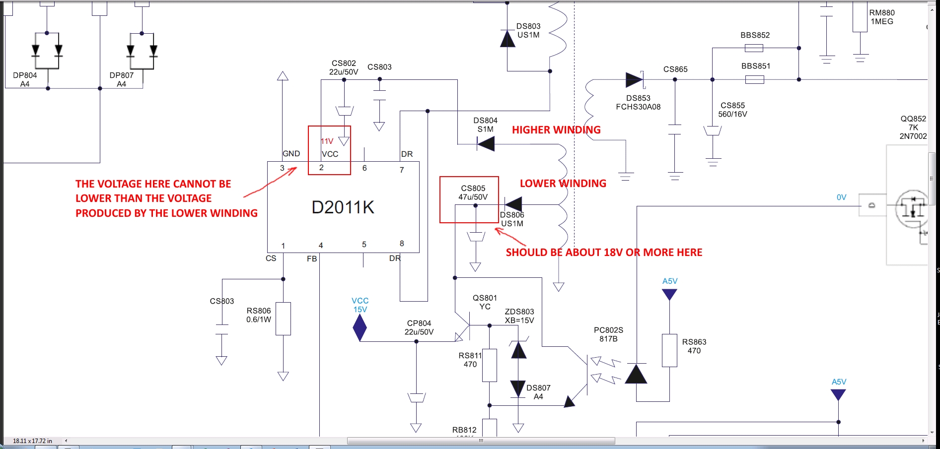

    Originally posted by tn245
    That was with the 100W in.
    Just tried without it on standby mode and CS805 is 18.5V but voltage is creeping up. Was heading up to 19V when I decided to switch off.
    That reversed engineer schematic has lots of errors, if you look at how the DCV is generated by the HIGHER AND LOWER Transformer windings, it is impossible to have lower Voltage on the HIGH winding than the low winding.
    11V to run that STBY SMPS is right.
    What is the P/N of the actual IC of the stby power supply? Really D2011K as shown in the diagram?

            So QM801 has about 14V on its base so must be switching off the Vcc supply to the FSFR1700. Just trying to get my head around how ICM803 shunt regulator works. It has 2.5V on Vref pin.
              Re: Samsung UE46EH6030 - Blowing fuse and mosfet
              QS801
              If the Base has 14V then the output will be 14V - Vbe of the transistor (about 0.6V) so the out put should be 13.4 VDC.
              But per Schematic you have 15V zener in series with diode so the Base Voltage should be around 15.6 V (depend on the tolerance of the Zener diode) to get 15VDC output.
              I expect the Collector Voltage to be around 18V or so. What is the Collector Voltage?
                  Sorry I was testing QM801 there, not QS801. The numbers are confusing. QM801 is a pnp transistor switching Vcc supply to the FSFR1700. As it is a pnp the 14V on the base would be pretty much switching off the Vcc supply at that point right?
                  To answer your questions QS801 has ~15V on all pins. Standby ic is D2011K.
                  Standby circuit all seems to be fine. Any reason you are asking about that part of the circuit as the 15V Vcc supply from there seems fine? 15V is just not getting to the FSFR1700 ic.
                      QM801:
                      B: 14V
                      E: 14.3V
                      C: 8V
                      All are fluctuating a little, especially collector.
                            I think you need to check the PFC output Voltage sensing 1M resistors RP824, 826, 826, 827, 828, 829 (30K), and the DCV of RP829.
                            right now that ICM803 is not fully on to give bias current to turn on QM801, if you connect 1K resistor between Anode and Cathode of ICM803, you will probably get the VCC to run FSFR IC.
