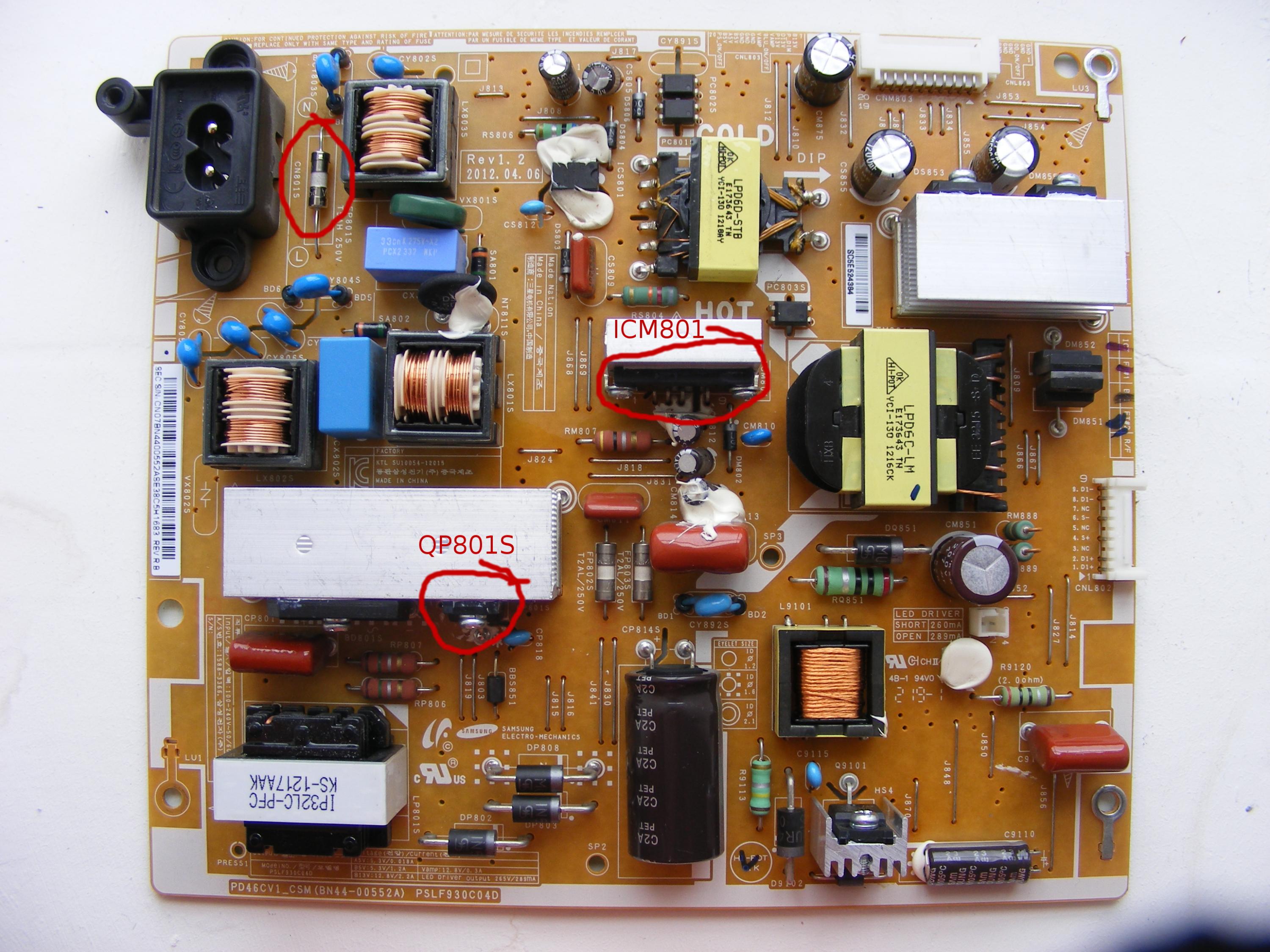

    Anybody worked on this power supply? PSU is PD46CV1_CSM (BN44-00552A). Came to me with blown primary fuse. I found ICM801 - FSFR1700XS had a hole in the side, QP801S 13NM60N mosfet shorted drain-source, QM801 PMBT2907A smd pnp transistor shorted collector-emitter.
    I replaced the above mentioned components. Powered up the board with 60W bulb in series to limit current. Bulb lit then went dim. 5v and 3.3v ps_on/off present. Tried to power up without lightbulb and something flashed around ICM801. Fuse blown, mosfet shorted again. pnp transistor seems ok. No hole or shorts in ICM801 but don't know if it's ok.
    There is a repair kit for this board but it seems to be a general one for all potential problems with more parts than I need. I don't have the other two fuses open or large diodes shorted but potentially the other two ics ICS801 and ICP801S could be the culprits. Not sure what the smd diode is in the kit.
    http://www.ebay.com/itm/Samsung-BN44...-/361740963020
    Anybody encountered this one before or have any thoughts or ideas for fault finding?

    So I'm going to replace ICS801 (D2011K) and ICP801S (SPC7011F) as well as the previously replaced parts.

      Re: Samsung UE46EH6030 - Blowing fuse and mosfet
      Id also advise you change ICM803-smd pfc controller.

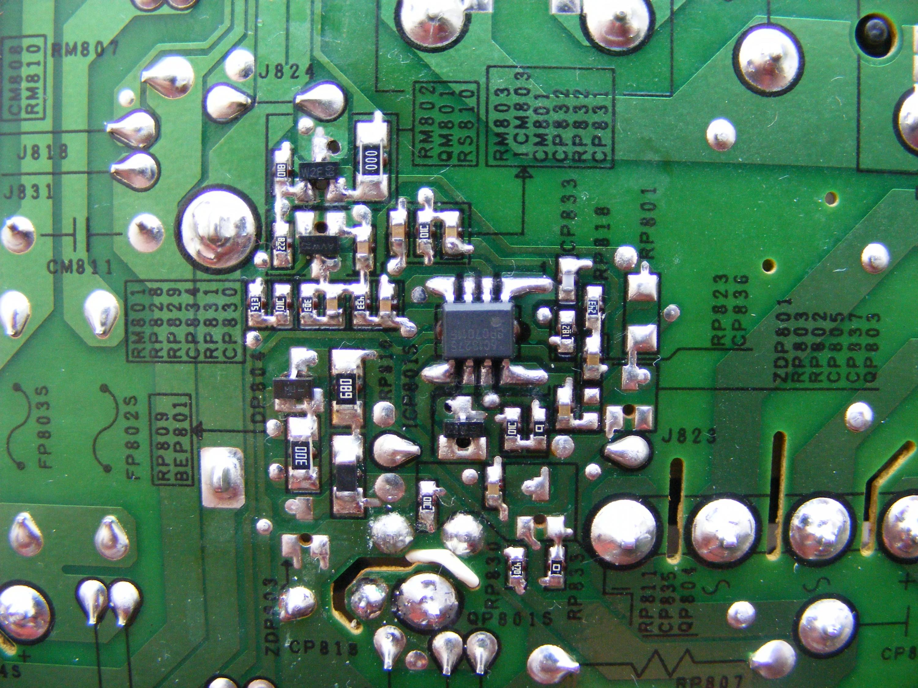

          So I got the parts finally and put them in. I'm running the board with a 100W bulb in series. LED backlight strings flash rapidly. PFC cap is at 260V.
          The PFC controller ic is getting 14.5V Vcc. The other pins are at:
          1 FB: 1.6V
          2 COMP: 5V
          3 RT: 1V
          4 OVP: 1.9V
          5 IS: -0.02V
          6 GND
          7 OUT: 14.8V (I guess this is pulsing but my meter is reading it as DC? Does fluctuate slightly)
          8 Vcc: 14.5V
          Datasheet for pfc ic:
          I've been referencing the attached schematic although it is not the same board it has some similarities and is the closest I could find.

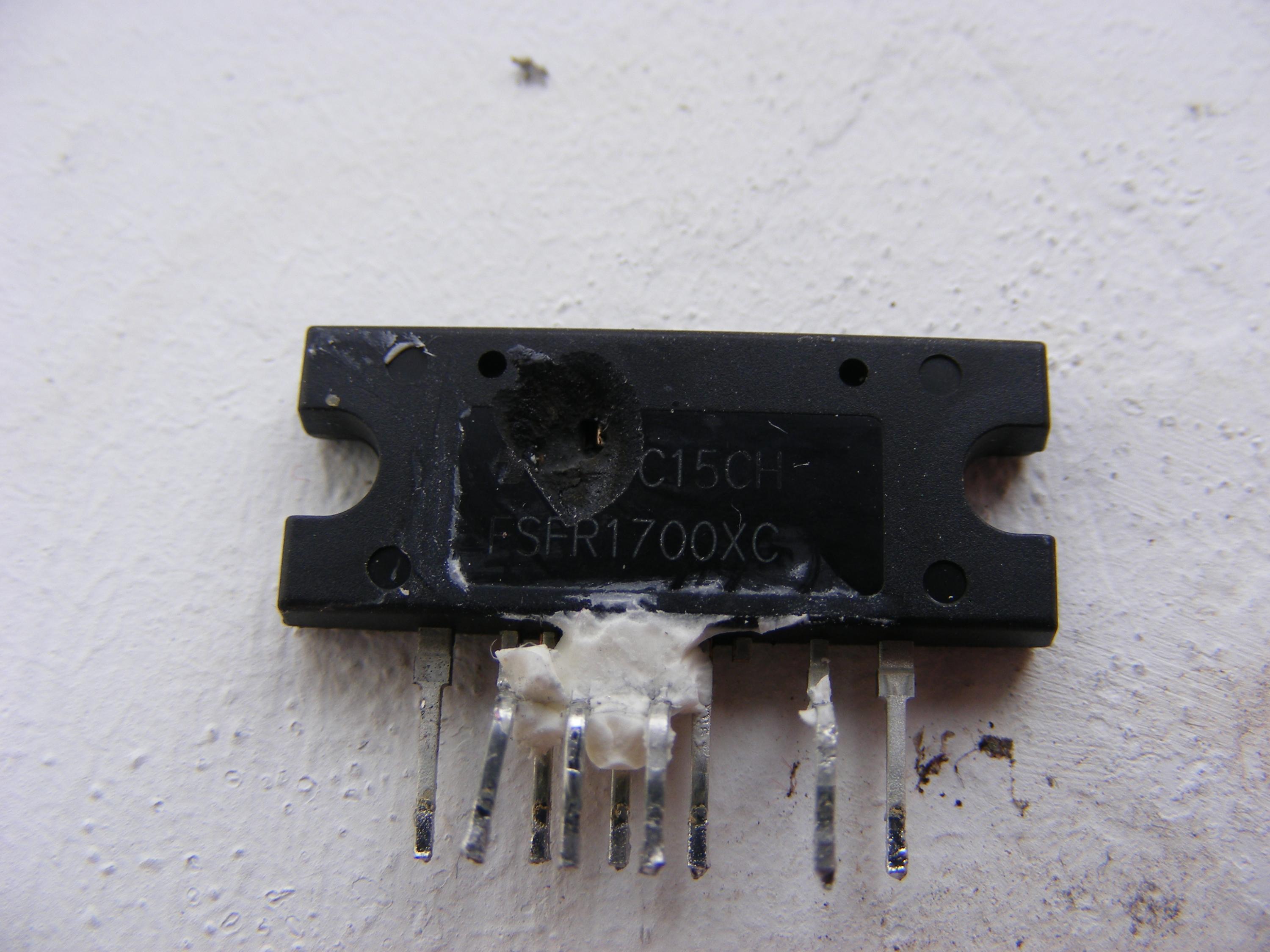

            Actually the pfc circuit seems to be working. I noticed the Vcc to the FSFR1700 was low and fluctuating, so removed the jumper supplying Vcc to it and now the pfc cap gets to 390V. So something in the FSFR circuit is causing the trouble.
