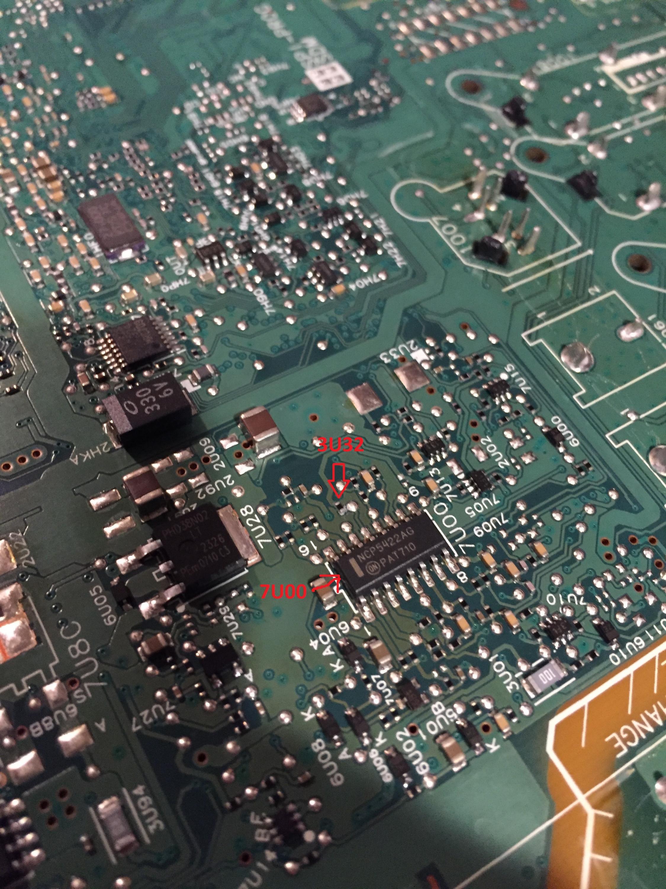

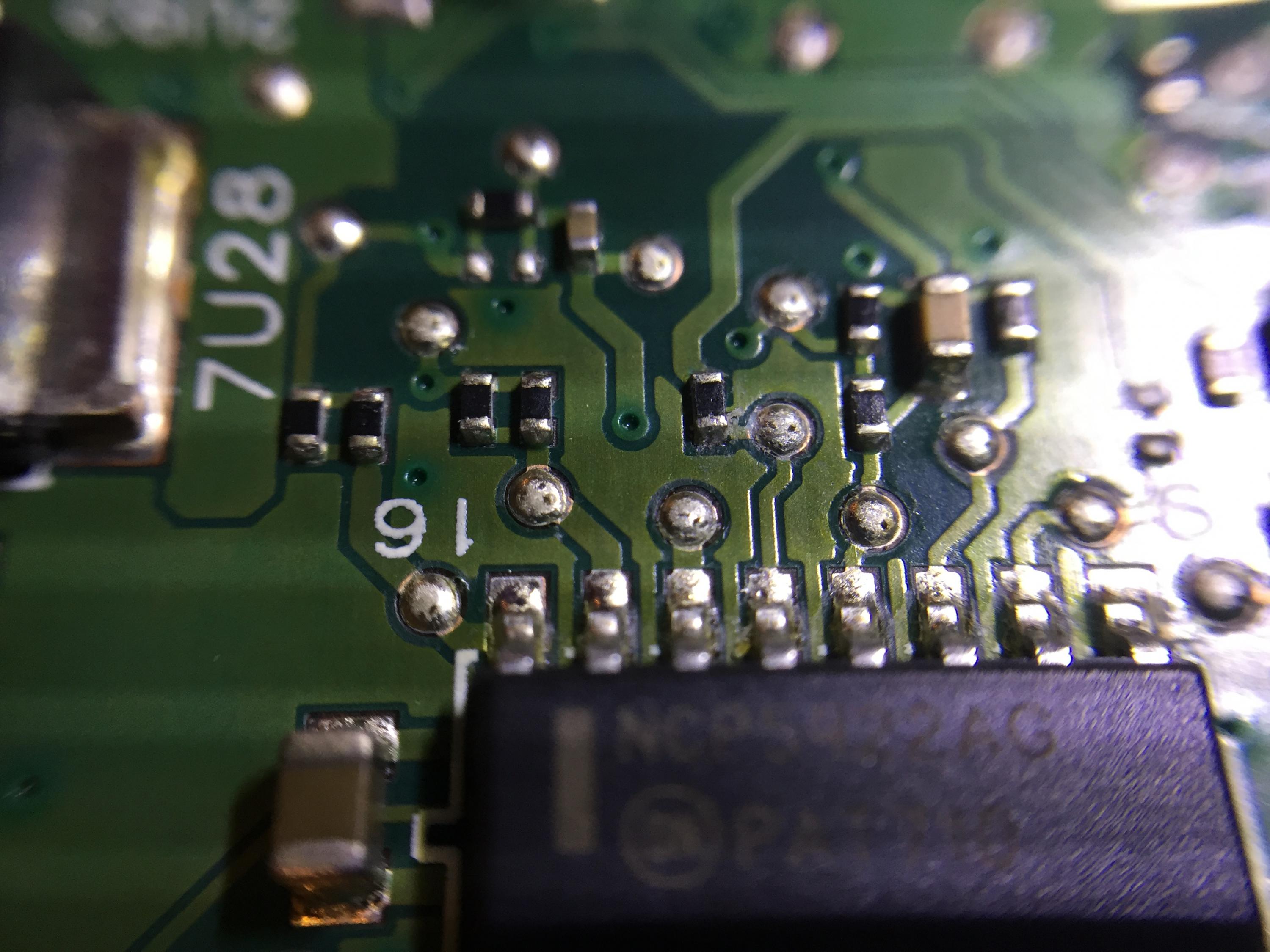

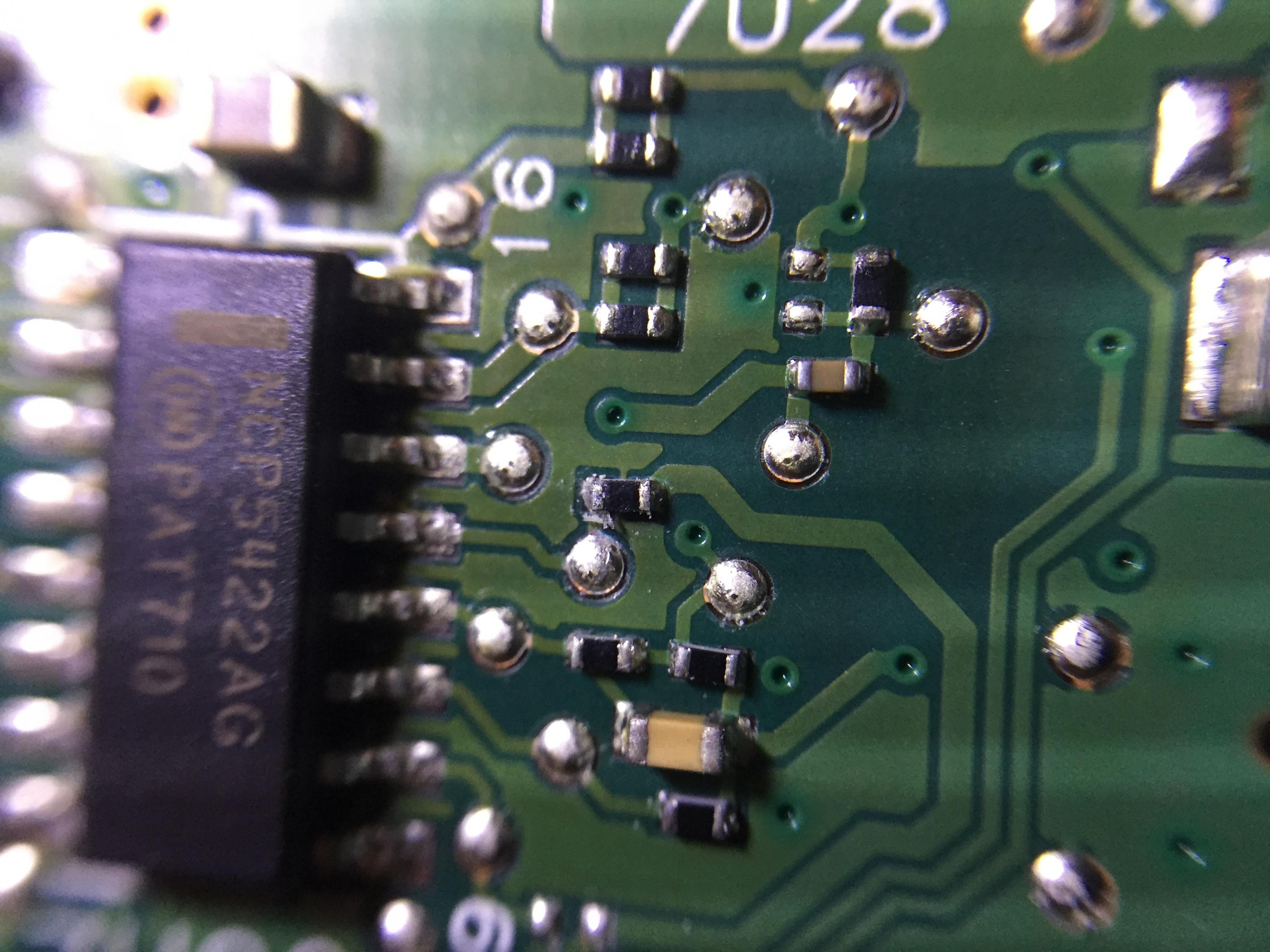

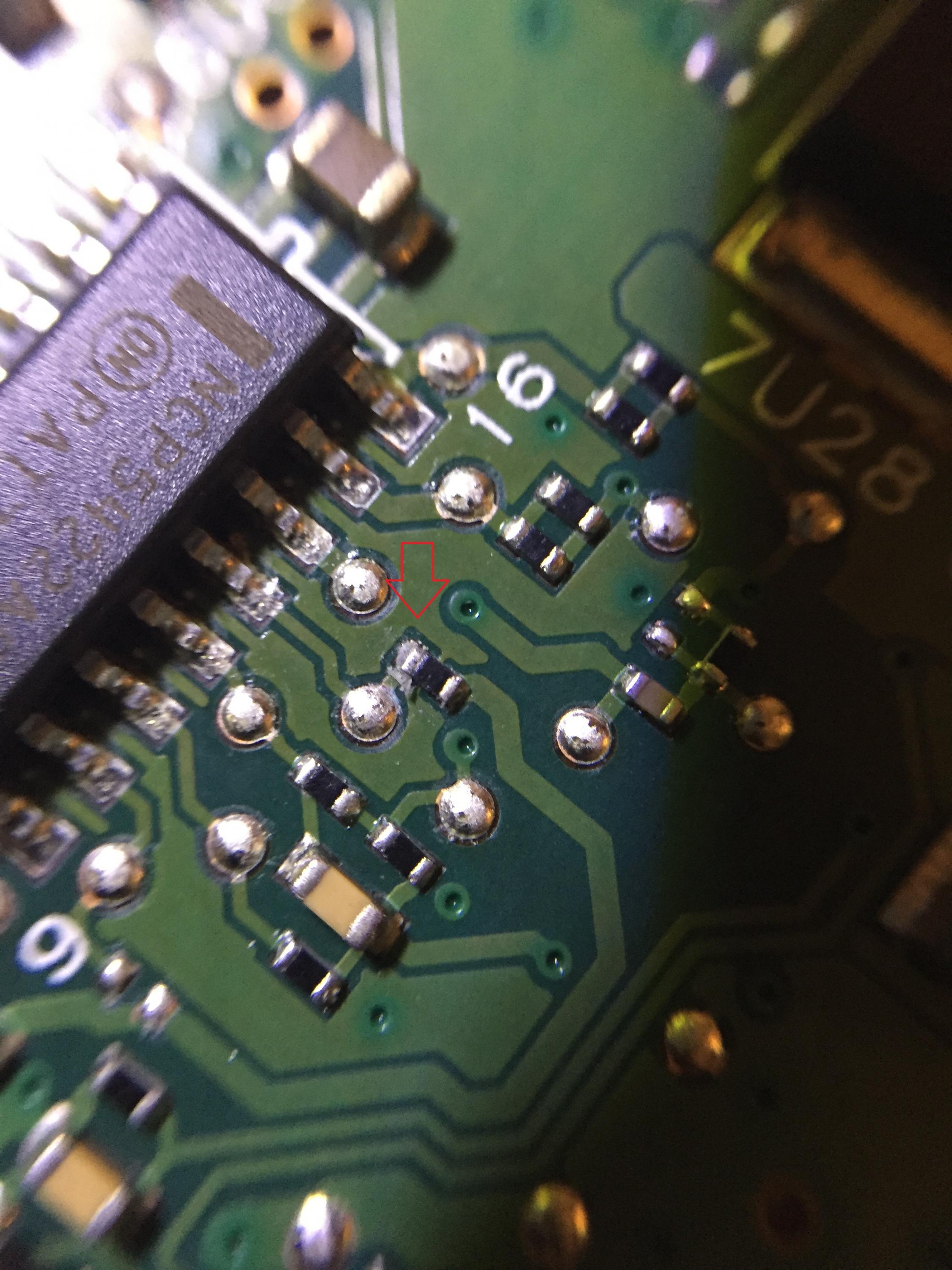

              I first tested resistor 3U32, which is a SMD on the back of the main board. It tested ok (38.7k ohms, rated for 39k), but it looks a little funky. I have attached a picture of 3U32. (sorry I couldn't get a closer shot, if I can find my dang macro lens I'll take a better one.) It has continuity to the next components, but it almost looks burned or unseated, at least compared to the others. For some reason I then plugged in the board, and I touched a probe to the resistor. The squeal immediately became much more intense, as if I had touched an open wound. The board restarted if I recall correctly.
              I also noticed that there seemed to be heat coming from this area. I hovered my finger around until I found that the source seemed to be 7U00, a small integrated circuit connected directly to 3U32. I touched the top to feel if it was hot (it was) and the board restarted 2 or 3 times in a row. I made sure I wasn't touching any pins and tried it again with the same result. I've heard that when processors get hot, it sometimes means they are bad, but I don't know if this applies to ICs.

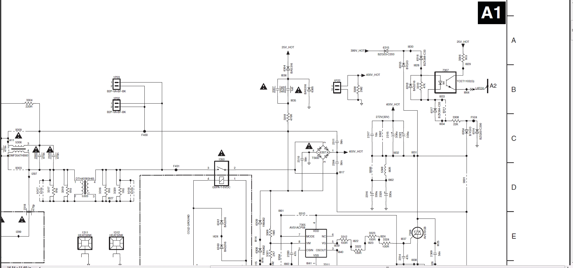

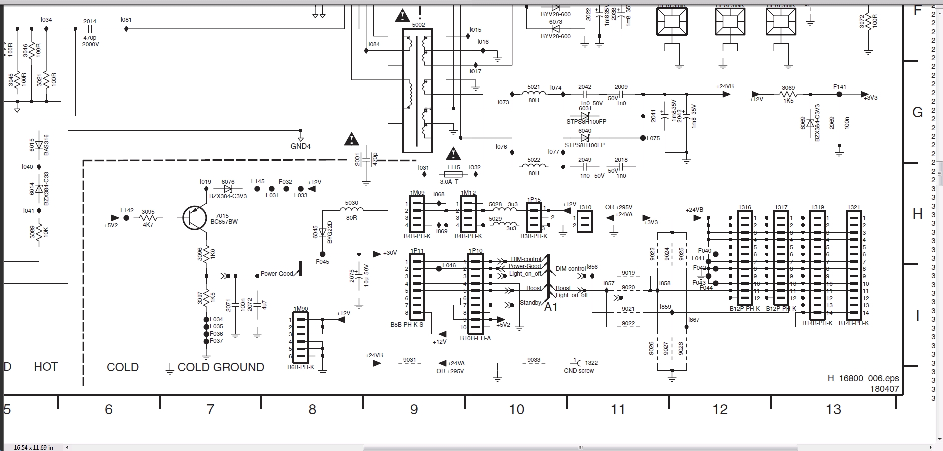

              I searched the guide to see what else I could find about 7U00, and it seems like its a fairly important circuit?? Page 142 says it is a MOSFET driver and PWM generator. The paragraph titled "Voltage Booster" on page 142 says that pin 4 should be 18V. I tried to get a voltage reading on pin 4, and as soon as I touched the probe to it, the board restarted continuously, so much so that I couldn't even get a reading on the pin. Pin 4 is directly connected to 3U32. Coincidence? Maybe.
              This is where I'm stuck. Like I said, I'm pretty inexperienced, so I don't know where to go from here or what to test next. Does it sound like I may be on to something or am I on a wild goose chase? Maybe I'm just causing a short... Any advice is appreciated, I'm here to learn.
              *Full diagram of the main board can be found on page 122; 7U00 and 3U32 are in E2*

                Re: Phillips LCD Model #42PFL7422D/37
                Need some pictures of the area
                  Whoops, image didn't post. Tell me if you can't see it well enough, I'll try and get a better one.

                    Alright, that picture sucked. These are a little better. There was more of that grayish mark/stuff around the SMD (burned solder?), but it came off when I grazed it with the probe.
