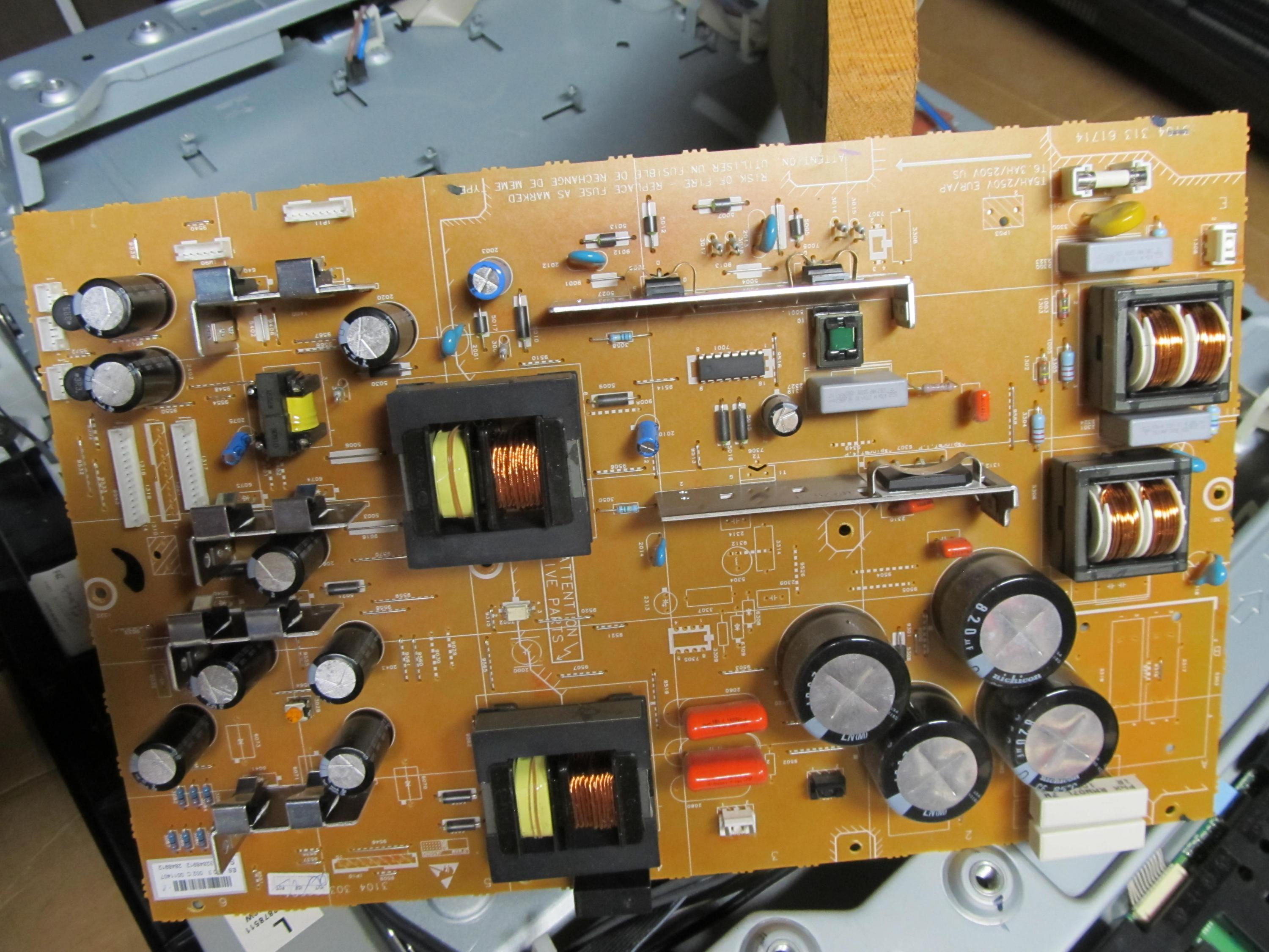

    I have this 42” tv, Phillips LCD Model #42PFL7422D/37, when you plug it in, it shows a solid blue power light, black screen (nothing on the screen), and then makes a clicking sound for a while, then shuts down (with no power light). I thought wow, easy fix, probably bad caps. Took the back off, cannot see any visible signs of bad caps (no bulging or leakage visible). I then plugged it in and turned it on to see where the noise was coming from, could see two different places that lit up and went back off with the clicking sound, on the main board. The noted lights (on the main board) came on and off with the clicking sound. Haven't checked anything else yet. Just took “my pictures” and quit for the night. Appreciate a little guidance as I'm not trained in this field, just trying to pick up a little knowledge as a hobby. Thanks!

      You have standby voltage and tv is trying to turn on. You need to take all the voltages as shown near connectors on Power board and post the readings together with what the markings say e.g. ps-on etc.

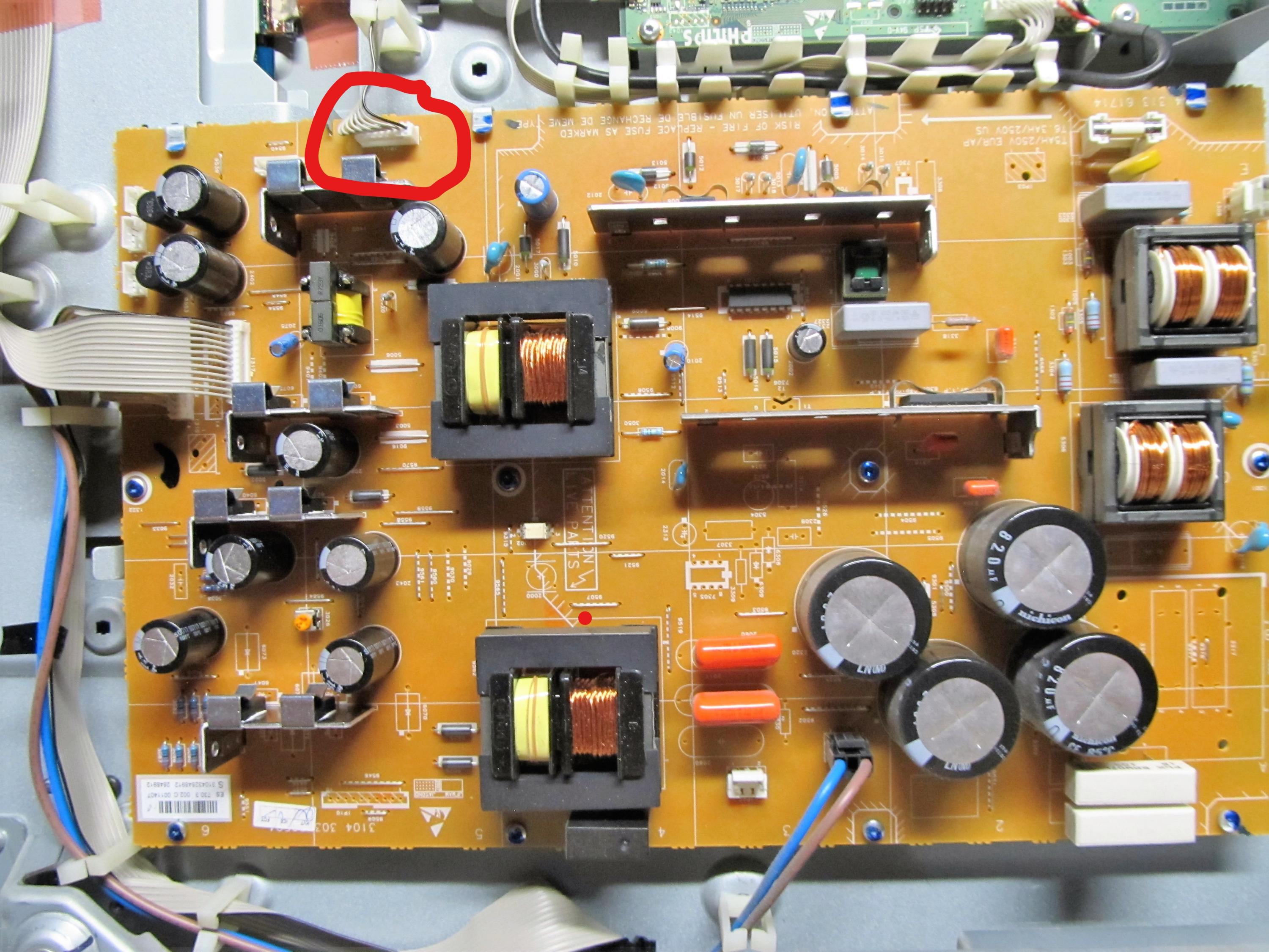

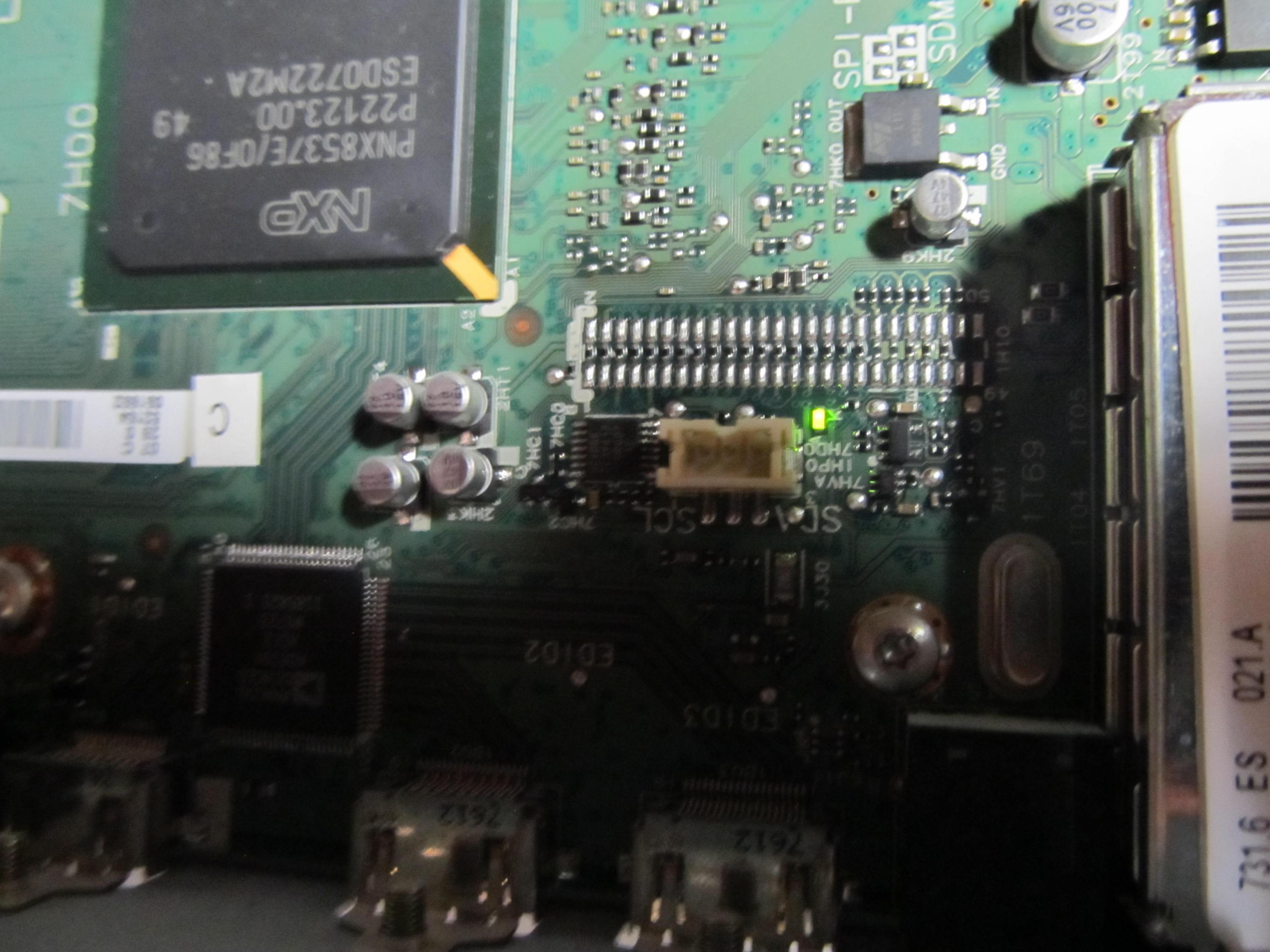

            Hi,,,,,I just got back to my tv. I checked for power at the ribbon that goes from the power board to the main board (with everything connected) and found no dc voltage at any of the pins. When I plug in the AC cord, the green lights (standby voltage, I guess) come on and the blue power light comes on. Then the green lights on the main board go out, and the blue power light goes out and turns to a red blinking light of six long and three short blinks. I had my wife plug it in, and there is still no dc voltage at that ribbon with the green lights burning on the main board. What does six long blinking red lights, followed by three short red blinking red lights indicate? Thanks!

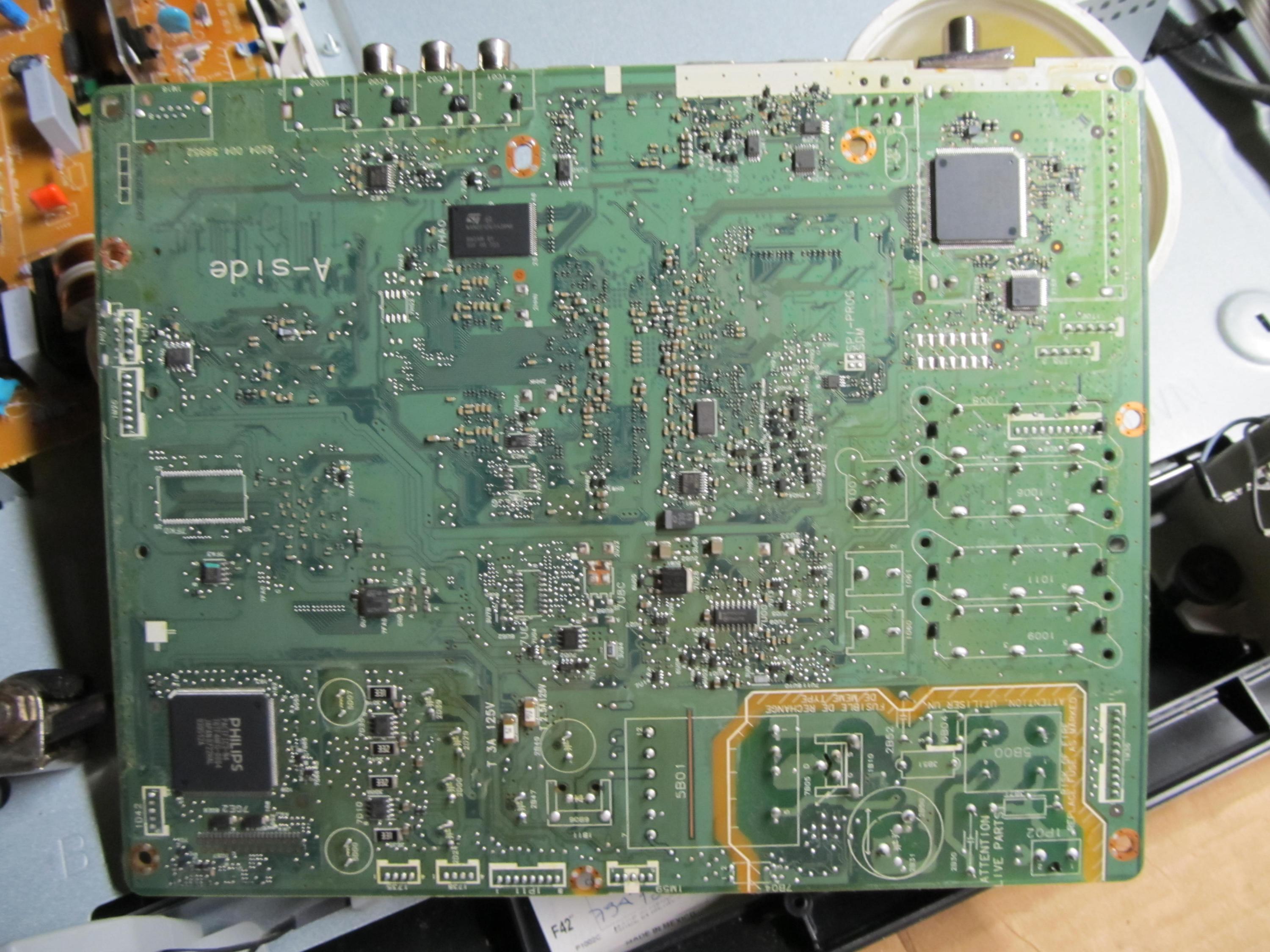

                Re: Phillips LCD Model #42PFL7422D/37

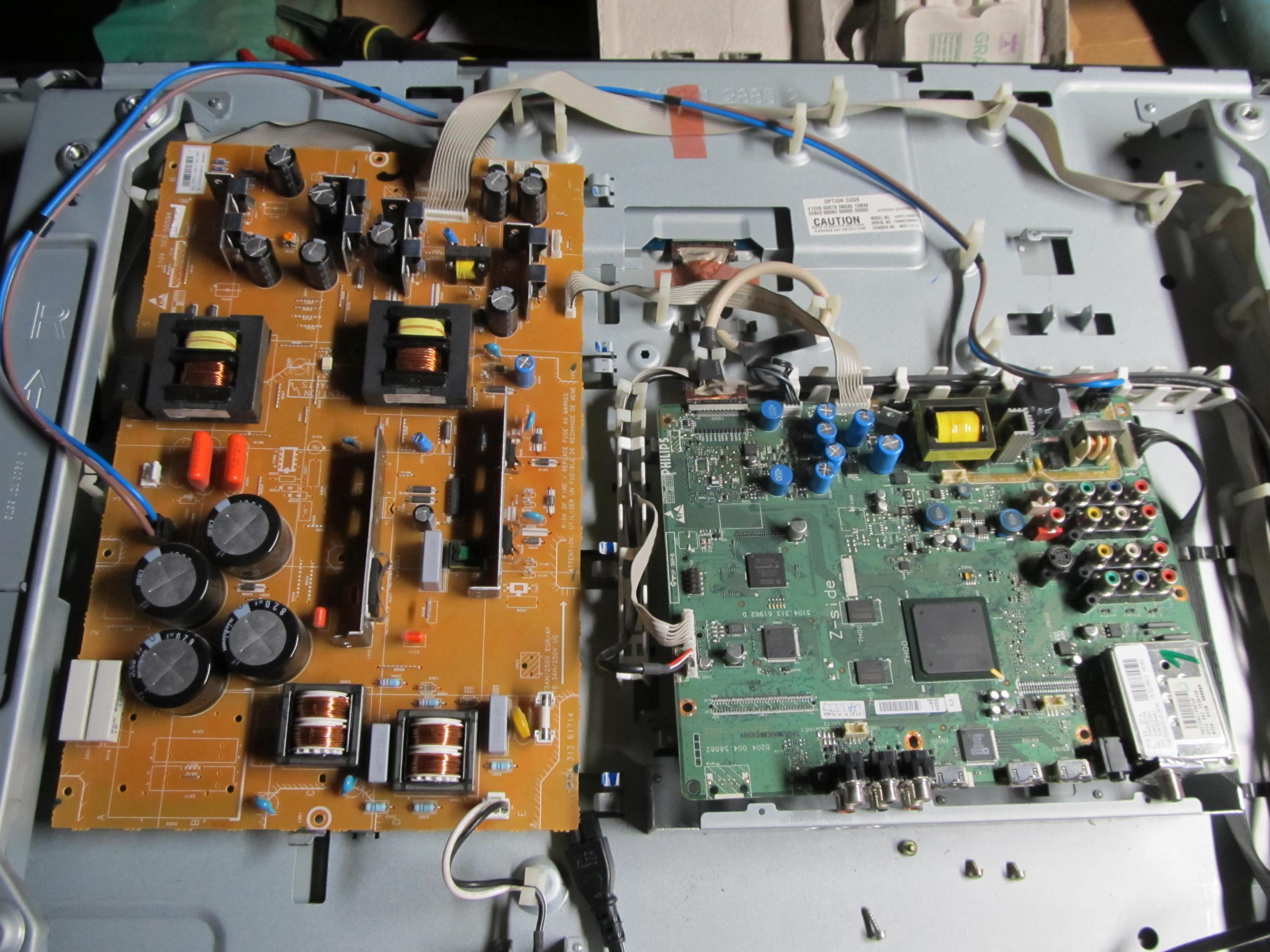

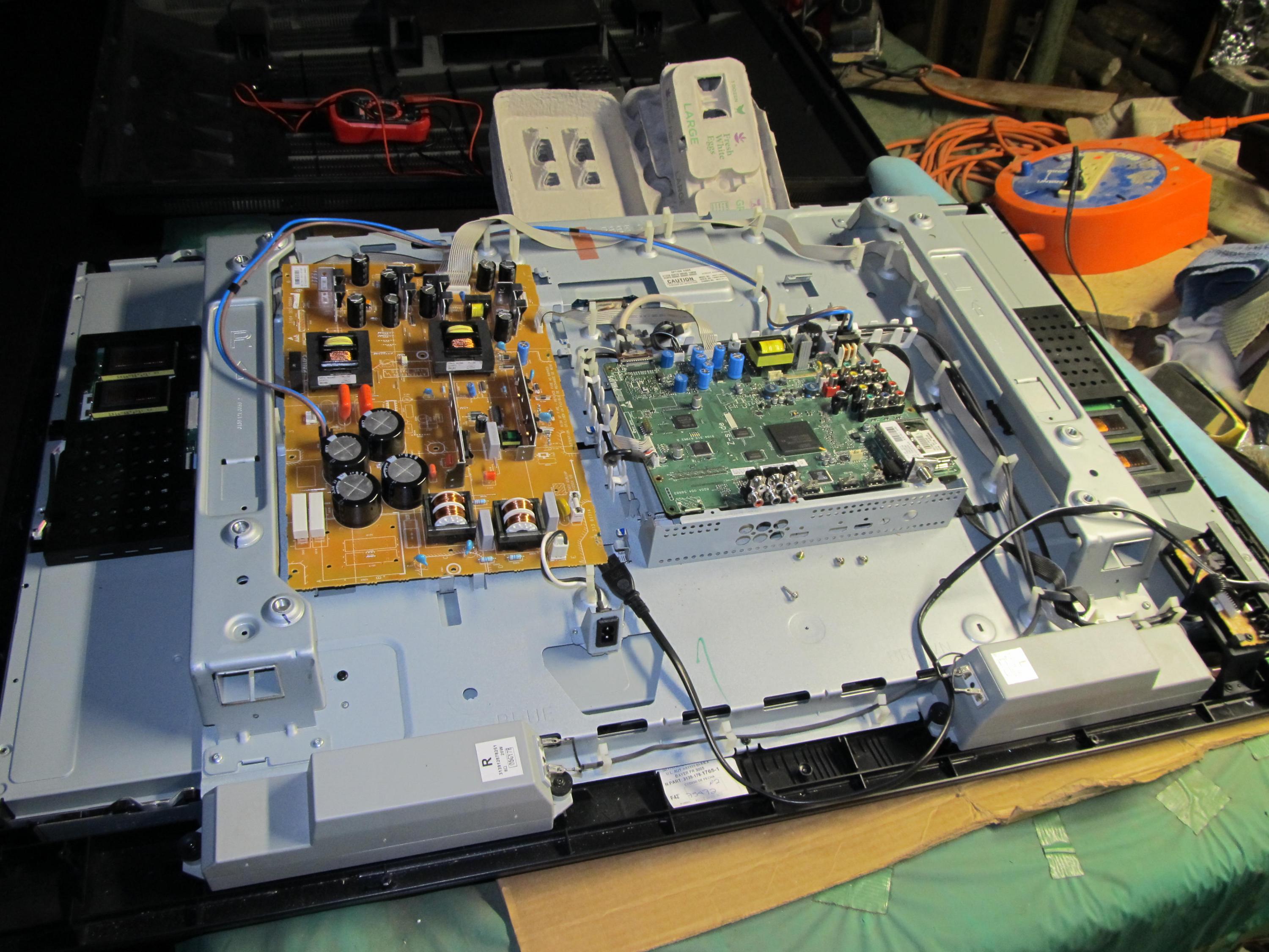

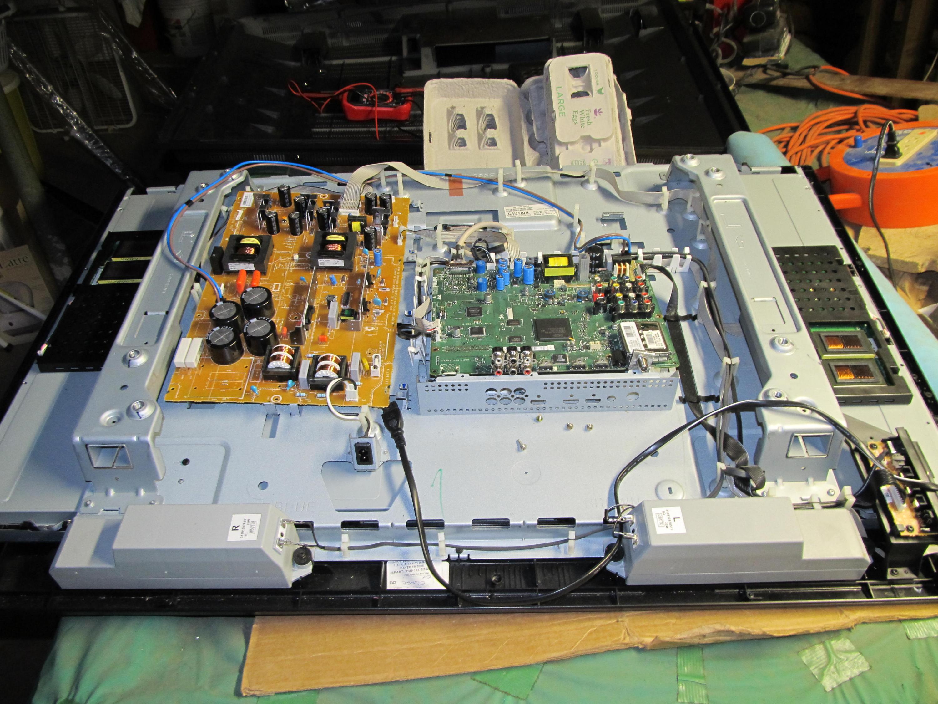

                We need the pictures of the whole backside of the TV showing all the boards and how they are connected together.
                You have two power supplies, the standby supply is on the main board, and then you have main power supply that is turned on by the main board.
                There are many version of this model so we need to know what trhe actual boards are being used in your TV.

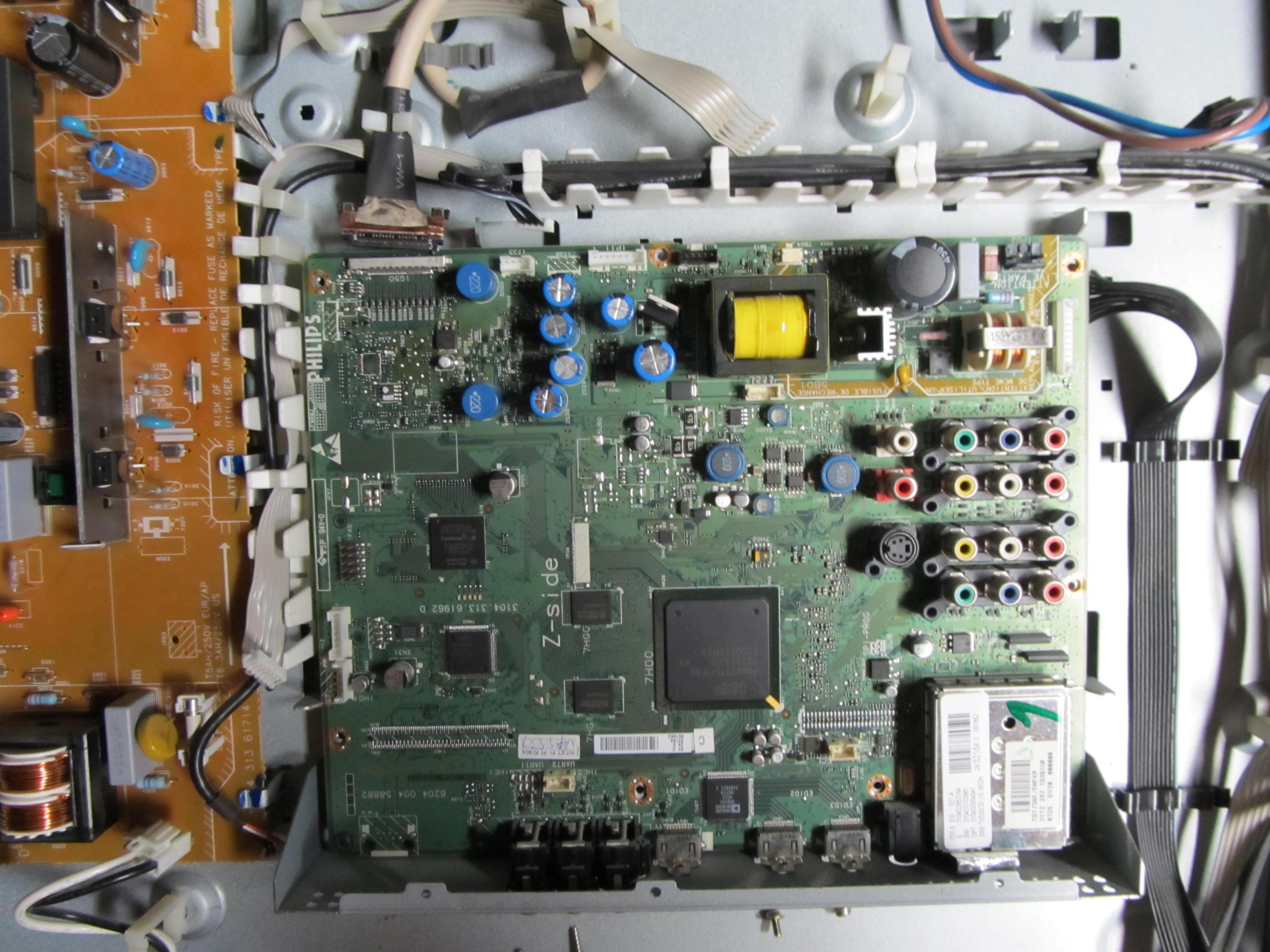

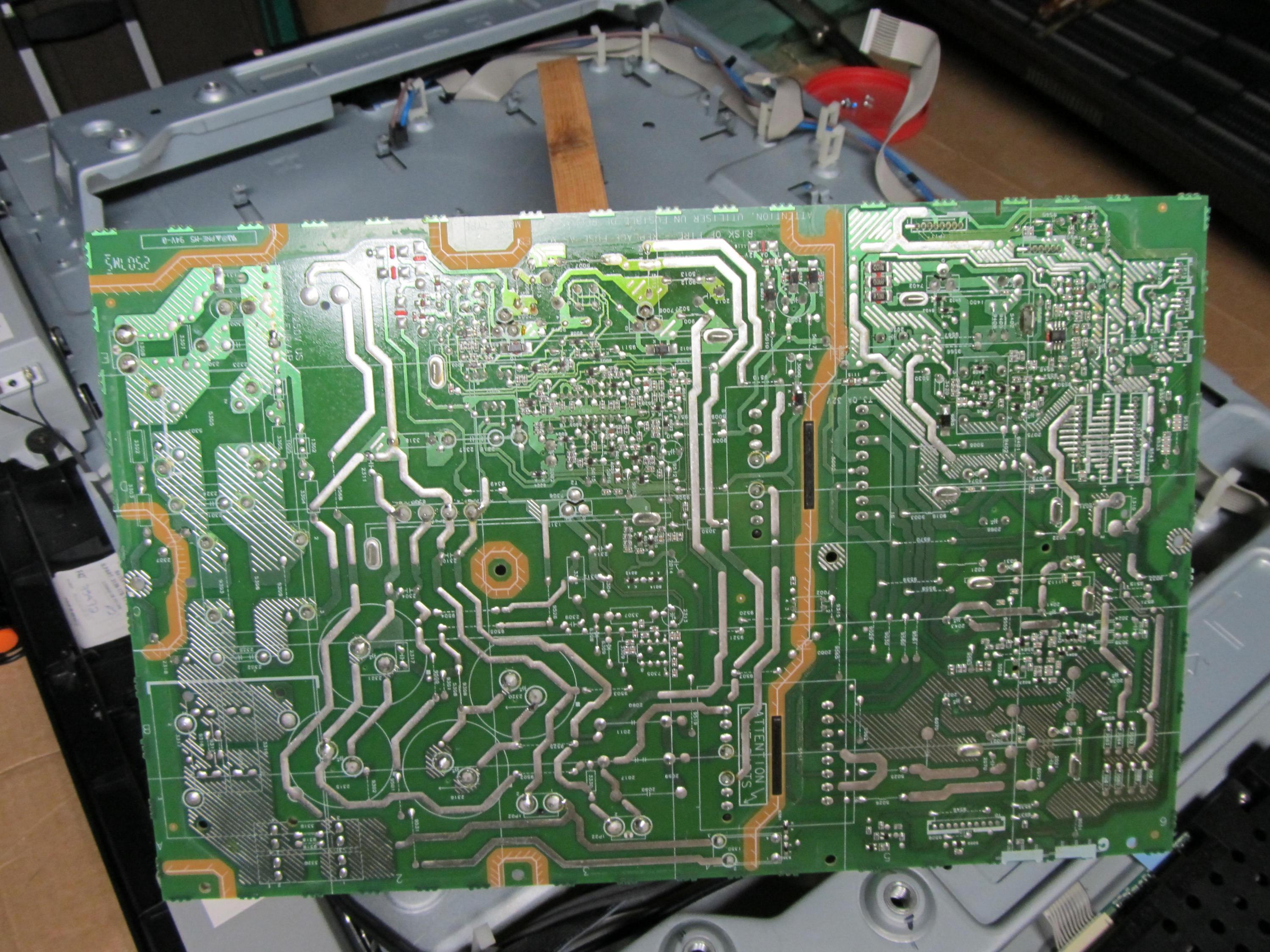

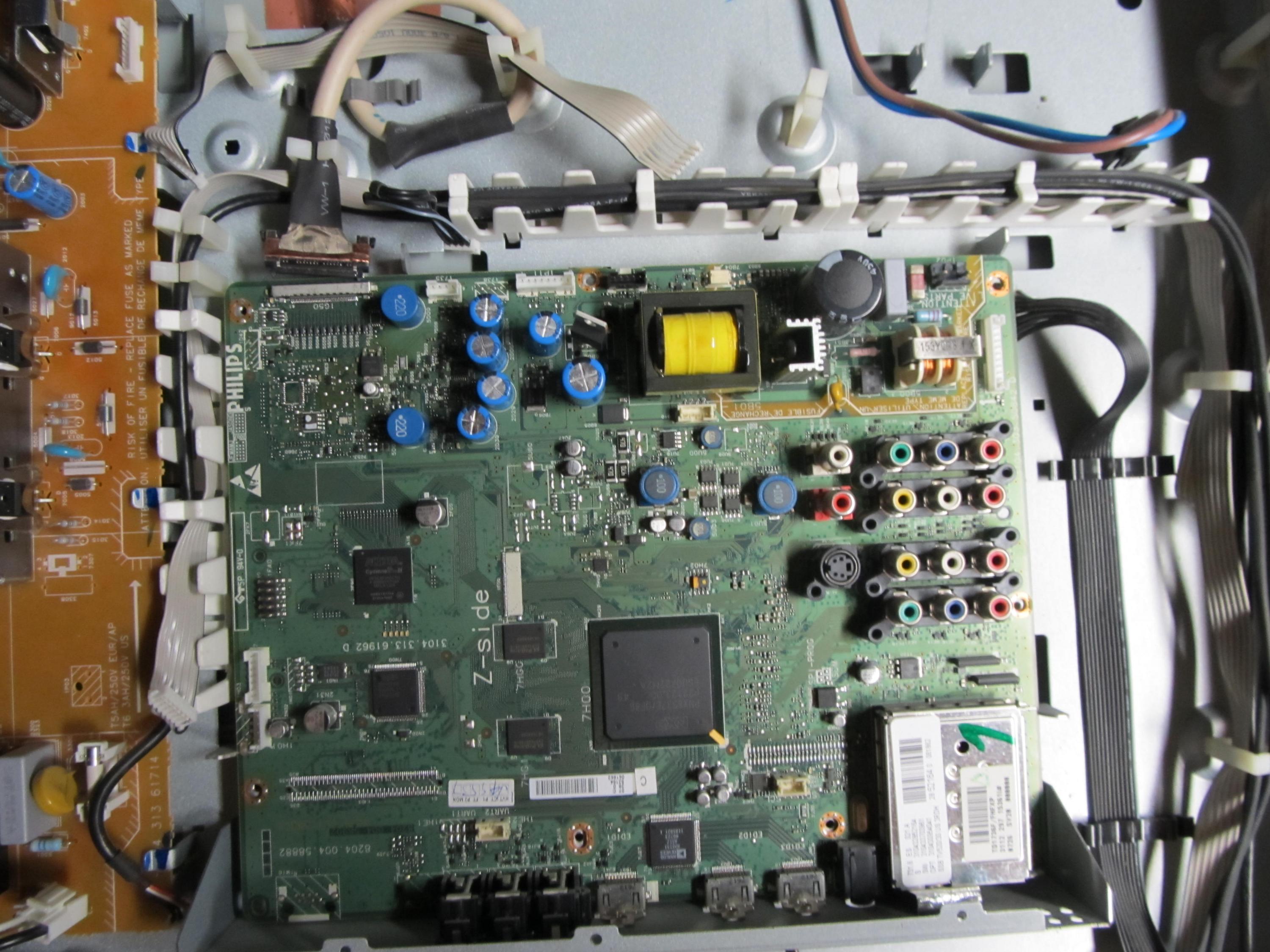

                  Seems like there were a lot of numbers on these boards: On the power board was 3104 303 50594 Then on a sticker was ES 730.3 002.C 0011407 and S310432848912 284912
                  Then on the main board: 3104.303.50842 D and 8204.004.58882 Hope these are what you need.
                  DISREGARD MY %6 post, I had a ribbon cable disconnected and did realize it at the time. My symptoms are still the same as in my first post.

                    OK,,,,,,here are the pictures of the back of the tv,,,,,,

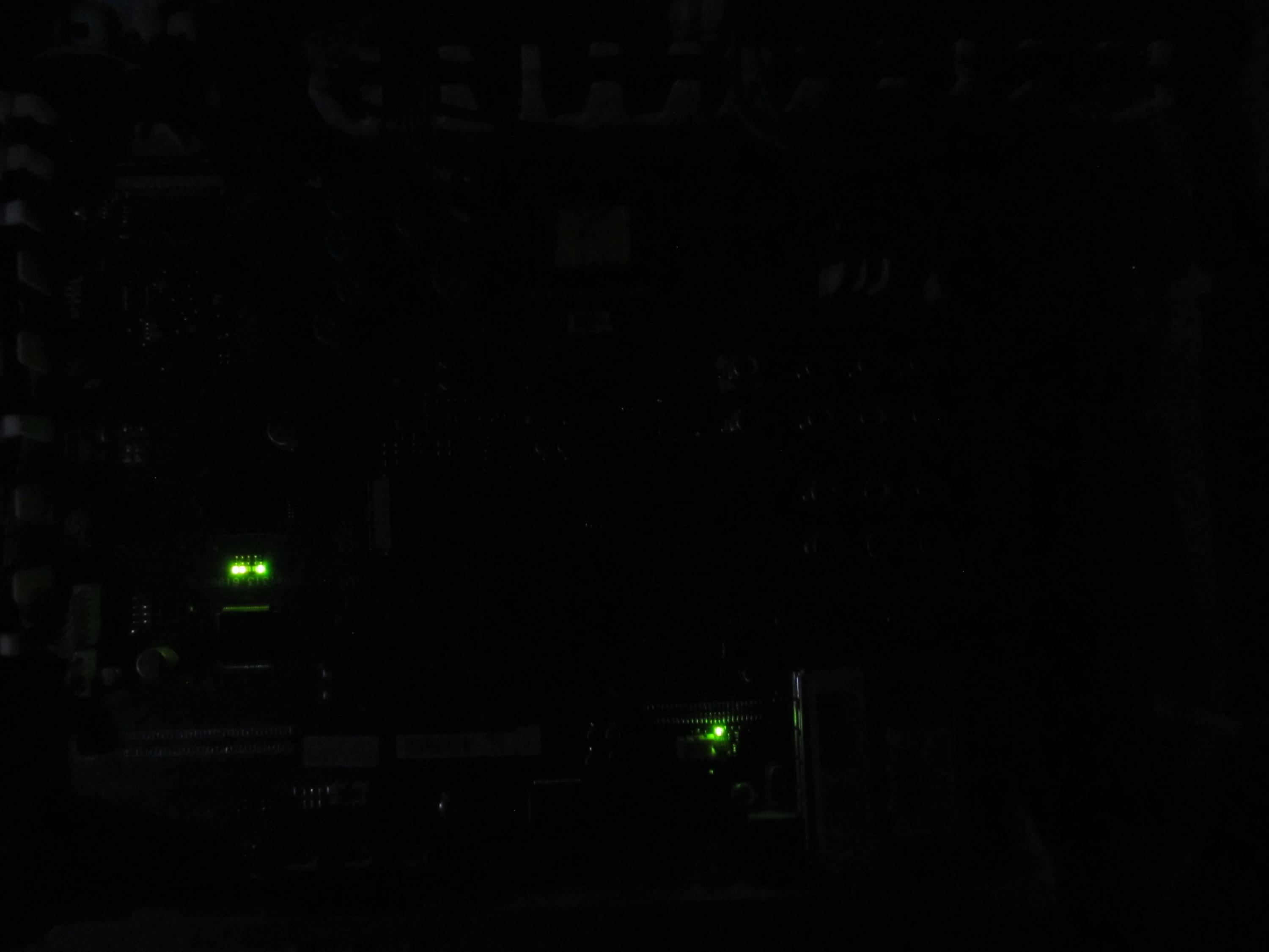

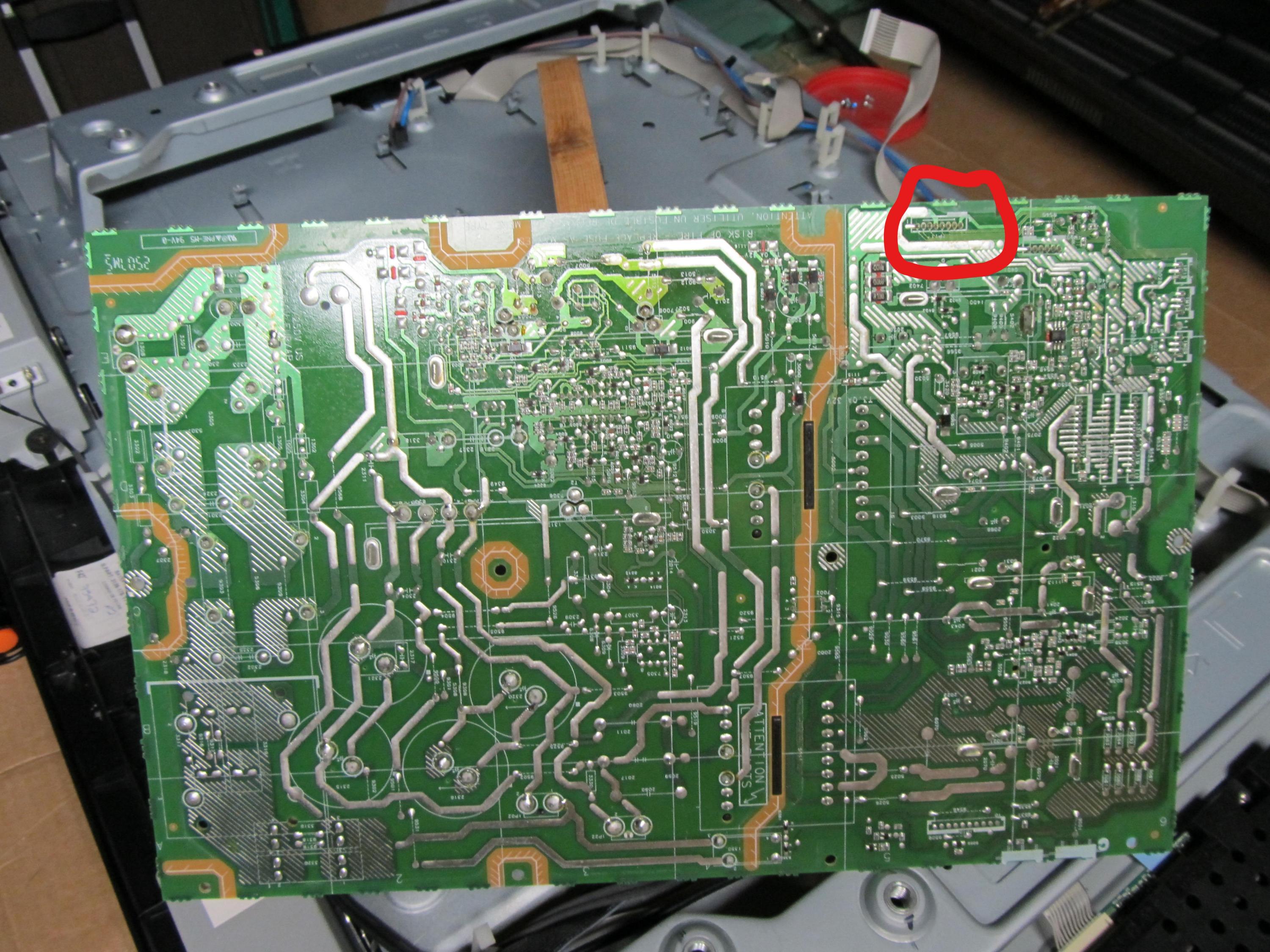

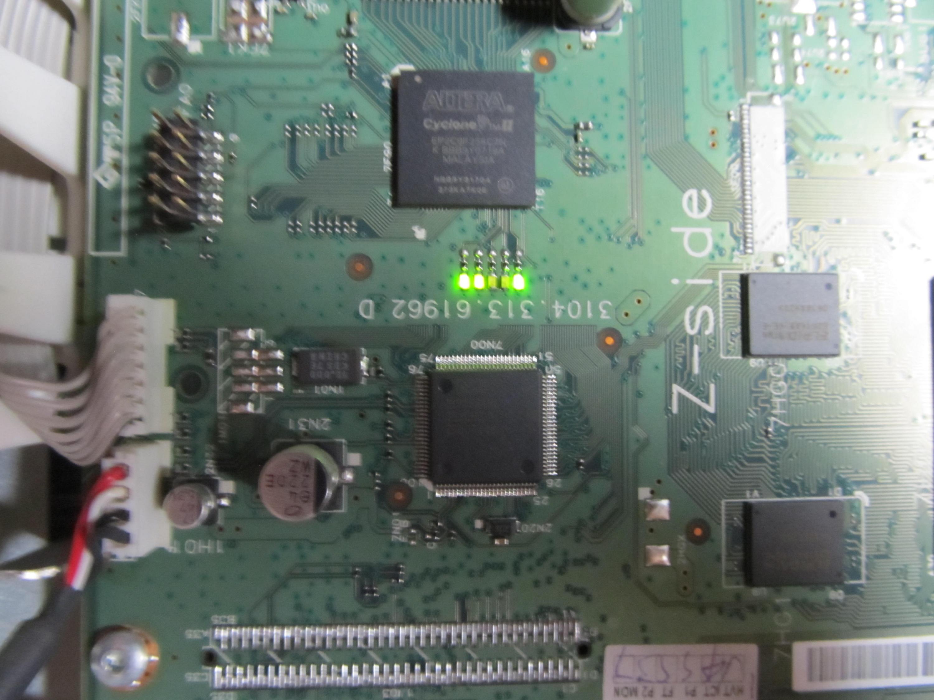

                      It seems that most of the pins on these boards are not labeled. I plugged it in,,,,,the green lights (standby voltage?) came on for a couple seconds,,,,,then went off. I measured the voltage on the ribbon that goes from power board to main board AT the edge of the power board.
                      Pin furthest to the left I'll call #8 on the pic of the top of the board,,,,,,#8 pin will be the furthest to right on the pic of bottom of the board.
                      #8 0 Voltage
                      #7 0
                      #6 0
                      #5 0
                      #4 0
                      #3 4.0 Volts
                      #2 5.0 Volts
                      #1 0.1 Volts

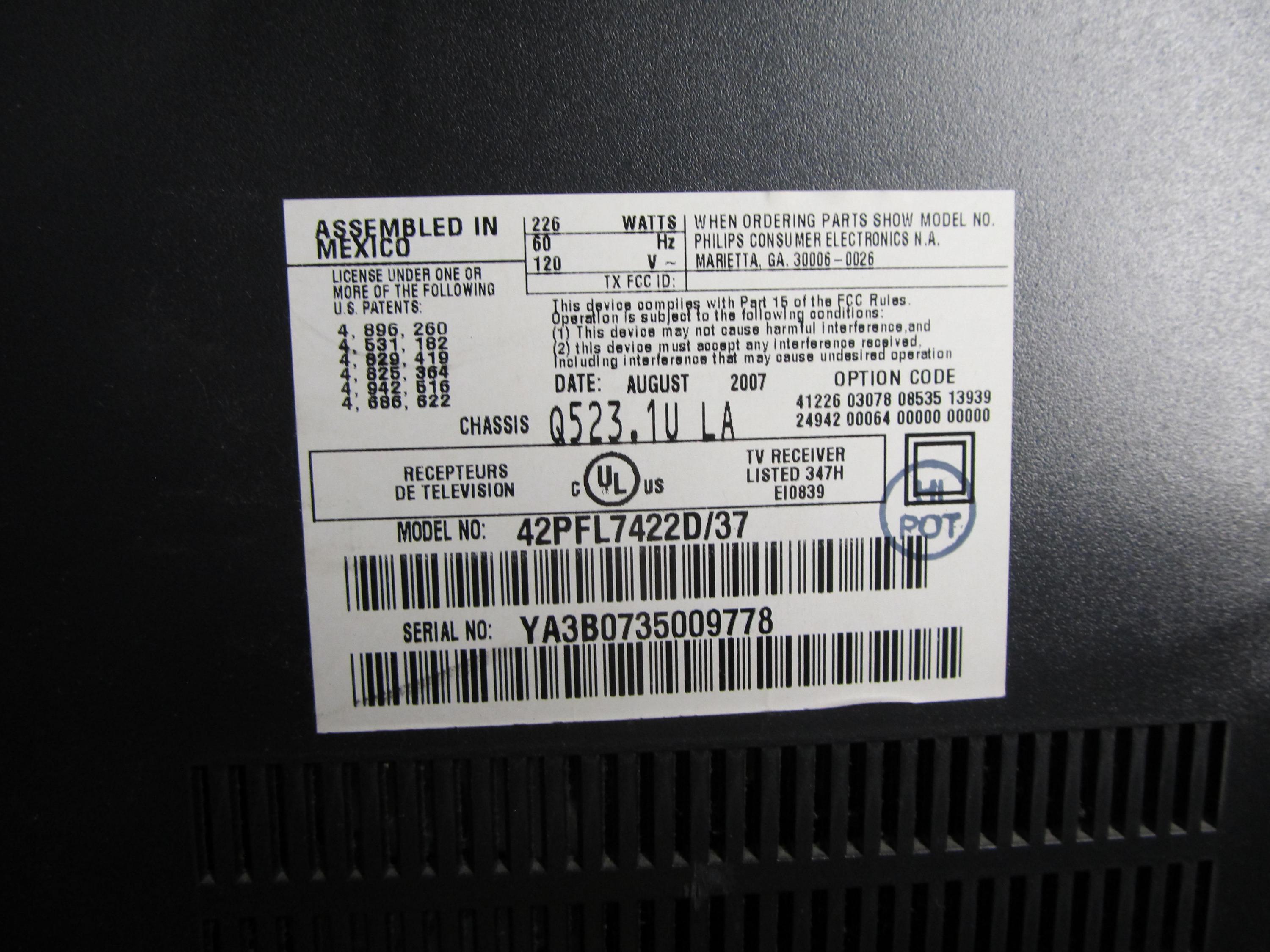

                        Can I see the model number sticker on the back of the TV? I need the chassis number on that sticker.
                          https://www.badcaps.net/forum/attach...3&d=1490296060
                          Check the resistance of the resistor R3318 which is right next to the gray rectangular cap, you also need t check the capacitance of that grey cap.

                            OK,,,,,,here's the sticker on the back.
                              You can test it without removing the resistor, that resistor usually goes open circuit when it is bad, it usually has the value between 47~150 Ohms.
                              The grey cap that the resistor is connected to usually lose its capacitance.

                                OK, so it is 42PFL7422D/37 chassis # Q523.1U LA.
                                I will see if they have the service manual at elektrotanya.com

                                  I think you were right about that resister. When I checked it on 200 ohm scale, it flashed a number, then went to the 1 at the left of the scale, indicating that it's open. I have a continuity checker that beeps. Touch the probes together, and it beeps,,,,,,,,put a probe on each end of the resistor,,,,,and nothing.
                                  Not sure on the capacitor. Put meter on the 2000k scale and it started out at about 800, and slowly the numbers continued going up.

                                    Can you read the resistance as printed on that resistor?
                                    To check the capacitor you will need to check the capacitance, I do not know if your DMM can do capacitance reading or not.
                                      OK, R3318 per Q523.1U LA chassis, it is supposed to be 470 Ohms.
