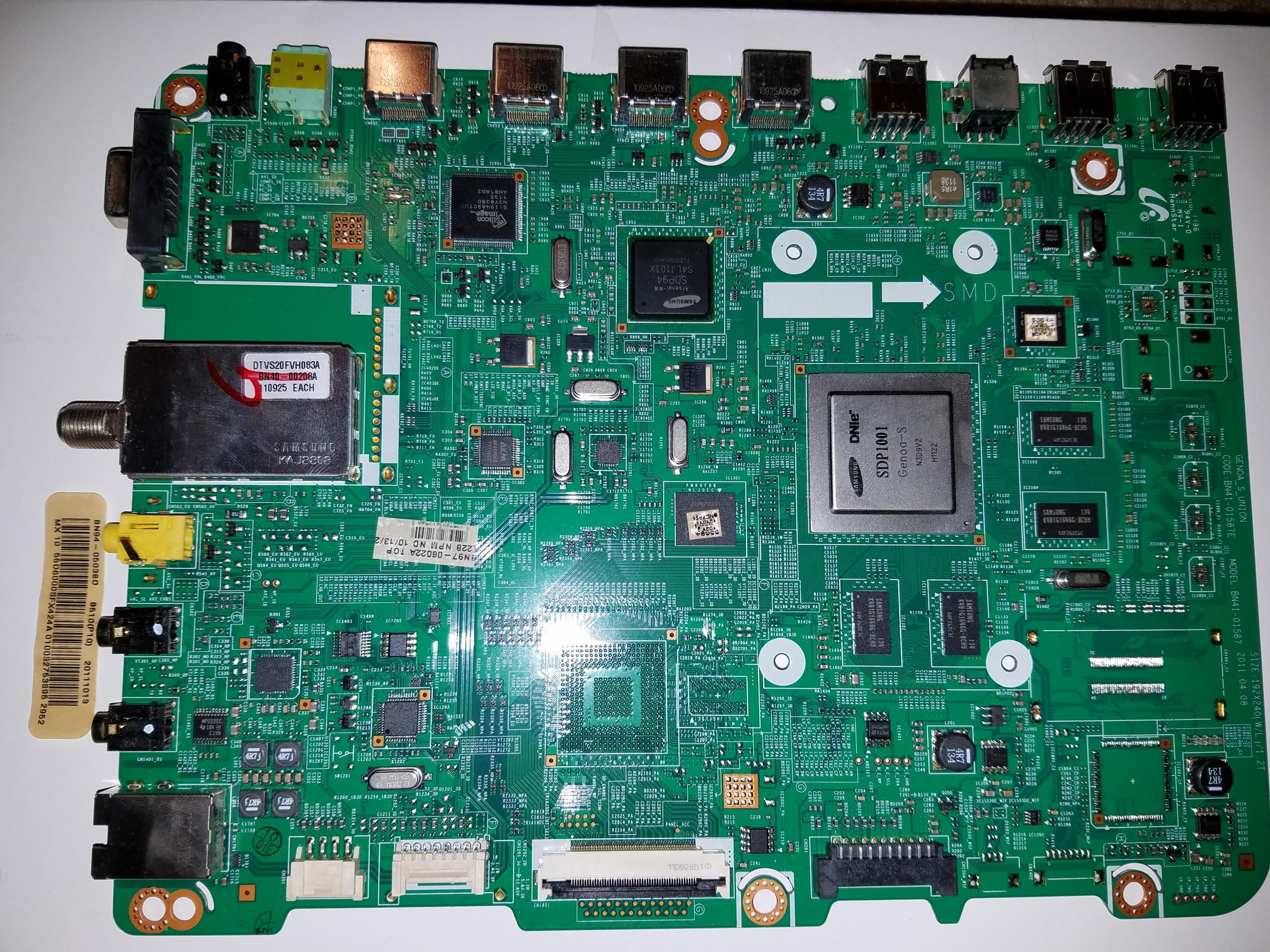

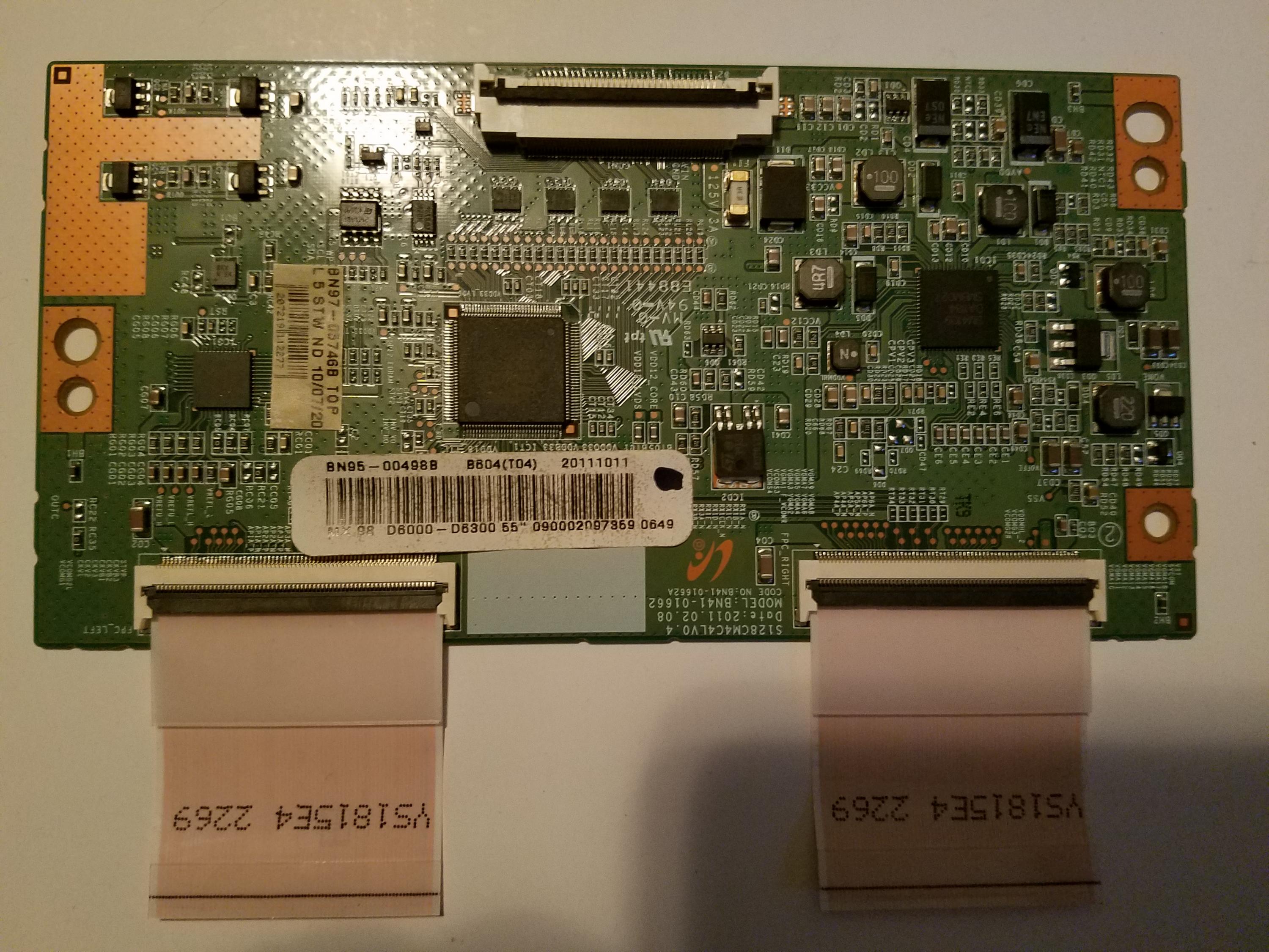

    There are only three boards inside this set.
    * Power Supply

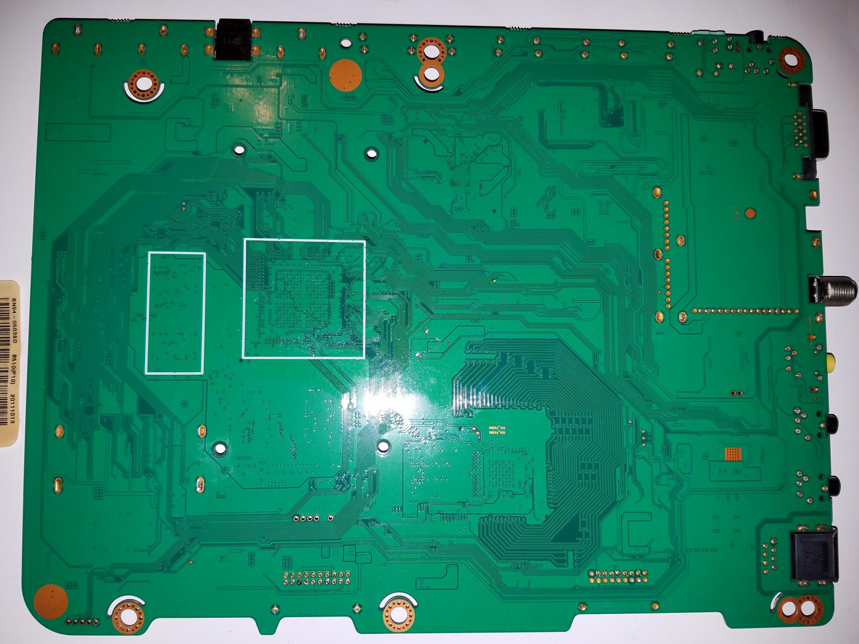

    * Main Board - Sticker on board says P/N BN94-05038D. Other numbers on board: BN97-06022A, BN41-01587
    * TCON

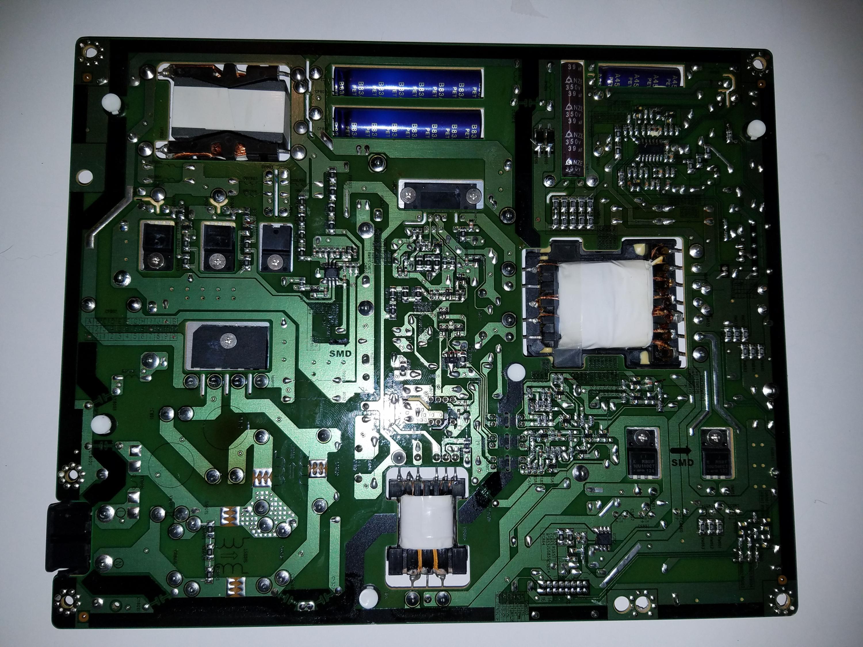

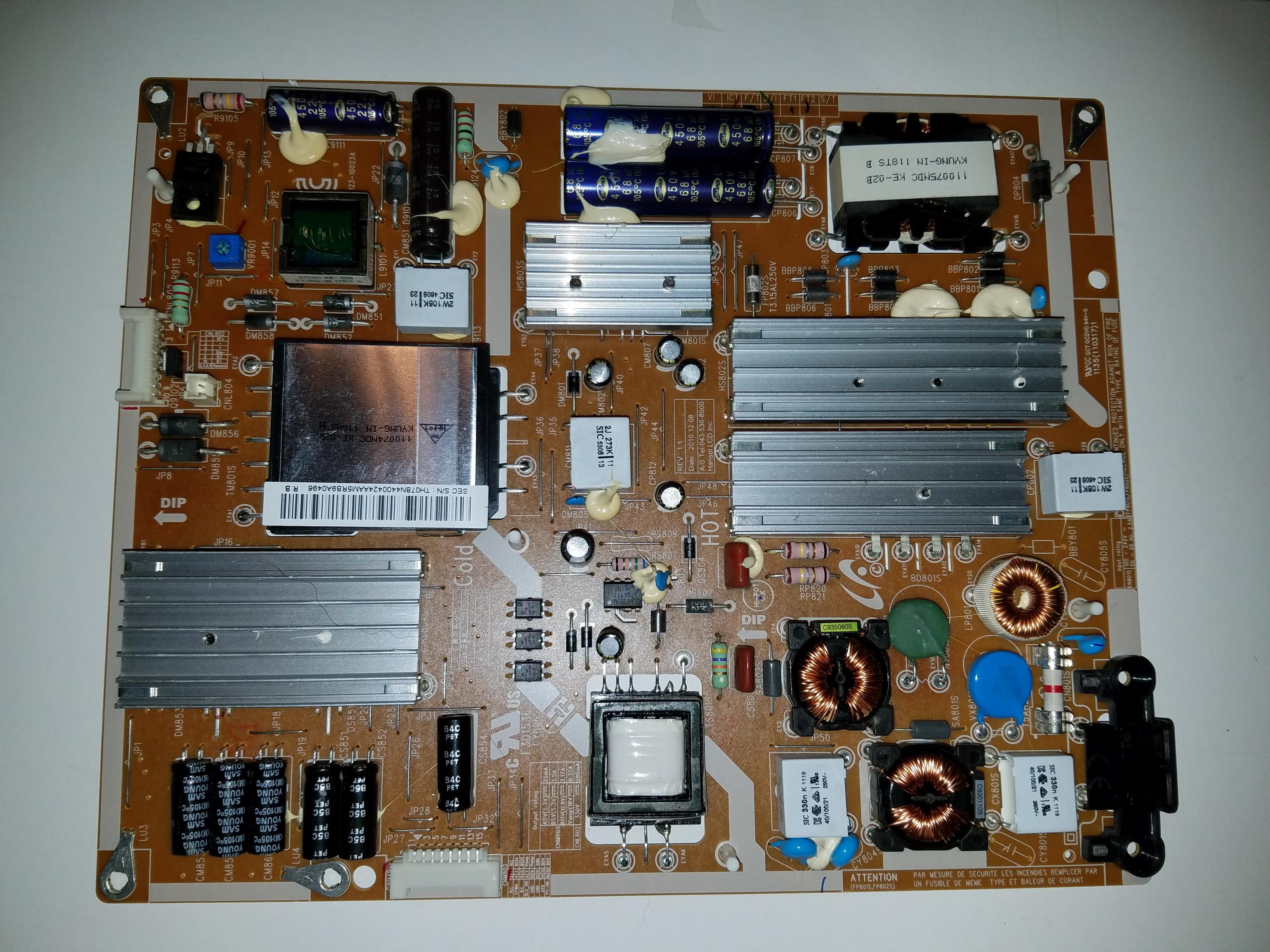

      We need good clear pictures of the whole back side of the TV showing all the boads, then we need to test Voltages at the connectors of the power supply board.
      Power supply board is BN44-?????

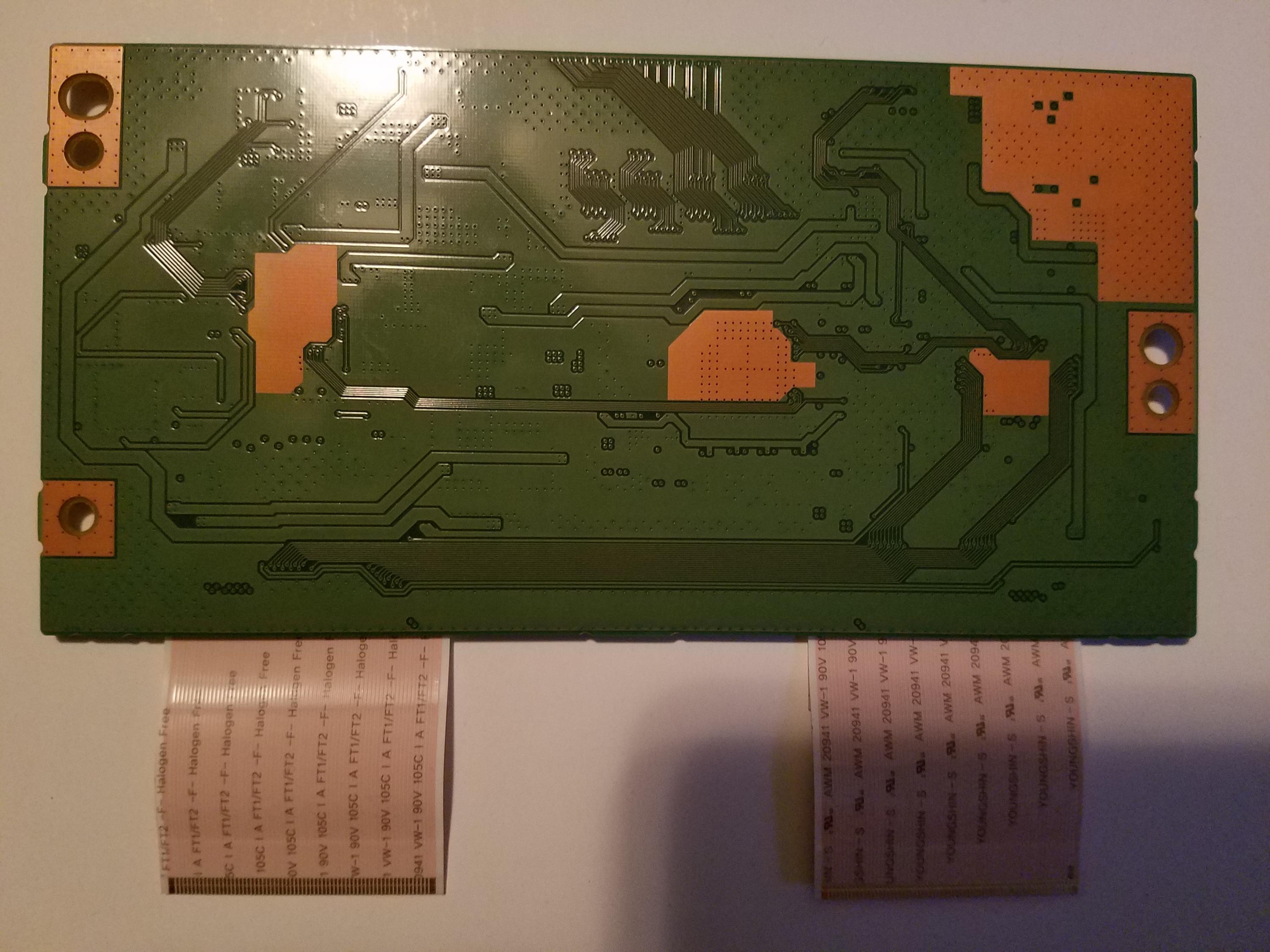

        Thanks for the replies. I have attached pictures (front and back) of all three boards.
        Power supply board is P/N - BN44-00424A

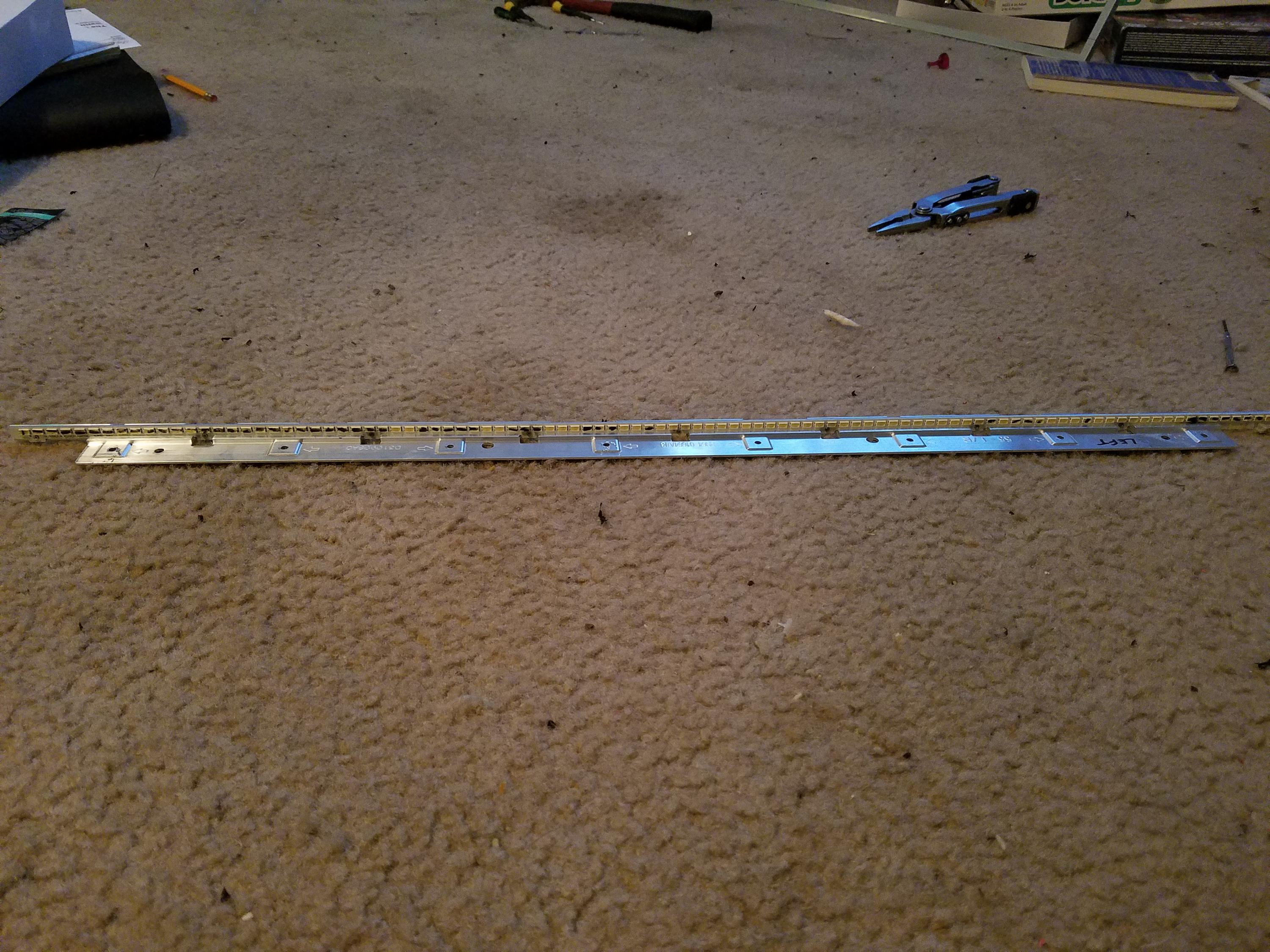

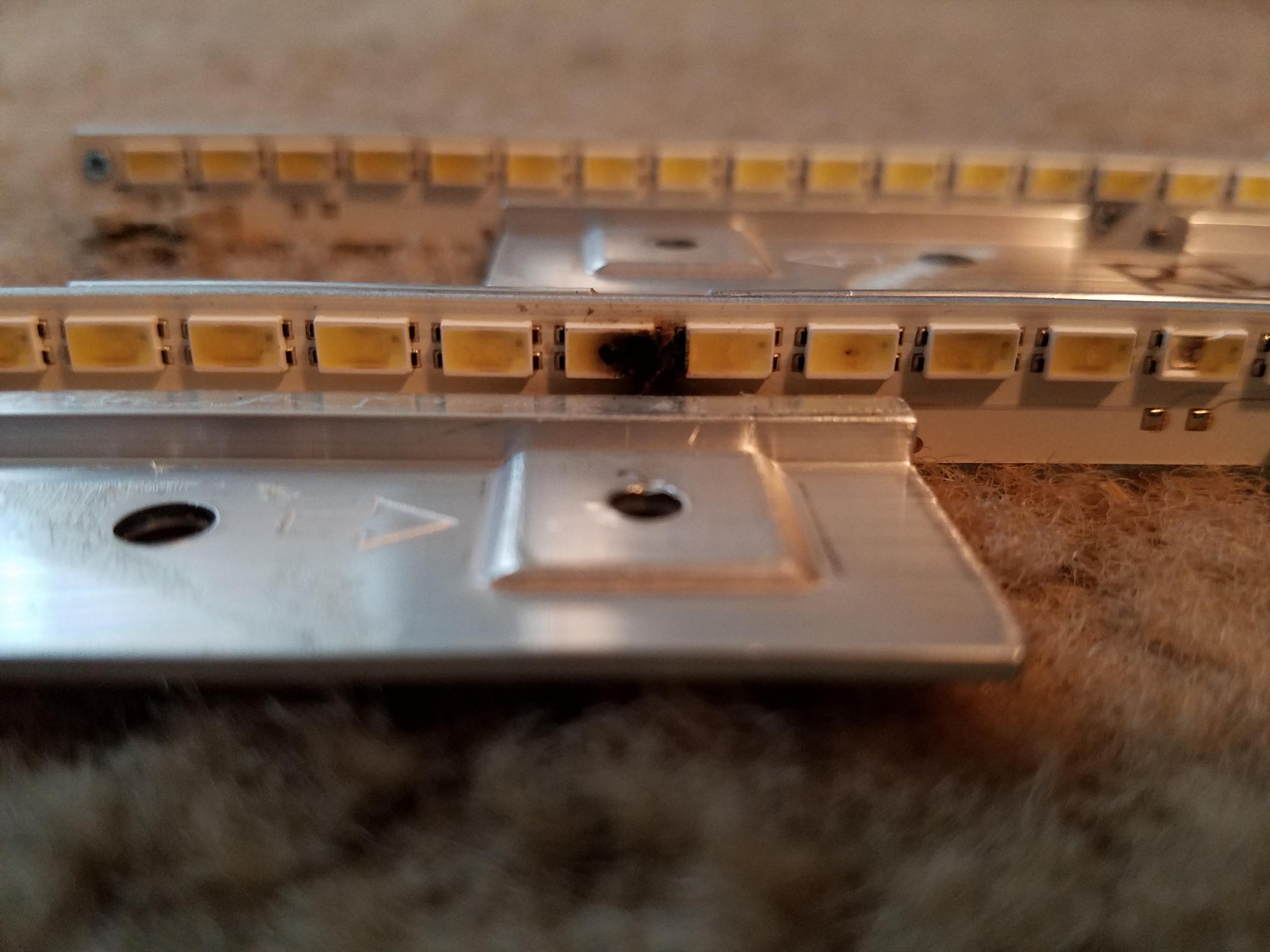

          On a whim, and diagnoses of other threads, I decided to open the LCD panel to look at the LED backlights.
          I havent tested them individually yet, but there are obviously a few bad LEDS.
          • dick_barton
            • Aug 2015
            • 6643
            • Wales
            Re: Samsung UN55D6000FXZA - Power light flashing, backlight for a moment
            Is that a crack through diode D9101 on the power supply?
            Definitely some burnt up leds needing to be replaced
              No sir, not a crack - simply a line of blue ink. Most of the diodes seem to have a blue mark on them.

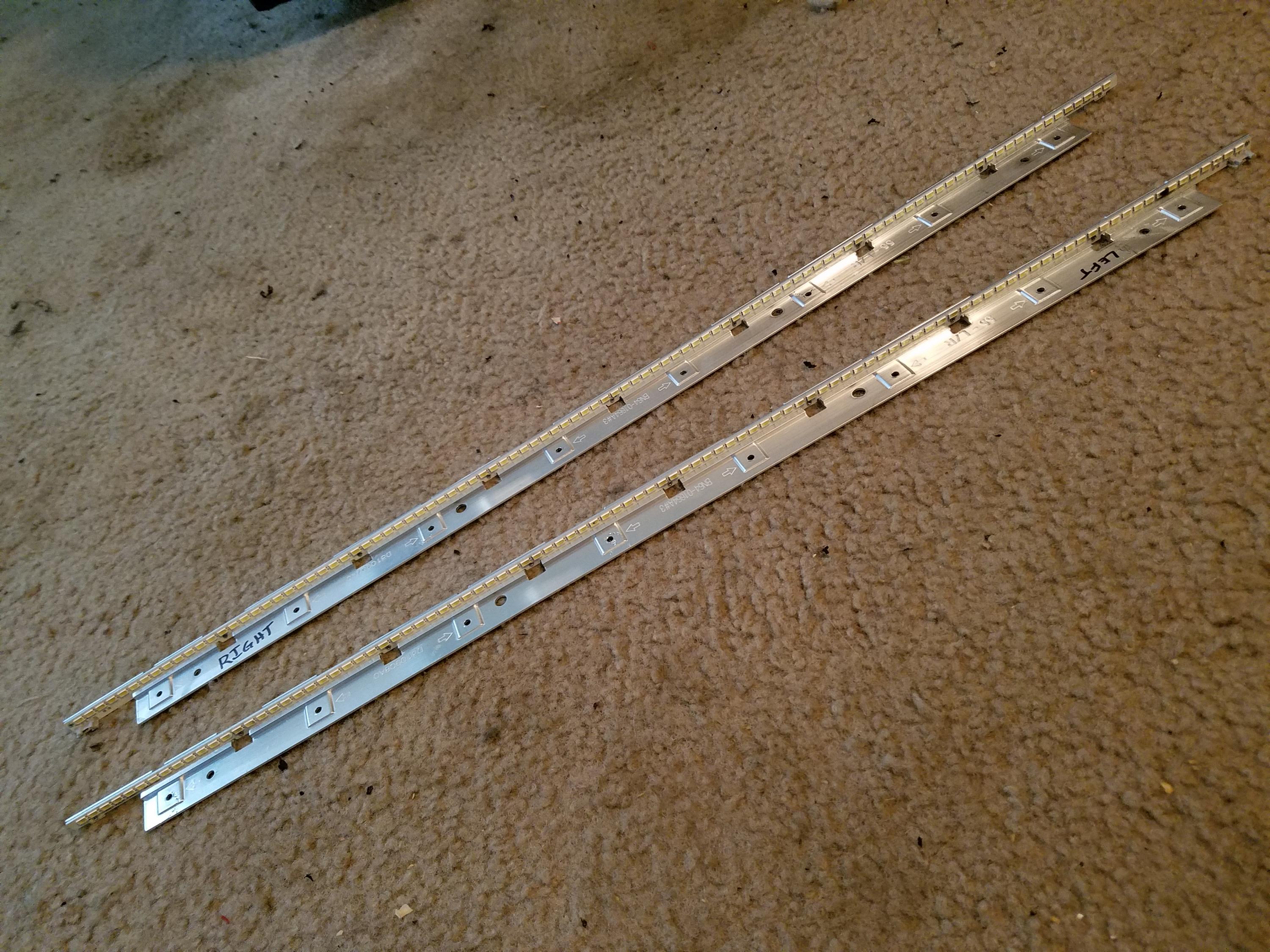

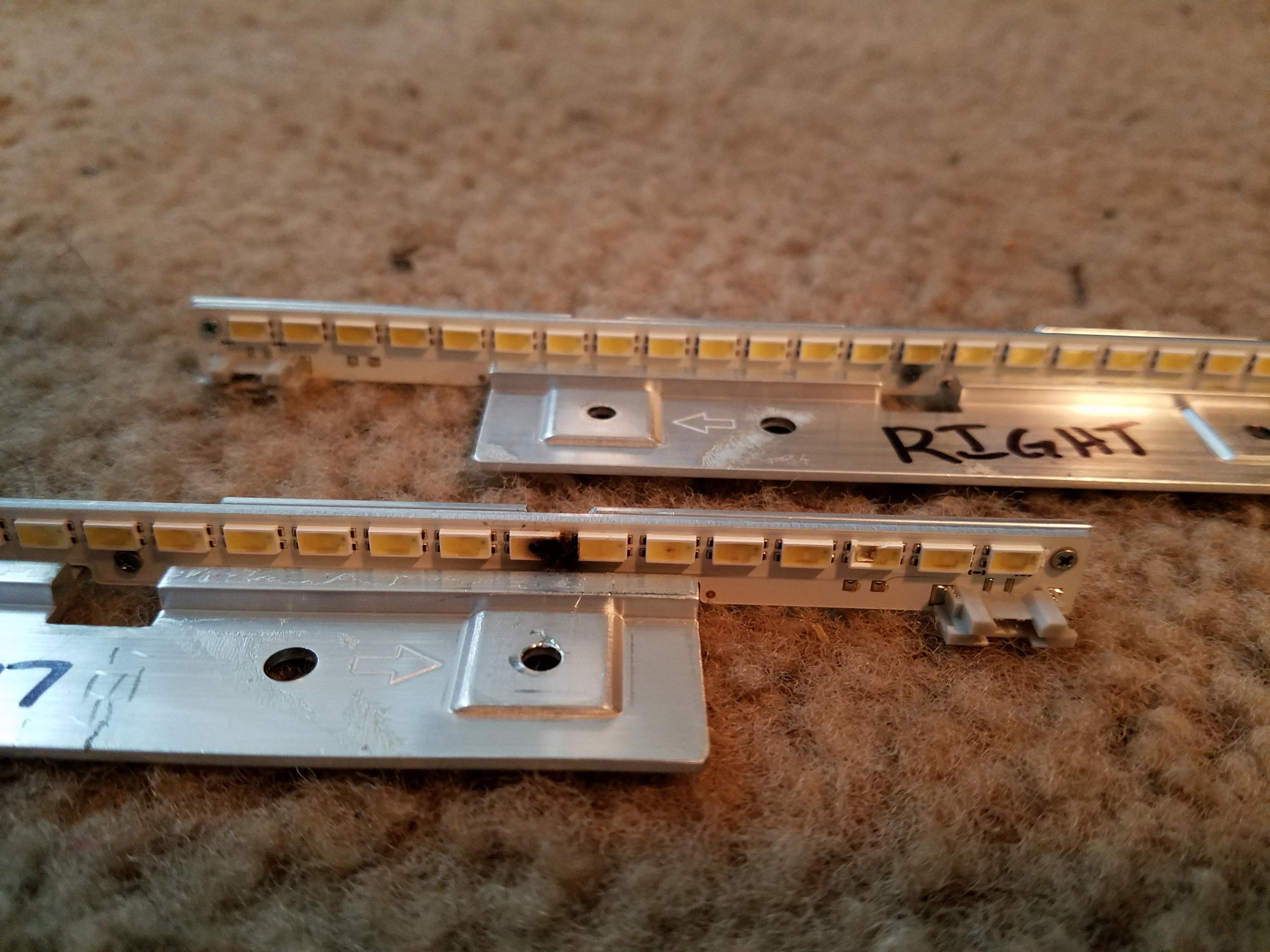

                    I just tested all the LEDs on both strips individually.
                    All of the LEDs on the "Left" Strip are fine.
                    More than half of the LEDs on the "Right" Strip do not light.
                    I've marked the bad ones with a black sharpie.
                    Do you guys think the LED themselves are bad, or should I suspect the PSU overdriving the current for the LEDs on that side?

                      Replace the strip Turn your backlights as low as possible. Update your firmware. Don't break your panel and you should be alright.
                        I apologize profusely for the delay. I was browsing a new issue and noticed I never closed the thread.
                        After finally sourcing replacement LED strip for left and right, this set powered on and worked normally.
