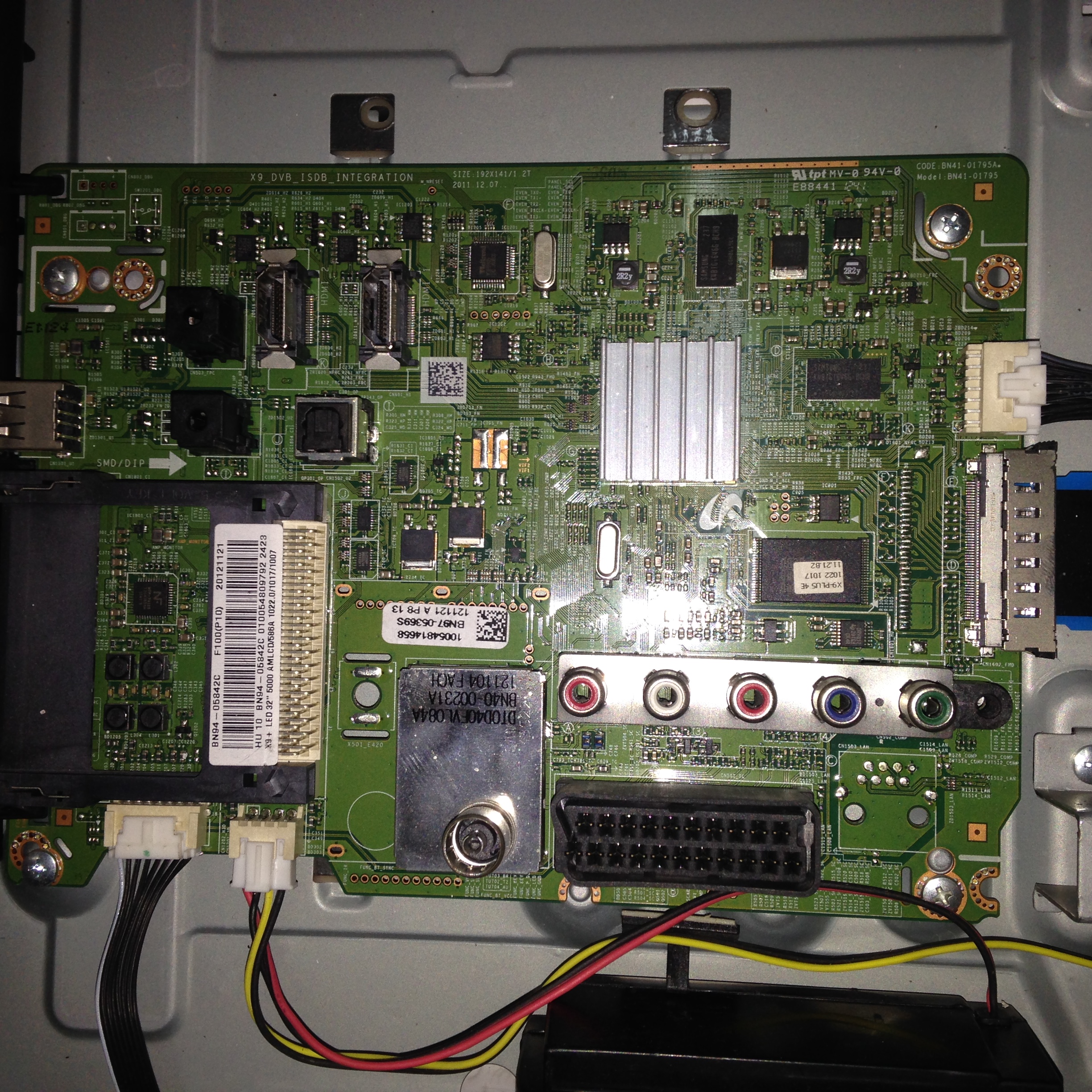

    SAMSUNG UE324H5000WWZF VER N° :02
    MAIN BN41-01795A
    PSU BN44-00493B
    pwm IC 2S110
    INVERTER PFFF may be SLK2012M
    SCREEN LTJ320HN07-V
    T-CON BN41-01797A

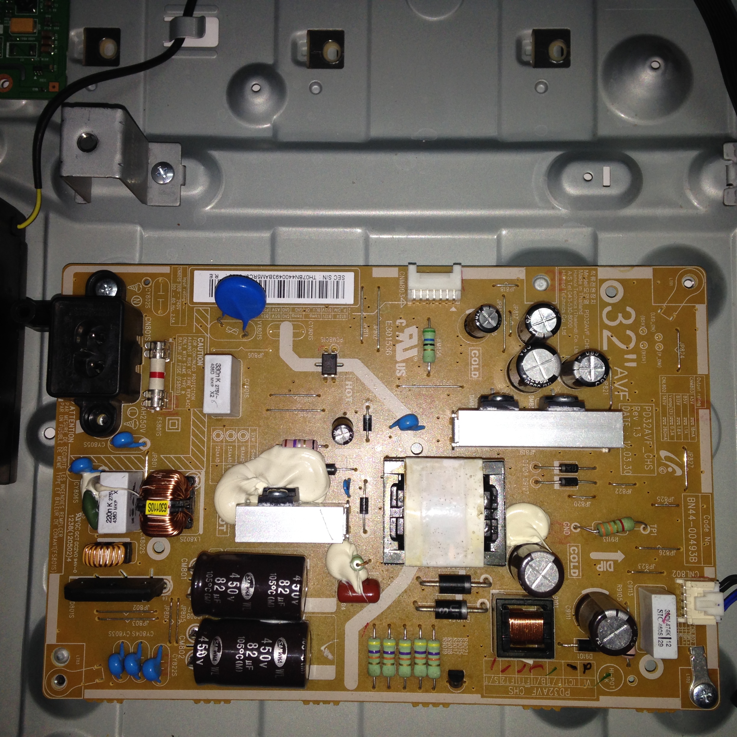

    MA IN CAPACITOR CM 801 802 292V
    CM806 15V

      Re: Samsung ue324h5000w no backlight
      Main cap voltage looks about 100v low
        i think main cap is norm because there is no PFC
        PS ON LOOK IN NORM THERE IS IMAGE BUT NO BACKLIGHT

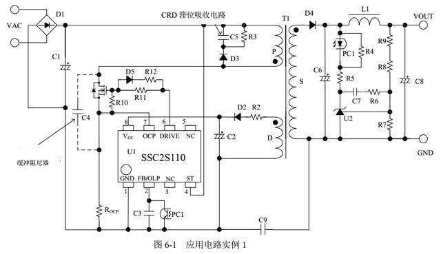

          Do you have a schematic?
          What DC voltage do you have between pins 1 and 8 of the 2S110

                  with unit t multimeter ut-61b
                  vcc 1-->8 ---------------15 V
                  1---7-----------------
                  1---6-----------------
                  1---5-----------------
                  1---4----------------285V
                  1---2----------------1.2 V

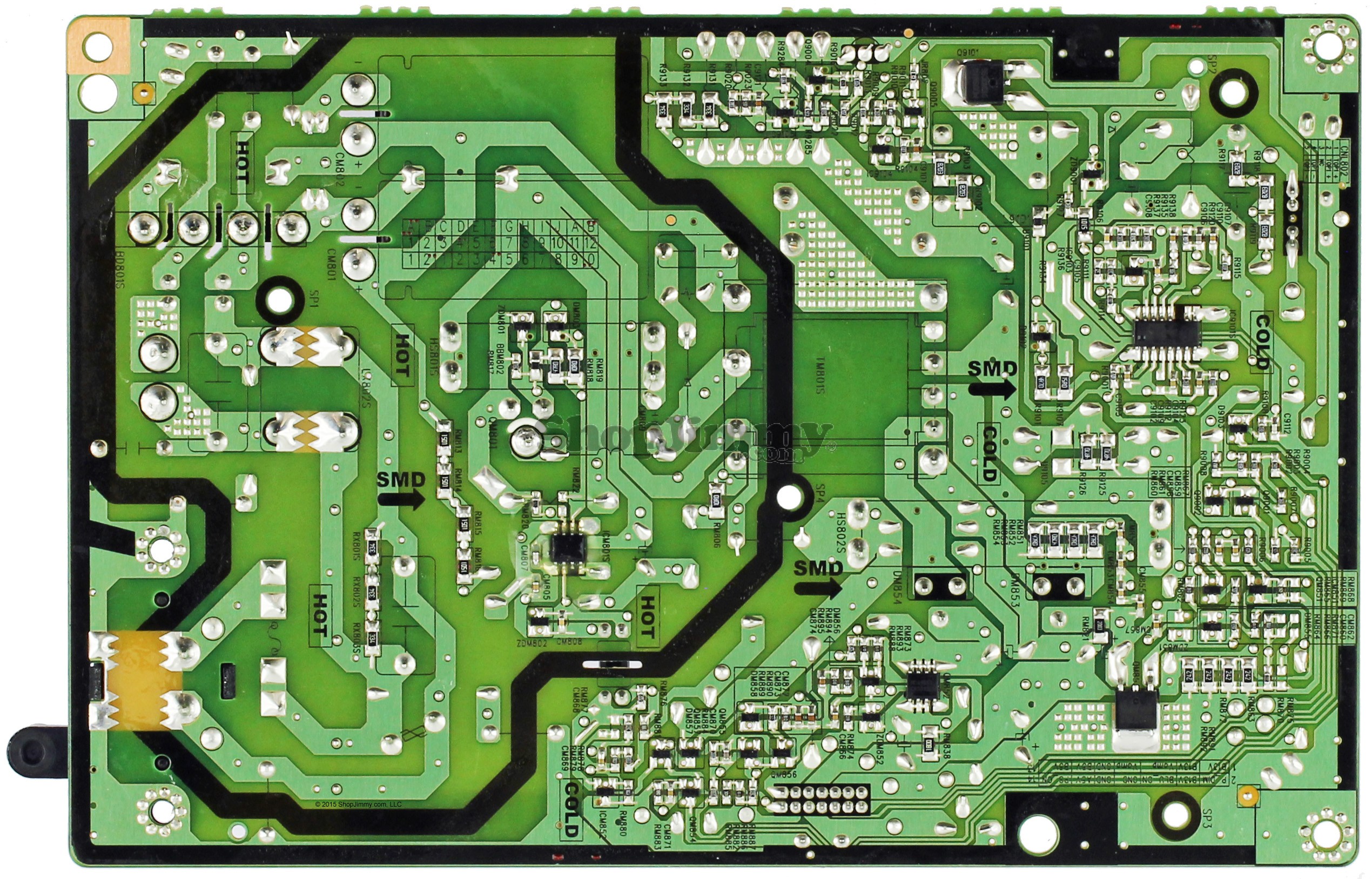

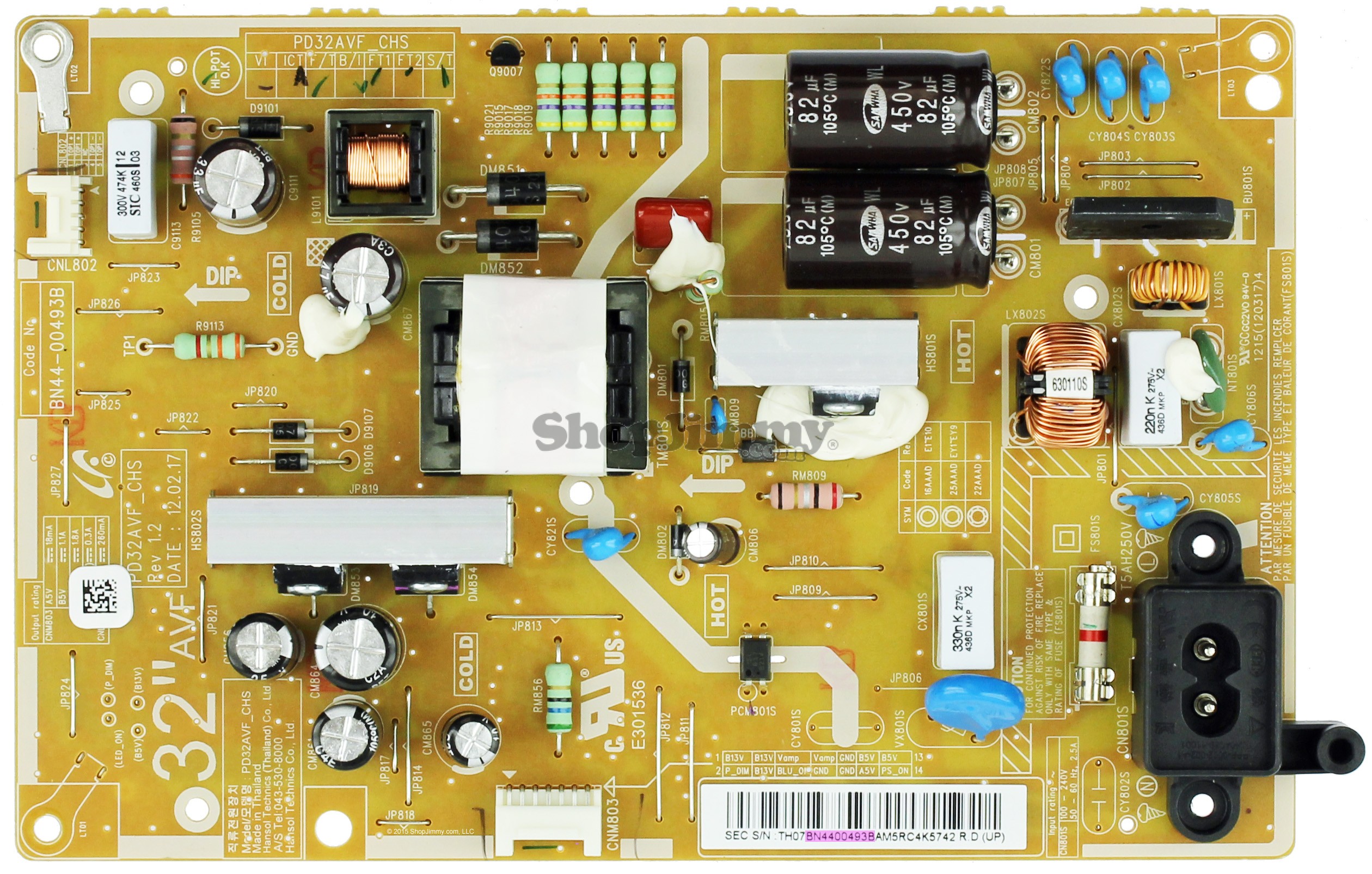

                                Pictures provided by shopjimmy.
