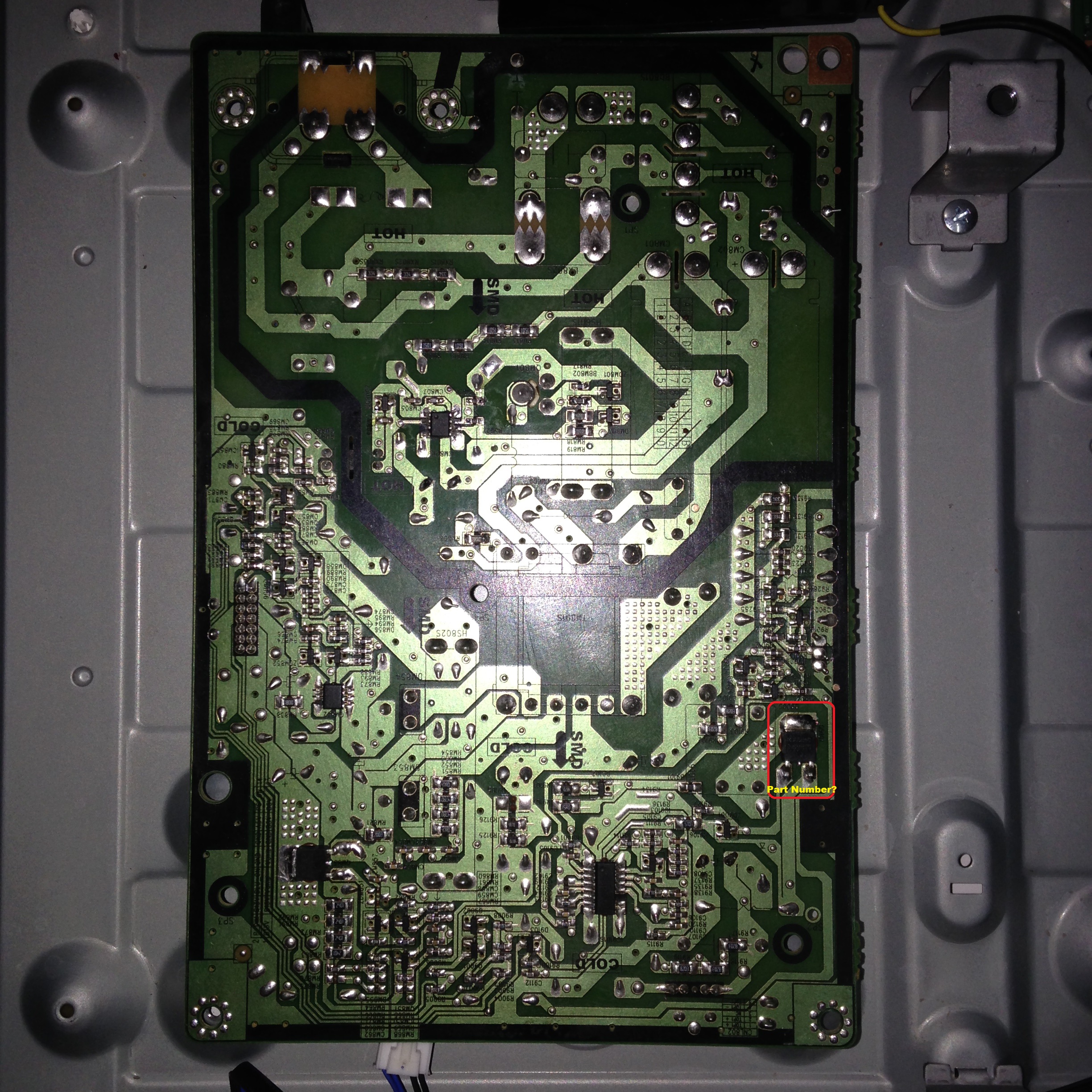

                  Re: Samsung ue324h5000w no backlight

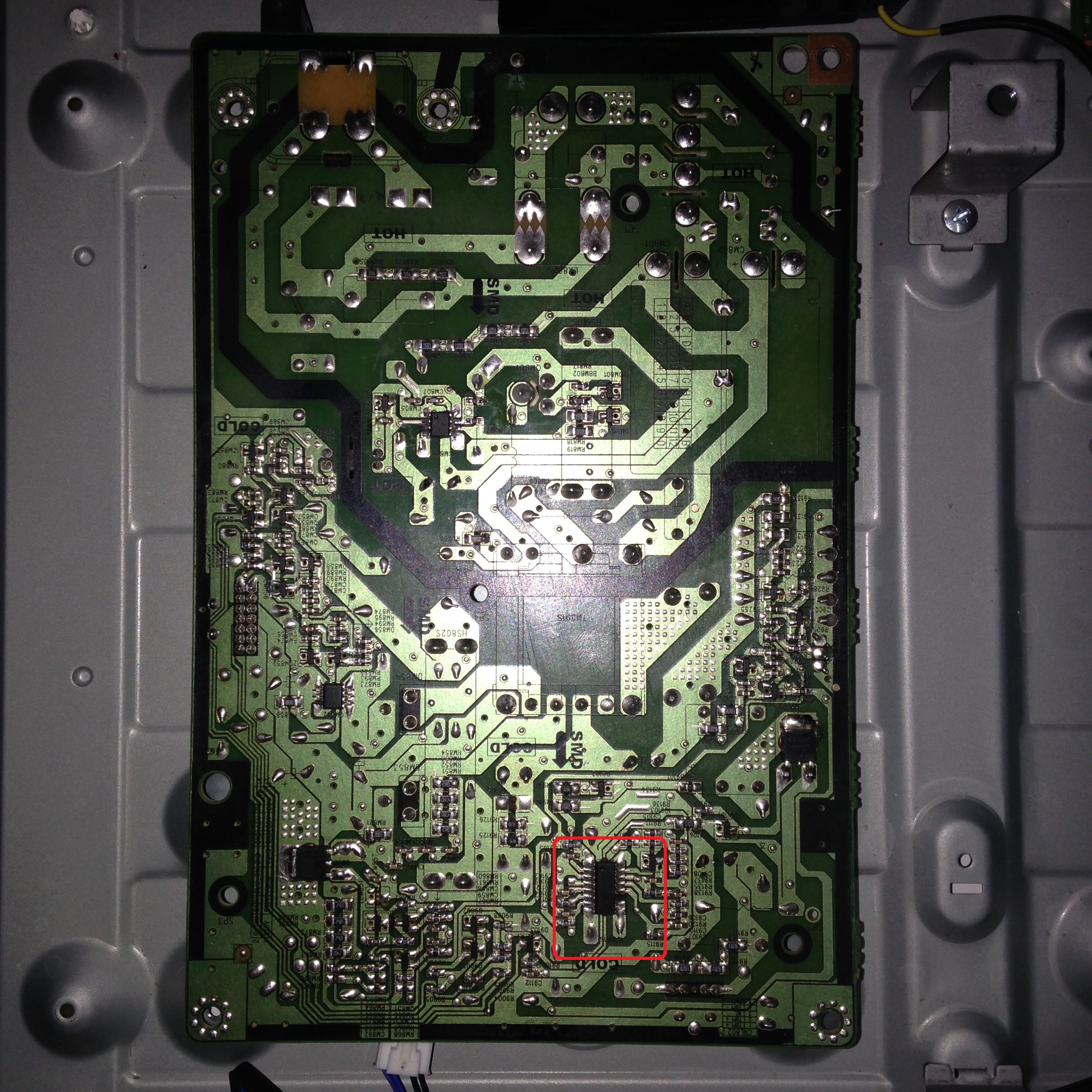

                  What's the IC part number as printed on it.
                    #29
                    may be SLK2012M IM NOT SURE I CANT READ
                      #30
                      Cannot find anything on that number but could find SLC2012M listed as a power supply drive control IC
                        #31

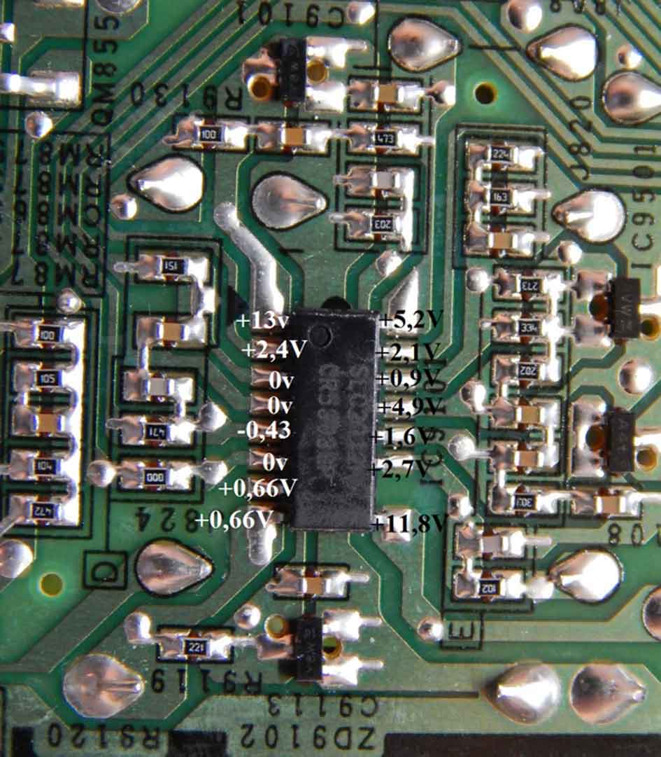

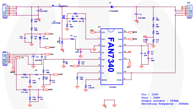

                        The IC looks very much like a FAN7340 in layout. Can you measure very carefully what DC voltages you have on the pins 1 - 16 with the black meter lead connected to pin 3.
                        http://pdf1.alldatasheet.com/datashe...D/FAN7340.html
                          What's the part number and what voltages do you have on the 3 pins?
                            #33
                            Gnd is 4 leg
                            1. 12 .8 v
                            2. 105 mv
                            3. 105 mv
                            4. Gnd
                            5. 4 .8 v
                            6. 120 mv
                            7. 86 mv
                            8. 105 mv
                            9. ~4 v
                            10. 3.5 v
                            11. Nc
                            12. 100 mv
                            13. 105 mv
                            14. 93 mv
                            15. 0.77 v
                            16. 87 mv
                              #34
                                MDD5N40 N-Channel MOSFET
                                D 124V
                                G 0V
                                S 0V
                                  Here's a Samsung model using the same LED driver giving voltages.
                                  So you have your 120V for driving the leds. What voltage on pin 11? It's pin 10 that's NC.
                                  Looking like the led driver is faulty since there does not appear to be any drive voltage to the mosfet.
                                    Just taken another look at the information you provided.
                                    If the drain of the mosfet is at 124V then that should pass through a diode and arrive at CNL802.
                                    Can you confirm the 124V is on pins "Top1-"
                                      BIG THANKS TO dick_barton
                                      After changing SLC2012M the backlight is coming
