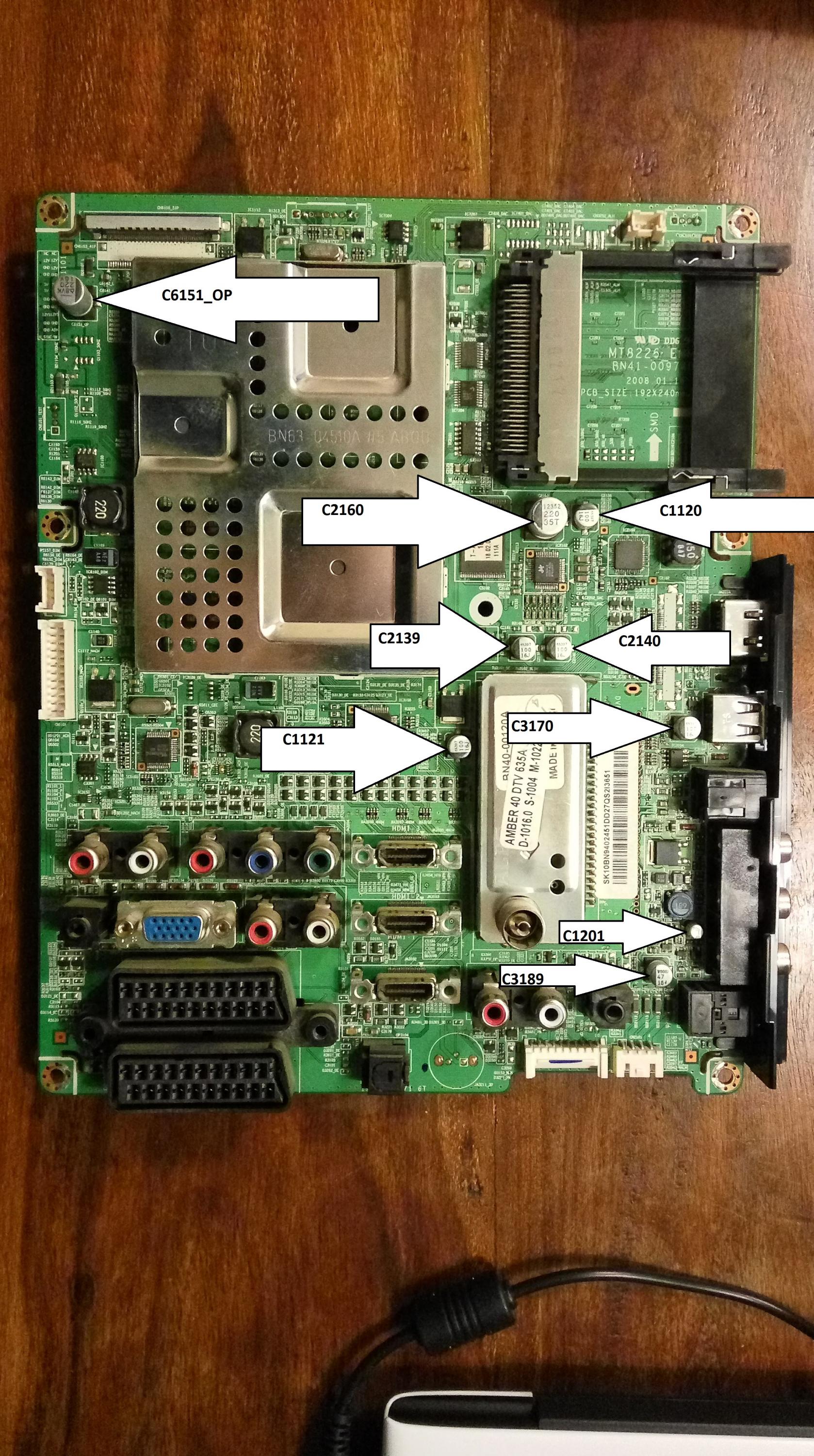

    I have Samsung LE40A656 lcd tv from 2009 with no picture or sound.
    When I switch it on with the rc, the power led blinks a few times and then the cool fan for the Tcon comes on. But there is no picture or sound.
    When I push on "on" the tv starts direct but I have to push on "off" several times to get it off. I can switch the tv on with te touch button on the bezel but not off. When I turn it on, I also hear a startup sound from the speaker.
    Sometimes the cool fan stops for a few seconds and then starts again. I don't now why that is, I dont think it is mechanical, the time is to short to measure the voltage on the fan.
    A few years ago I already replaced 4 caps on the power'supply because sometimes it would turn on. Now I replaced all te caps on the power supply, but no change. (exept the two high voltage caps)
    I measured the voltages on the power supply and I think they are okay but a little bit low. Is that a problem?
    I can force the backlight on with some pull up resistors and the mainboard disconnected. So I think the lamps are ok.
    I also checked the voltage regulators on the mainboard and they are okay.
    Because of the strange behaviore of the mainboard I think I replace the mainboard but I am not sure.
    Can someone help me to identify the problem?

    Re: No picture and sound Samsung LCD LE40A656A1FXXU
    Hi, that mainboard suffer from a well known fault, are those 4 EL.CO. 1000uF10v, 2 near, 2 under the metal shield, change them with good quality SMD caps, fo example
    Panasonic EEEFC1A102P, it's not an easy task, stay careful with the path that come away if prolonged heat is applied..
    first, if you want, try to heat them with hairdryer then switch on, if it starts ok, the are them...
      Hi Davi.P
      The elco's you mentioned are not on my mainboard. see the listing.
      Mainboard SK10BN9402451DD27QS213651 (BN41-00974B)
      C1120 100 16J measured in circuit 167.1mf 0.14kohm ESR ??
      C1121 100 16J measured in circuit 96.7mf 0.14kohm ESR ??
      C1201 strange mesurement ??
      C2139 100 16J measured in circuit 98.68mf 1.5ohm ESR
      C2140 100 16J measured in circuit 100.8mf 1.4ohm ESR
      C2160 220 35T measured in circuit 224.3mf 0.4ohm ESR
      C3170 100 16J measured in circuit 105.8mf 1.1ohm ESR
      C3189 47 16J measured in circuit 56.63mf 0.9ohm ESR
      C6151_op 220 16V measured in circuit 226.8mf 0.69ohm ESR
      I did not do the heattest yet.
      • Joop
        • Jan 2017
        • 23
        • Nederland
        Here's a photo of my mainboard.
        Any suggestions?
          "A few years ago I already replaced 4 caps on the power'supply because sometimes it would turn on"
          not so good to replace only few, in theese brands when you have the chance to open it up replace always all the caps with good brand, if them has at least 5 years, not so easy to find the big ones, but at least change the low voltage ones...
          "I measured the voltages on the power supply and I think they are okay but a little bit low. Is that a problem?"
          surely not...
          i'm sorry i had wathced only a little picture before make my suggestion of the 1000uf caps, this one is an implemented version of the older Bordeaux plus..
          is not a cap problem now, but i think it was, and them had damaged something on the mainboard, more probably, it's not easy to troubleshoot a ma.bo., one can only trace lvds data to tcon i think, with oscilloscope, the best way is find another screen even cracked, not too much, to test a little the signal, is possible a tcon damage also..
          do you have tested only linear regulators on ma.bo.? switching ones?

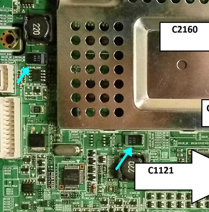

                      Hi Andrew, i have always read on Italian forum the resetting with sh.cir. pin SDA - SCL.. i have done it on 2 tv's, one have worked, the other no.. and Capleaker, the freezing have worked for you?
                      Test the voltage on theese 2 Caps:
                        I found the Eeprom its a S 24C SO.
                        Try to do a reset as you described but no luck.
                        The standby led stil blinks 5 times and then nothing.
                        I measured the the two caps.
                        Top cap on the picture: left 0 v on the right side 3.33 v
                        Bottom cap on the picture: left 1.29v on the right side 0v
                        What does that mean?
                        I also measured the voltage on the eeprom between Vss and Vcc its 3.30 v
                          How do you have found the eeprom? It's always the bigger in memory, i think in yours will be a 24c256
                          voltages seems ok even if i don't have schematics, but 3,3v is normal for many chips, 1,2xv is for the cpu.. try to let it stay on for many seconds, then feel the cpu with finger if it gets very hot, if yes then a probable try have to be a reflow of the CPU/main graphic chip (bigger one)
