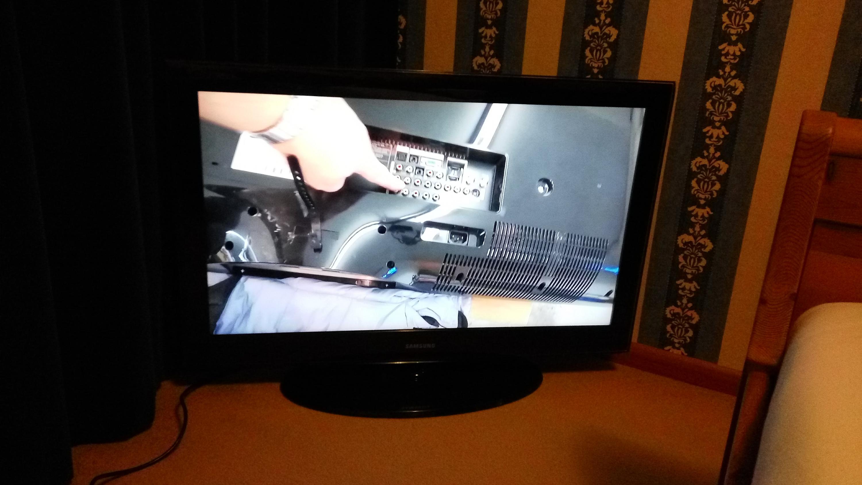

      I have shorted the pins 5 (SDA) and 6 (SCL). done this with power on and stb but no luck.
      Today I received the main board, installed it and its up and running.
      After all it was the main board.
      So everyone with similar behavior of the mainboard as described, try a Eeprom reset or change the main board.
      I am very glad.
      Of course in the mean wile I bought a 55inch led lcd so the 40inch Samsung goes to the bedroom.
      The total cost of the parts are 58 Euro for the main board including shipping and about 9 Euro for the replaced caps on the power supply.
      I want to thank everybody for their help.

          What I meant is, there are 2 states when plugging in the power cord.
          1: When you unplug the powercord and the tv was in a standby state, the next time you plug in the cord the set goes into standby.
          2: When you unplug the powercord and the tv was in a “on” state, the next time you plug in the power cord the set goes into a “on” state.
          I tried both states with the short but it didn’t help.
          When there is a corrupt eeprom, is it stil possible to have these 2 states?
          What are the symptoms when there is a corrupt eeprom on the mainboard?

                  I understand the procedure but I still don't know in what state the set must be in?
                  Because the main board remembers the last state it was in, it goes to that state when plugging in the power cord.
                  So when it was in standby, I unplug it, short the eeprom and plug it in. The set goes to the standby state.
                  When it was in the “on” state, , I unplug it, short the eeprom and plug it in. The set goes to the "on" state. (fan starts direct"
                  So there can be 2 states.
                  Please tell me what state do you prefer?
                  Plugging in the power cord and it goes directly to the “on” state or to the standby state.
