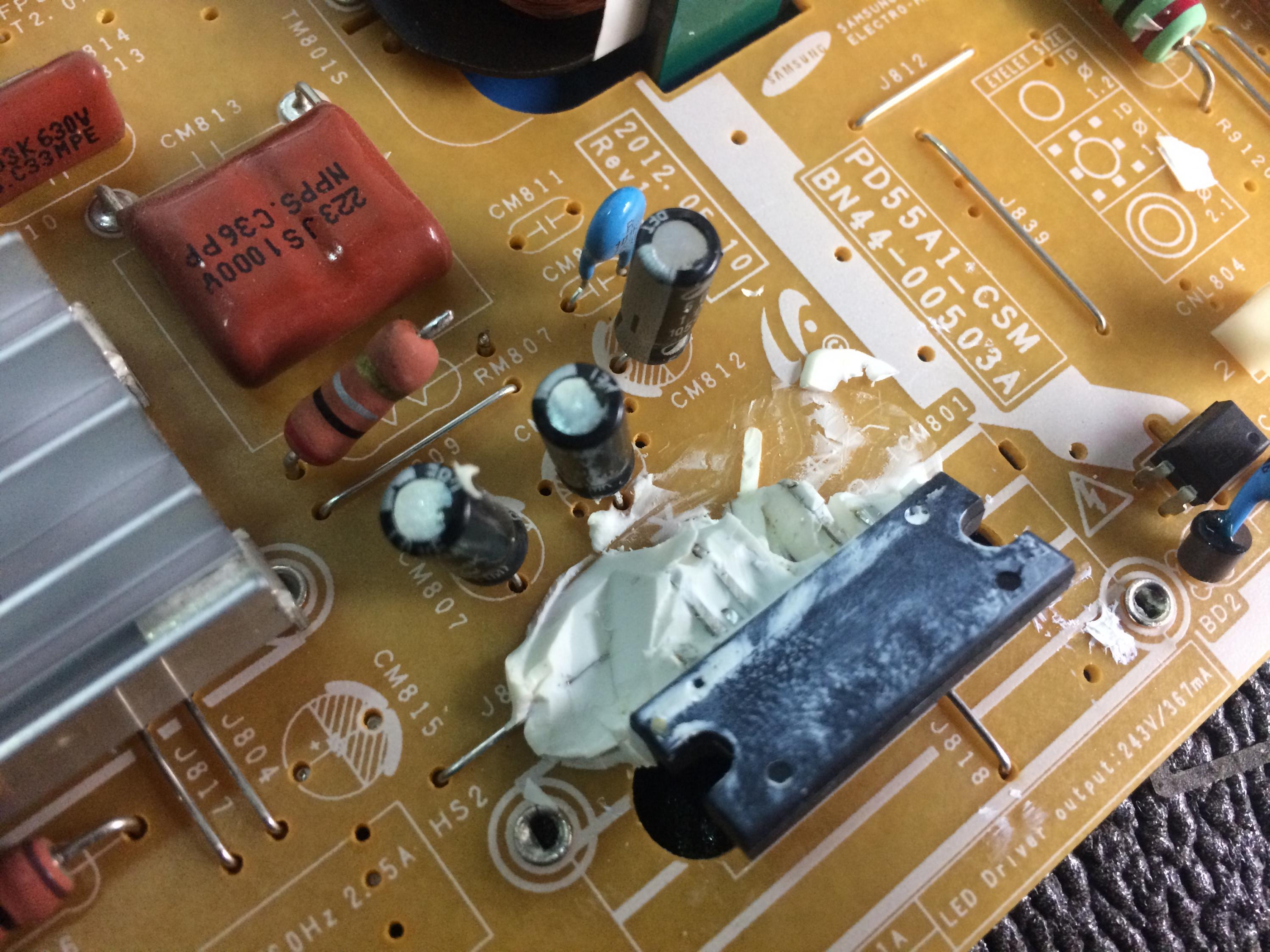

RM807 really shows 0.5 Ohms?
Pin 5 and 6 are returned to circuit through that RM807 so it should not have 13.77V on pin 5 and 6 unless the resistor has much higher than 0.5 Ohms. What Ohm scale are you using?
Has to be measurement error or that resistor is no longer 0.5 Ohms.Last edited by budm; 02-03-2017, 12:20 AM.Never stop learning
http://www.badcaps.net/forum/showthread.php?t=24809Comment
Re: How to repair Power board BN44-00503A ?
OK, solder the resistor back in place and measure the DCV between the two legs of that resistor to see if you get 13.77V per your earlier measurement.
BTW, as you can see, one end of that resistor is connected to the negative leg of the main filter cap which is the GND ref for the primary side, the other end should be connected to pin 5 and pin 6 (please verify that)Never stop learning

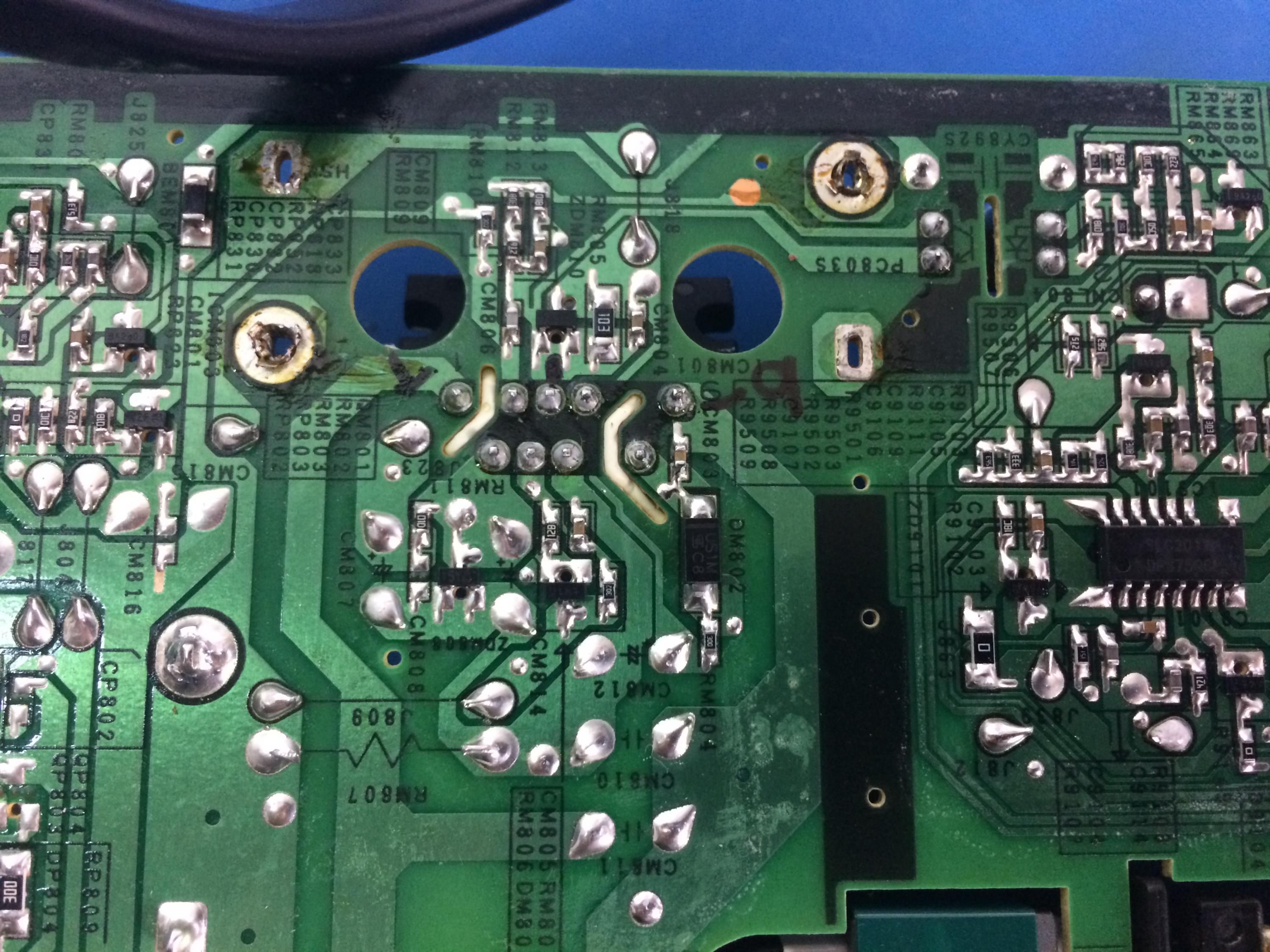

OT. In the second picture of post 25. Is that an acceptable way to remove one side of a component? Can one just solder the leg back together?Comment

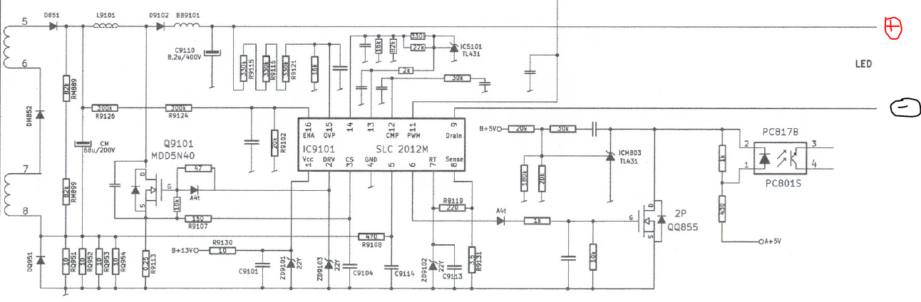

Trying to modify led current. I believe R9113 is the CS sense resistor. But I've been wrong beforeAttached Filesif you find these attachements useful please consider making a small donation to the site
I assume no responsibility for any stupid suggestions I might post.Comment
Do you mean R9131, 3.5 Ohms, resistor?
Unless that IC has the LED current ref. pin for setting the current.Last edited by budm; 02-18-2018, 10:34 PM.Never stop learning
I cannot really tell from the picture if it is 3.5 or 2.5 but it is R9131.Never stop learning
