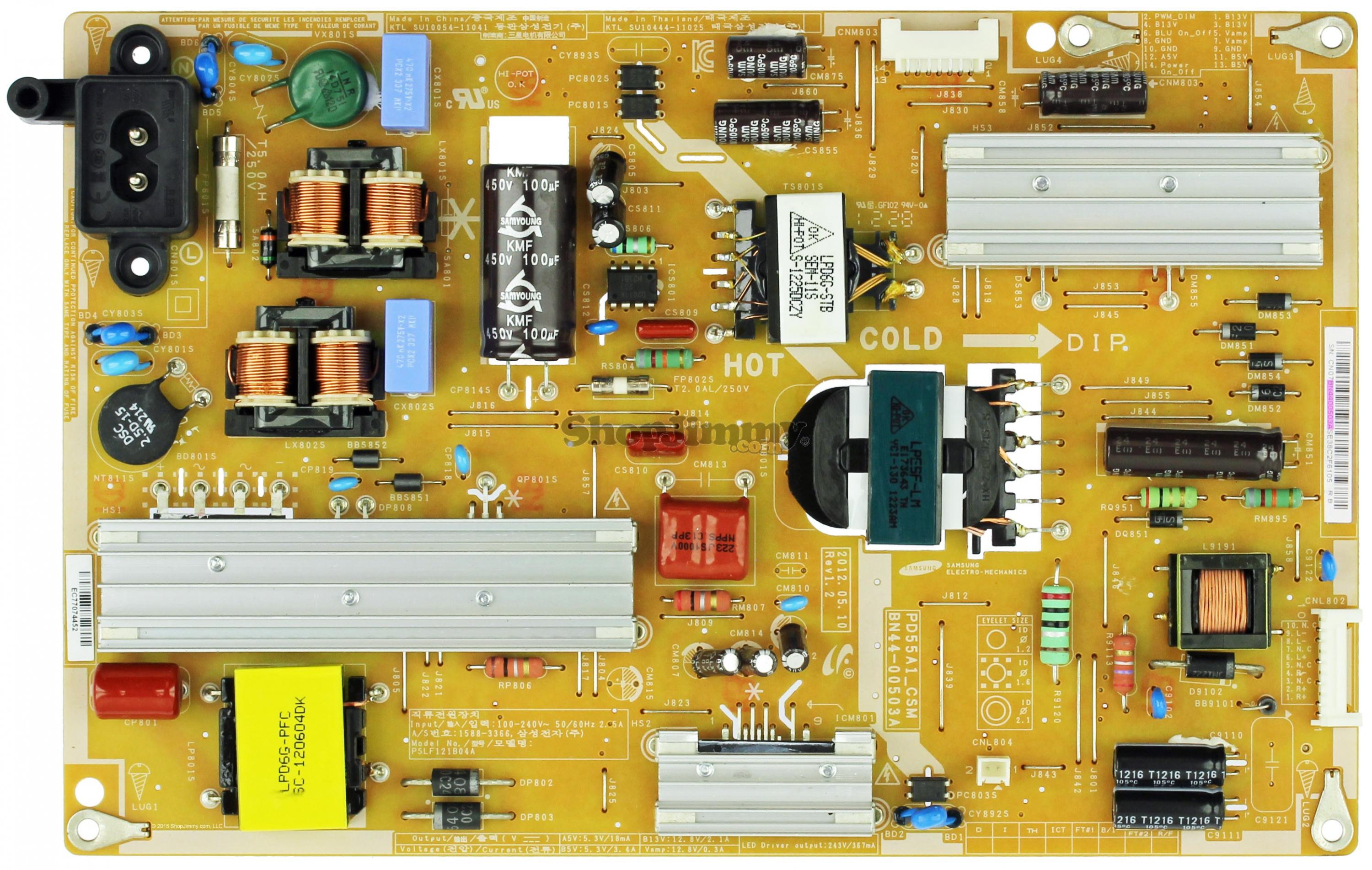

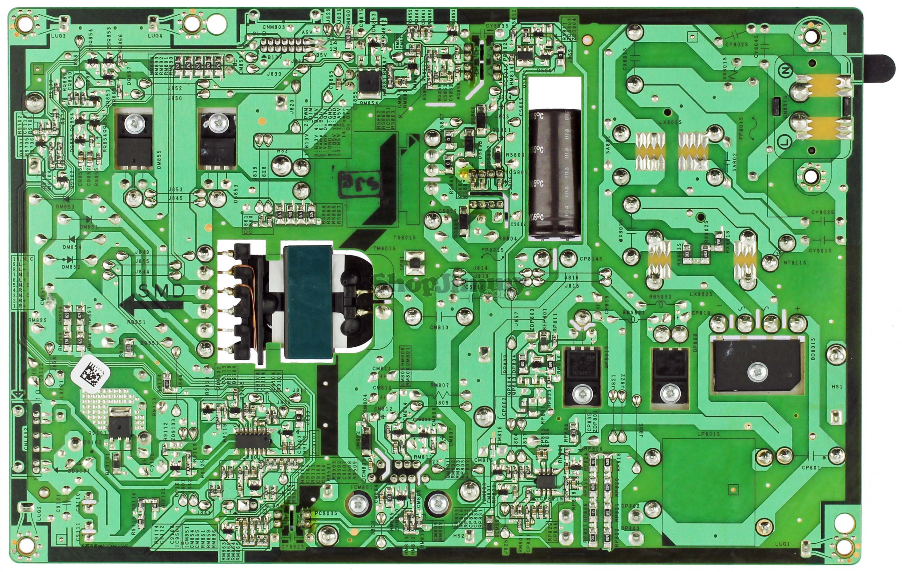

    Hello there,
    I would like to learn how to repair this power board BN44-00503A. There is 5v Standby, big filter cap measures 396v but there is no voltage out to LED's. This board belongs to Samsung tv model UN55ES6100 and it has the pull up resistor that should allow the backlight to turn on when disconnected from main board.
    Any suggestions of what to check or measure would be appreciated. High definition pictures from Shopjimmy are attached.

                Have you checked the fuse FP802S? A photo of your power supply could prove more useful.

                        OK, I look at the board layout, without B13V present then you will not have B5V.
                        ICM801 drives power transformer TM801S which supplies the B13V, and the Voltage for the LED driver power supply.
                        We need the P/N of that ICM801 mounted on the heatsink so we can get the spec sheet and be able to verify Voltages on that IC.
                        I also see three small lytics caps CM812, 814, ??? in that section, you may want to heat them up with hair dryer for a few minutes and then apply power to the board to see what happen.
                        The key point right now is to get the info of that SMPS IC.
                        Cap CM 813 and resistor RM807 need to be check.
                        BTW, I would like to the pictures of YOUR board.
