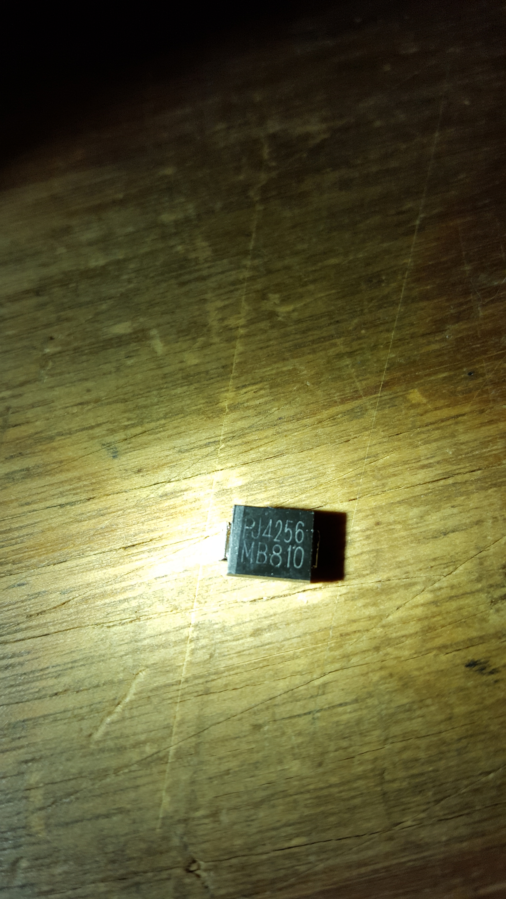

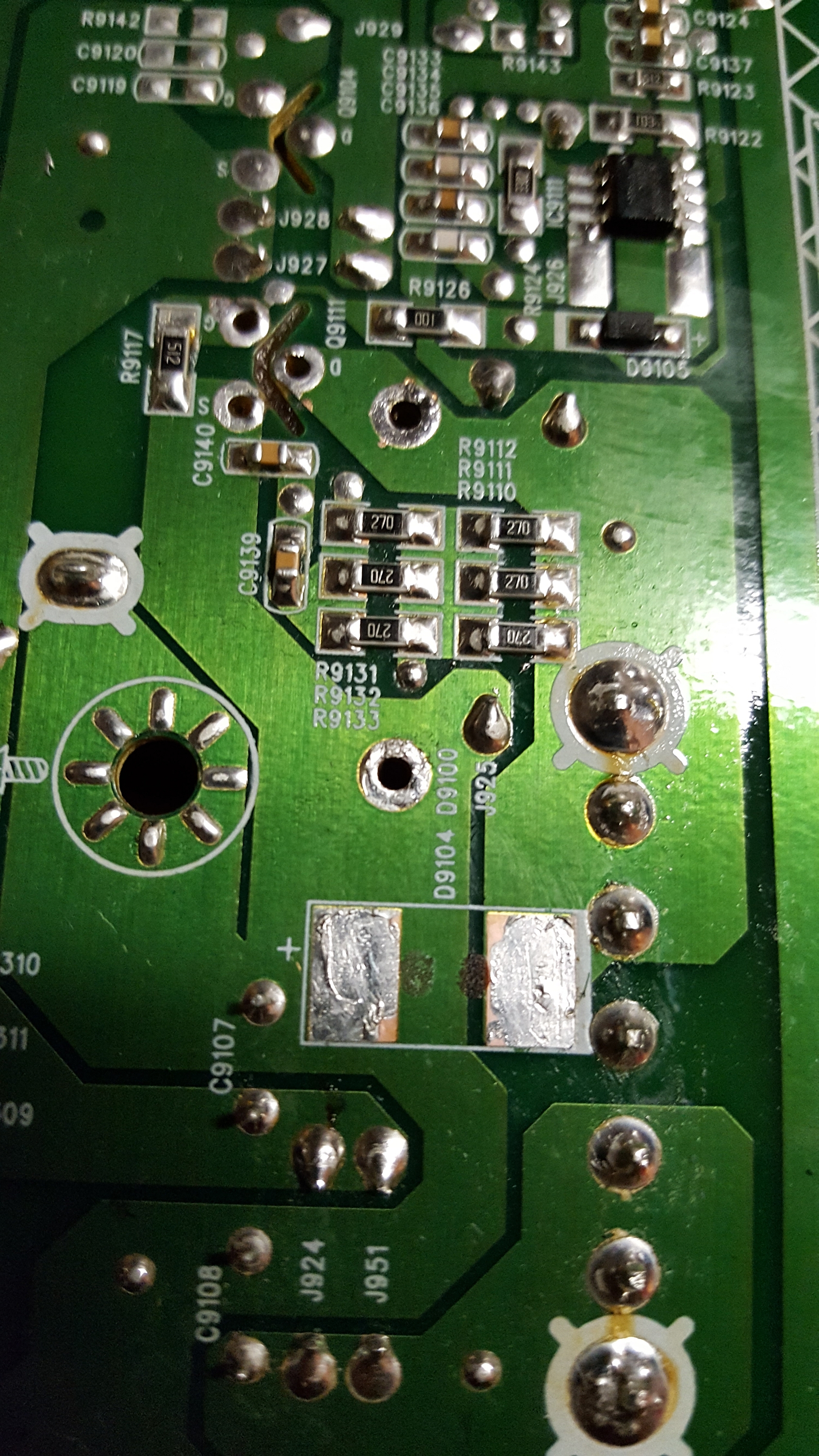

    I checked the power supply and found a shorted SMD diode. It was position D9104. I had also removed a thru hole diode D9100 but it checks good out of circuit as well as Q9111. I at first thought the transistor was bad but it tests good out of circuit.
    I cannot get a data sheet for this diode D9104 it has PJ4256 at top and MB810 below. I get nothing from a google search.. was hoping someone could point me to a replacement...
    note- it is a rather big SMD but I think the PJ is the package but hey i don't know much about the SMD parts size identifiers and tend to get the wrong ones half the time.
    I believe this single diode is the whole of the trouble...

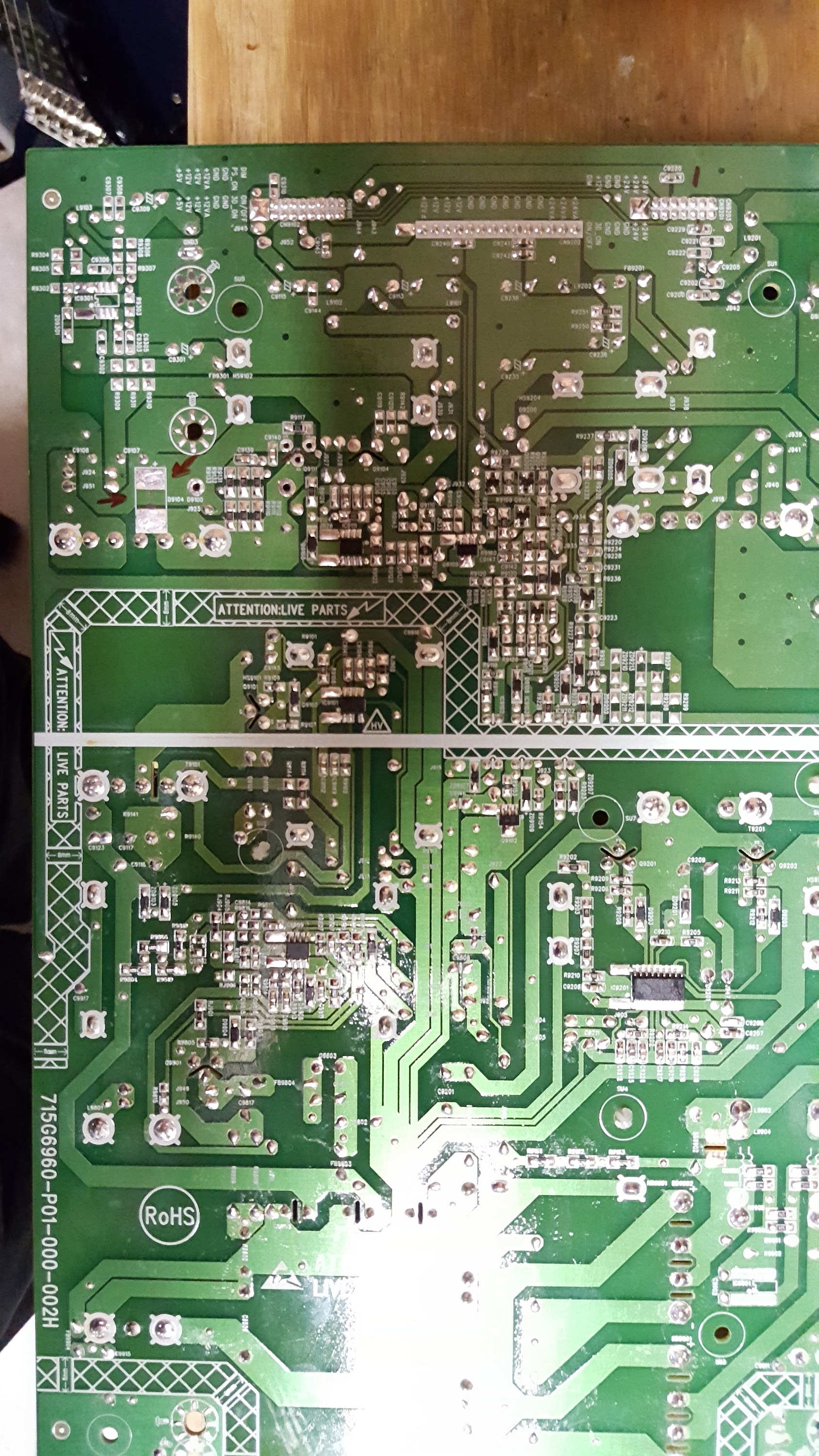

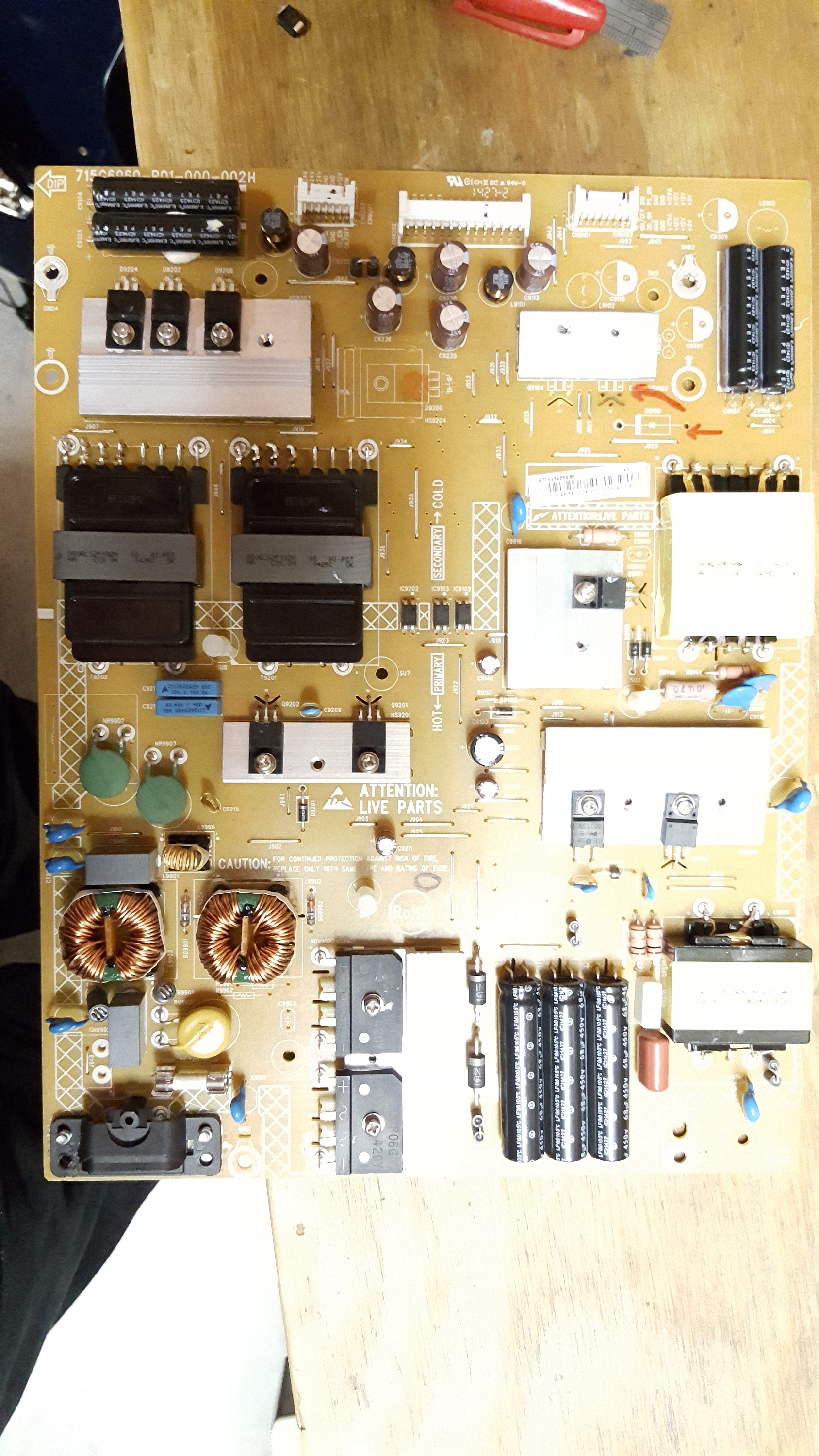

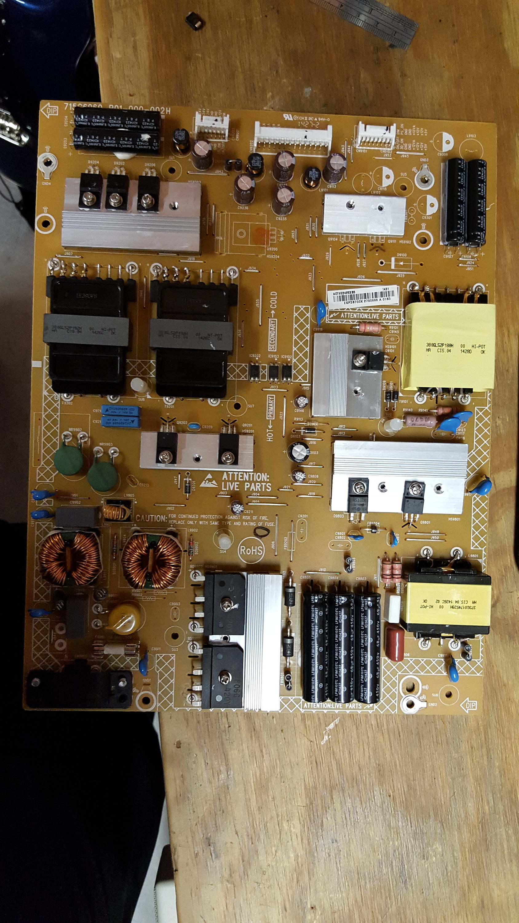

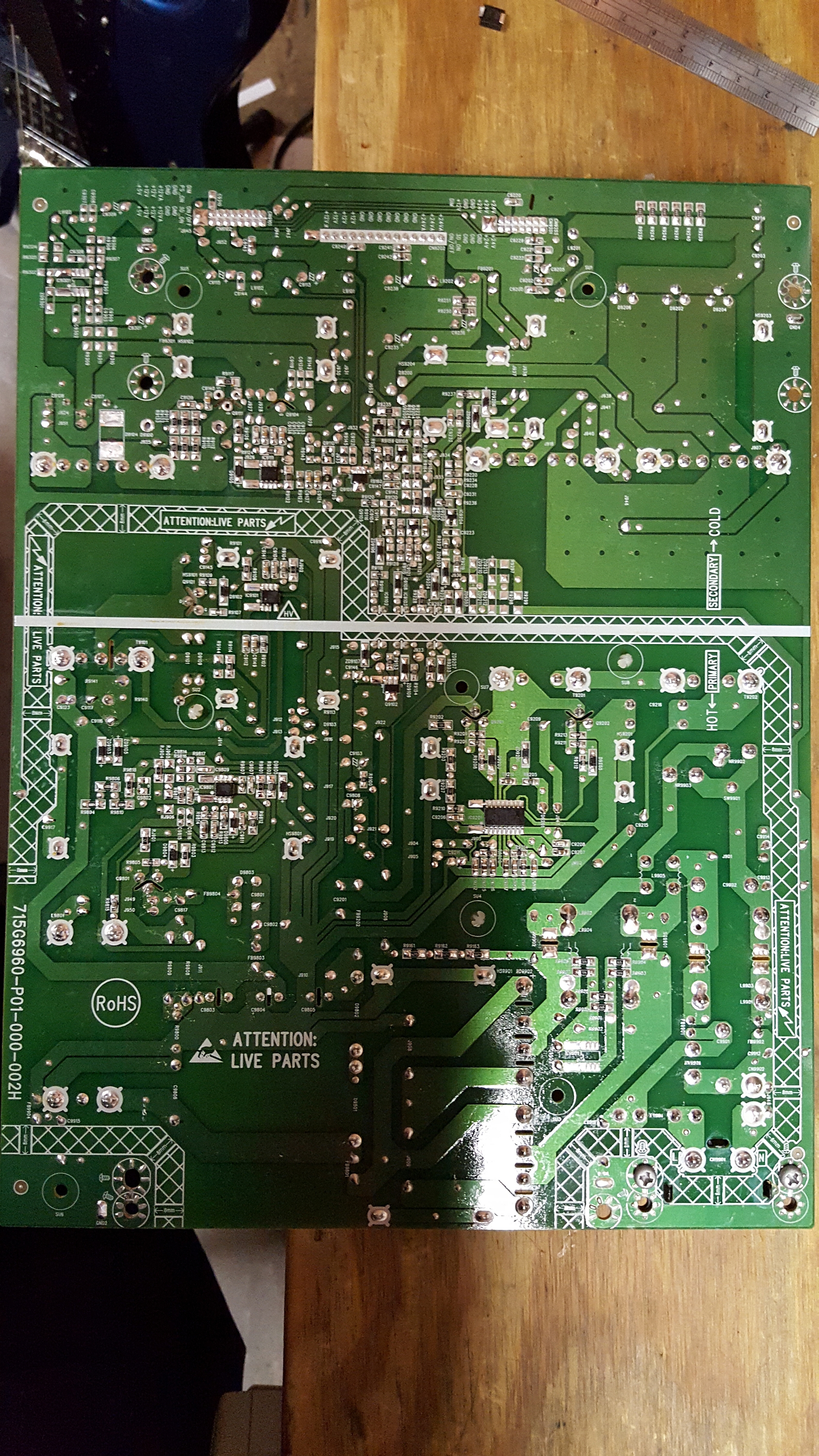

    Can we see straight shot pictures of top and bottom side of the board so we may be able to figure out the function of that diode?

      Looks like this one.

        Everything looks like it is correct... thanks! Now I just have to find one to buy..
        Size is spot on in the datasheet.
        MB810

          Attached photos, top and bottom - with and without marks (red arrows)
            Re: Vizio P502ui-B1E No power on, led blinks once when pwr plug is inserted into outl
            D9100, D9104 are connected in parallel, but the one with the lower Vf will conduct and have most of the current flowing through it, it is wrong to use two diode connected in parallel, especial they are not the same spec and no balancing.
            That is the 12VA standby power supply section.
                Ordered the power supply board. Installed it and all is well.
                Thanks!
                Note: never did find where I could order the smd diode. Found one i think was equal but with shipping it was 2 thirds the cost of the entire guaranteed board replacement so I went with the sure thing in this case.
