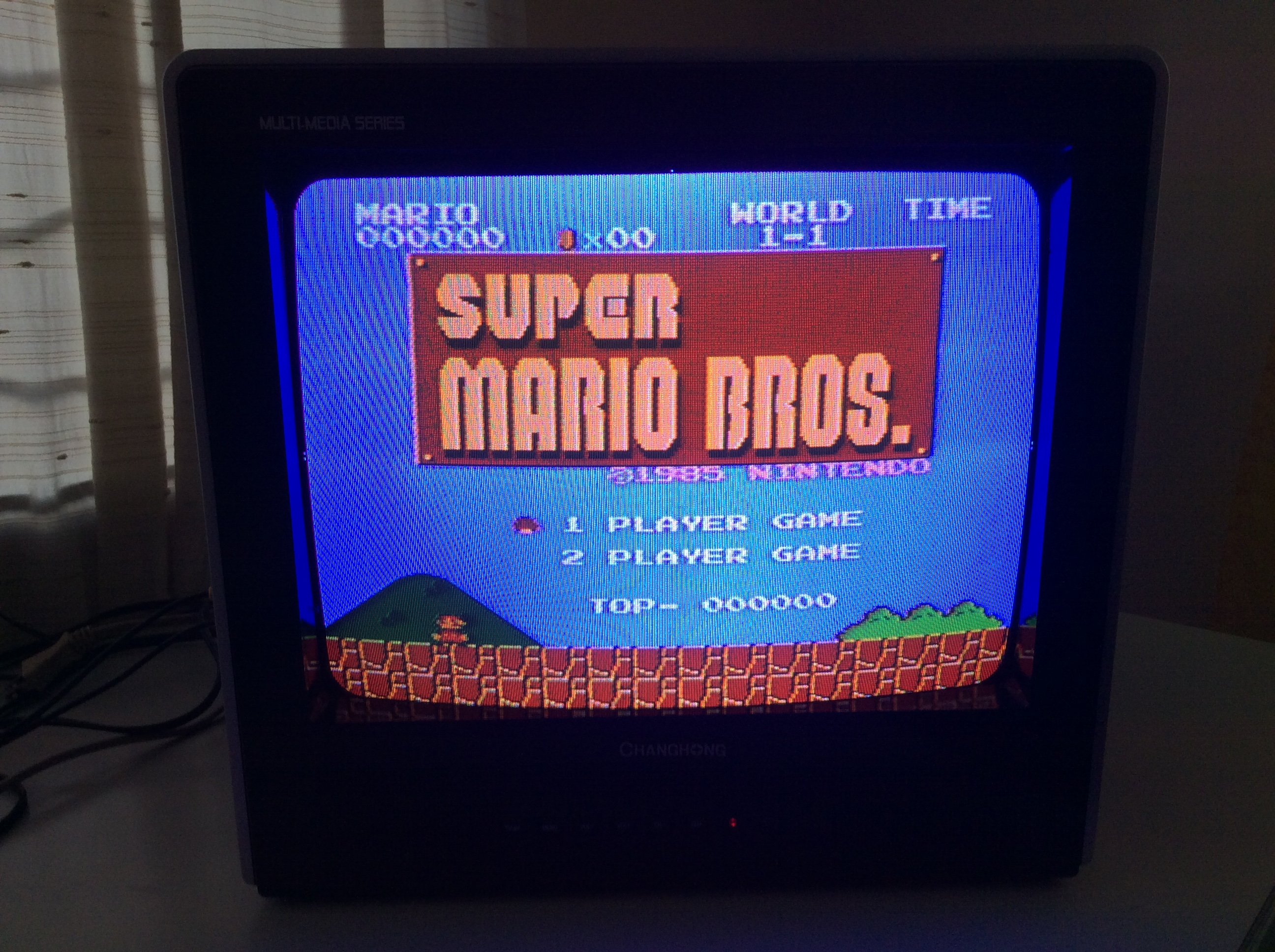

    If the picture is tilted, you would need to rotate the deflection yoke, after all this time and heat it will be stuck to the crt neck, loosen the clamp holding it to the neck and try rotating it, if its not out that much don't wory about it. Don't be too concerned about the yellow marks not being lined up, many times that was just a starting point reference, check the rgb convergence in the center of the screen, if its ok then you don't have to change them, The first two tabs closest to the yoke are for purity adjustment
    I dought that c310 is bad.
    If you replace the c310 and you see the lines thats because that cap is in parallel with the yoke and changes the impedence of the yoke circuit and slightly increases the deflection, so I would go after the 2 electrolytics in the output circuit.
    If the lines are just slightly noticable at the botom, it might just need the vertical height adjusted slightly, there should be about 3/8" of overscan aprox.
    If c403 looses value slightly , it can cause the picture to not fill the screen properly. try replaceing it, c304 might also affect the vertical size slightly.

      i just looked at the pic again and it looks level to me at the lower screen ...upper right looks pulled up so those shift plates might need a nudge like i mentioned earlier ....
      the factory marks are not aligned ...
      just remember where they are before moving them ..
      am thinking its the ones closest to back of tv that will shift the picture .
      its been a long time since i messed with one ..
      also looks like height might need a tweak as well . probably a pot on main pcb for that .

        moving the convergence tabs won't tilt the picture, they are for r.g.b. convergence at the center of the screen (see manual page 7) to turn the picture you need to turn the yoke. To adjust the height you need to go into the service menu, Page 10 in manual (page 6 of service menu) there are no adjustments on the chassis itself.
        There looks like a VCENT (on page 9 of service menu) that could adjust the whole picture down slightly fixing the lines at the bottom an showing more of the top os the screen.

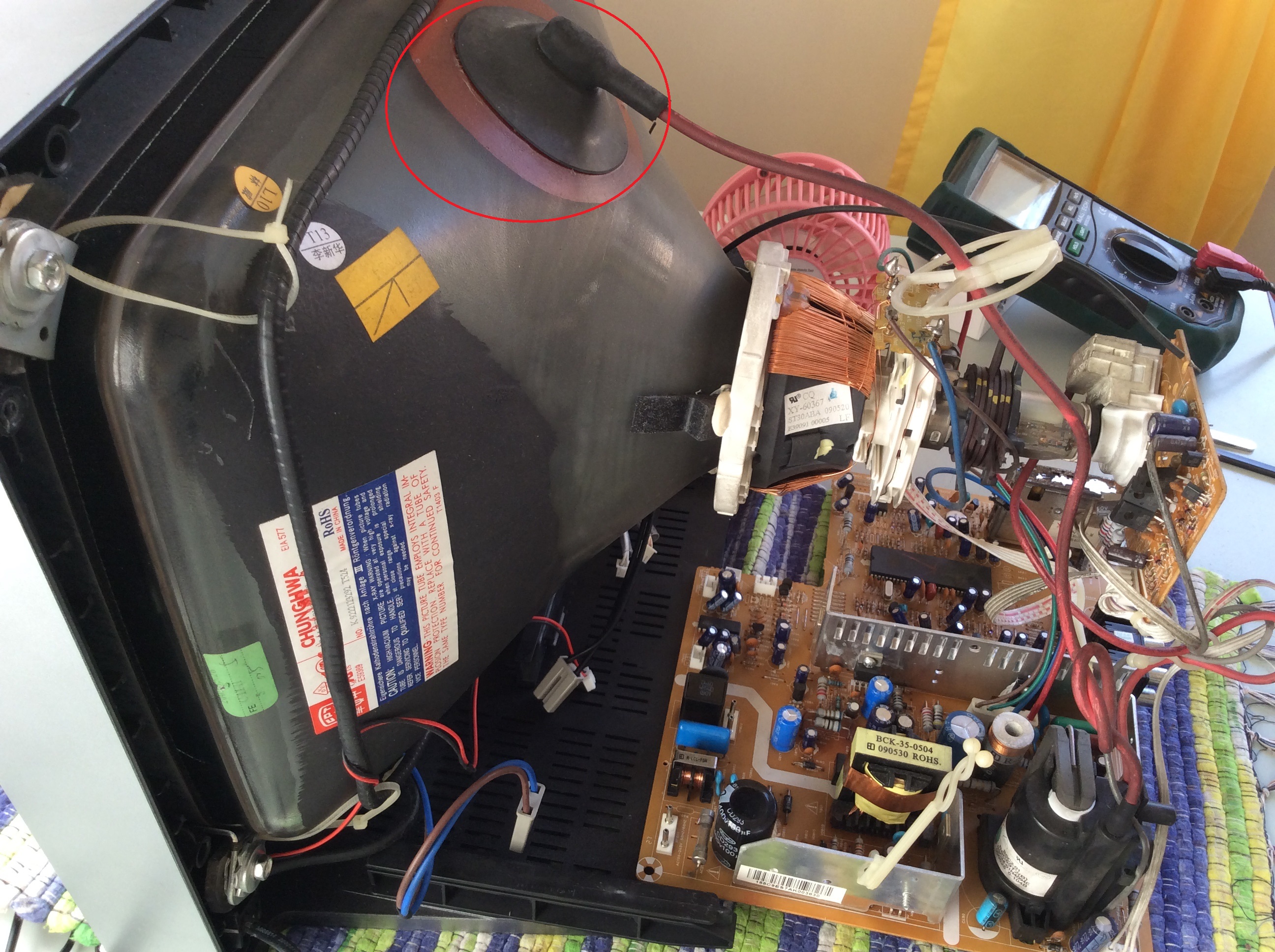

          I loosen the screw on the clamp and I tried to rotate the yoke but it won't move. Probably because of the white adhesive between the yoke and the black padding on the tube. I'm not sure how to proceed.

            There is NO tilt adjustment in the service menu, That yoke was most likely crooked from day one, (seen it many times) If its that tight to the neck of the tube you could end up either breaking the yoke coils from the plastic or worse break the crt neck.
            Some large crt tv's 32" plus had a tilt adjustment but those tv's had an extra coil seperate but close to the yoke, and a seperate drive circuit. this 14" won't have that
            The amount of movement needed to correct this amount of tilt is very little, it won't even break loose of the silicone on the wedges, Try and turn it a bit by grabing it on the plastic near the front of the yoke, but be carefull not to touch the coil.
              Yes I tried the service menu mode and couldn't find any tilt settings. I did not notice or mind the tilt issue when I bought it new maybe 3 years ago because it was just for watching local channels but I'm not surprised if it's tilted like this from the start.
              I did exactly that way even with a rubberized gloves but it's too stuck on the white rubber-like silicon adhesive. I can move it a bit but since it's too stuck it will just go back to its original position when I let go. Can I do it while the TV is on?
                No, the whole picture is tilted. Maybe because of the angle I took the picture. Top and bottom right corners are pulled up while the top & bottom left corners are pulled down.

                    That silicone should come loose quite easily, just make sure the clamp on the neck is loose, and yes you can adjust it when its on just be careful of the bare connections on the yoke, they will bite Like I said it should not have to rotate the yoke very far to make the picture straight, maybe 1/2 a degree. a 640x480 pattern should work, give it a try and see what it looks like
                        did you try degaussing it ?
                        also did you try rotating the tv ?
                          I did it!
                          My screen looks better now.
                          The only thing I did wrong is that I accidentally set the "INITIAL" service mode setting but all good now. One setting I cannot bring back is when the tv is manually switched on I can just plug in the power cord and it will be on. Now when I plug in the power cord I would need to use the remote control to turn it on. Anyone knows what the service setting code for it?

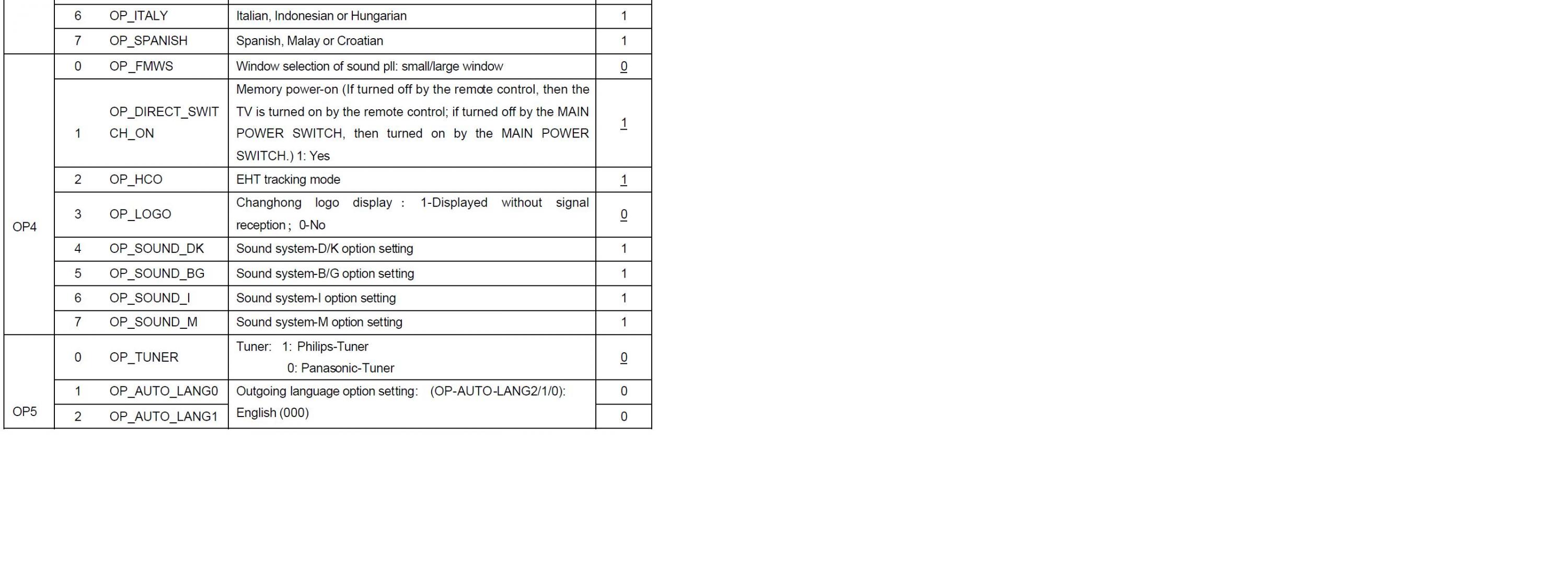

                                What about the settings (page 15) for Mode0 & Mode1 are they the same as in the manual?
                                This is what a different model has, in op4 (1) is where you would set that option.

                                  I tried some values for the Mode0 & Mode1 but nothing works.
                                  I've gone over all the service menu pages but couldn't find anything related to op4.
