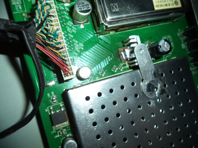

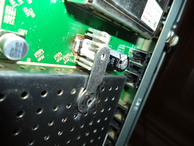

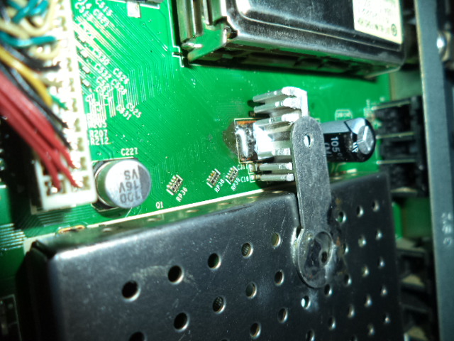

    Just finished repairing a Hisense f42k203. It is the 150308 and E120111.
    Checked P/s voltages with only red led on {would not turn blue}
    XP902 connector
    stb = 3.7v
    5v = 5v
    12v = 12v
    PWM= 0v
    sw = 0v
    18v = 18v
    xp902 had 131v on +1 pin
    Tried EEPROM but that did not work
    While looking for another main board noticed the N4 regulator was very discolored. Checked it out AZ1080D and replaced it with UZ1080L and TV fired up perfect. Also put the original EEPROM back in and it worked perfect.
    The N4 input of 5v was right on and a perfect 3.3v output. Noticed it was still getting very hot so i put a small heatsink on N4.

    Nice Hope it keeps working though. Wouldn't think it should get so hot unless something downstream is drawing excess current. Maybe check components around it getting hot also.
      Re: HISENSE F42K20E 158308 not turning on
      Something is still drawing too much current, keep an eye on it.

        Thanks for the reply. TV is still going. Temp. on regulator is around 120f. Maybe a little hotter closer to the 3.3v output on board. I have seen a few other boards with the same discoloration on N4 . I think Bud is right that something is drawing too much current. Maybe if someone has one of these tv's they could let me know how Hot N4 is getting on their TV and if they sense it has overheated.

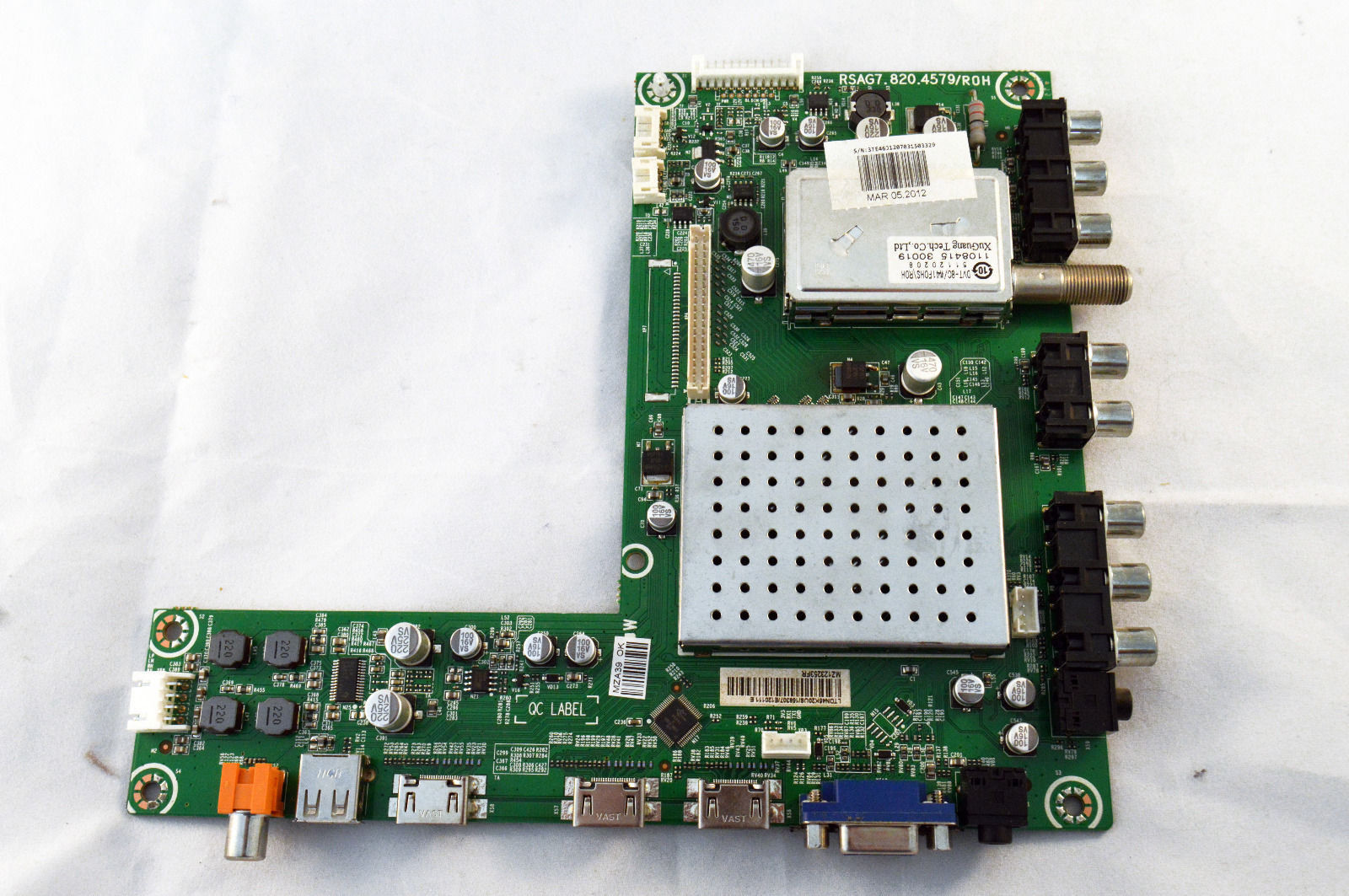

          Here is a board from ebay with same problem. N4 is between the tuner and cpu in center of board. az1084d
