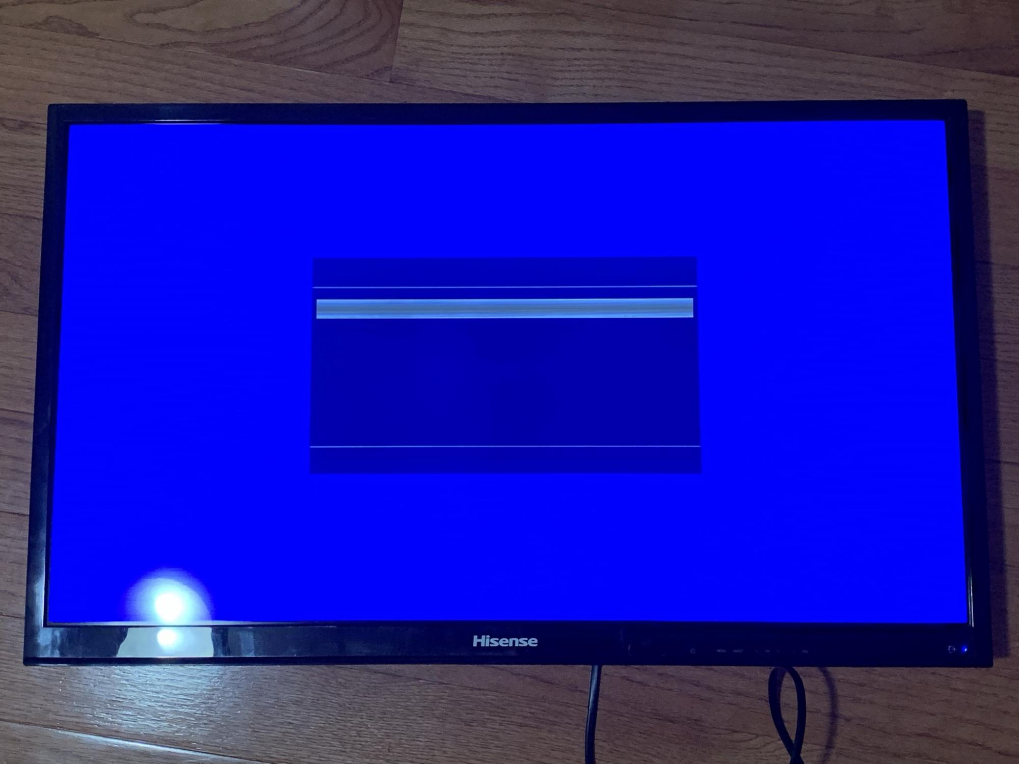

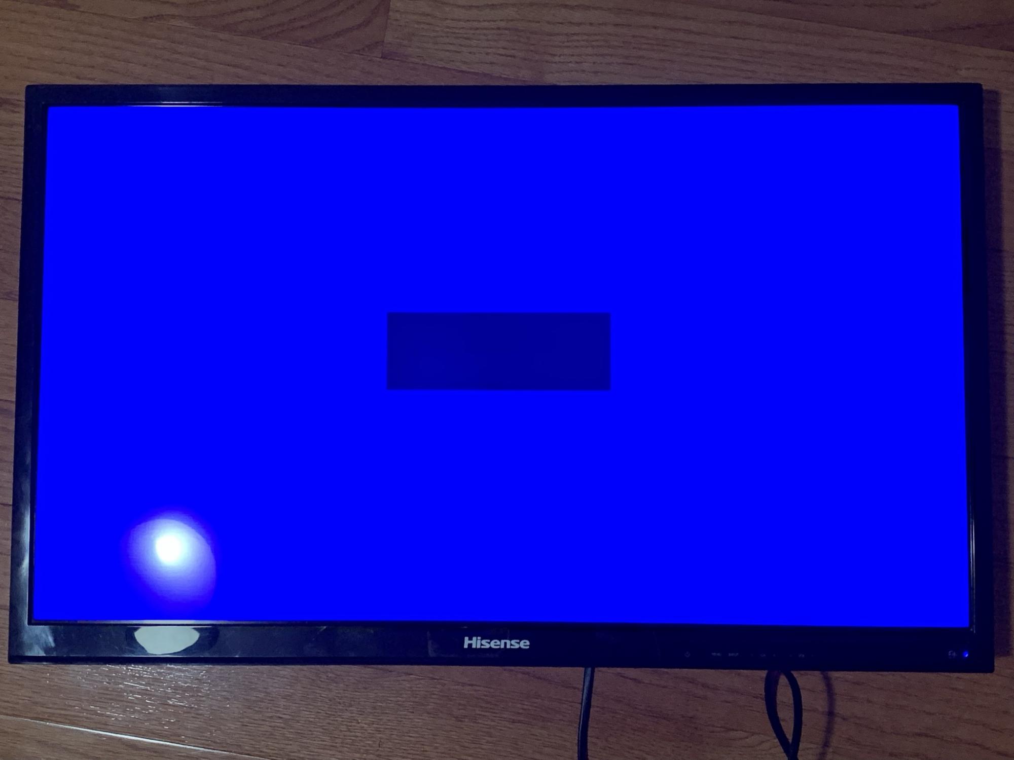

    The TV initially had a steady (not flashing) red standby light but did not turn on when power button was pressed. I tried all the usual “fixes” but nothing worked. TV would not turn on. After researching the issue, I concluded the cause was a bad EEPROM chip. I ordered the appropriate chip from ShopJimmy:
    https://www.shopjimmy.com/hisense-32...hoCOcUQAvD_BwE
    I took off the old chip using my hot air station and soldered on the new chip. I tested and made sure all the legs have continuity to the pads. When I turned on the TV, the screen lit up and seemed to be fine. However, all of the menus are missing the text. I can navigate the menus but the menu choices are invisible.
    What could be wrong and how can I fix this? Did ShopJimmy send me the wrong EEPROM?

    Did you program the new EEPROM before putting it in?

      Re: Hisense TV 32D33 - Replaced EEPROM, now menus have no text
      I did not…how do you do that? I had no idea programming was required!
      • R_J
        • Jun 2012
        • 9623
        The eeprom from shopjimmy should have come pre-programmed. See if there is a way to do a master reset on the tv or from the service menu
        • NYKing
          • 17
          Got it! It's going be difficult to navigate blind but if I can get the appropriate screenshots from a service manual, I think I can manage. Thank you!
