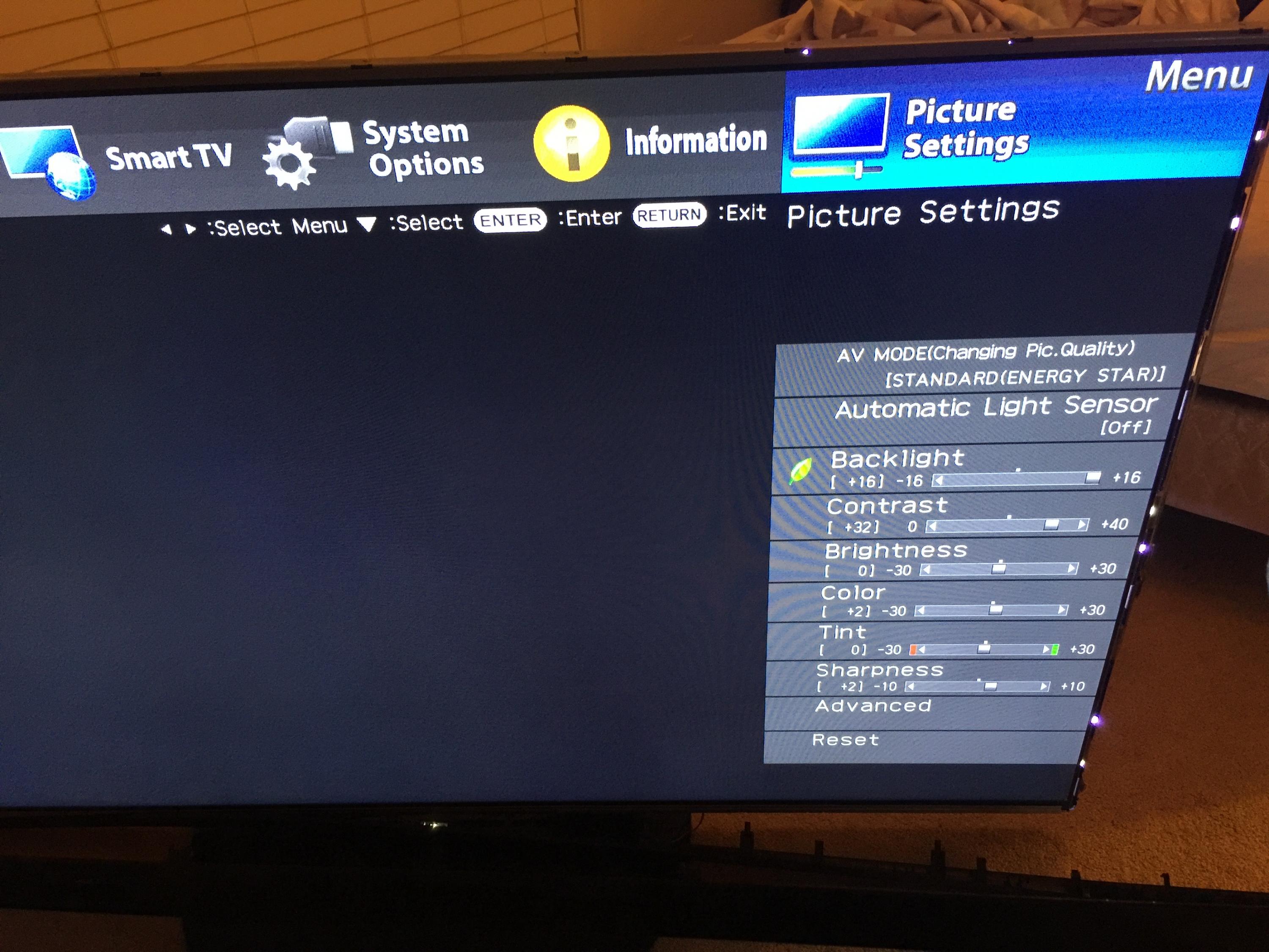

              I haven't cut anything but for some reason now the backlight and screen won't turn on when I turn the TV on? Is there a cable on this side that controls this?
              • wilbanks951
                • Jan 2017
                • 22
                Re: Sharp Aquos LC-70LE650U display is slow and discolored
                Nevermind it's back on.. hold on

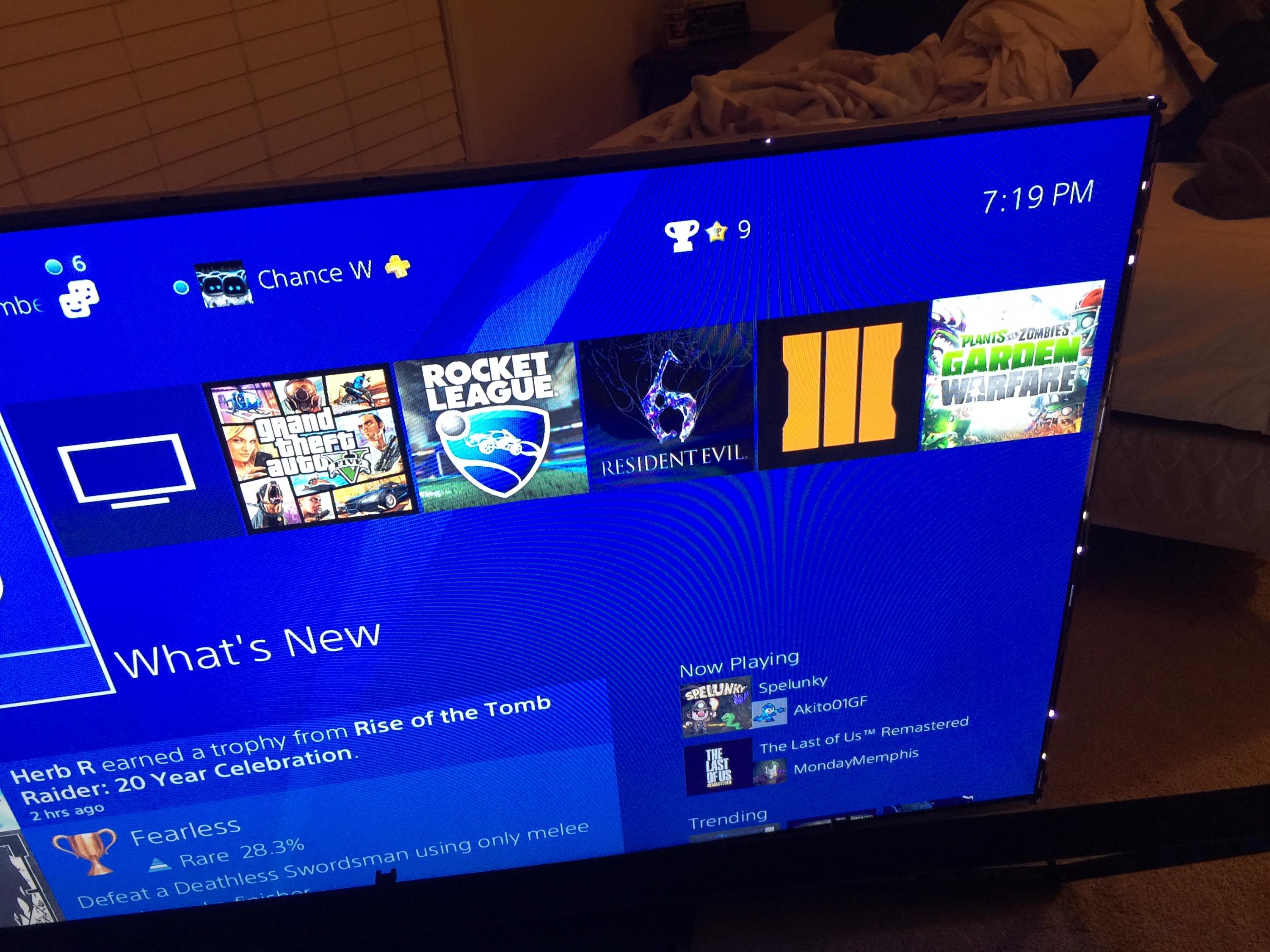

                    • wilbanks951
                      • Jan 2017
                      • 22
                      #30
                      So I did what seemed like nothing and it's working perfectly now? I'll try the PS4 again and see how that looks...

                            #33
                            turn the backlight down ... its on full ..

                              #34
                              BTW All I did was unplug the white ribbon at the bottom of the right hand side and plug it back in. Maybe that fixed it? Maybe it was loose?

                                  • wilbanks951
                                    • Jan 2017
                                    • 22
                                    #37
                                    I'd bet! Thank you for all the help! Just hope it stays this way after I put it back together

                                      #38
                                      turn down the backlights and save power and make tv live lots longer .

                                        #39
                                        I did, just had it up all the way earlier to see if I could see any other issues. Thanks again!
