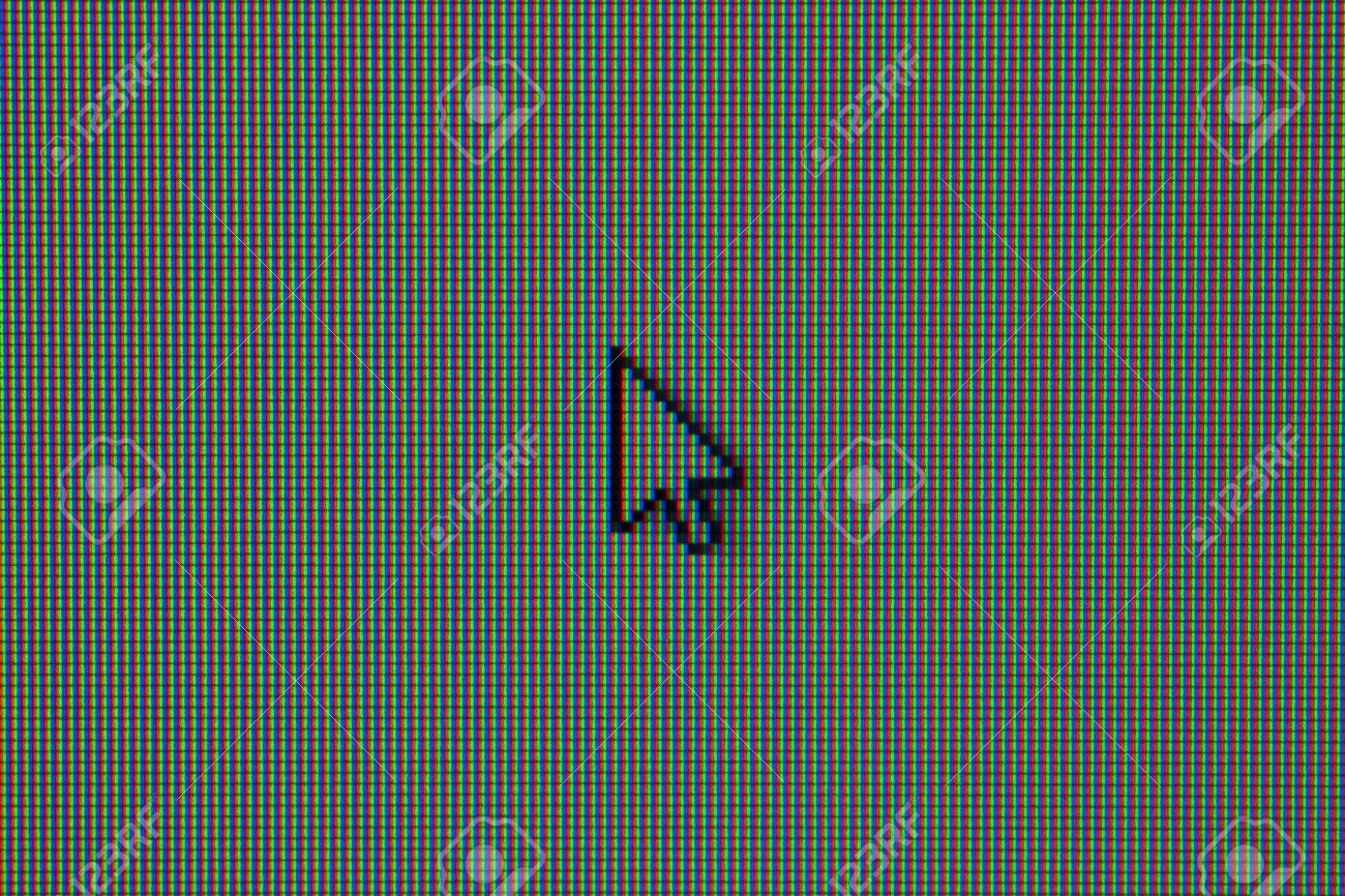

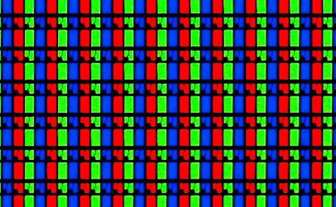

      My Sharp 60 TV customer never returns it for about 3 months.
      Is castrated-one-side-TABs-TV will be the same as before?
      But ..but.... pero...I think, Every other horizontal lines are disappeared (At 1080P) but TV may be use interlace so we not notice it.
      Can someone use high power magnifier glass double check it? Something wrong down there but look is A OK?
