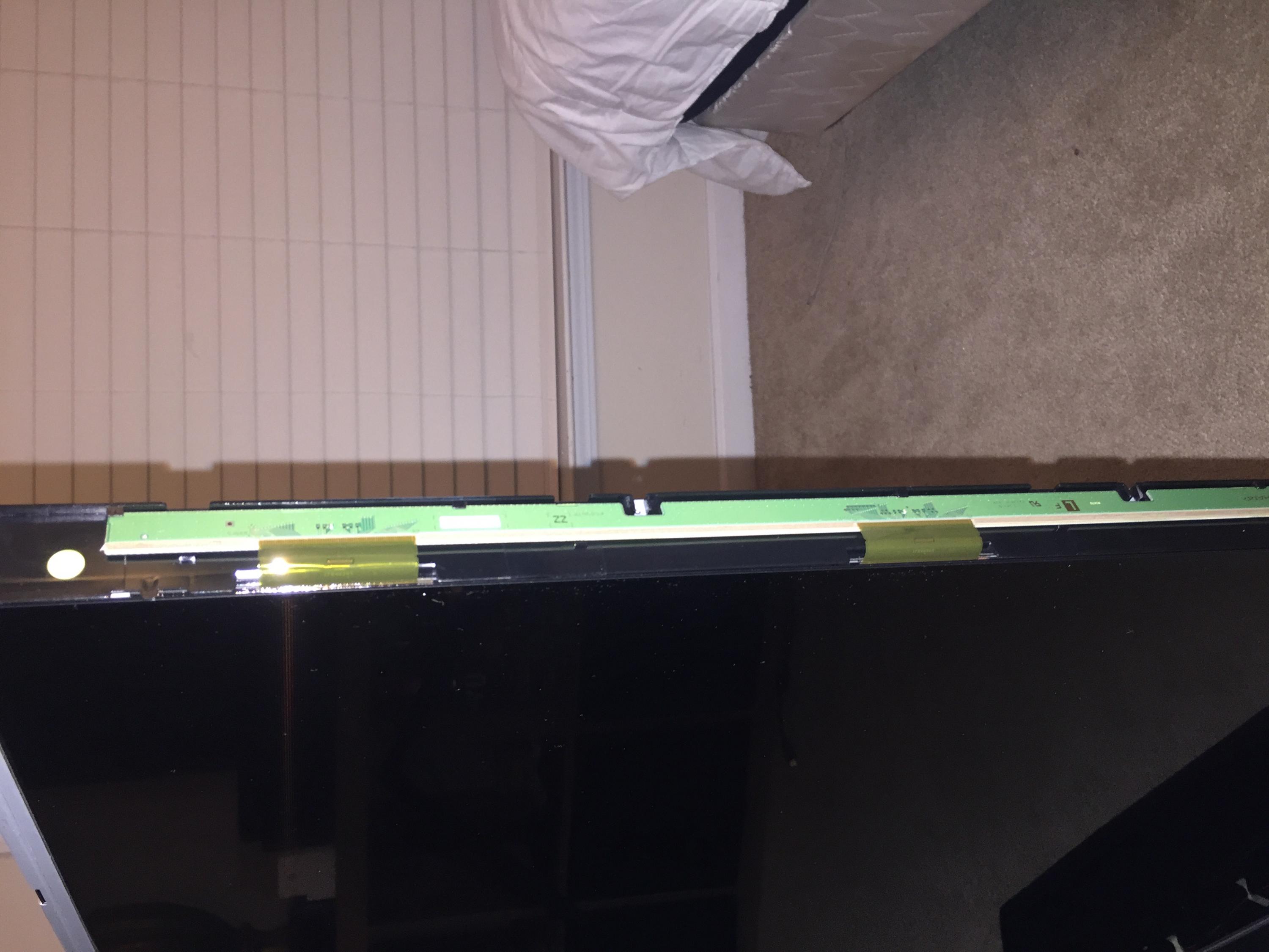

    Hey, so I've only had the TV for about two years and all of a sudden the display has been giving me problems. I had one guy look at it, told me it was the T-Conn board, replaced that and it didn't solve the problem. I read another thread where someone had the same issue and was able to fix it. You can find it here. The only issue is that I tried reading through the thread but there weren't really any "steps" and I'm not sure where to even begin. I will attach pictures of what is going on with my screen, which is almost identical to the one in the post. Any advice or instruction would be extremely appreciated as I have hope for this TV!

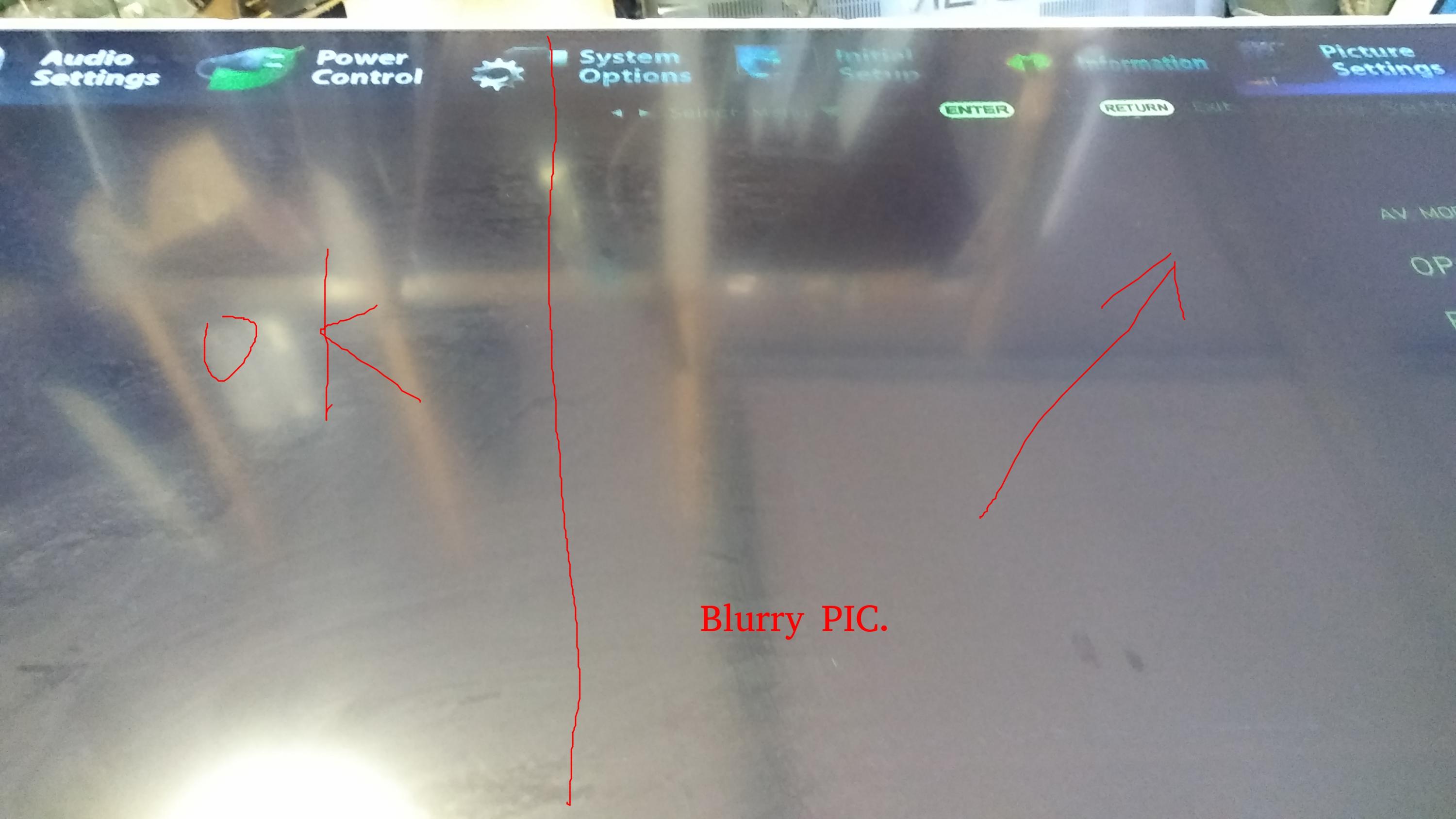

              Re: Sharp Aquos LC-70LE650U display is slow and discolored
              Sorry, what do you mean by feeding a know signal/color bars? Do you mean plug it into an output ex. PlayStation?

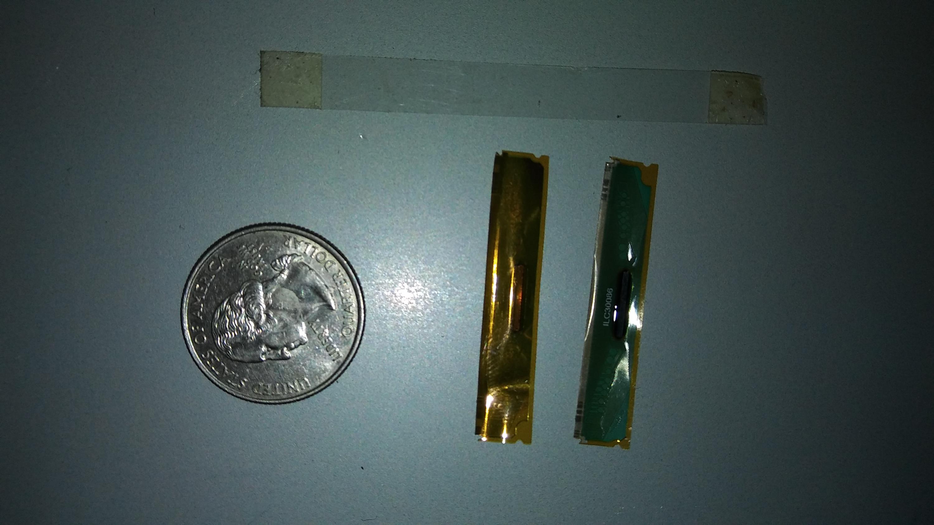

                Yes, You need to castrate those TABs........If TV only on right side has blurry picture..........
                PS: Picture worth a thousand words. Id done that at OCT/14 2016, so far so good.
                PS: Whose idea is this? I like to say "Thank You" to whomever.

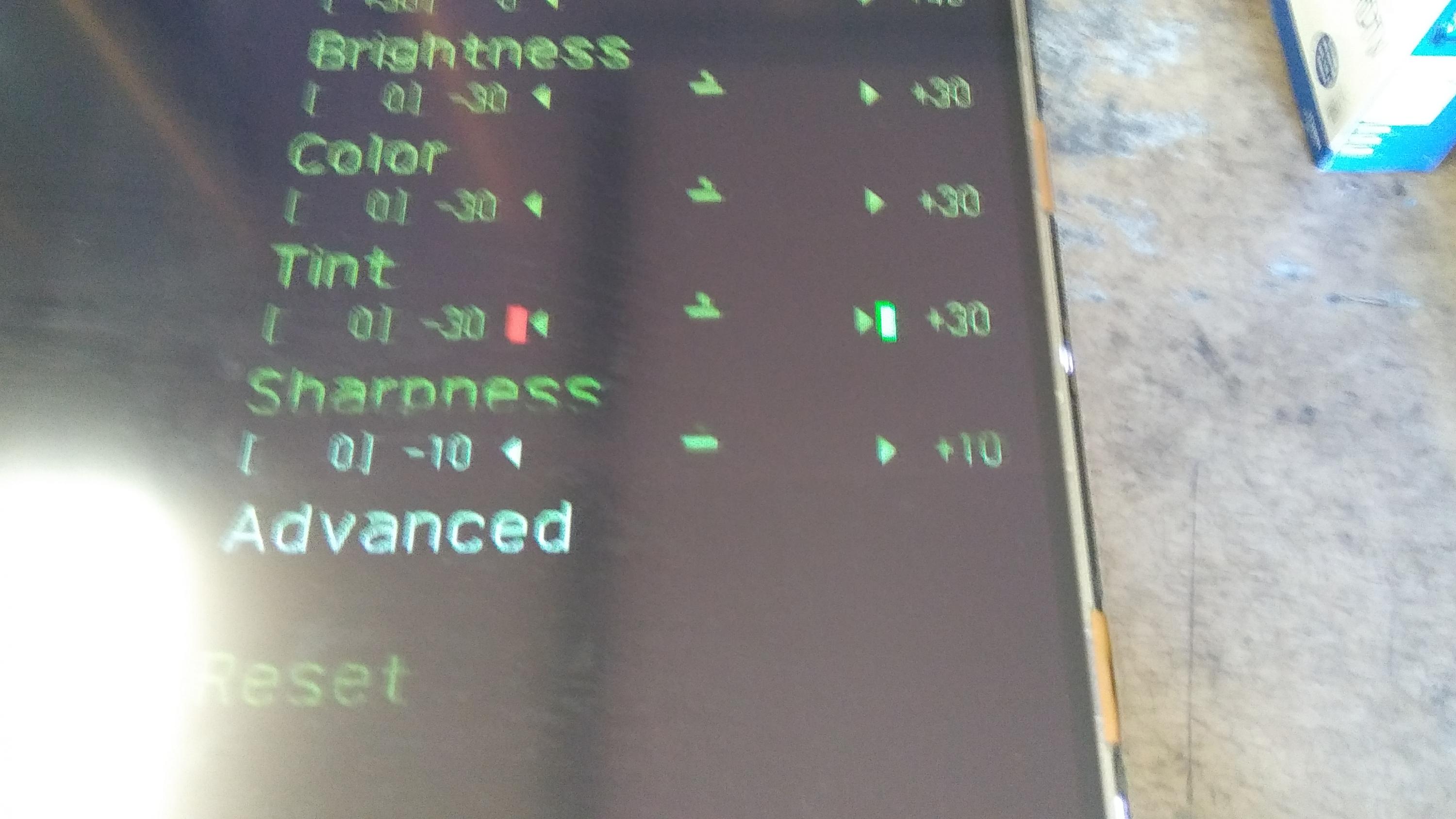

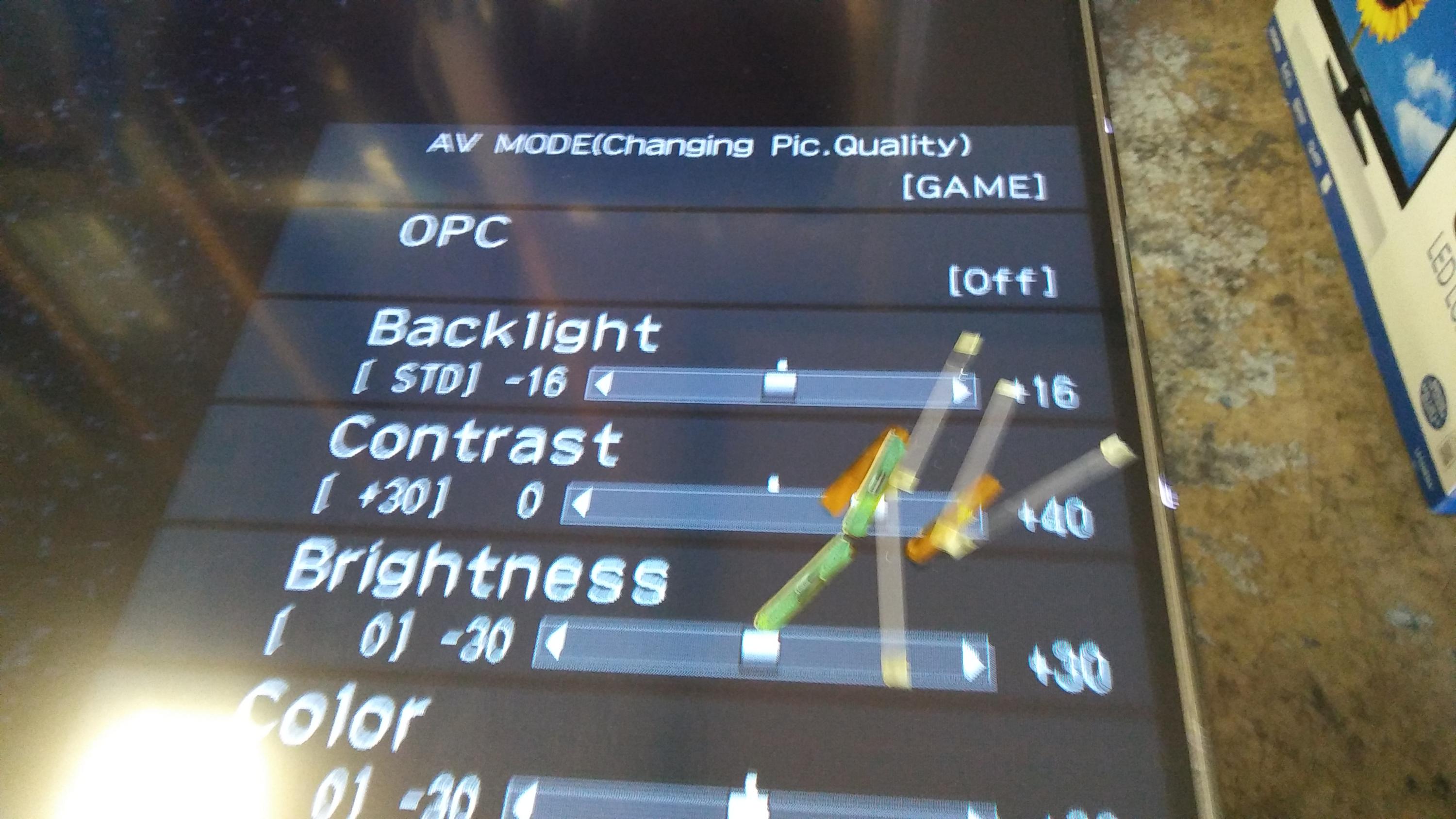

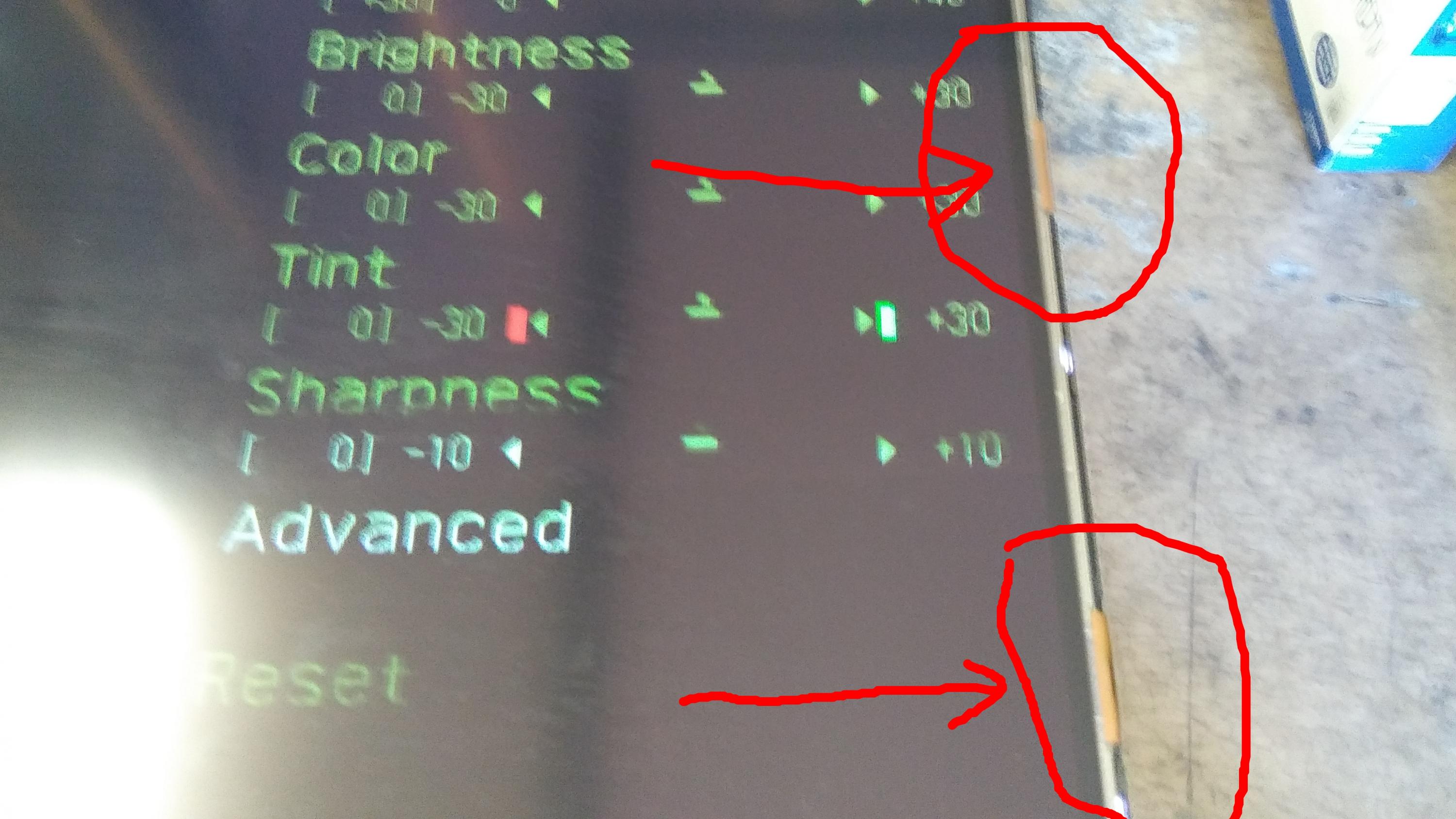

                  So it's not as so much blurry as it is dark. I plugged in my PS4 to show what it looks like when it's connected to an input. The right side is very dark and looks somewhat discolored, especially towards the bottom. How can I make sure my problem is the tabs? Is there any other troubleshooting I can do before making the plunge into removing them? Thanks.
                  • capwizard
                    • Jun 2016
                    • 1991
                    "How can I make sure my problem is the tabs?"
                    Castrated then you know! I am 95% sure.
                    PS: looking for burn marks or abnormal temperature on those TABs, if yse, chance is 100% .

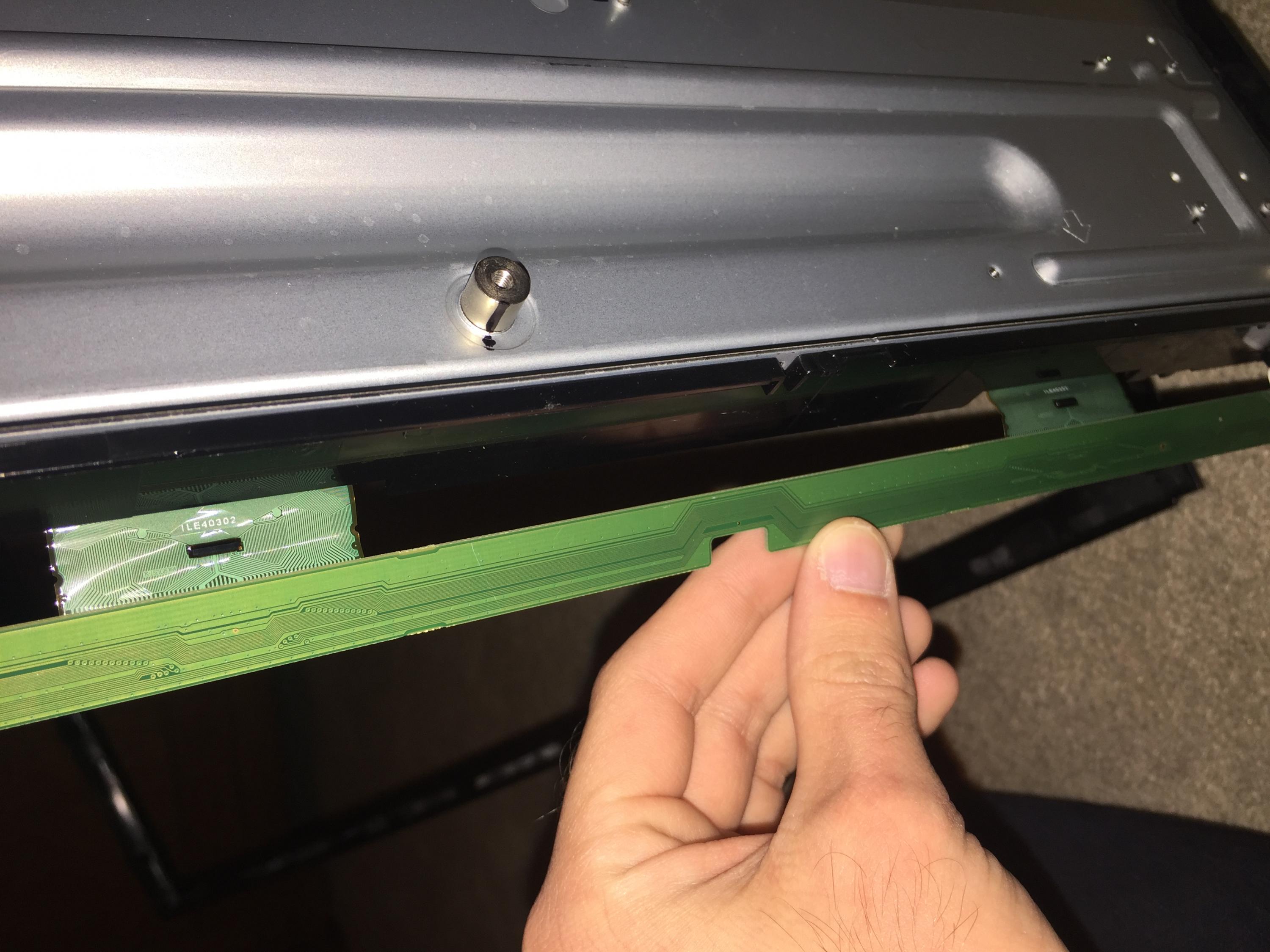

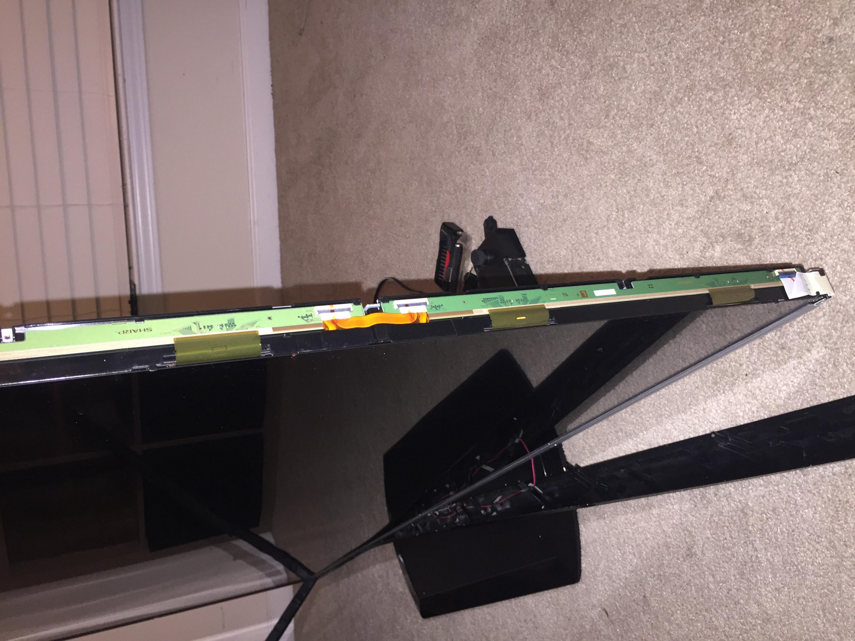

                      Are these the tabs you're talking about?
                      • capwizard
                        • Jun 2016
                        • 1991
                        No oOh My God! It is the one at right side edge. PL.... Wee.......wait a minute. I will upload the pictures.

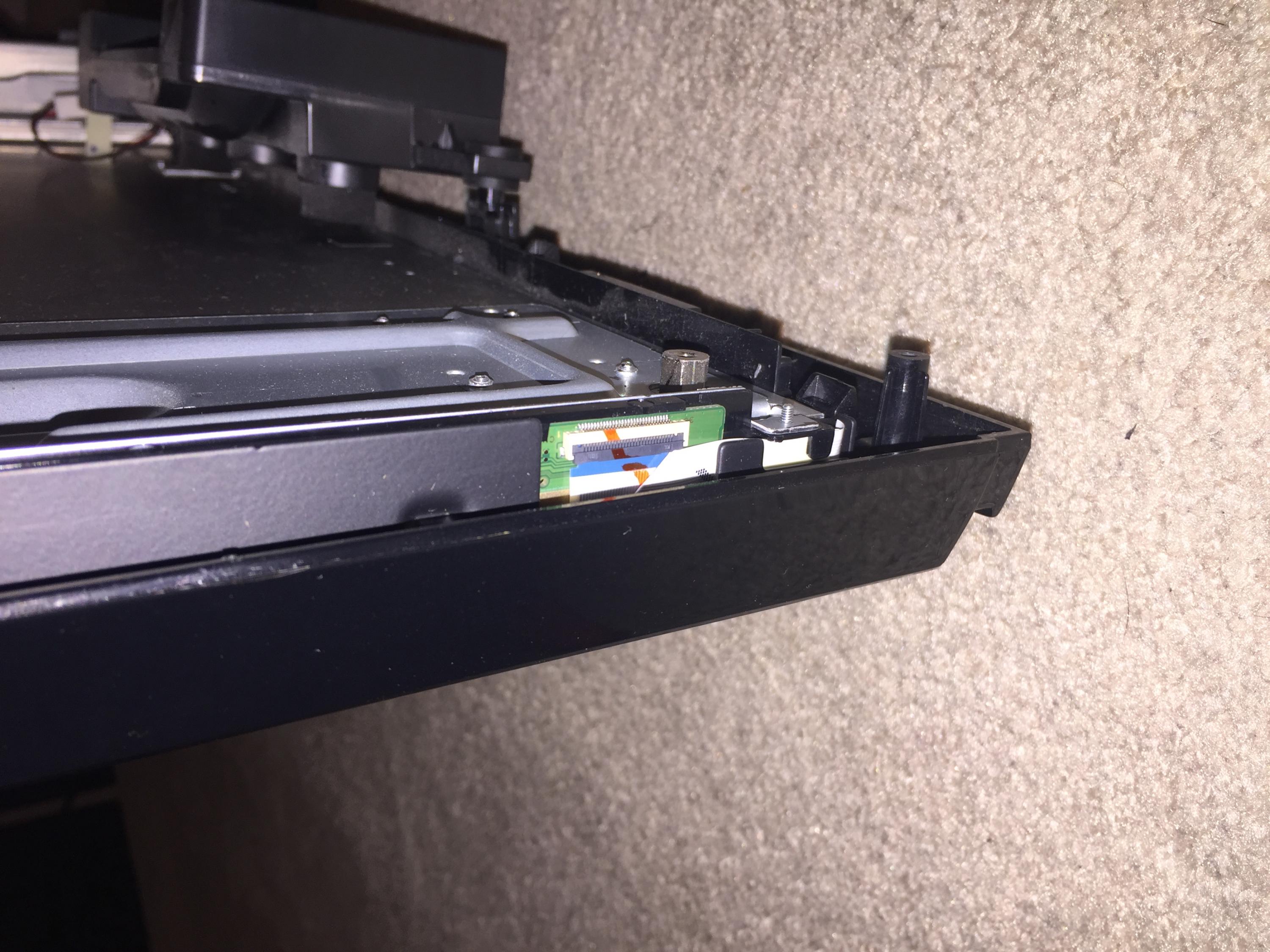

                          Do I have to take the front panel of the screen off? If so, I'm having trouble I don't see any other screws left to "unscrew". What are the tabs supposed to look like?
                          • capwizard
                            • Jun 2016
                            • 1991
                            Please be extremely carefully. Take your time and take it easy. You will need big and flat workplace maybe on the floor.
                            You need to be very carefully remove the front plastic frame then 4 metal bars to assess the screen.
                            PS: My screen Tabs have 3, your screen TABs maybe have 4 to 5.
                            PS: Castrate with Razor Blade.
                            PS: The metal bars have 16 small black machine threaded screws and one side bar (near T-con board) has 6 - 8 metal color longer machine threaded screws. If you could just take out right side of bar but they are interlocked.
                              I think you need to review the threads a bit more. IF I understand your pictures correctly, those are "interconnect flex cables"... they are on "unclamp/clamp" connectors so you can unclamp/reclamp as many times as you want... but it won't solve your problem. From your pictures, IF those are after you disconnected the lower corner cable on that side, then it is likely that those side tab drivers have a problem... assuming that the other side "disconnect test" resulted in no picture.

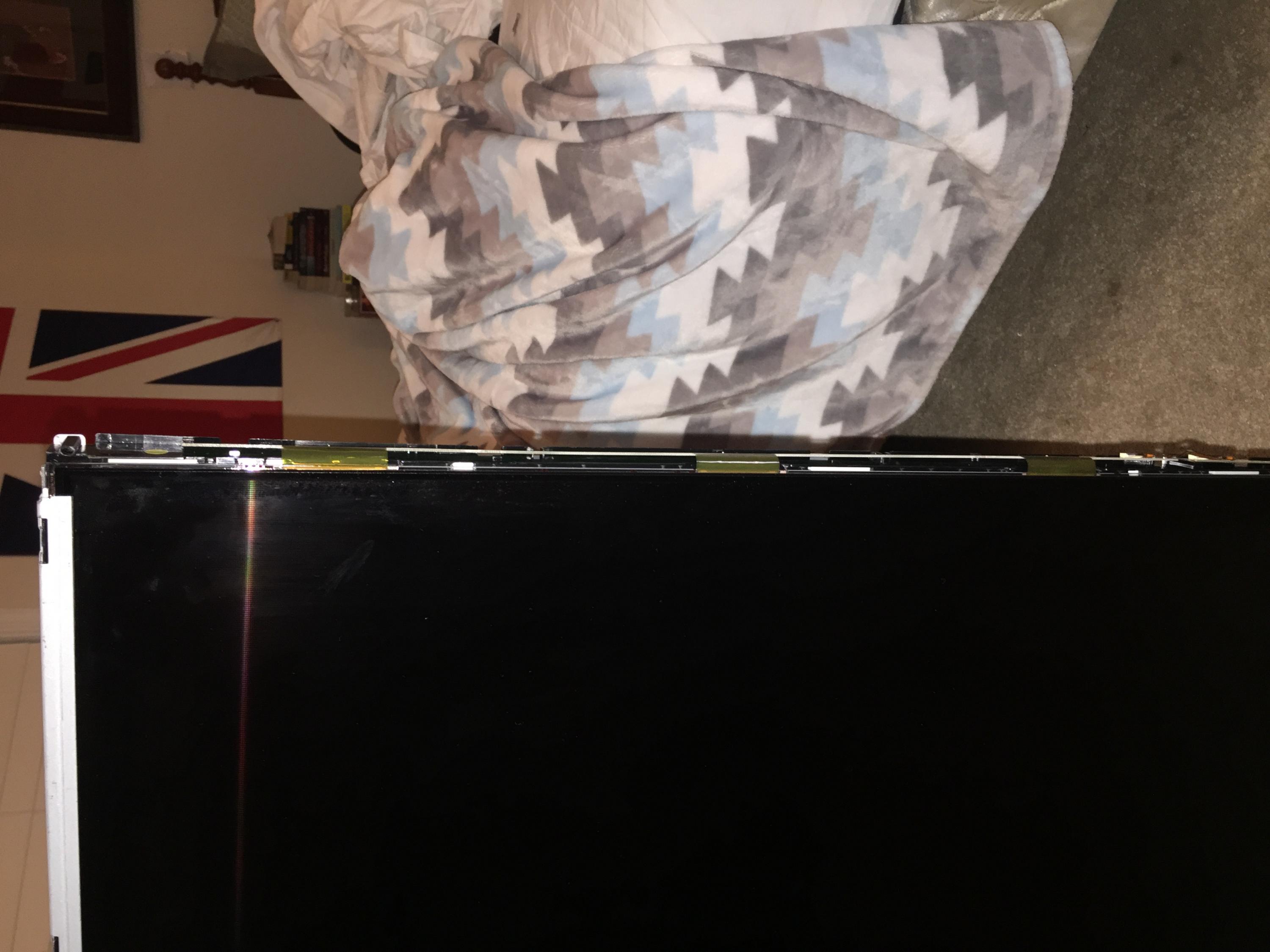

                                    N...No...... not that one ....is you face the TV screen ( When you watch TV) on your right hand side!
                                    Wait......Im uploading pictures.
                                    PS: the TABs are under the transparent plastic strips.
                                      This is what I am looking at on the right hand side... Or do I need to remove all four metal bars to get behind that?
                                      • capwizard
                                        • Jun 2016
                                        • 1991
                                        Heeu..u......YES, See if you can just remove right hand side bar, and you will see the TABs under the transparent plastic strips
                                        PS: it Should has 6-8 small black machine threaded screws
