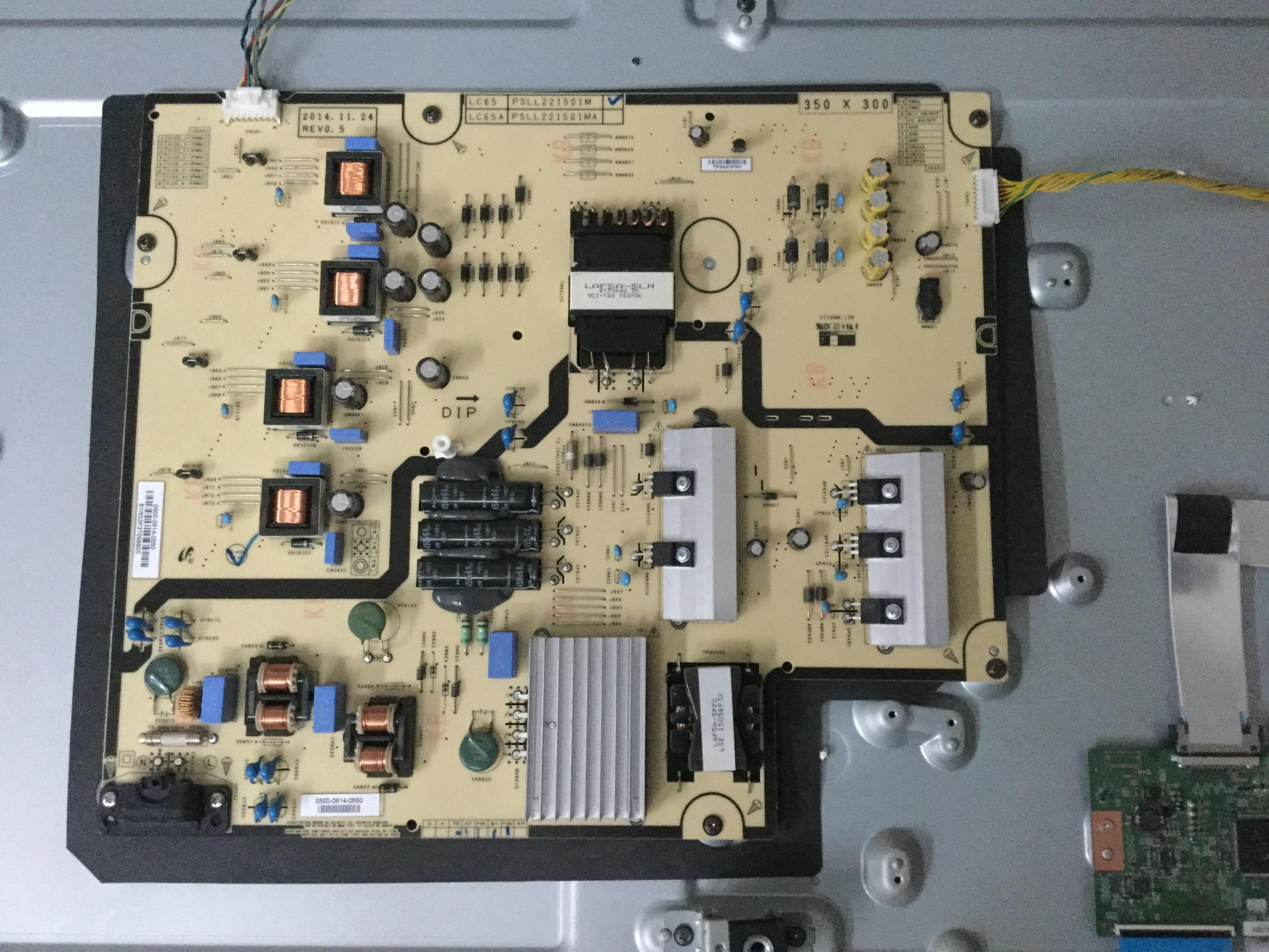

    Hello;
    My sharp TV Model LC-65LE654U just keeps restarting. It starts, I can see the SHARP logo, the logo disappears, the tv stays on for about 40 seconds, and then restarts again. None of the buttons are responsive so I can not turn it off or on, change input, change volume or channel. So the whole TV is unresponsive, but it just keeps restarting after being on for about 40 seconds. Can anyone help me out?
    Thank you

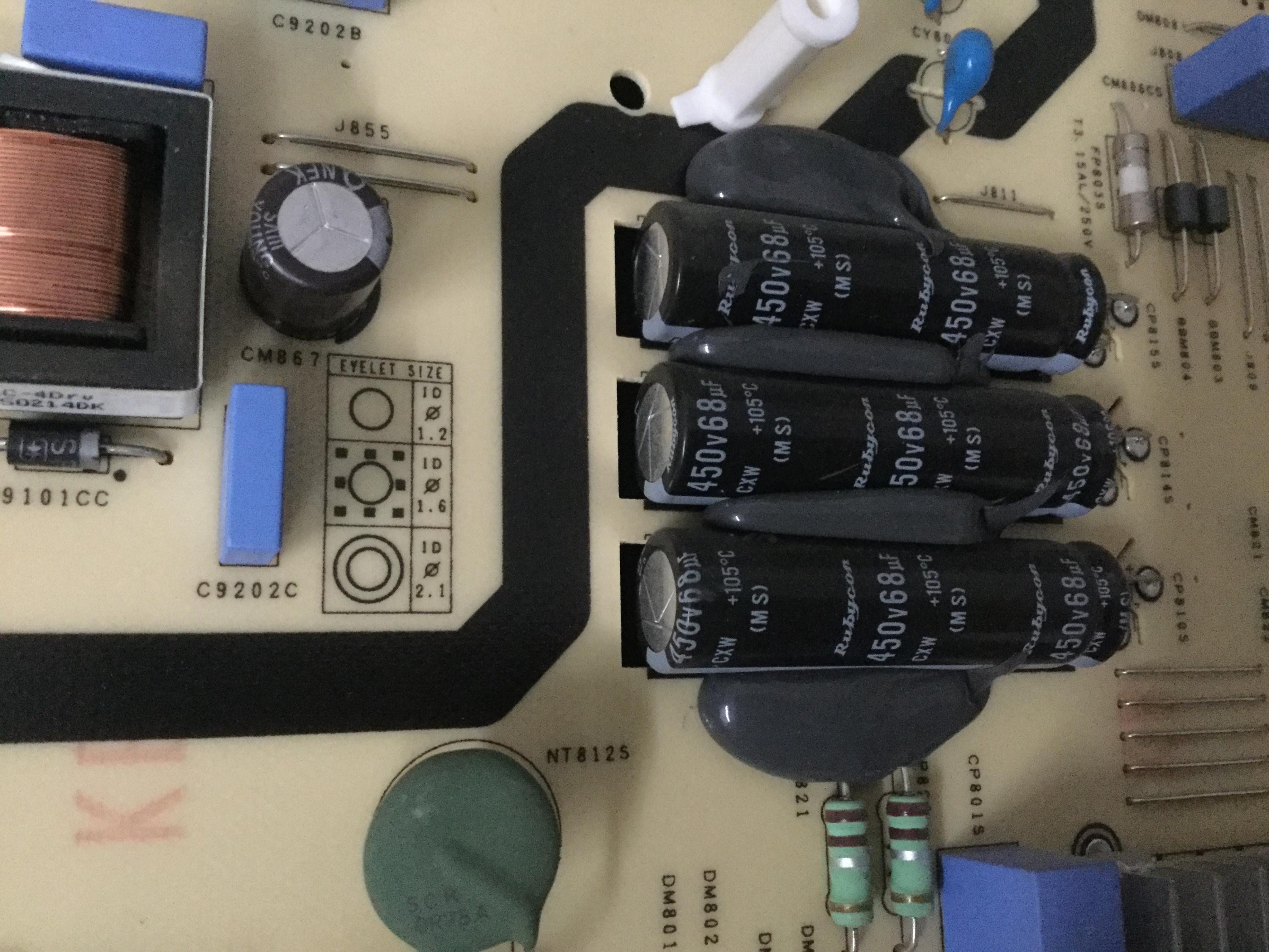

    Well, I did some research and found that they used a combination of Rubycon, Sanyo, and Nippon Chemi-Con capacitors in the supply. The power supply looks decently made as well, so I'm surprised if that's the issue. However, there's two kinds of board, one has all those good caps, the other one has those caps, and then a lot of shit ones I can't recognize the brand on them, they're neon yellow.

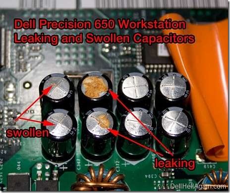

    Now, if you're going to open this, you'll see the board will be on the back of the display, look for any capacitors that are bulged on the top that could also be leaking that look like this:

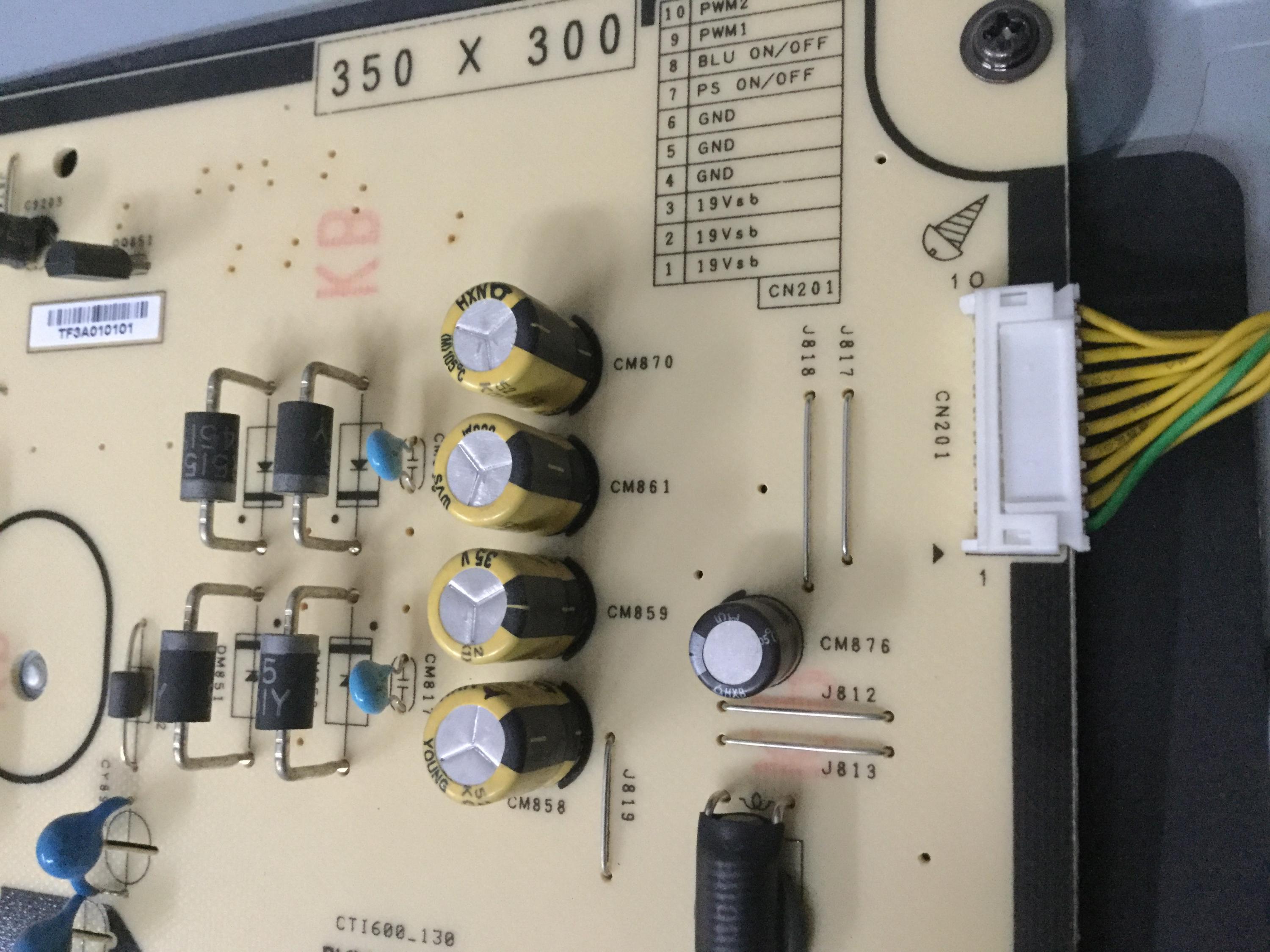

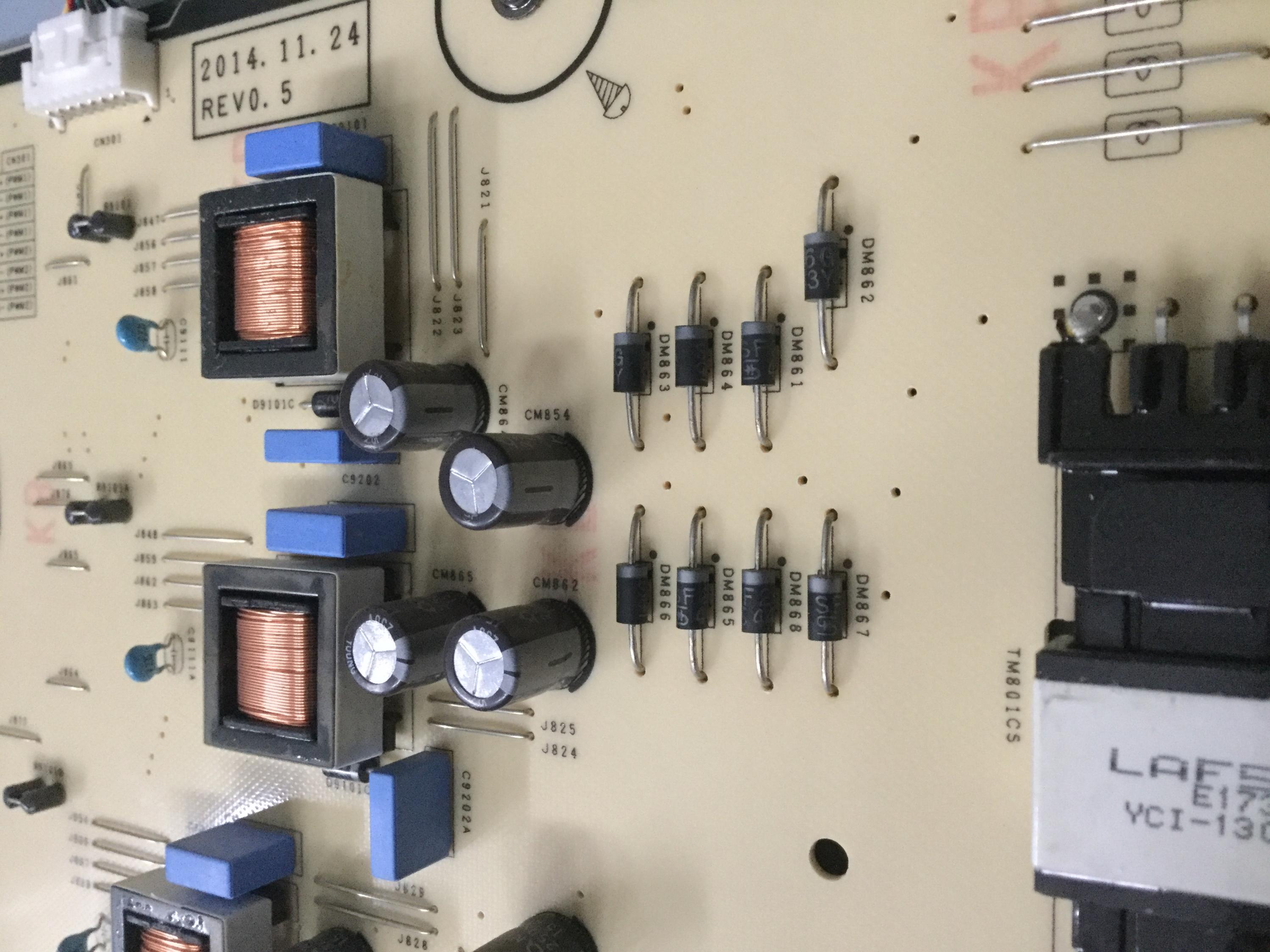

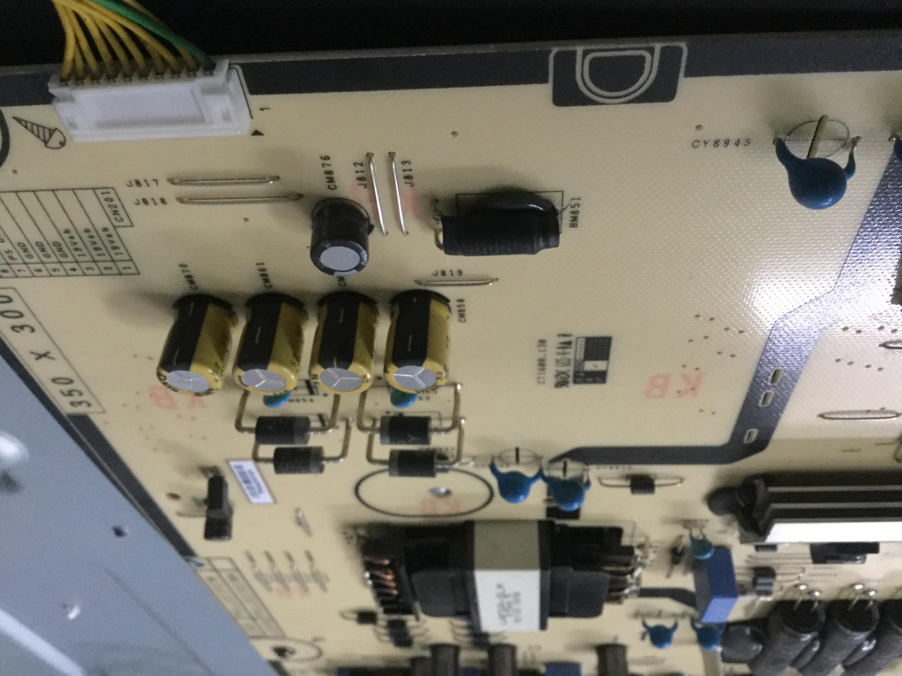

      Thank you for your quick reply. I took the tv apart and everything appears to be good. I included some pictures of the power board. I do have the yellow capacitors. Do you think they are bad?

        I fixed it. Thank you for your reply and help. I saw on YouTube how someone reinstalled the firmware to solve it, and it worked for me. All the buttons work now and the tv is as good as new!!

          Edit: I don't like those neon SamYoung capacitors, but if it works it works and I'm not gonna complain. They seem to be from a cancelled series of capacitor, I can't find them in any current production datasheets, so I'm going to take a wild guess they're not in production anymore.
