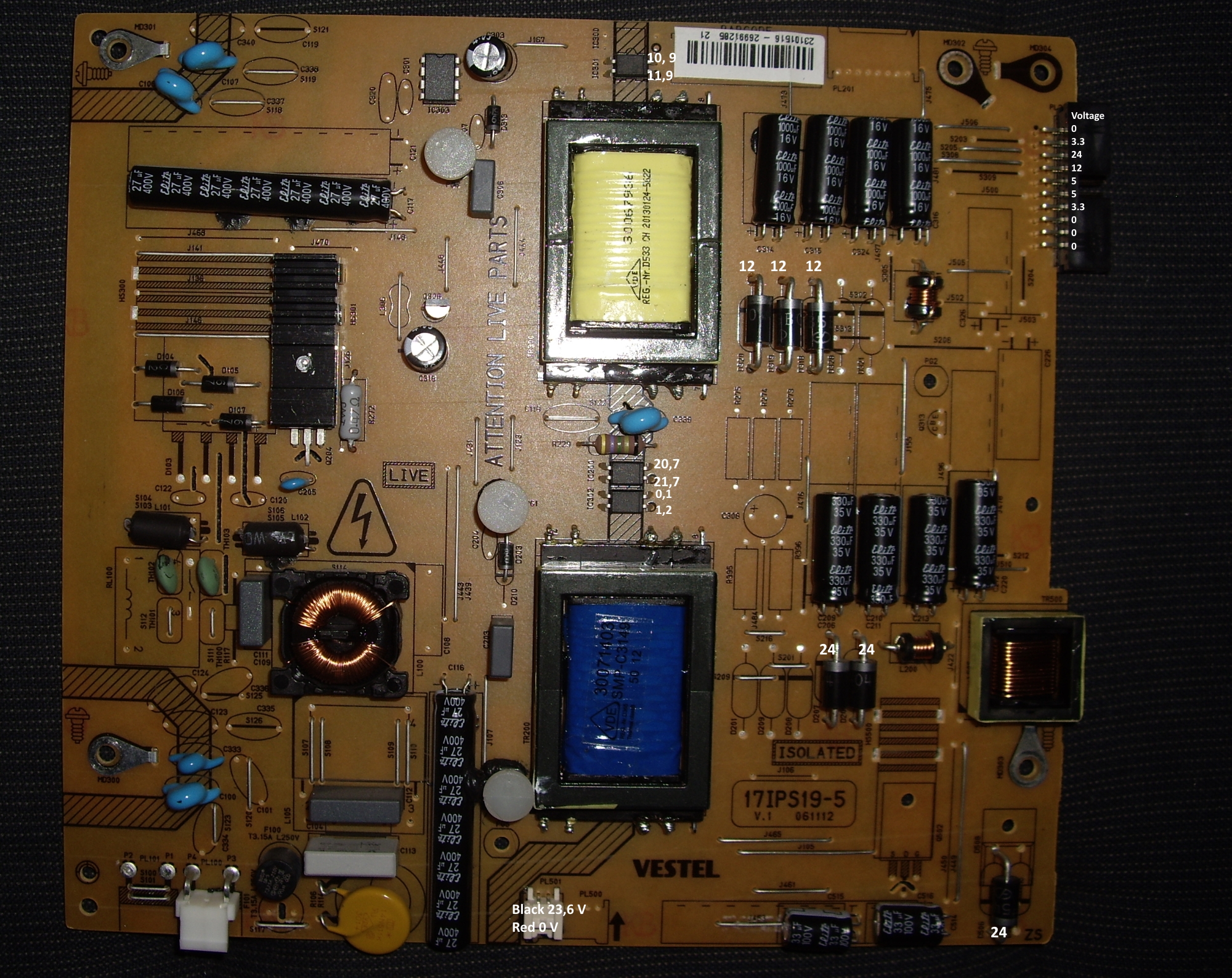

    Hi Guys,
    I have a problem with my 32 inch LED TV. It does not start and only the red StandBy LED is flashing.
    At the connection of the backlight on the black pin is only 24V, at the red pin 0V. No diode is broken. The backlight LED works if I connect a laboratory power supply. Freezing of U10 and U12 did not work.
    I have attached an image with the measured voltages. It would be great if someone could help me.
    Thank you very much
    Power supply: 17IPS19-5
    Mainboard: 17MB82S-1a

            With the mb removed do you get the 24v and 12v on one side of the diodes ?
              Re: 17IPS19-5 LED TV does not start (Flashing Standby)
              Hello, without mainboard:
              The three 12V diodes: 12V
              The three 24V diodes start at 24V and then sink slowly to 0V.
                Well there is a fault on the smp then, have you checked the Led drive area like the mosfet and that for short circuits ?
                    What is the voltage between the 2 legs of C116. It should be around 380V. Place your meter probes on each leg of the capacitor.

                      smp = switch mode power supply
                      Put your meter in diode mode and check D203, D207 and the one along side it. Take a reading with meter probes on each side of the diode and a second reading after reversing the leads. Post the readings.

                        C116 and C117 320V DC.

                          Hi!
                          D203: black anode, red cathode = Impermeable (or leaktight (dont know the english word))
                          D203: black cathode, red anode = 0,562 V
                          D206,D207: black anode, red cathode = leaktight
                          D206,D207: black cathode, red anode = 0,389 V
                          D506: black anode, red cathode = leaktight
                          D506: black cathode, red anode = 0,423 V
                          D318,D319,D320: black cathode, red anode = 0,213 V
                          D318,D319,D320: black anode, red cathode = 0,837 V
                            What voltage do you have between pins 1 & 7 of IC201. Meter set to DC volts and measure with care so as not to short out any other pins.
                            Pin 1 often has a dimple in the top of the IC alongside it and the pin numbers go anticlockwise around the chip.
                              Without Mainboard (i had to turn the power supply): 15,2V.

                                According to the data sheet IC201 (PWM controller IC) has a minimum startup voltage of 14.5V with typical 15.5V so it looks as though that IC is OK.
                                Check the following components with your meter in ohms or Kohms range
                                R211, R210, R220, R272, R212
                                Also with meter in diode mode
                                D202, D208, D206, D207, D201, D209 (if in circuit)
                                Finally check Q203, Q204
                                https://www.youtube.com/watch?v=gzh8ICLMXzQ
                                https://www.youtube.com/watch?v=RkWy1EirEu8
                                      D318,319,320 I had already soldered. All OK.
                                      The resistors have to solder, too?
                                      What about the LED driver IC (3394)? At the background connection the voltage is missing
