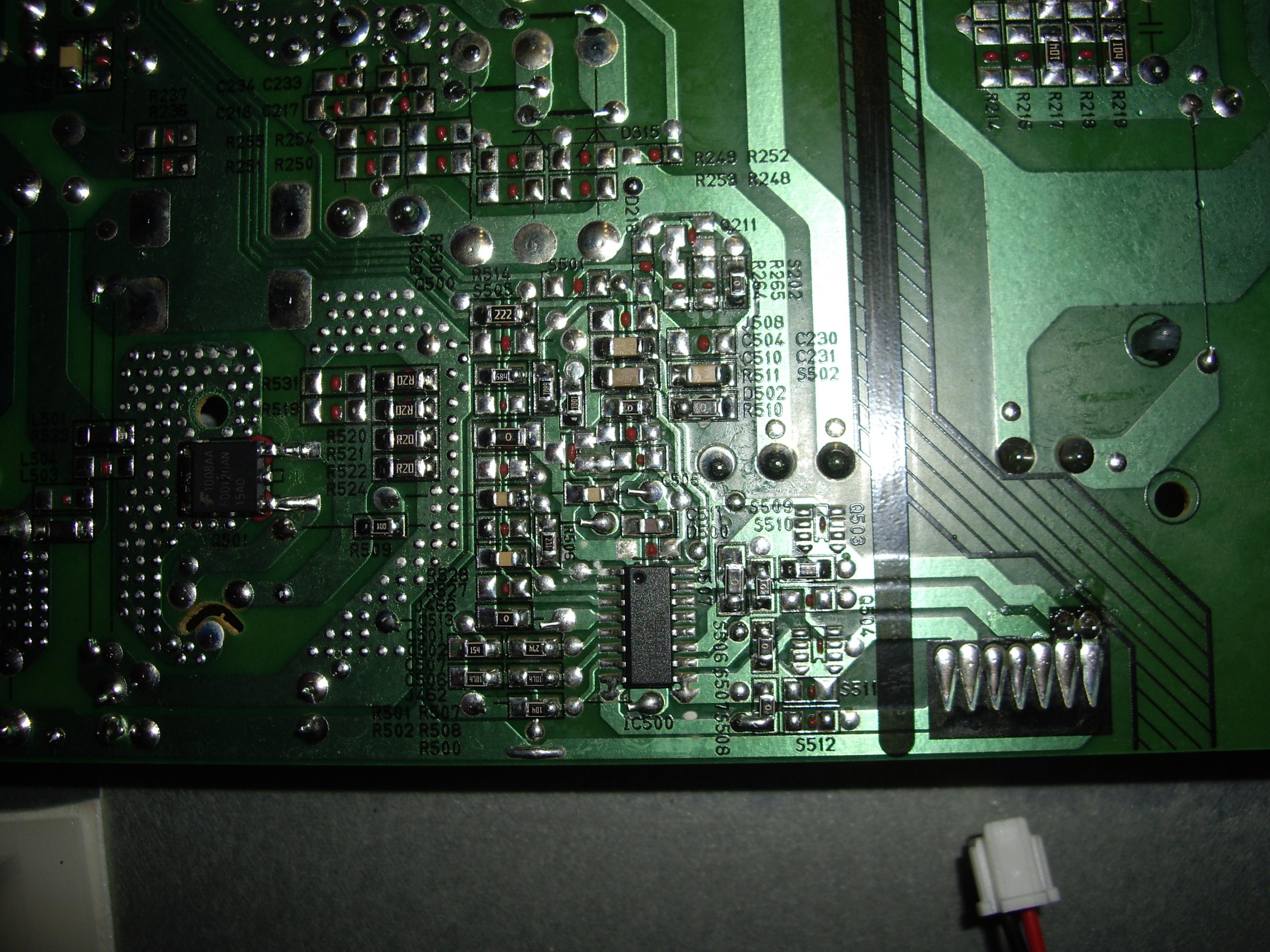

      Circuit only D506
      Anode: 24V, Cathode 23,6V
      D207, D206: Cathode 24V, Anode -3,0V
      D318-320: Cathode 12,2V, Anode -0,5V

        Re: 17IPS19-5 LED TV does not start (Flashing Standby)
        OK. I read that the 24V supply was dropping and was trying to trace why, but you say it is steady.
        So it is a backlight driver problem and you have verified the leds as working.
        If you can say what the voltages are on the diodes above may be helpful.

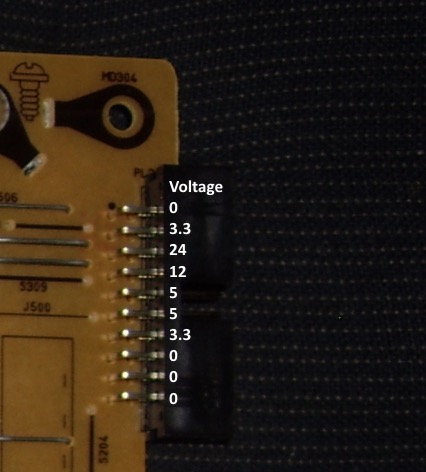

                                          Hello.
                                          I'm writting here because I have the same simptoms in my 32" Telefunken.
                                          Model: D32H127N2.
                                          Inside is a Vestel 17IPS18-5 V.1 with the MB 17MB82-1a.
                                          On the metallic case is a label with Model:VES315WNDB-01.
                                          I wrote at this step because between the pins of C116 there are only 210V.
                                          The diodes(12/24V) are ok, they are not shorted, but at both ends of diode D506 are 24V.
                                          On the PL501, on the black wire pin ,23V and on the red 2V.
                                          On the PL200 connector toate MB the voltages are like this:
                                          0V, 3.3V, 23.8V, 12.2V, 5.1V, 5.1V 3.3V, 0V, 0V, 0V.
                                          But still there ist no Backlight and the standby LED flashes continously.
                                          Please help.
