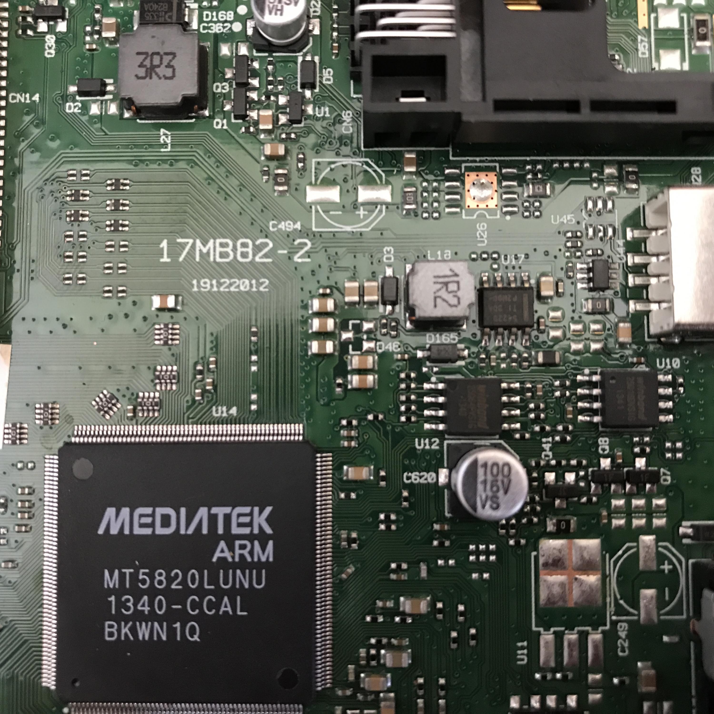

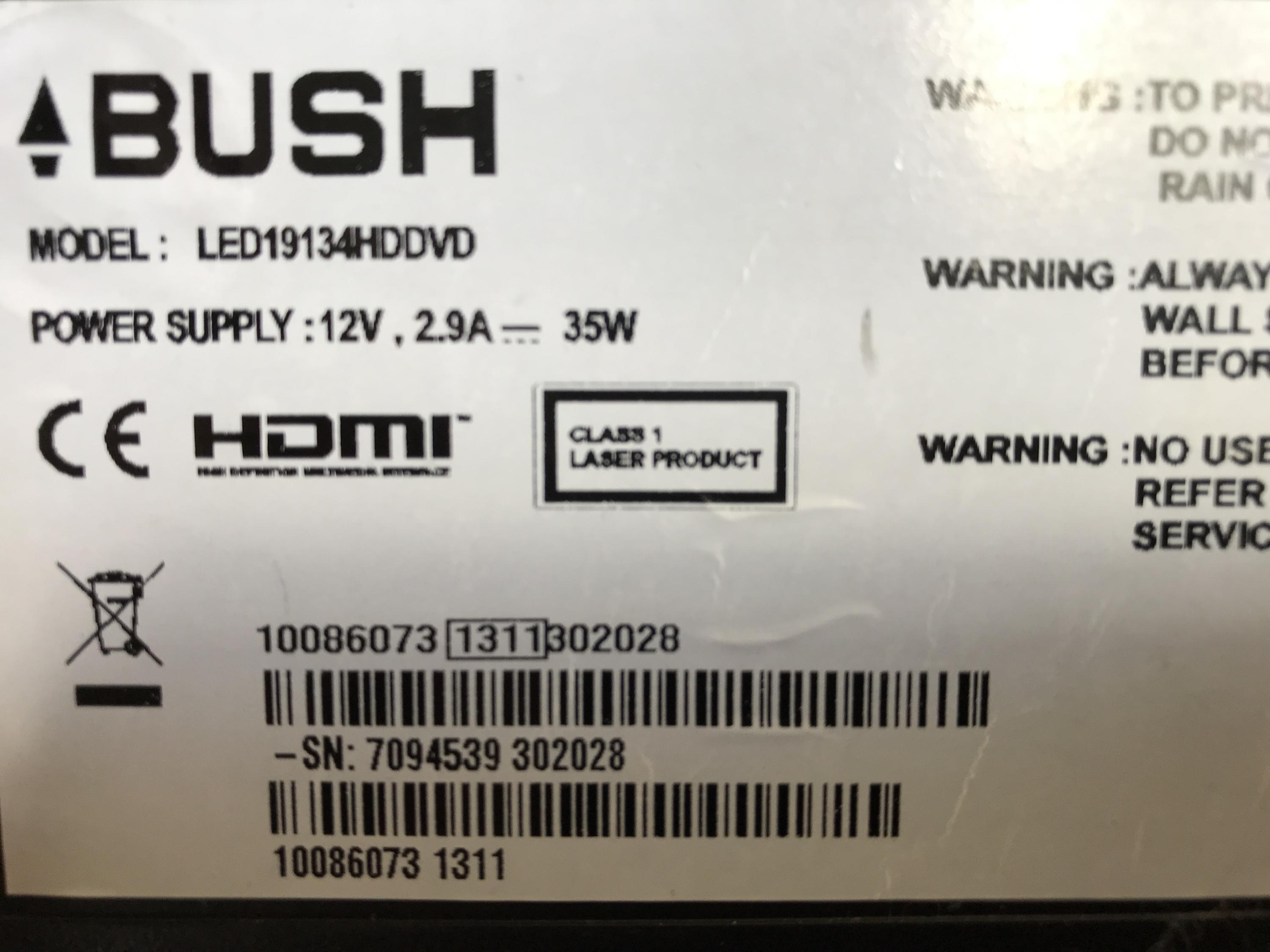

                        #171
                        Re: Eeprom dump thread!
                        Hi, guys how are you?
                        Here I have Bush TV. Model: LED19134HDDVD
                        Mainboard: HannStar 17MB82-2
                        The problem is 'power light flashes 5 times'. I think that the problem is in EEPROM.
                        Would you guys help me with dump file for this model, please?
                        Thank you in advance.

                          • antas
                            • Jul 2014
                            • 148
                            • Ireland
                            #173
                            Sorted with flash for Technika19 (both bin files added)
