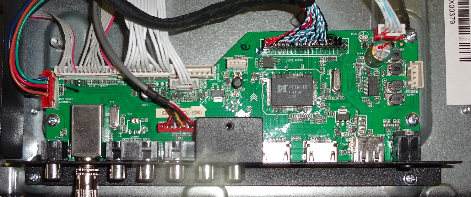

    RCA led32c45rqd found to have a bad main board so I bought one off ebay and it works however the picture is now upside down. Nothing in the TV settings to change this. all the connectors fit only 1 way except for the one to the TCON and I tried turning it around but then no picture. Anything I can change? or do I need to send this back?

    You could swap the EEPROM over and hope the old one was not faulty
    What's the mainboard number and panel number. Someone may have the software for it.

      turn the panel 180 degrees ..

        Did you order the board by the part number or by the model number? I know those RCA tv's usually have multiple main boards for the same model that go to different panels.
        Yep. SJ shows at least 2 mains for that model that use different panels.

          Can you send me a picture of the menu please?
          Can you access the service menu?

            Have you tried Menu, then 1147. Service menu for some RCA
