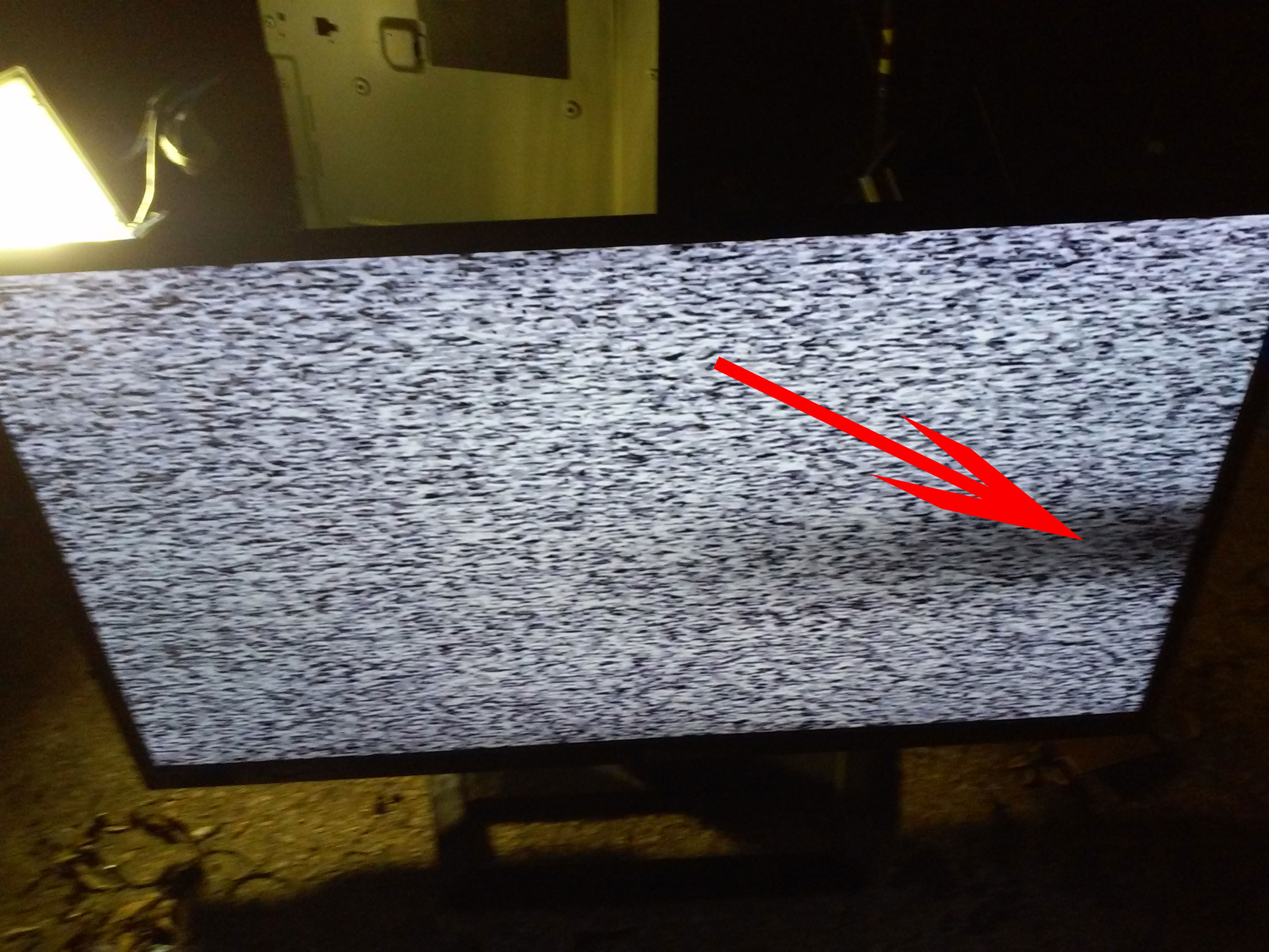

    Any idea what the cause of this could be? I have a dark spot on the right side of the screen. When I go to the menu and turn screen off, and then press a button on the remote to turn screen back on the dark spot is gone for 5 seconds. Every time I do that the dark spot goes away for 5 seconds and comes back.
    I originally presumed it was a bad LED.... but it doesn't make sense to me that it would work for 5 seconds then stop!?

    This is an edge lit tv and its clearly one of the banks of edge lighting failing. The fact it works for a few seconds is weird.
    If i had to guess that bank on the right side has a dead shorted led and the PSU is shutting down that PWM bank when it detects abnormal draw.
      Re: LG 55LM4600 faulty LED Driver or Backlights?
      It does look like some LEDs in that section shorted out so the circuit goes into over current shutdown.

        Was hoping it wasn't bad LEDs. Kind of figured it was but I thought if LEDs are shorted they don't work at all.
        I'm going to take the panel apart when I wake up in the morning and test all the LEDs.
          LEDs are connected in series to form LED strings, there may be 4 strings of LEDs used in that panel, so if some are shorted out the rest if the LEDs in that string will still light up, like Christmas lights..

              I took out the strip and tested the LEDs one by one with a battery. They all lit up and were relatively close in brightness. Also in the attached image if I touch my meter probe or any metal tip on the PDIM and PDIM2 (J47, J44) jumpers the backlights flicker.
              Leaving the TV on for a while the left side LED strip starts acting up in the same manner. Which is really confusing me. Why would the other LED strip start acting up much later?
              When that first section of LEDs cut off, they are actually still on with a very faint glow coming from them.

                I would have plugged the strip back in and let the tv drive them,that way you could see them fail after a few sec. Battery testing them prob didn't trigger the defective one.

                  It's most likely an LED failure at full operating current. The battery test is good to weed out open or shorted LED's, but it really doesn't test the LED's under normal operating current and after they heat up. I had the same problem. I operated the LED's normally with it taken apart so I could watch. I sped up the process by using a hair dryer on the suspected defective area. One LED would open up and the whole strip of 6 goes out (in series). Turned out to be a bad solder connection to the LED.

                    Plug the LED's back in, put your DMM to DC V and probe each LED string while turning the TV on. That will give you a clue on which string the problem is. LED's can fail like that. They may work for 5 seconds or even 5 or 20 minutes then go out. You can try to turn the back light down to next to nothing and probably the LED will stay on longer.

                      I realize now how stupid I am! I found the bad LEDs but these things are way too hard to remove! So I'll be ordering new strips instead, and I'll post my final result when I get the TV back together.
