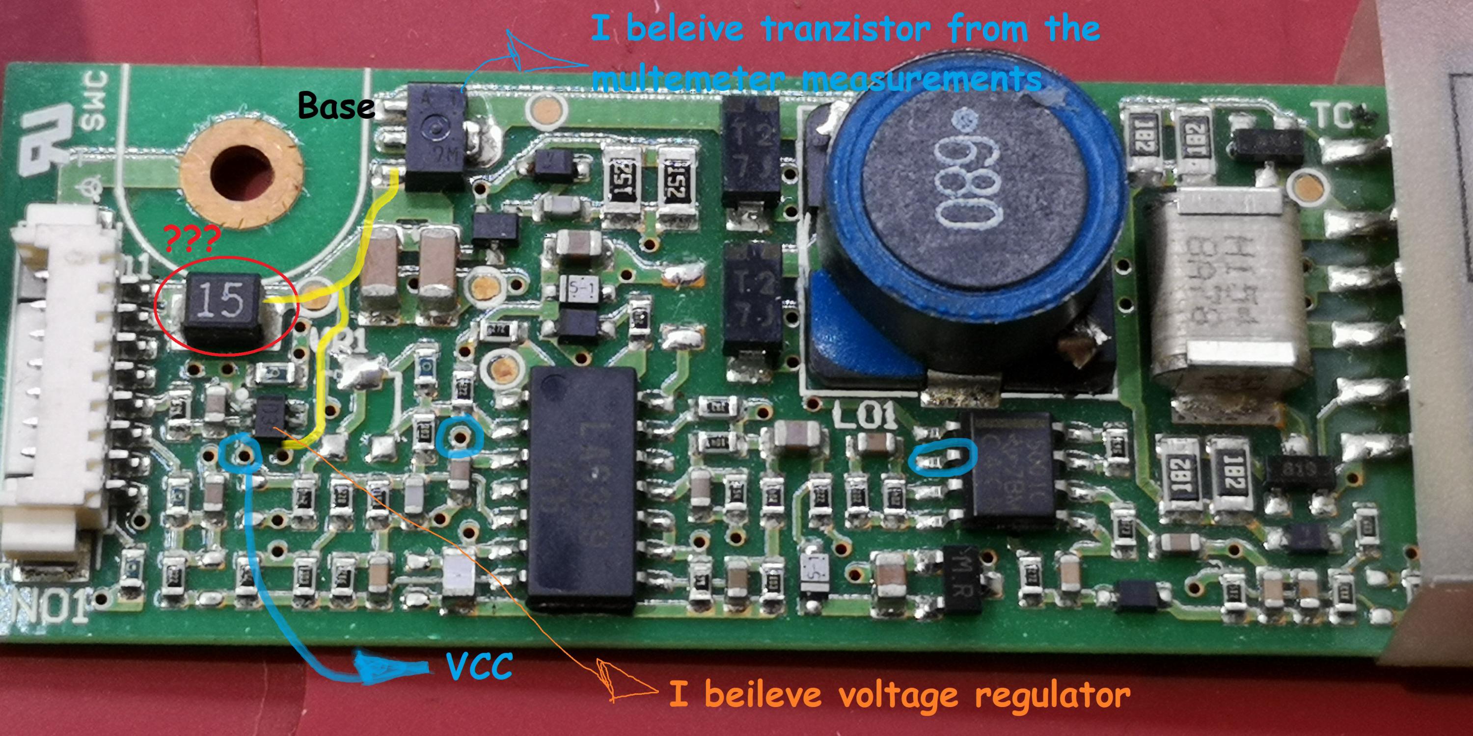

    I have an "LCD Backlights Driver" and it is not working. After measurments and checking the routes of the PCB I beleive that this component on the red circle is a choke for filtering the supply voltage and block noise from the inverter to go back to the main board. When I measured in ohm and in diode mode with multemeter shows always OL. I shortcircuit this component and it worked. The current that I measured with multemeter is 550mA, so I want rated current 1,5x550mA=825mA~1Ξ‘. Am I right that this is a choke and if yes what value do you beleive is (maybe 15uH or the 15 on the component is just an SMD marking code?)?
    Do you know in which category I have to find it?

    It's actually a 1.5A fuse.

      some have 2 amp fuse https://www.alibaba.com/product-deta...471564681.html

        Thanks all of you for your replies. This type of fuse consider slow, or Medium, or Fast blow?
        Fusing characteristics: Within 1s
        https://gr.mouser.com/c/circuit-prot...16%20metric%29
        I found this below. The broken was 1.5A/75V/1sec@250%of Ampere Rating and the replacement I found is 1.5A/125V/5sec@200%of Ampere Rating. Do you beleive the difference in the time will not safe?
        https://gr.mouser.com/ProductDetail/...nbZDuW6Q%3D%3D
