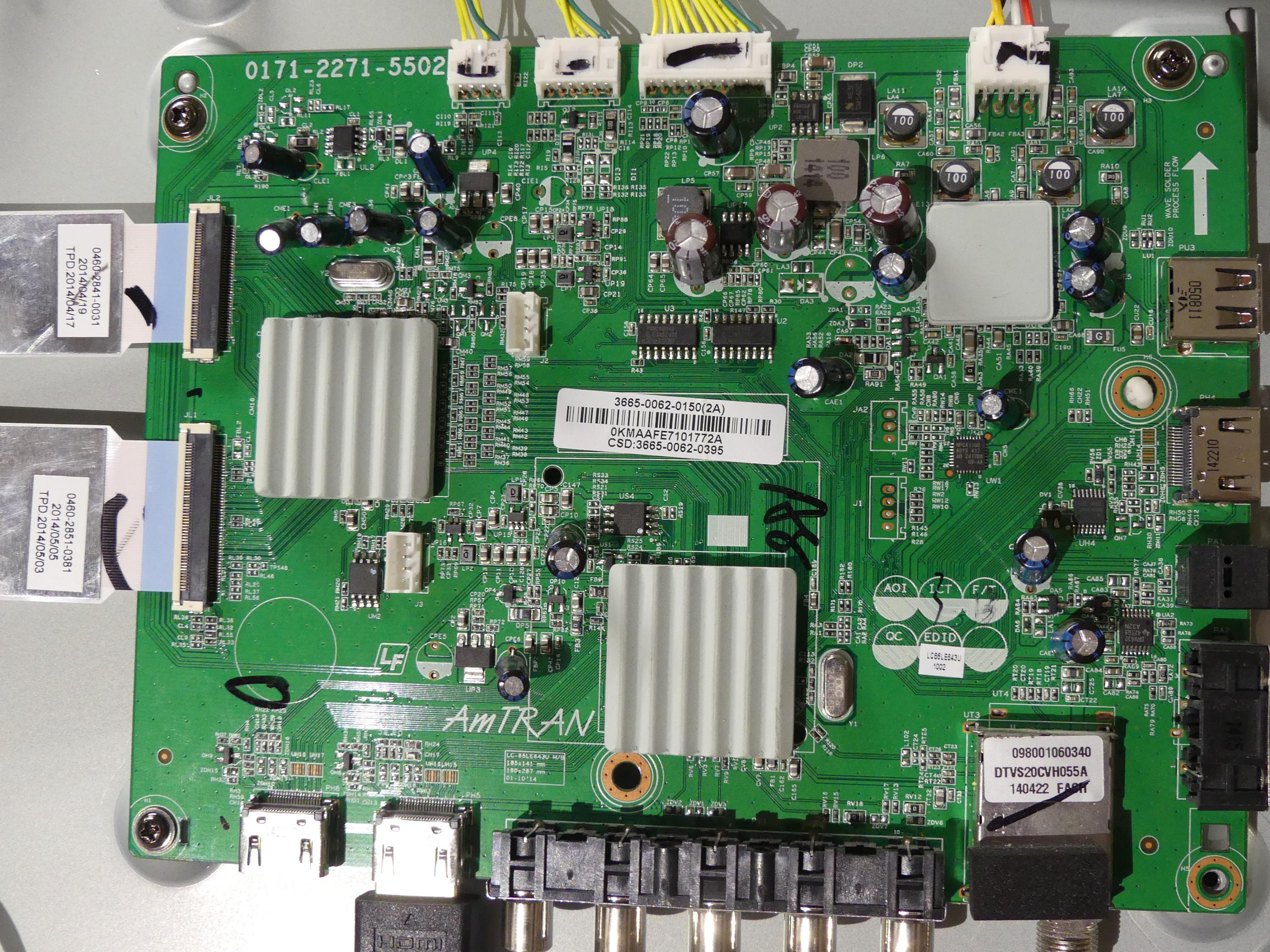

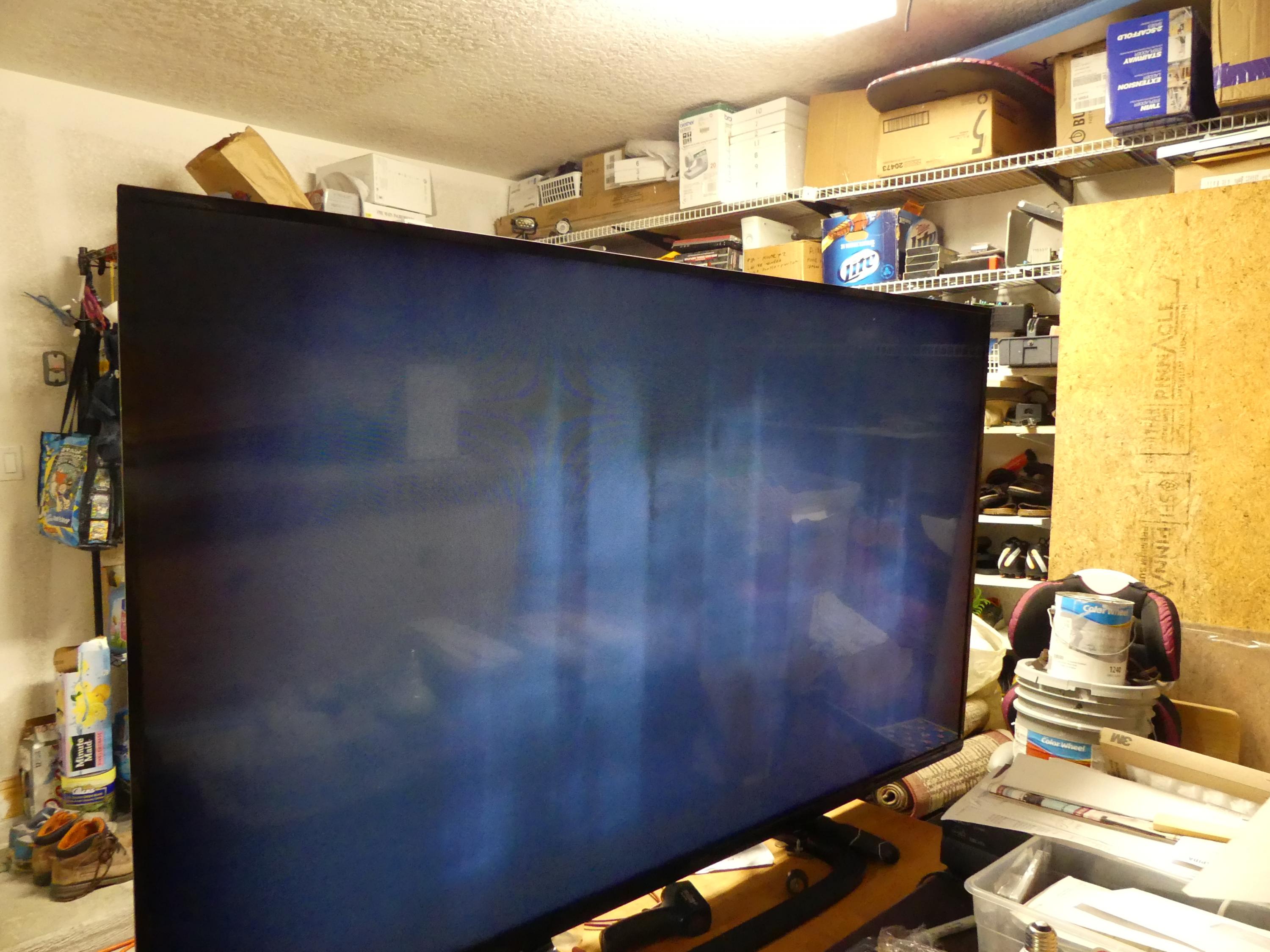

    Got this tv. sharp lc 65le643u without video or sound . Power up and back-light work. Screen start to get white from center to edge 3-4 seconds after start.
    My dilemma start after i replace main board (used) based on fact that was no sound, no video. Replace board and i think tv start when i plug in the power cord.I can see on screen (right upper side) text" no signal" and i turn back to plug a hdmi cord . When i look back i can see the screen get white again ,still
    with this board i have sound .

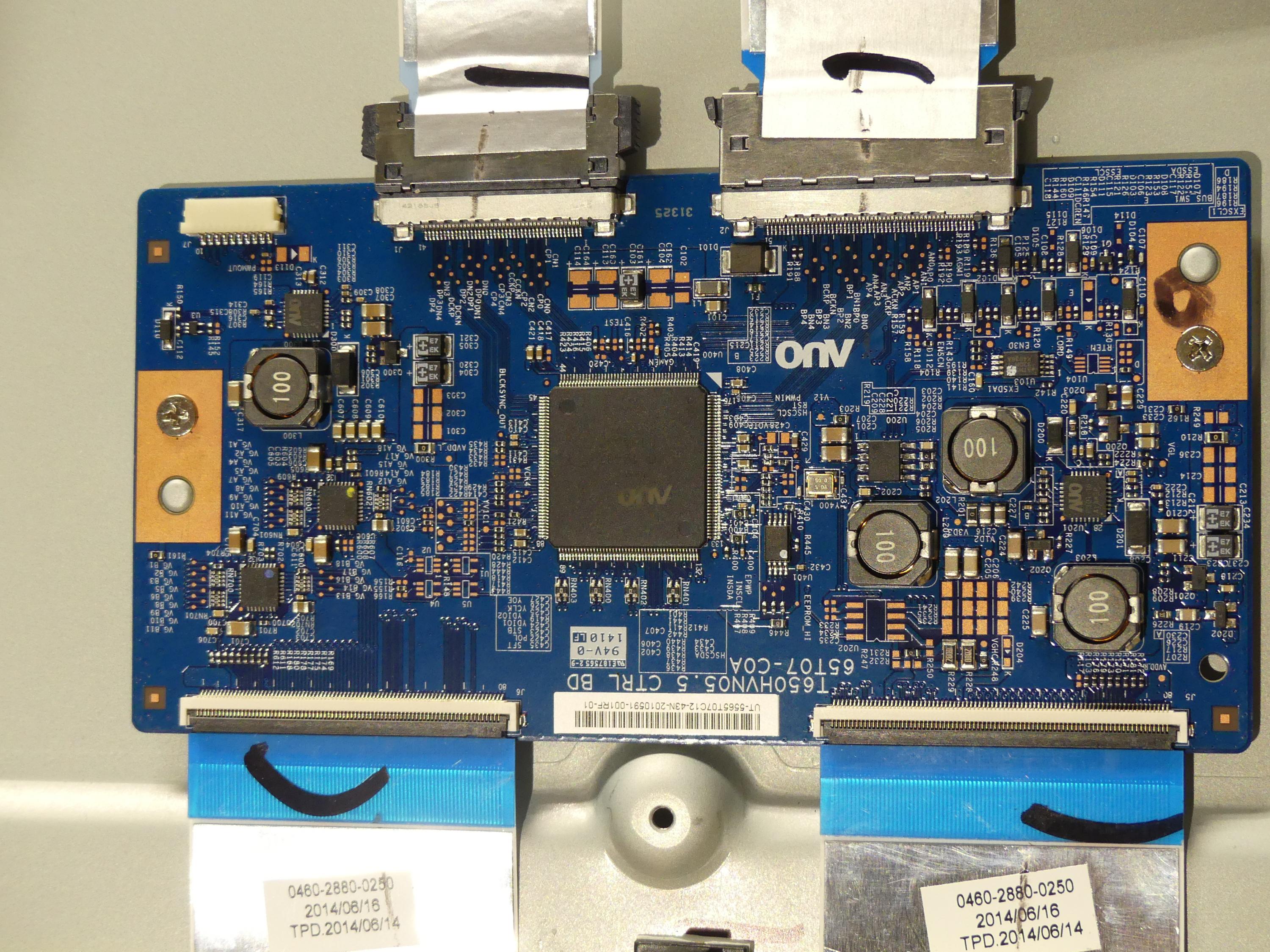

    i order a t-con board that does not change anything . anybody run in this problem? Should i return that main board that look it fail .
    main board voltage (19v) is 19.46V ; 12V for t-con is ok .
    The screen look good also . i have a voltage regulator on main board (the replacement) 5v to 3.3 that is not working. Thanks for any advice

    Did you have white screen problem originally or after mainboard replacement? Do you have voltage on both sides of fuse on t-con

          Unplug one side of tcon at a time and post results.

            Unplug left side bottom cable ( to screen) that side of screen remain dark and the other half get white . With the right side disconnected, right side screen remain dark the other side get white.
            when i disconnect the top cable (from main b.) left side , the screen get white . when disc. right side- screen stay dark(that is the side that power the t-con). -

              I mention that i am missing a 3.3v on the replacement board (main), i am not sure how that happen. it is the UP18, that circuit should drop 5v to 3.3v and feed UP4 3.3v to 1.8v .serial on circ. is RSAIH or RSAHU ( different board). Can't find this online any suggestion ? that circuit is defective for sure.

                Have you tried swapping 3.3v reg from old board?

                    You could apply external 3.3v voltage and see if it works

                      I think about that .I will try and post back. Found the actual part name LA8013ACD.I search for it with little success.

                        Back with good news . I connect 3.3V from an external p.s.u and video work. Had to replace the LA8013 defective with one from old board, did that and work . Thanks for feedback . Problem solved.
