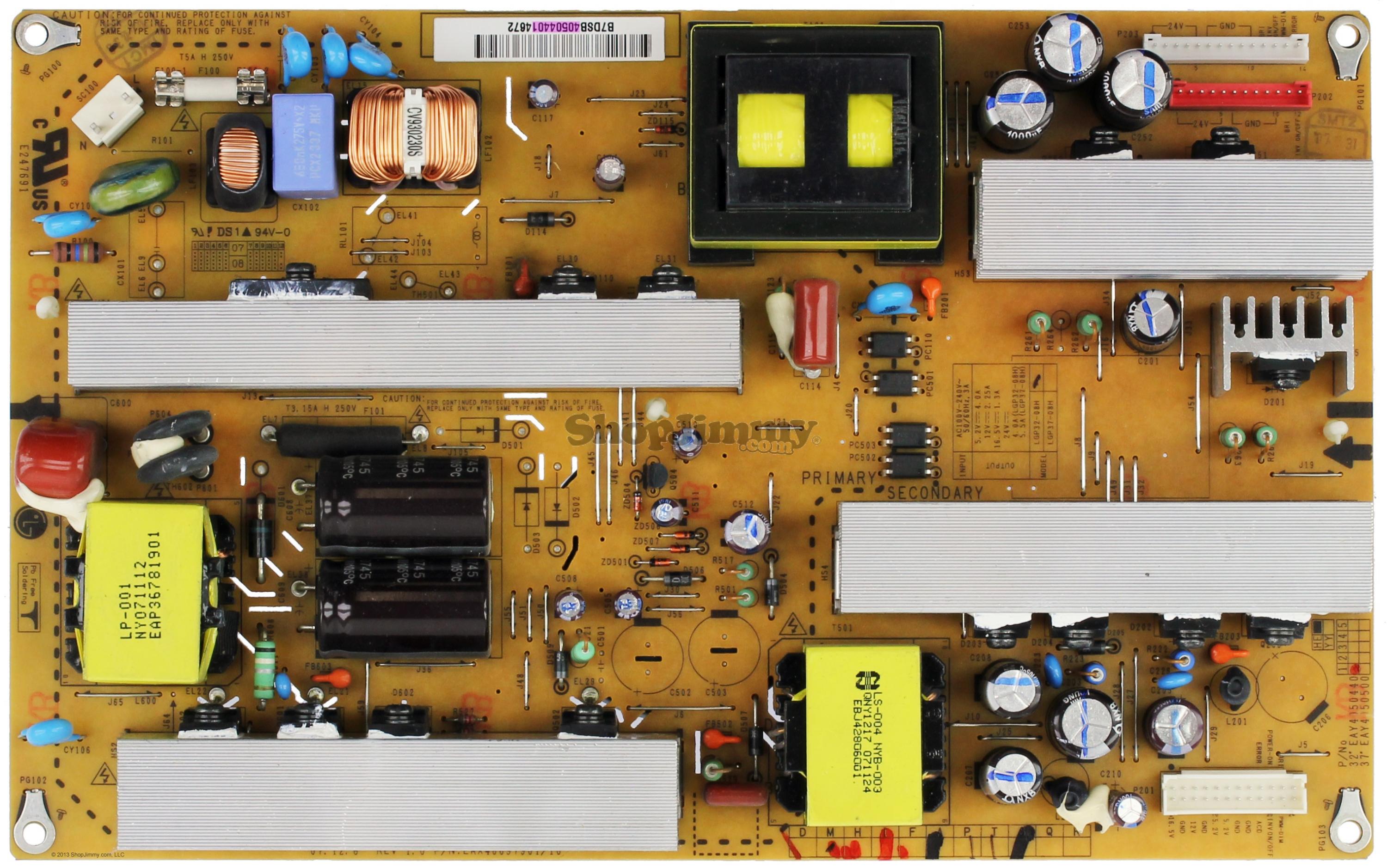

LG PSU EAY40504401 (LGP32-08H) repair
  • Chungalin
    • Jul 2014
    • 422
    • Spain
    I've seen this board incorrectly refered as EAY4050440, because last digit is a dot in a matrix (see right-bottom corner in attached image). I've always seen "1" marked, so real LG part for 32" is EAY40504401 (LGP32-08H).
    For 37" it's EAY40505001 (LGP37-08H), sharing the same PCB, only primary mosfets change.
    It can be found in LG 32LG3000-ZA model, among others.
    I've found schematic too.
    I haven't seen any of these fail of secondary capacitors. They have more subtle failures in primary side.
    One common failure is at SMD resistors in series R609, R610, R611, R612 (620kΩ x4 = 2,48MΩ ≈ 1MΩ + 1MΩ + 470kΩ). This affects PFC.
    I've one that after some minutes (cold start) it drops AC Detect signal ("ACD") but keeps generating 5V Standby. Haven't found solution to this one yet.

          Re: LG PSU EAY40504401 (LGP32-08H) repair
          I have swapped one of these power boards (LGP32-08H) in a faulty TV, because someone has worked on it before me, and did a messy job. The TV works fine, but as curious as I am, wanted to repair this PSU.
          I have ordered the replacement parts, soldered everything in place, but it has a weird symptom. T101 transformer ticks. It has a weird ticking sound, every second. Needless to say, it doesn't have steady output on the secondary side. Viewing with the scope, it reveals that the voltage rises about 20 percent over the nominal rail voltages (eg. 24VDC rail shuts itself down at around 30V) then the cycle repeats every second. I have changed so far the following: U102, Q110, Q111 (these drive T101), U600, Q601, Q602 (these drive the zero crossing detector L600), every optocoupler, and every capacitor that has anything to do with the VCC voltage of the ICs above. The only part I didn't touch is standby, because it is always steady, and from its transformer (T501) comes a switched 12V on the secondary side, which is also solid. Also replaced U251 (TL431), with no luck.
          If someone could help me out, that would be great.
          The schematic is found in the first comment.
          Cheers, Janos
          • R_J
            • Jun 2012
            • 9556
            What is the VCC voltage on U102 pin 12 and is it steady. ou should have VCC on Q114 collector and also the emitter if Q114 base is turned on
            Were any of the parts you replaced bad? Were the fets shorted? if they were shorted are the gate drive diode and resistors ok.
            Is the PFC ciruit working, what is the voltage on F101?
              R_J,
              first of all, thank you very much for your time.
              Voltage on F101 also fluctuates (385-405V) according to this ticking noise.
              VCC voltage is 13V, and goes to 12.5 when this sound appears. So I can say, it also varies, but not so much. I have replaced C512 (main capacitor for VCC), but nothing changed. Nothing seemed bad before the replacement, but as I said, someone has already worked on this before. U102 were completely shorted, and R118-119 were 12K (on schematic they are 10K), so I changed everything back, according to schematic. Only the FETs are different, instead of 04N60 I only got 10N60, but this should not be a problem.
              I made one interesting test. Changed U600 (SG6961SZ) to FAN6961, and now VCC is 15V, but U102 won't start T101. Strange, the two ICs should be the same. Have you seen such thing before?
              Cheers, Janos
                It seems your vcc is too low, Q505 is the vcc switch and Q504 is the regulator, It has ZD504 16 volt zener on the base so you should have around +16 volts for you VCC to the ic's That 12.5~13 is just on the border of them running
                U600 is the pfc boost driver ic, if you were getting 385~405 volts before, the ic was working. I suspect when you changed it now your pfc is no longer working. that would explain why your vcc came up also, no current draw by u600/u102.
                You changed C512 but I would also change C511 & C510
                What schematic are YOU using, the on from post #1 has R119 at 30Ω, R118 is 10k
                Did you list the wrong number and that should have been R117 & R119?
                If those resistors were bad, I suspect D116/117 and r119/120 may be bad also
                  With FAN6961 it won't start at all, but VCC goes as high as 15V. At the emitter of Q504 the voltage is 16.9V, so I would say it is okay.
                  As you said, something is not working around the PFC. I think I have narrowed it down to the zero crossing detector. So, in theory this PFC chip should "see" when the AC line is 0V and start a new switching cycle (if needed) to keep the voltage on the capacitors around 400V. BUT mine wants to start every second, and as I see on the scope, it doesn't recognize the zero crossing. I will try to figure out why, and if I succeed, I will write the results.
                    But your pfc circut WAS working before so why did you change U600? put back the original and get that circuit working again.
                    I suspect you are only getting about 325 volts on F101 now.
                      I wrote that the voltage also fluctuates (385-405V) so I was thinking the PFC was working, but only partly.
                      But now I have good news, there is some progress. I removed U102, and the voltage on the boost capacitors are rock steady 404V. This makes me believe that there is something wrong around U102 indeed.
                      Fun fact: the circuit still doesn't work with FAN6961. So here must I make a note, that SG6961SZ and FAN6961 are NOT interchangeable.
                            Good news, everyone!
                            I found the bad component. It was ZD115, a 7.5V zener diode.
                            In my circuit it was a firm 80 Ohm resistor.
                            After replacing it, the PSU is up and running!
                            Thank you R_J for your help!
