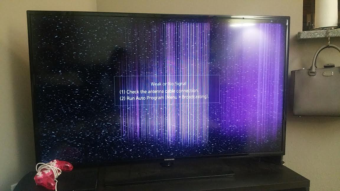

    Posting this for a friend:
    Samsung UN50J6200 recently went to purple streaks and double images. The problem persists on all HDMI inputs and when the TV menu is accessed.
    Almost immediately after turning the TV on:

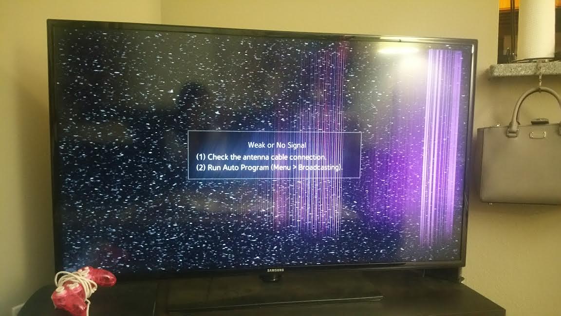

    About 5 seconds later:

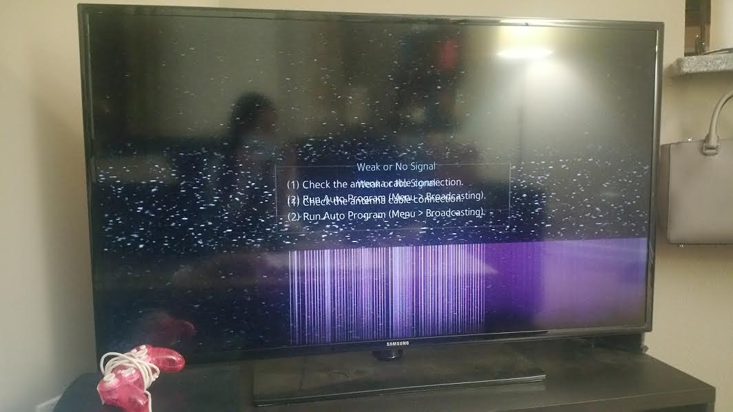

    About 10 seconds later:

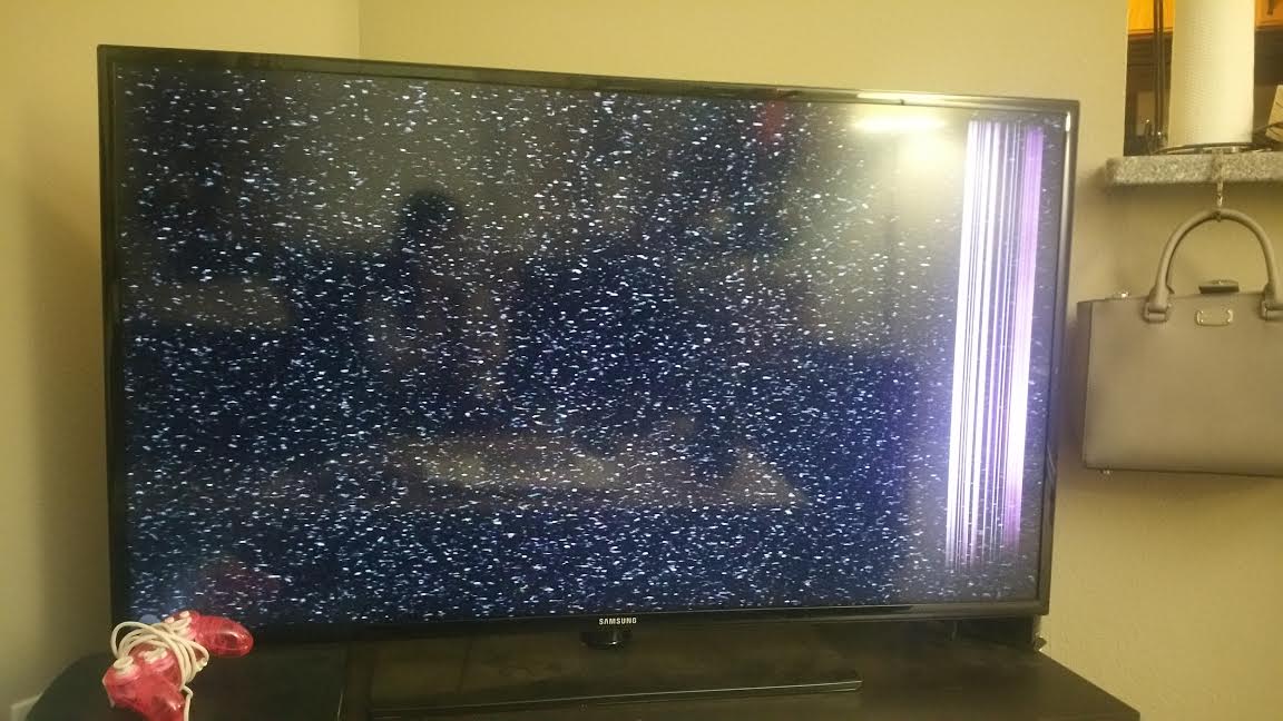

    And now:
    Any suggestions on a diagnosis?

    Re: Samsung UN50J6200 purple streaks / double image
    Panel fault could be shorted MLCC on driver pcbs.
      any suggestions on fix possibilities or is panel replacement the only route?
        Got the same problem, has anybody had a resolution. Tried a new T-Con, didn't fix. Do you think it could be a panel.
          As ReeceyBurger 123 said has all the looks of a panel fault.
            I agree with Reecey and dick above.
              +1, Bad panel.
