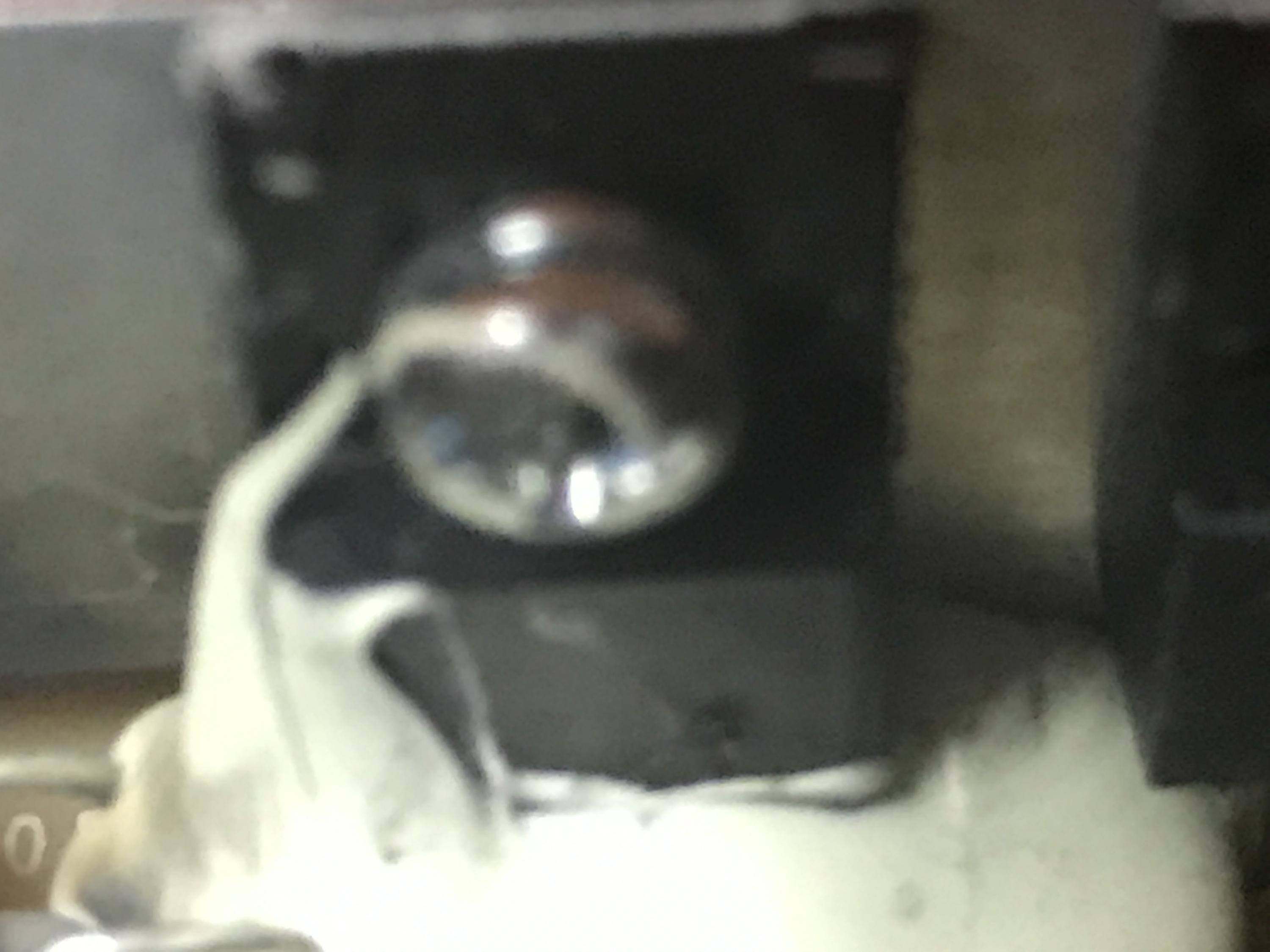

    Re: Samsung LN37D567F9HXZA dead power supplies, blown fuse
    here is the mosfet

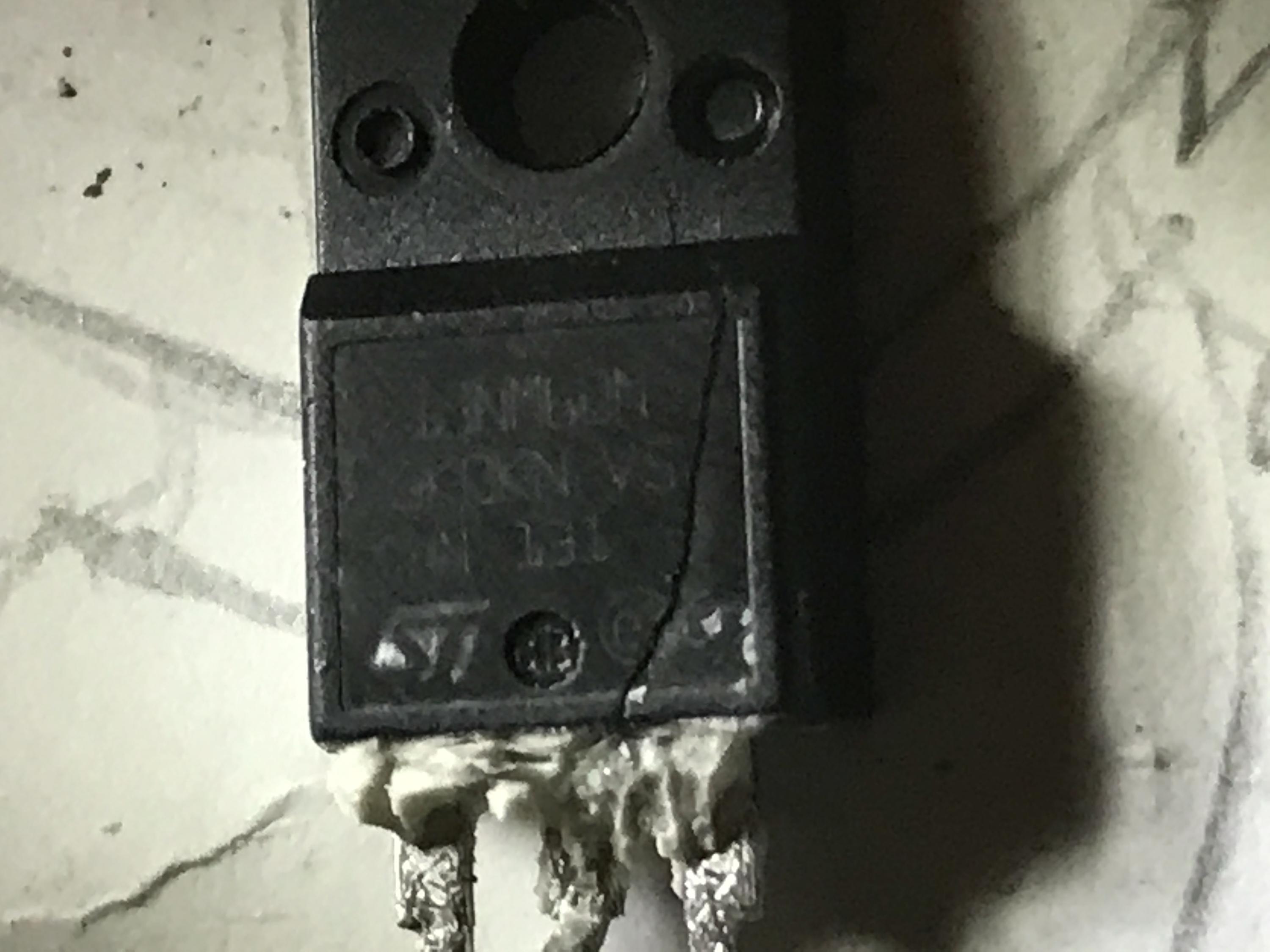

      the other 2 power supplies same... here are the mosfets from them. So now to find some replacement parts. should I check anything else ?
        CHN 131 is probably manufacturing plant code, date code, etc. CHN may be = China.
          I seen some with Mar but most i have seen have chn I think you are correct
          will these work? http://www.ebay.com/itm/10pcs-STF13N...-/252464607828

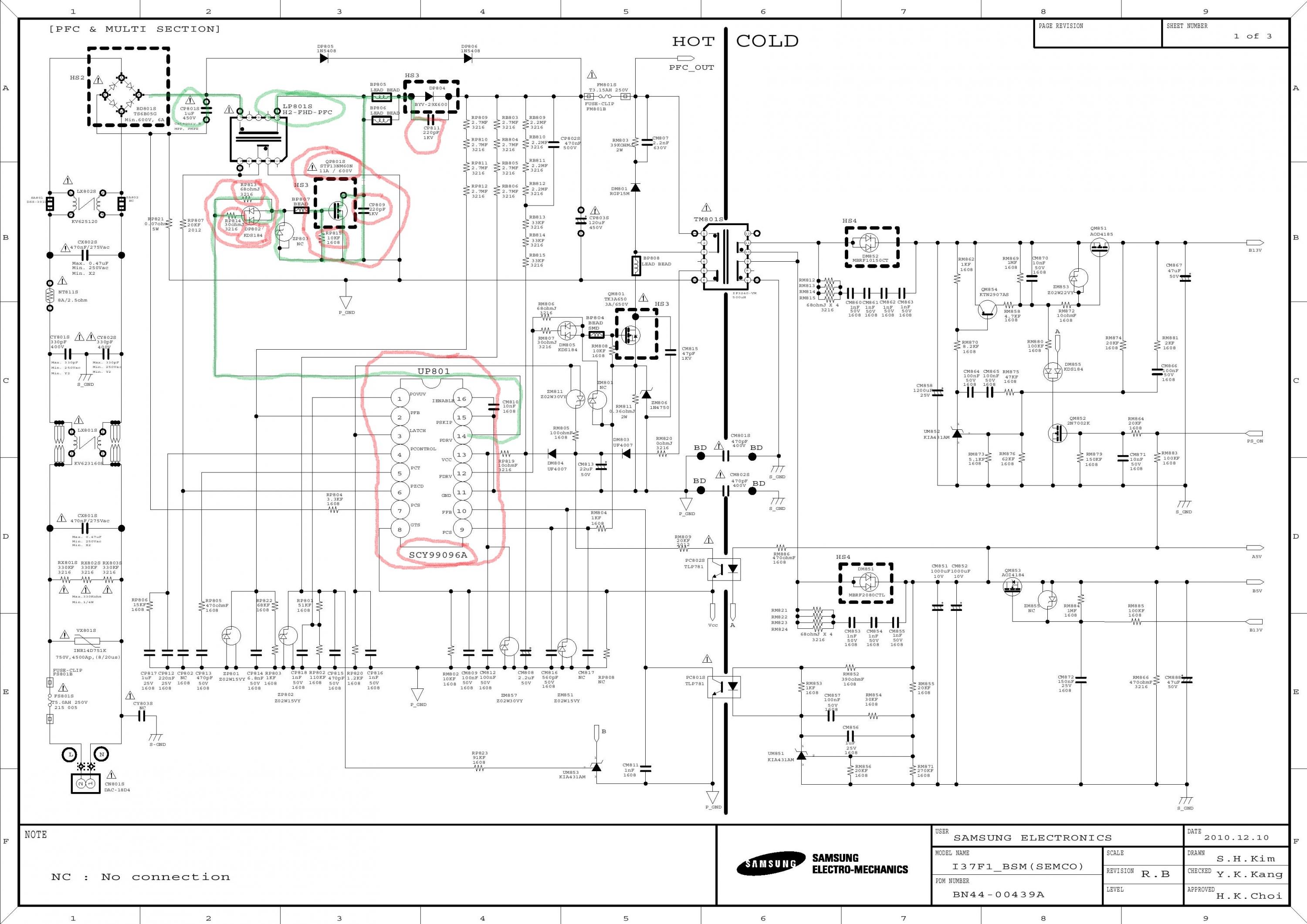

            Originally posted by crushkittykitty
            here is the mosfet
            The schematic says it's an STF13NM60N made by STMicroelectronics and available from Mouser and several other suppliers.
            Check any diodes/zener diodes located near QP801S and for damaged capacitors before you replace the mosfet.

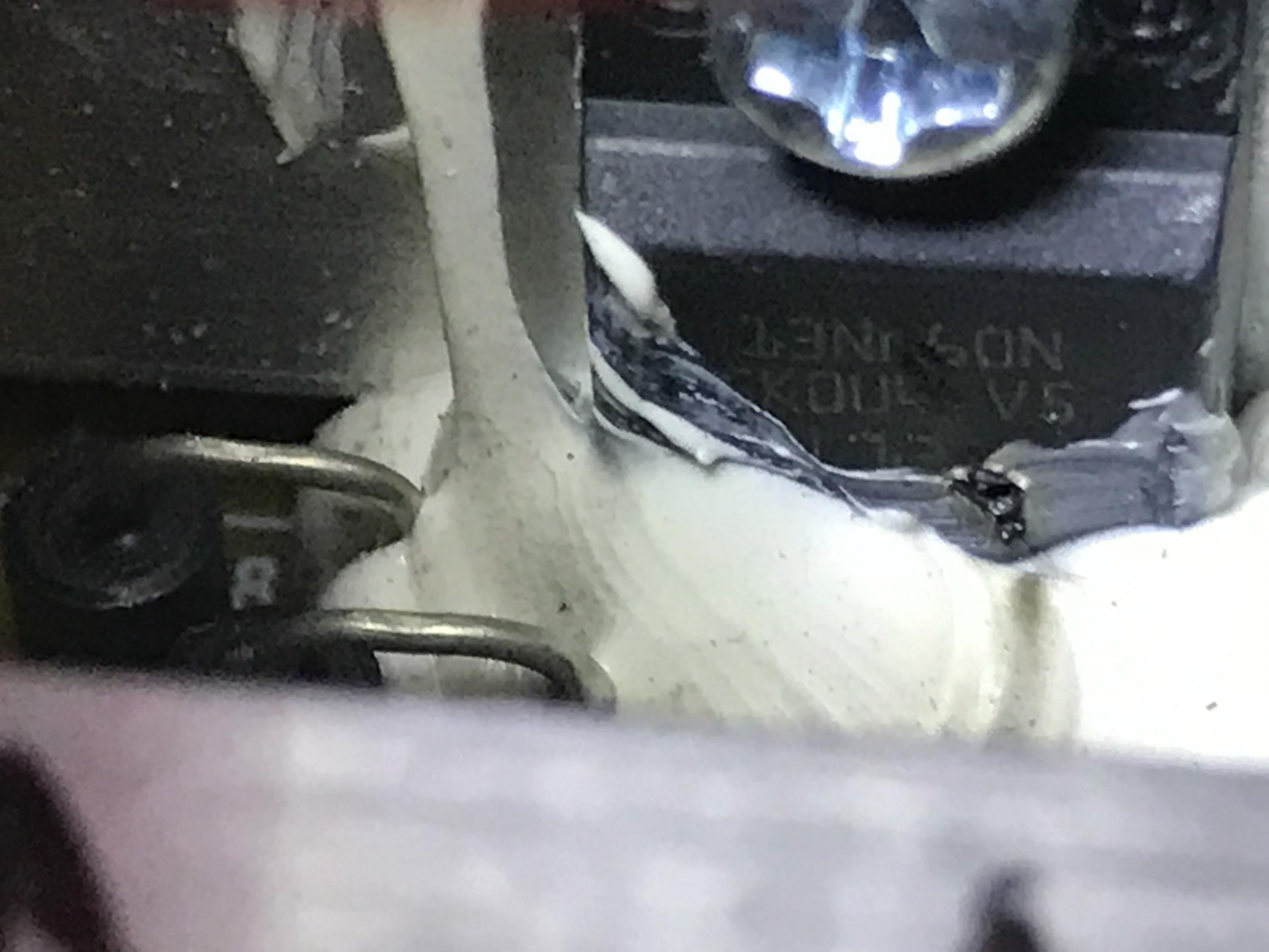

              looks like they might be overheating because of all that silicon ..its only supposed to cover the legs to stop dust . or maybe the heat-sink isnt flat or paste dried up .
                They have no paste on them, but I think you might be on to something there funny they all failed the same time. I figured it was a lighting strike or voltage spike at the hotel.
                So far i have seen about 10 tvs from there these are all the same tv. The first ones were main boards, 2 had broken screens, The rest are all power supplies.

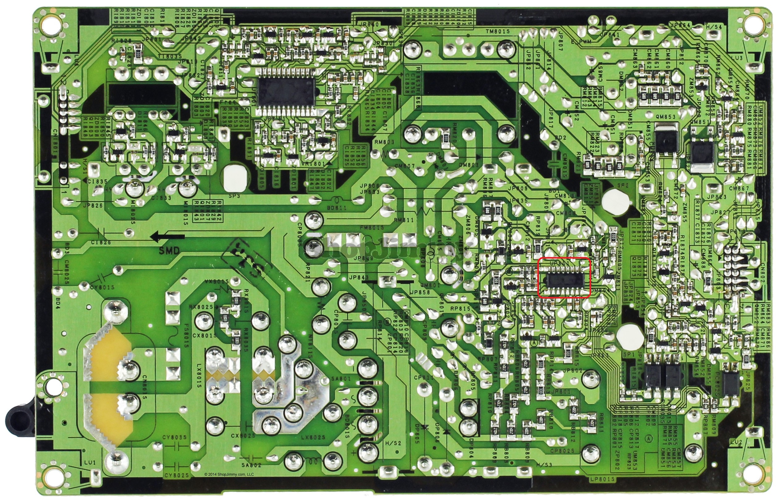

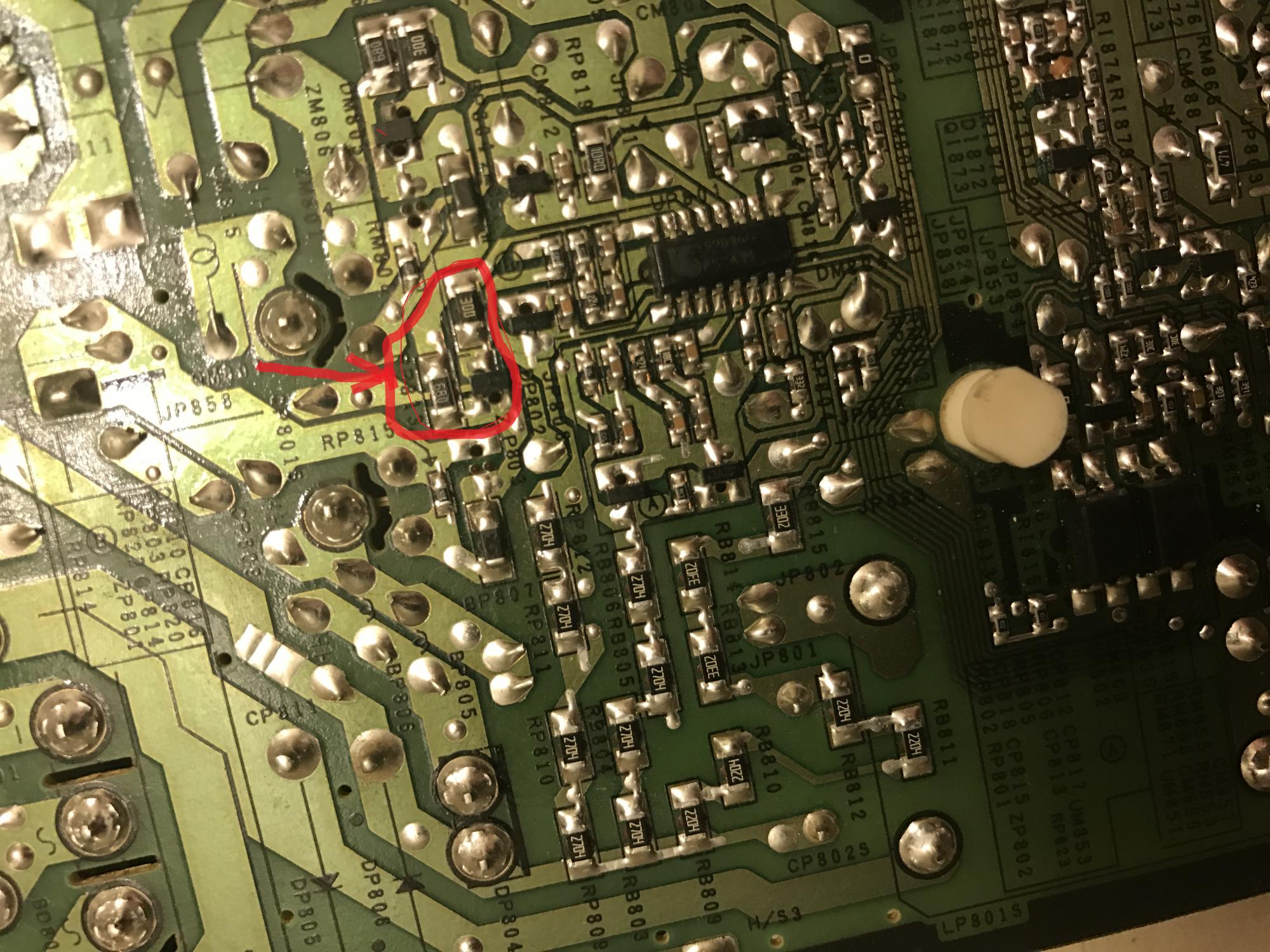

                    #29
                    i guess they are all same age and similar usage so that might be why they all died at same time ..unless they all went bang at exactly the same time then a power surge is more likely .

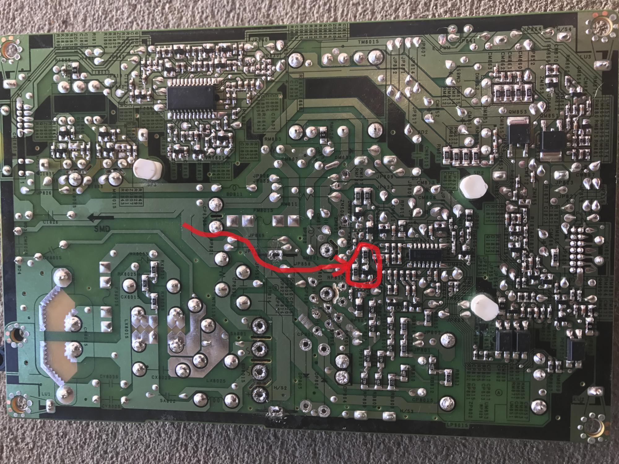

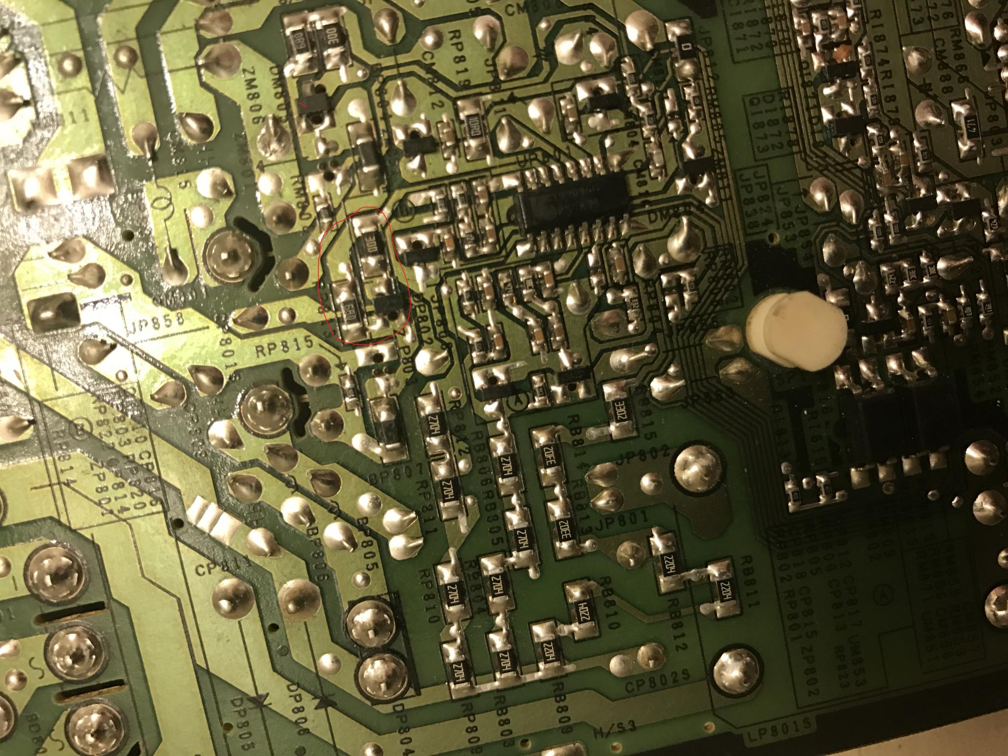

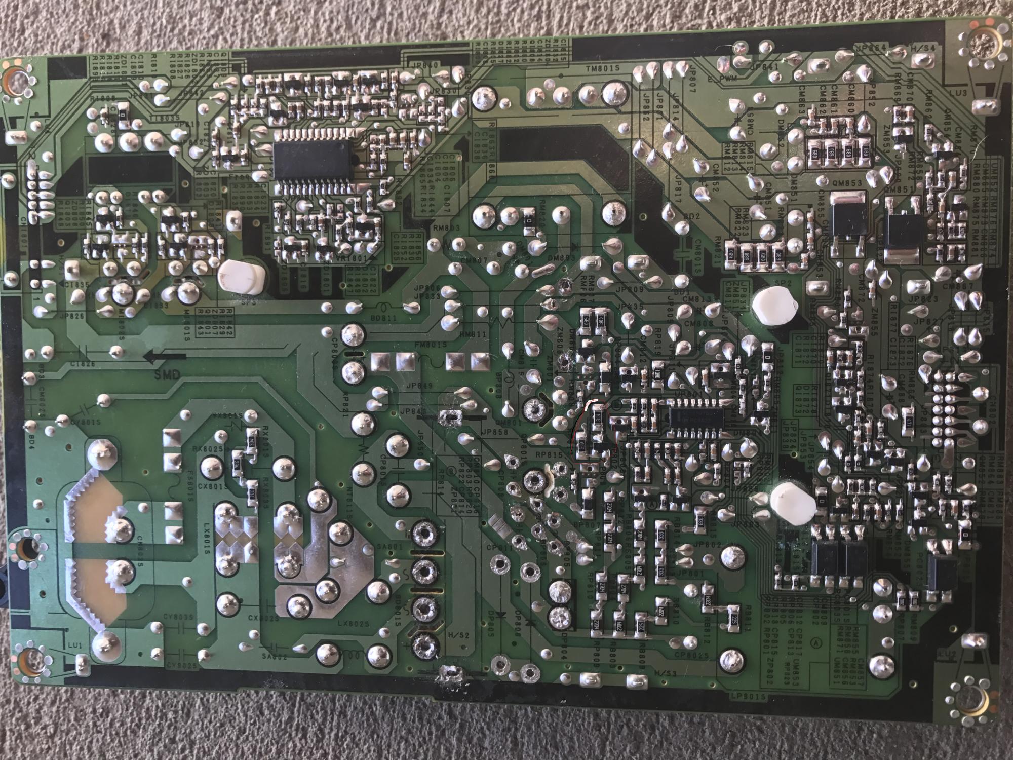

                    finally got the good supply out (family is sick)
                    how do i find surface mount parts like at digikey?
                    comparing the 2 power supplies this caught my eye
                    • petehall347
                      • Jan 2015
                      • 4450
                      • United Kingdom
                      #30
                      i cant make out exactly what you are referring to
                      • crushkittykitty
                        • Sep 2015
                        • 41
                        • usa

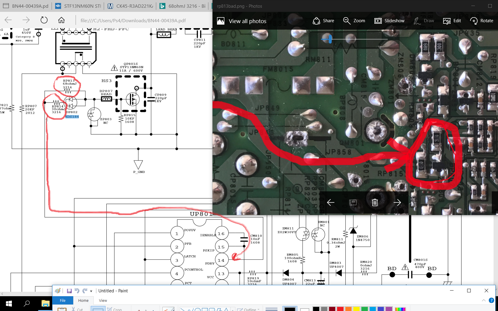

                        #31
                        RP813 68ohmJ 3216
                        rp814 30ohmJ 3216
                        these test bad
                        db802 KDS184 tests fine
                        I suppose this means that the chip (up801)(SCY99096A) is bad as well I have
                        no idea how to test it. (will be my project today google it)
                        I can find parts but they are all in china and a 100 at a time though free shipping and cheap lol
                        no doubt poor qaulity
                        still at a loss how to find parts
                        sorry re-posted the pictures with the spot highlighted better

                          #32
                          if qp801s is shorted then that is what blew those resistors ..
                          looks to me like up801 drives the gate on qp801s
                            #33
                            That PFC IC is toasted due to high Voltage dump into the Gate drive output pin of the IC when shorts is between Drain and Gate, that is why I always recommend to replace the IC and the MOSFET at the same time + any damage parts in the Gate drive circuit.

                              #34
                              can you circle the parts that you are talking about sorry been sick for 2 days now and have med head :\ or we might have to wait till I can think clearly
                              • dick_barton
                                • Aug 2015
                                • 6643
                                • Wales
                                #35
                                UP801 shown in box

                                  #36
                                  thanks that is what I thought so i will add it to the list. lol the list is growing you guys are the best .
