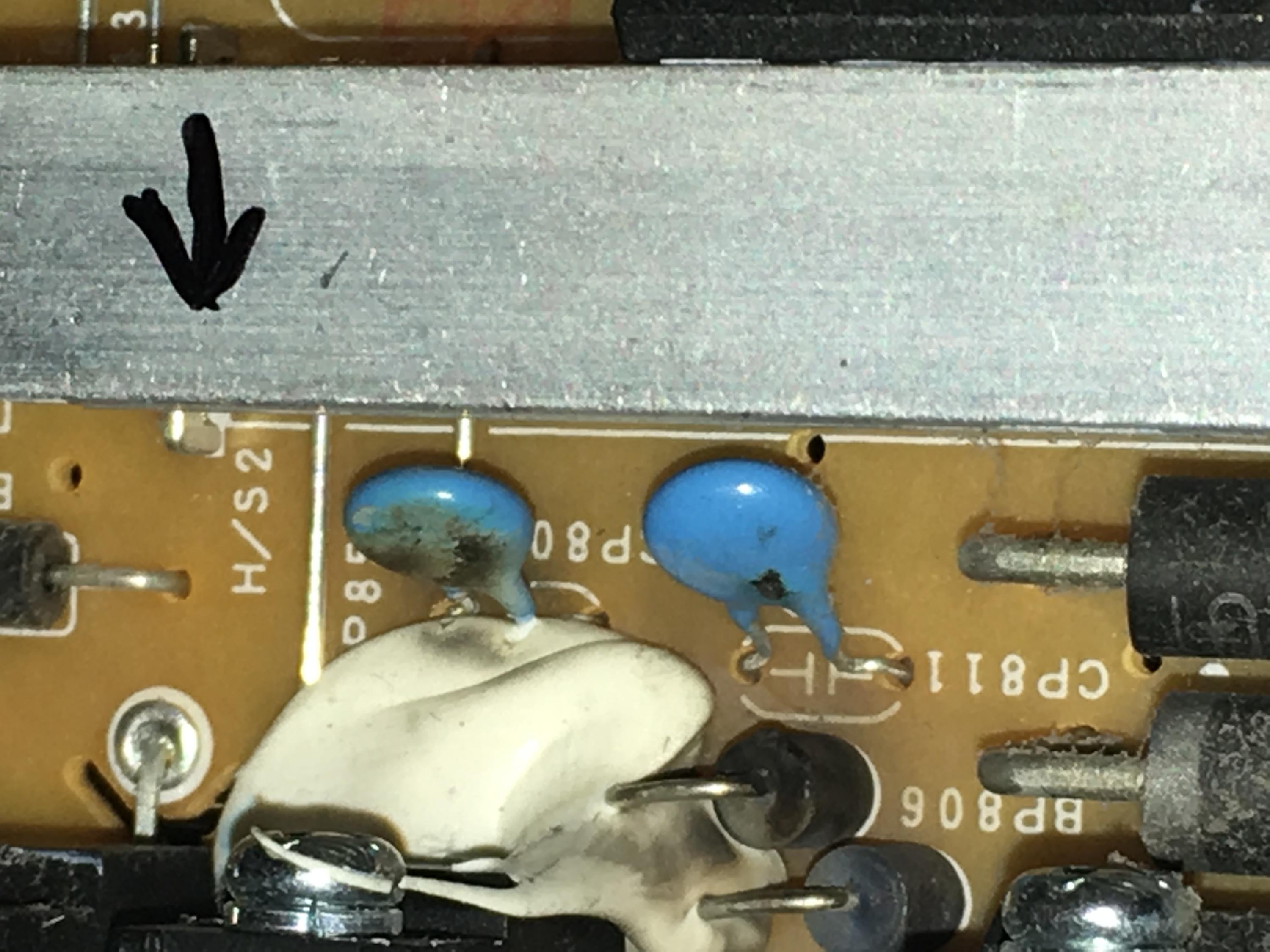

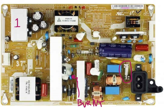

      Re: Samsung LN37D567F9HXZA dead power supplies, blown fuse
      The picture is too small to see what component(s) you are referring to as burnt. Is it the Mosfet on the heatsink or the blue capacitor?
      • jondoe
        • Nov 2016
        • 547
        CP811, I think, based on this picture.
        https://www.tvpartsforsale.com/asset...N44-00439A.jpg
        • dick_barton
          • Aug 2015
          • 6643
          • Wales
          Thanks for that.
          Use your meter set to diode mode and with the power supply disconnected from the mains, test the Mosfets on the heatsink and the diodes in that area for any short circuit ( 0 ohms)

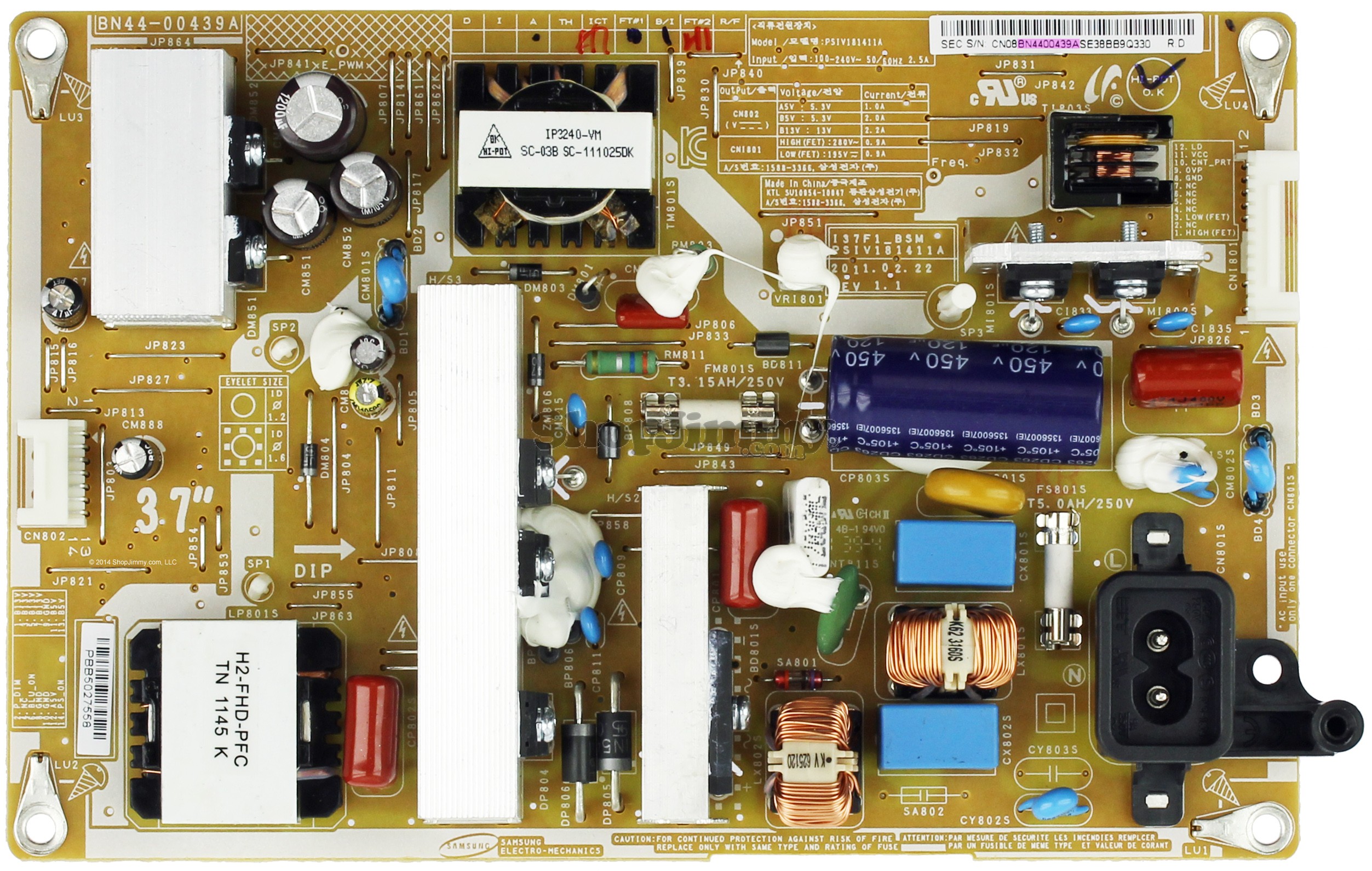

              Samsung BN44-00439A (PSIV181411A) Power Supply Unit
              http://www.shopjimmy.com/samsung-bn4...pply-unit.htm#
              Another bad snubber cap. Remove that cap and check its resistance to see if it shows any resistance, also check the resistance of the cap pads (cap is not in place to see if it shows low resistance).

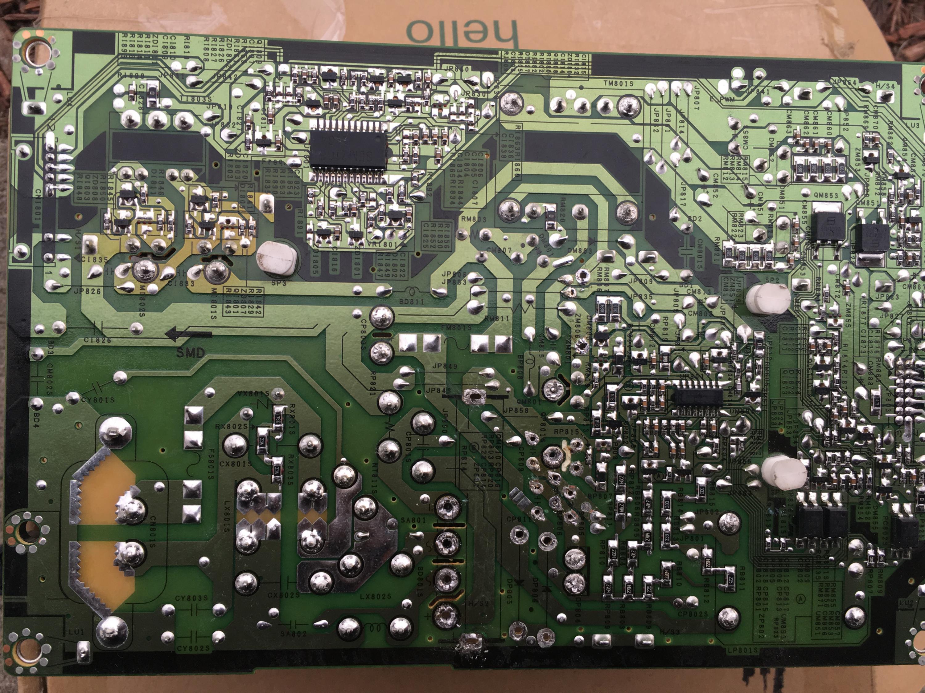

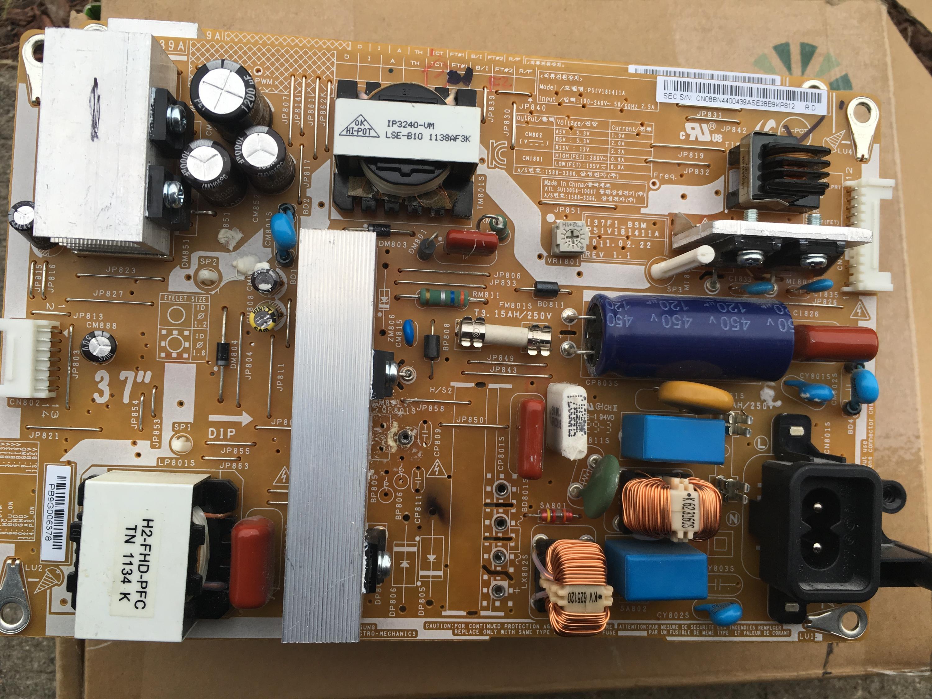

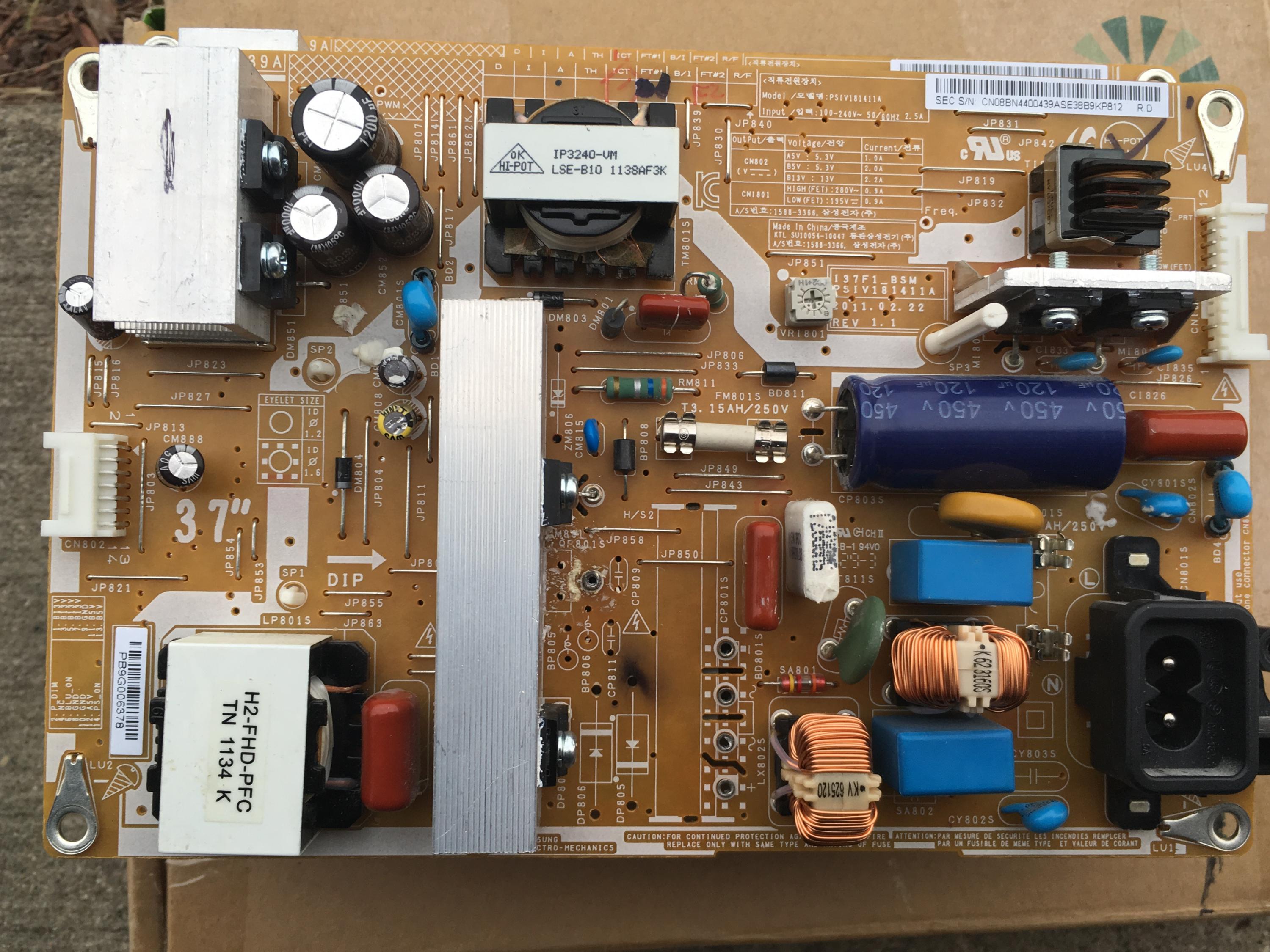

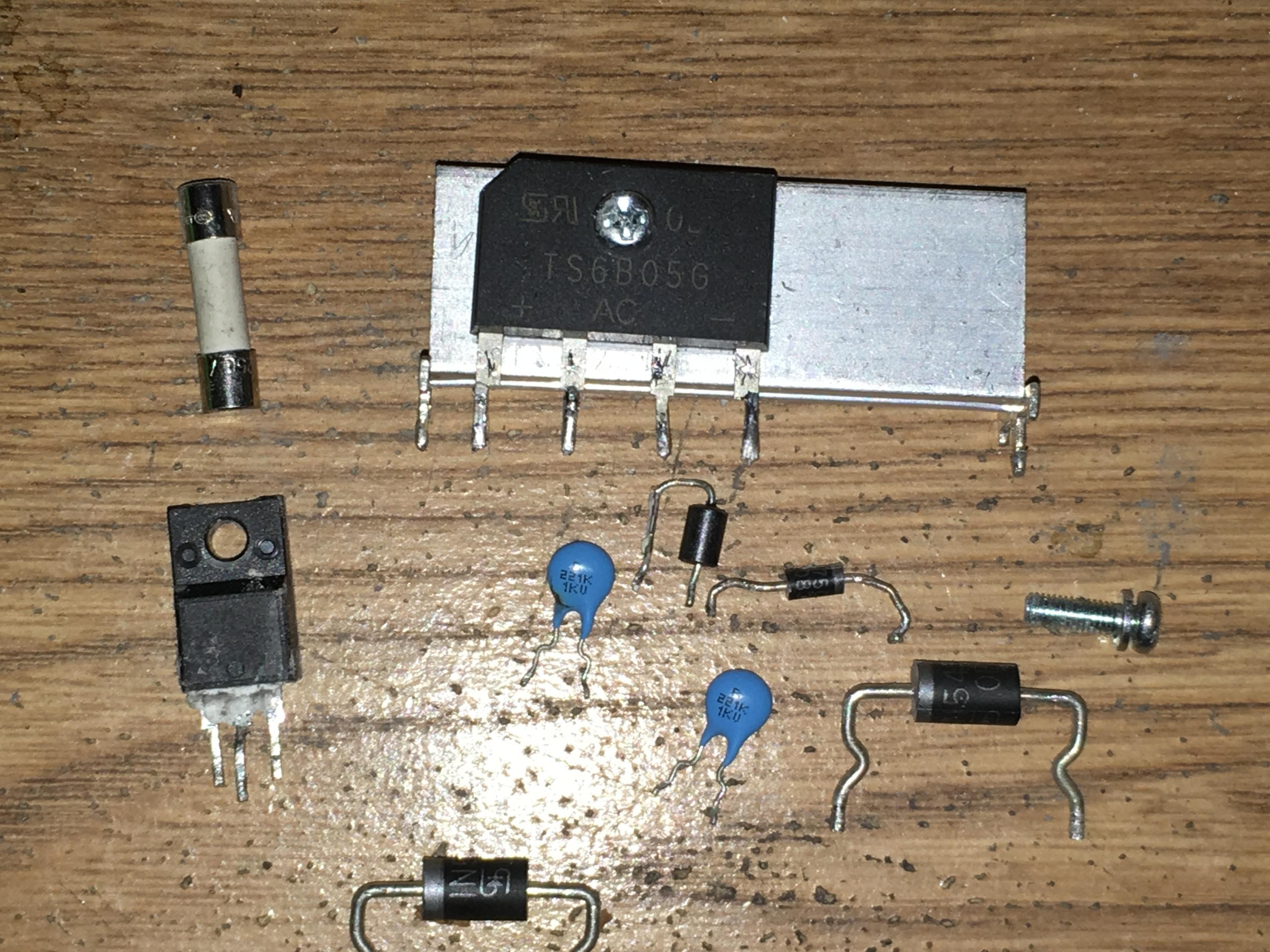

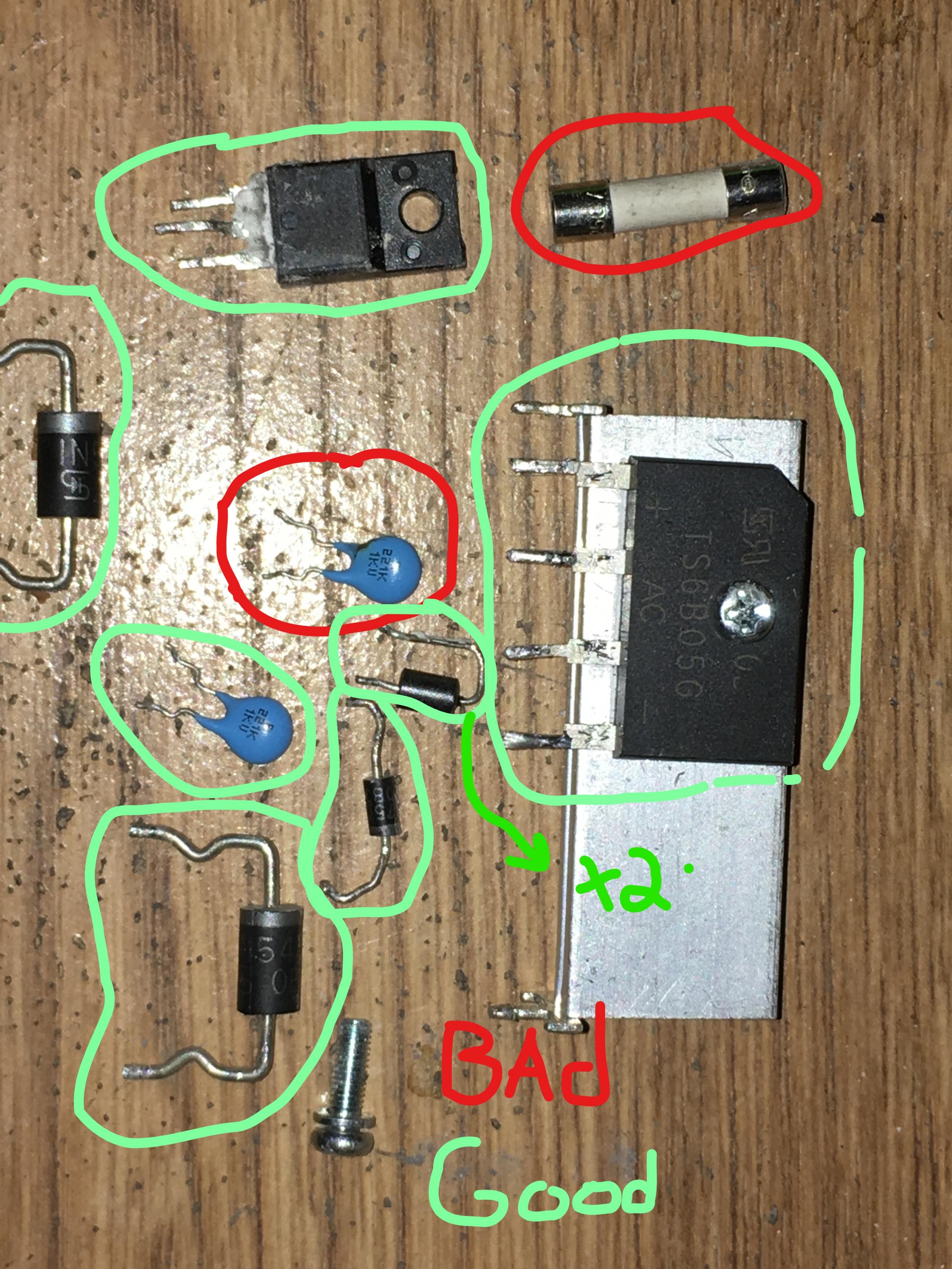

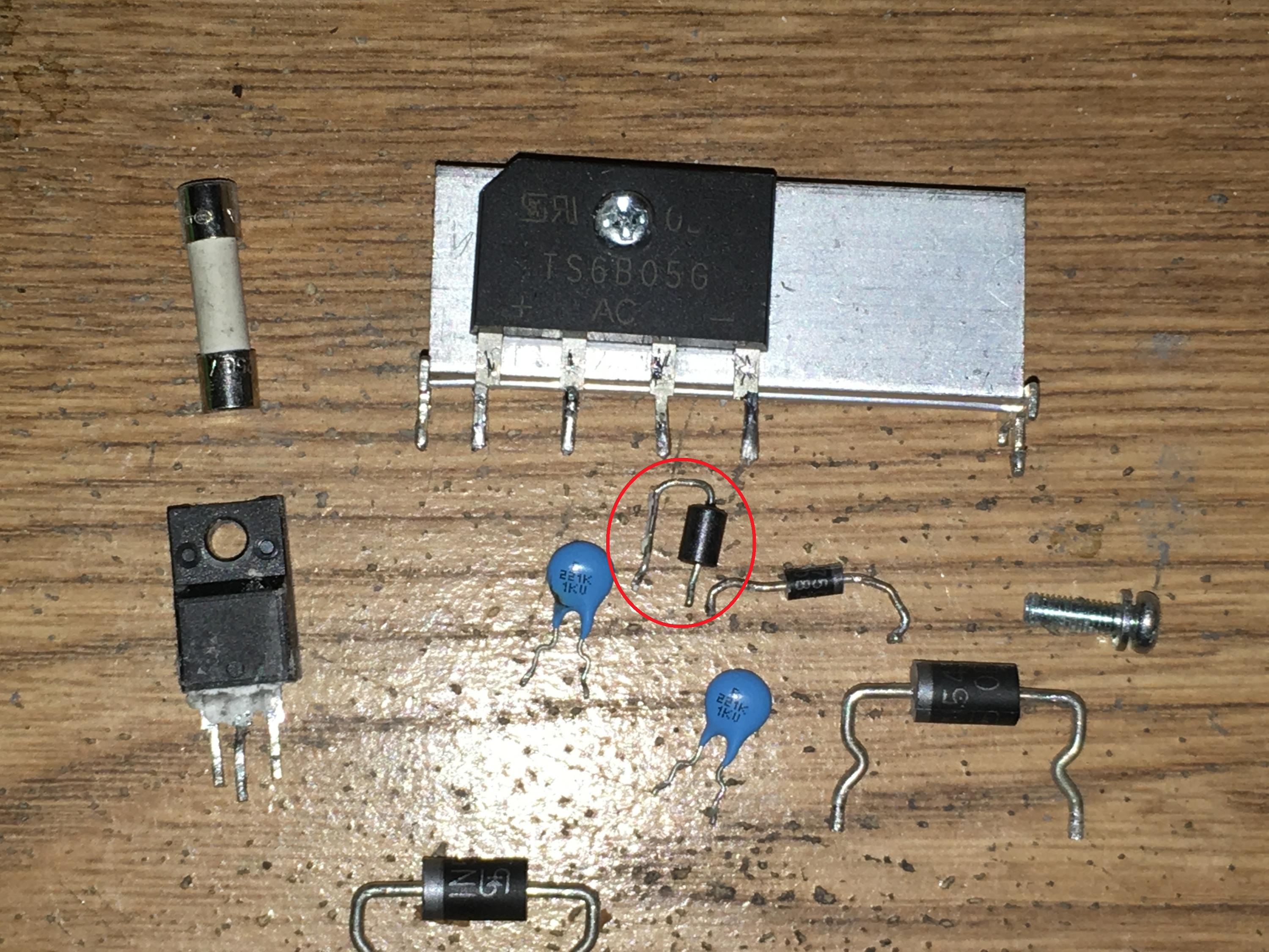

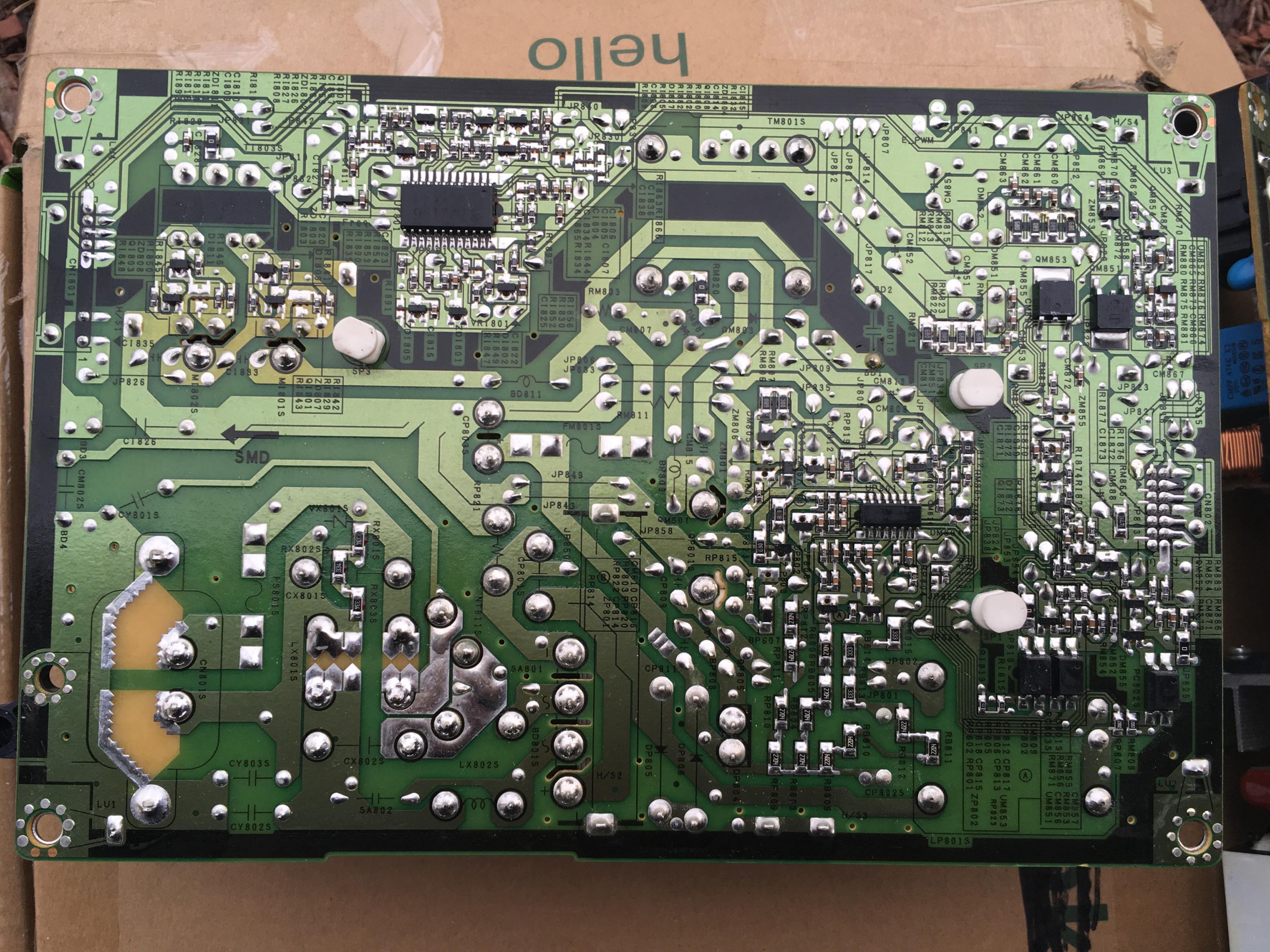

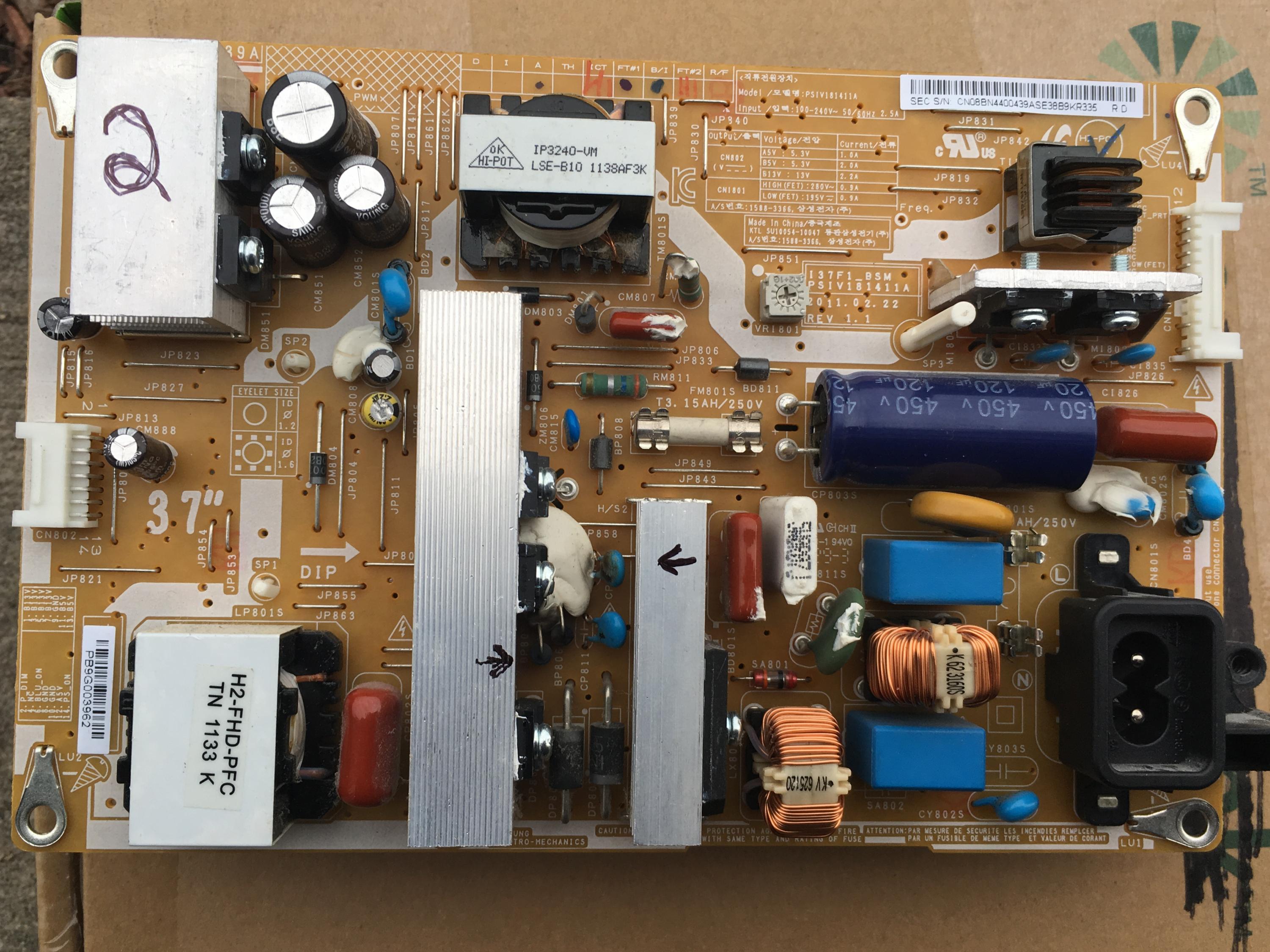

                I took pictures of all 3 power supplies we are working on number 1 and a big thank you

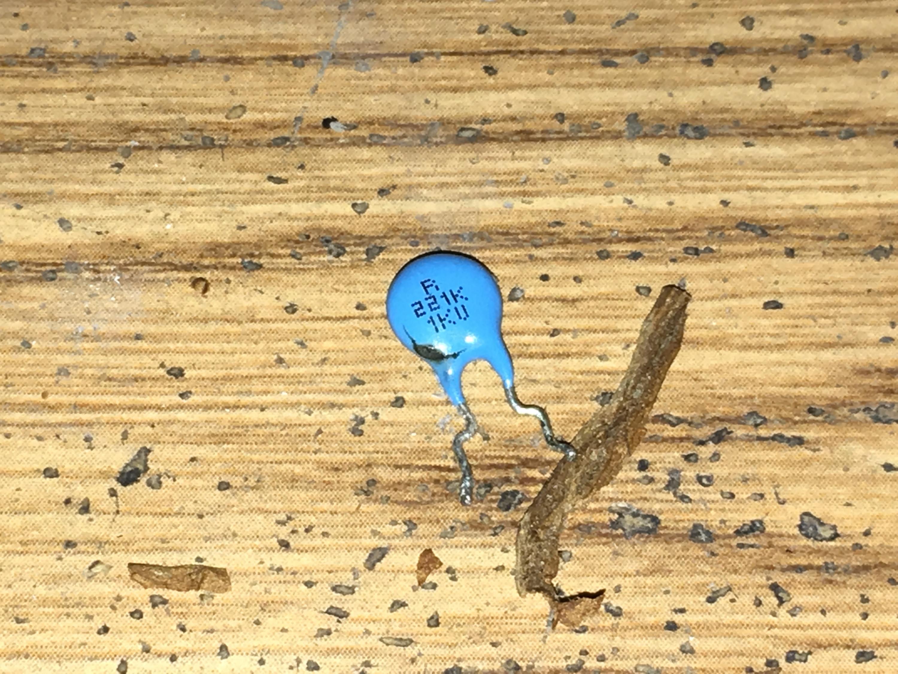

                TS68056 (cp8015) tested bad in board, taking it out made it alot better to get other parts out
                fi 221k 1ku (cp811), has a blow out cp809 tested fine but will replace both
                bp805,reads 701 one way open the other
                bp806, short
                bp8015 tests bad
                  If the item circled is a ferrite bead it will show 0 ohms but is OK.
                    If cp811 (snubber cap for the PFC Booster diode) is shorted out or has leakage resistance, you will not have PFC Boosted Voltage, it will not cause any damage to the circuit, same result if D804 is shorted out or have leakage resistance. We have seen may of these caps and the Diodes failure before.
                      So you think if I just replace cp811 and cp809 it will work?
                      retested the Ts6b05g its fine
                      all 3 are burnt in the same place have not tested anything else on the other 2, think I can get them local rat shack, that is a long shot they do have 30 phones but the parts are little to none.
                      as for fuses can a glass fuse (5.0 A 250v slow-blow glass) be used to test or should i just wait for the other fuses to get here?

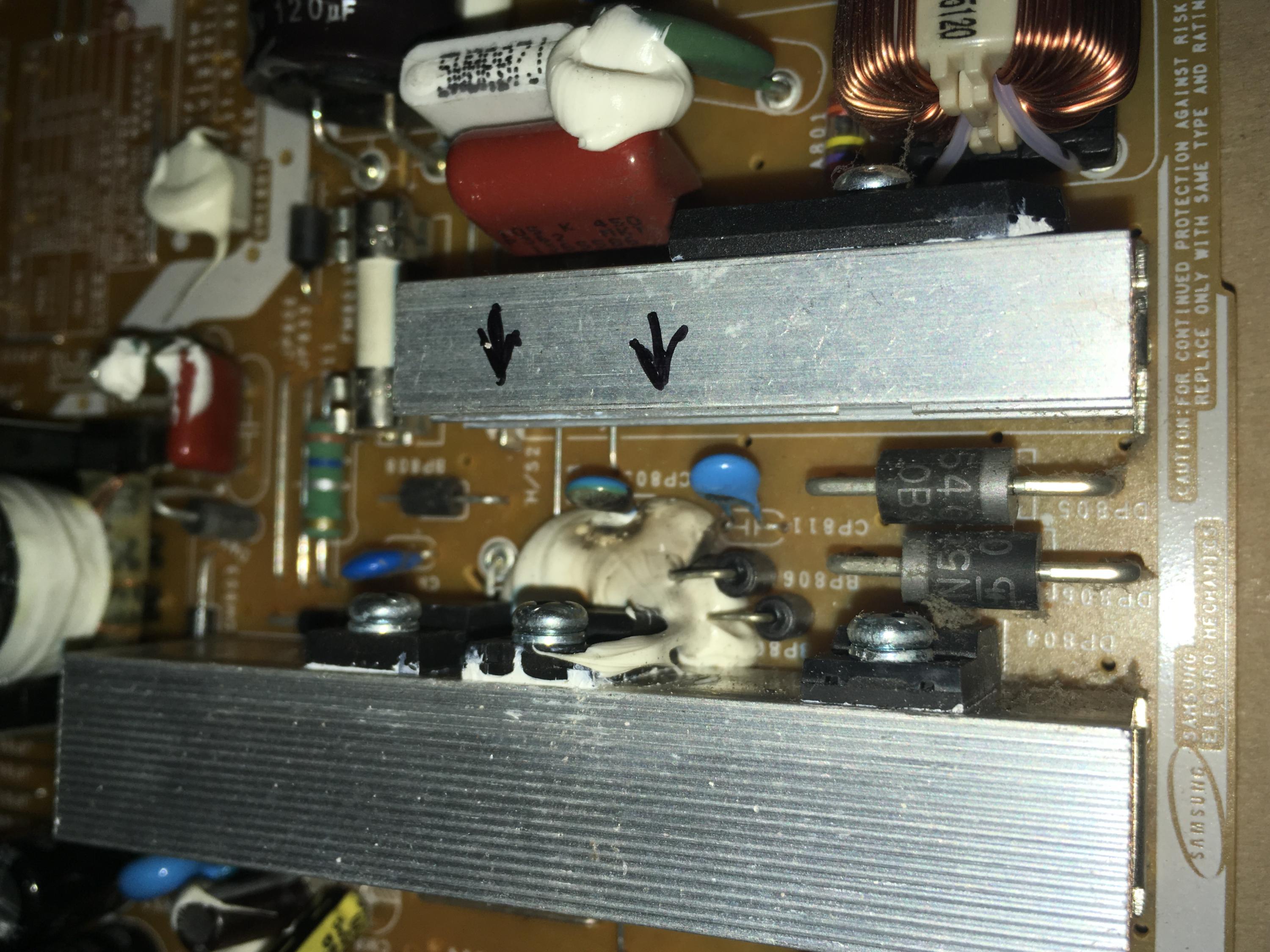

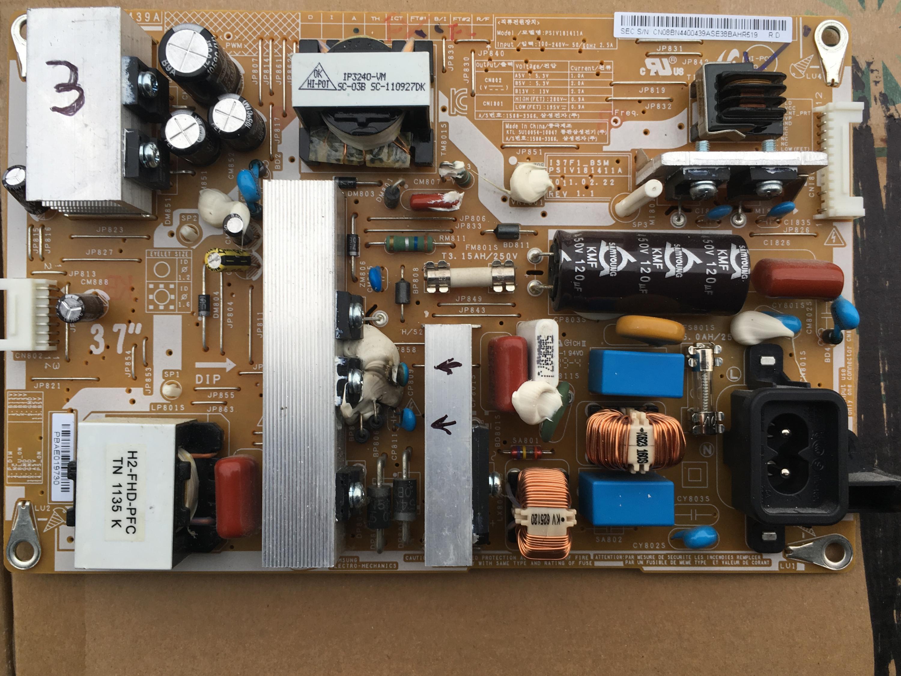

                        so this is were I am at right now.
                        • dick_barton
                          • Aug 2015
                          • 6643
                          • Wales
                          I prefer ceramic fuses because they don't shatter glass everywhere if they blow should there be a short circuit in the set.
                            So are you working on more than one board at the same time?
                            The one with shorted snubber cap for the PFC diode may not have other damaged part but I would check the MOSFET for the PFC at least, same for other boards.
                            So the one with shorted snubber cap for the diode, did it also blow the fuse?
                              all have blown fuses there is 3, I have 2 tvs left that need power supplies. Working on just one at a time learning as I go. (the one marked with the black 1.) this one showed the least amount of damage. 1 blown snubber cap cp811
                              would that mosfit be the one in the center of the heat sink that I removed
                              see pics below.
                              btw. the other 2 show blown 2 snubber caps cp811, cp809
                              would that mosfit be the one in the center of the heat sink?
                                QP801S is MOSFET for PFC circuit.
                                xPxxx designator: P = for PFC circuit section.
                                  learned something testing it shows not working. has alot of silicone coated on it will clean it off and test again have tested it 3 times once showed good if i can get the part number off of it will just replace it.
                                      its bad
                                      QP801S STF13NM60N 11A / 600V
                                      looking at it under microscope has a crack push on it tests fine lol
                                      what is the last numbers on the mosfet chn 131 ?
                                        When MOSFET shorted out, it can take out the IC that drive the Gate of the MOSFET with it too, so if you do not replace the IC and the MOSFET at the same time, you can take a chance of blowing up the new MOSFET.
                                        "what is the last numbers on the chip chn 131 " Which IC is that?
