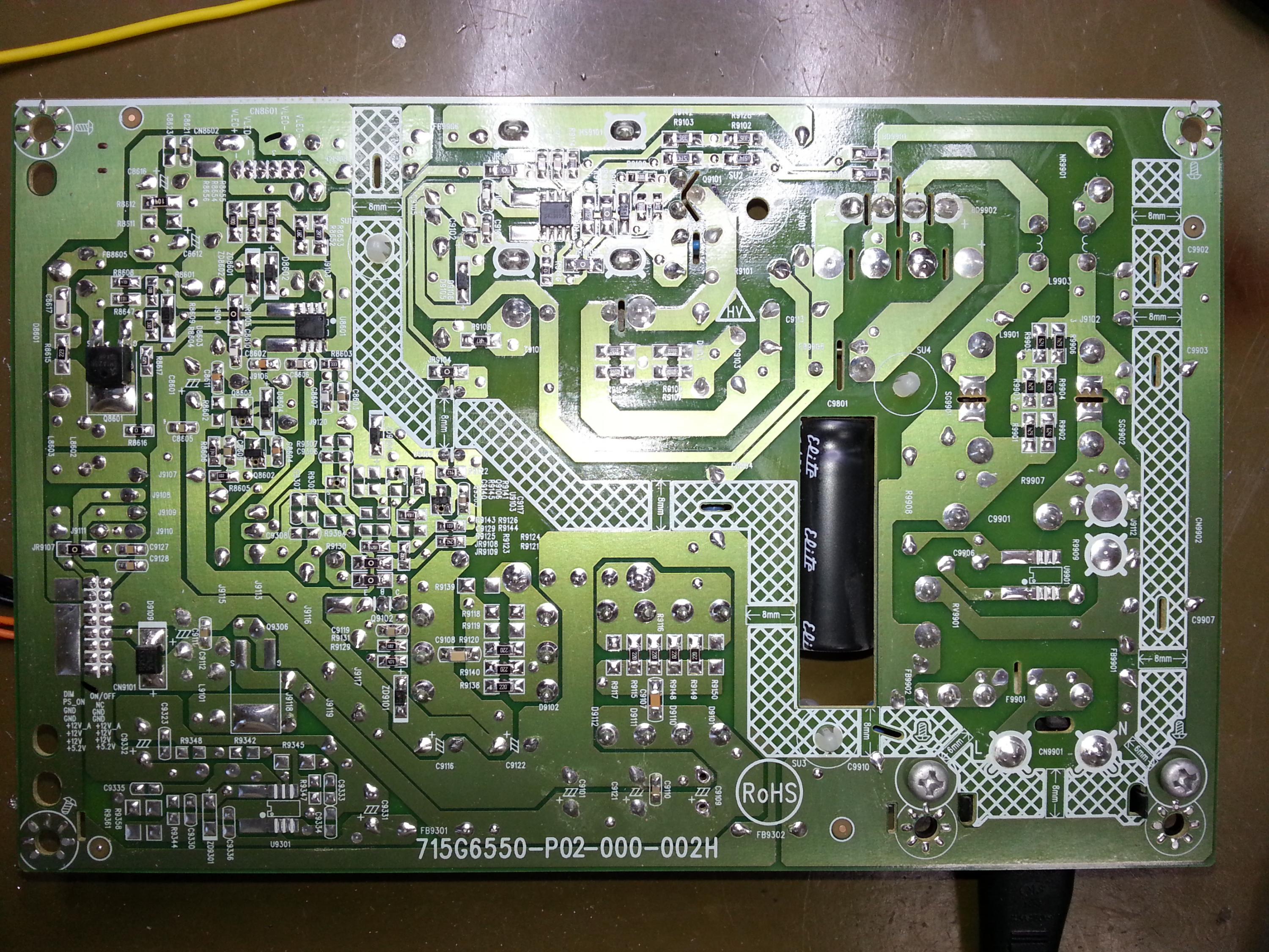

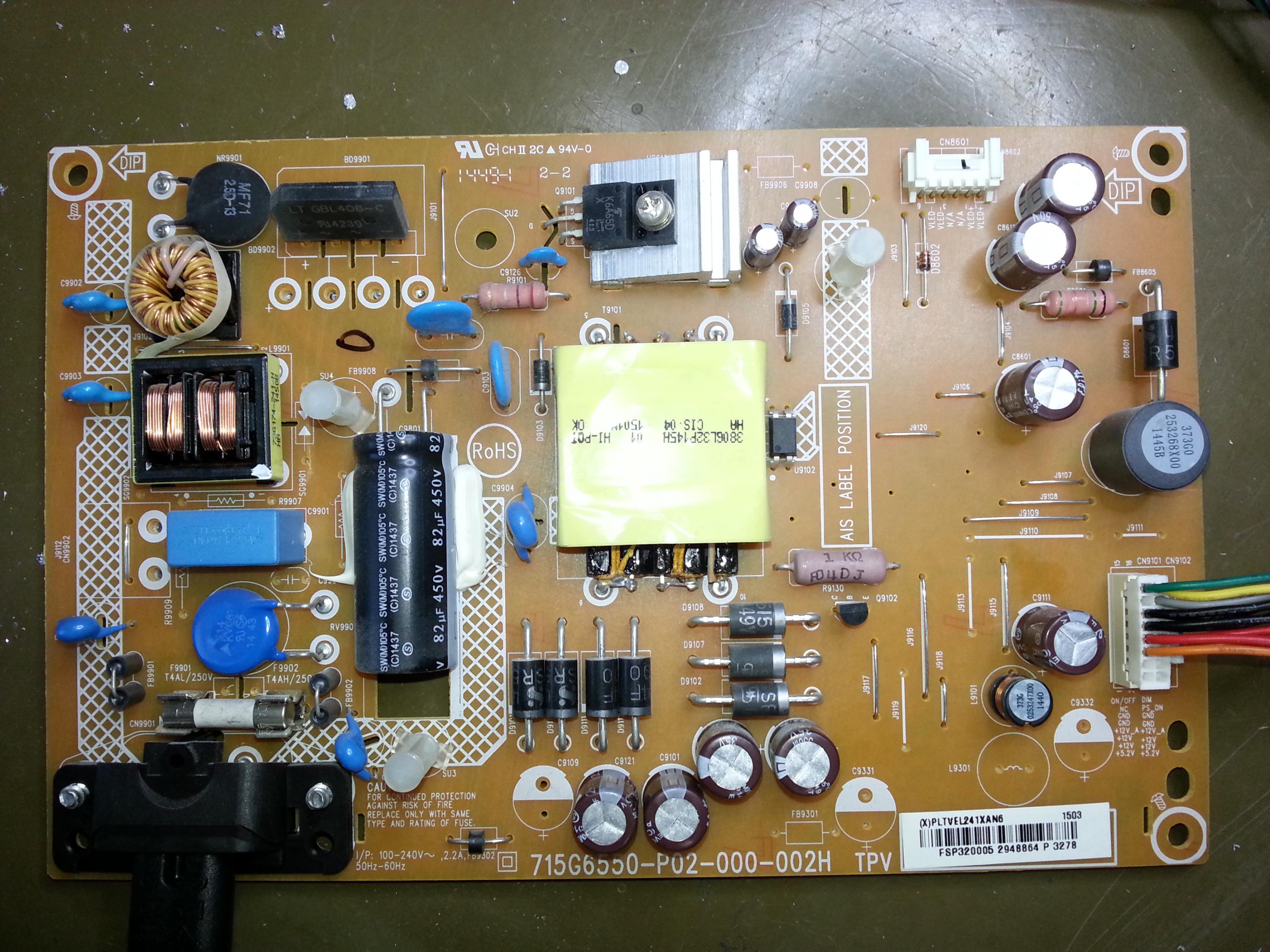

    Good day folks. Got this Philips 32PHH4100 LED TV which has power supply issues. When the chap brought it in, the red power LED would blink rapidly, indicating the set is trying to come on but can't. I took it apart, took some measurements and immediately noticed the 12v output dropping to around 7v when the main board was connected to the power supply. It is an "always on" supply, meaning it doesn't have a STBY voltage - the 12v rail IS the standby voltage as well. To test this theory, I took a computer PSU, connected its 12v output to the appropriate pins on the main board and powered the set on: even though there was no backlight, the TV was definitely on and working fine, as I could see stuff moving on screen with the "flashlight method".
    Back on the faulty power board, it is a 715G6550. I couldn't find a schematic, but it's not really necessary at this point, since no components are completely blown apart. When it's first plugged in, the 12v output slowly rises, until it reaches around 11.6v, which is OK, but the turn-on "curve" is WAY too slow: it starts off at 5v and takes about 5 seconds to reach 11v, which is not alright. When you load this output, the voltage goes down to 7v and then slowly rises again upon removal of the load. What I have tried so far to no avail:
    -replacing the caps on the 12v output (but not the LED driver too, which runs off a separate tap on the switching transformer)
    -replacing the optocoupler, thinking perhaps it doesn't provide correct feedback to the PWM IC
    -replacing the 2 small caps on the Vcc pin of the PWM IC in the primary
    Could this be a bad PWM Ic, bad MOSFET, bad rectifier diodes ? Suggestions are highly appreciated

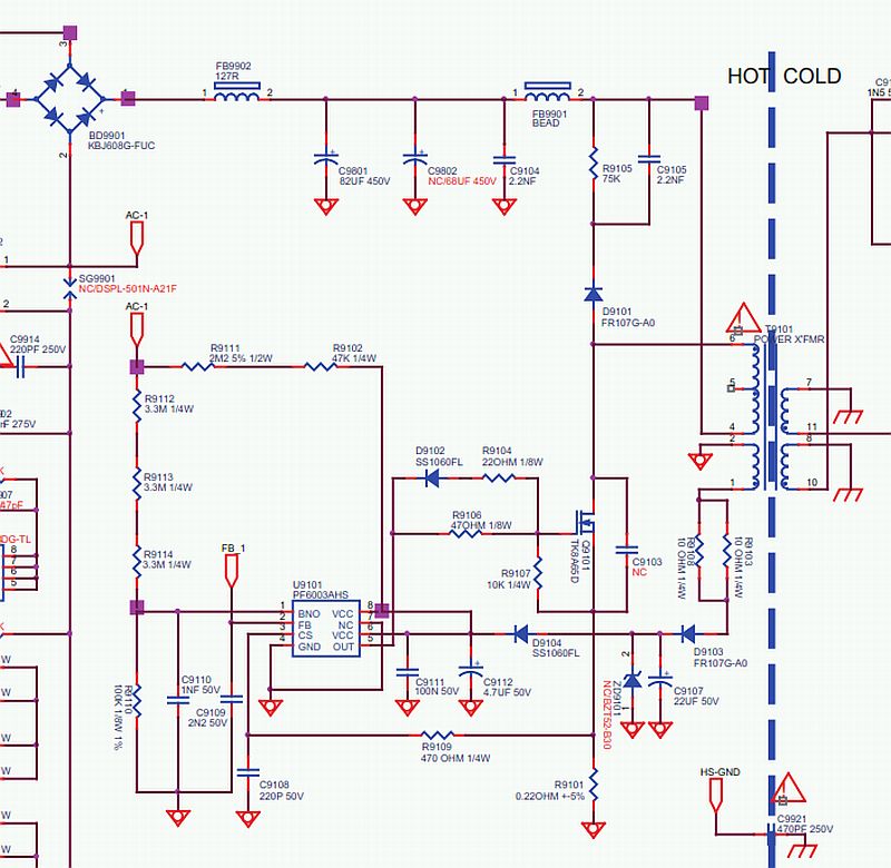

          Re: Philips 32PHH4100 faulty power supply (dropping voltage)
          Here is some information on that chip which does show VCC tied to AC line. It's probably to start the chip operating (charge pump) before being taken over by the secondary voltage.
          Edit.
          You've changed the caps on the VCC pin but it may be worth also checking the resistors around that circuit.
                    In the service manual there's a 20V zener BZT52-B20 connected to VCC so I'd expect VCC to be somewhere between 13V -18V
                        The capacitor on VCC is charged by current supplied through the resistors tied to the Line voltage. When the voltage at VCC reaches a certain amount the oscillator starts and VCC is now maintained by the secondary supply voltage and the internal supply via line voltage is turned off.
                        It may be attempting to start but the VCC cannot be maintained by the secondary voltage so it goes back to charging VCC via the line supply and during this time the secondary voltages start falling. This repeats.
                          Ok, so probably bad R9108, D9105 or D9106. Those 11v I see might come from the AC line and might not from the AUX winding at all now that I think about it.
                                  Have you checked R9127, R9128, R9142 = 3.3Meg Ohm and R9114 = 110K are within value?

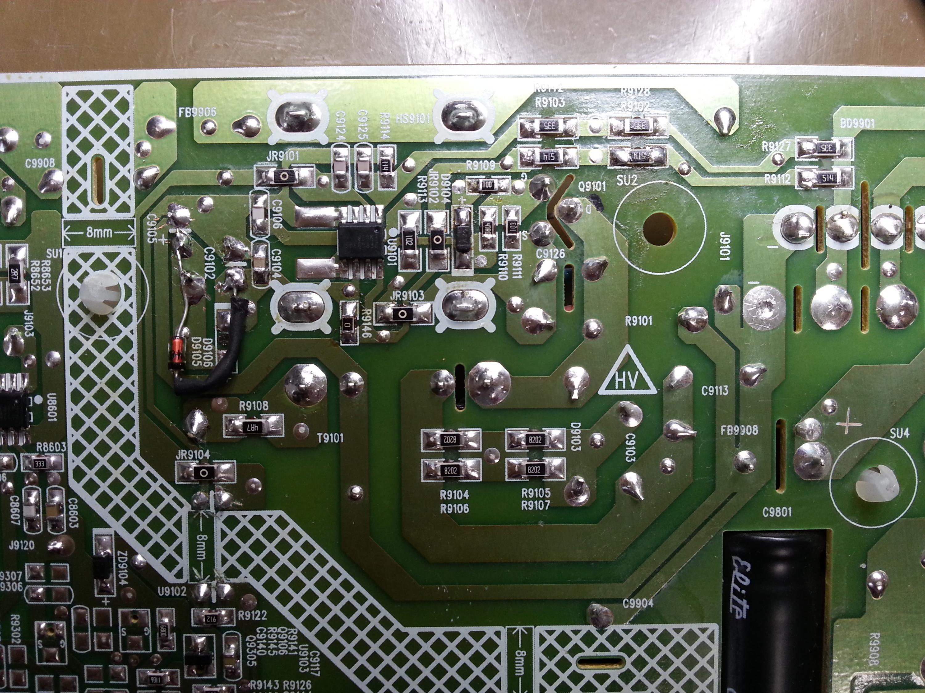

                                        I took a close-up of the area we're talking about, just in case (and oh, don't mind that through-hole diode botched on there - I didn't have a SMD 4148 ). Let's answer some questions:
                                        -resistors: while I have measured all of them, I just noticed something: R9142, 9128 and 9127 are supposed to be 3.3 meg-ohms, but when I put my probes across one of them, it displayed 1.5 meg-ohms and it slowly kept going up, so at that moment I disregarded them, thinking that the number would eventually reach the desired 3 meg-ohm or real close, but now after your suggestion, I took another reading and I'm not getting squat :| Eventually I figured out what happened: initially, I had my probes in one orientation (+ on the right of the resistor and - on the left, let's say), but for my second reading I had them in reverse, so what I was seeing was some leakage going through perhaps the bridge rectifier and the PWM IC....I'll now try pulling them out and measuring them off-board.
                                        -it's a 24v 5w bulb (yes, I lied, it's not 12v now that I look at it )
