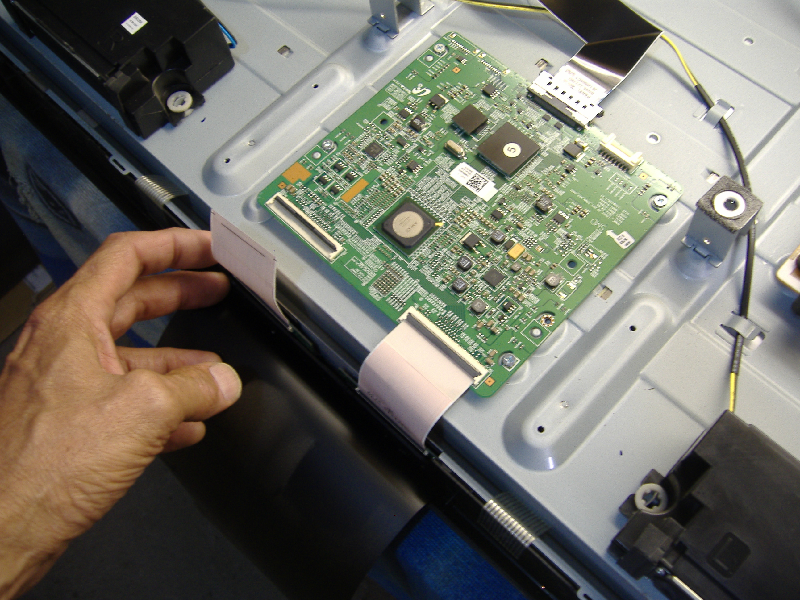

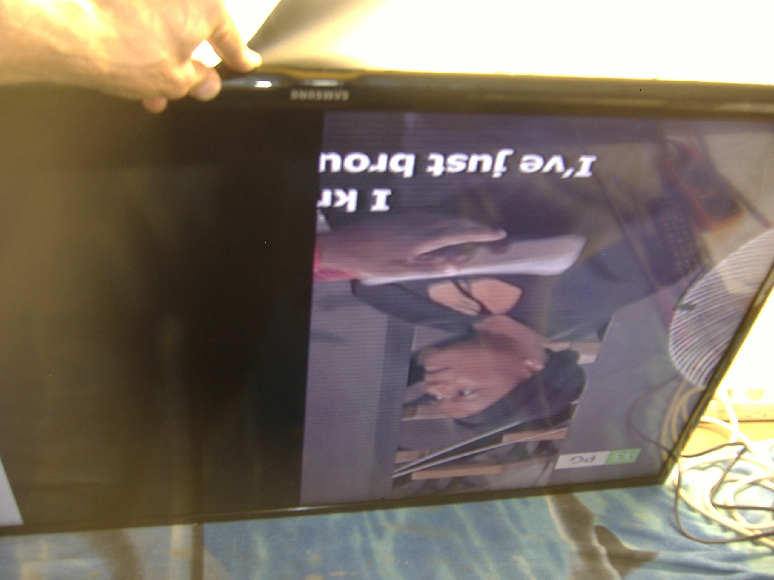

    Disconnecting the ribbons from the Tcon one at a time I noticed that disconnecting the right ribbon (Right from the front) that I got half a picture. (see photo)
    I was convinced that the panel was faulty on the right, and that it was causing the Tcon to malfunction, giving no picture. (rnr/ uneconomical)

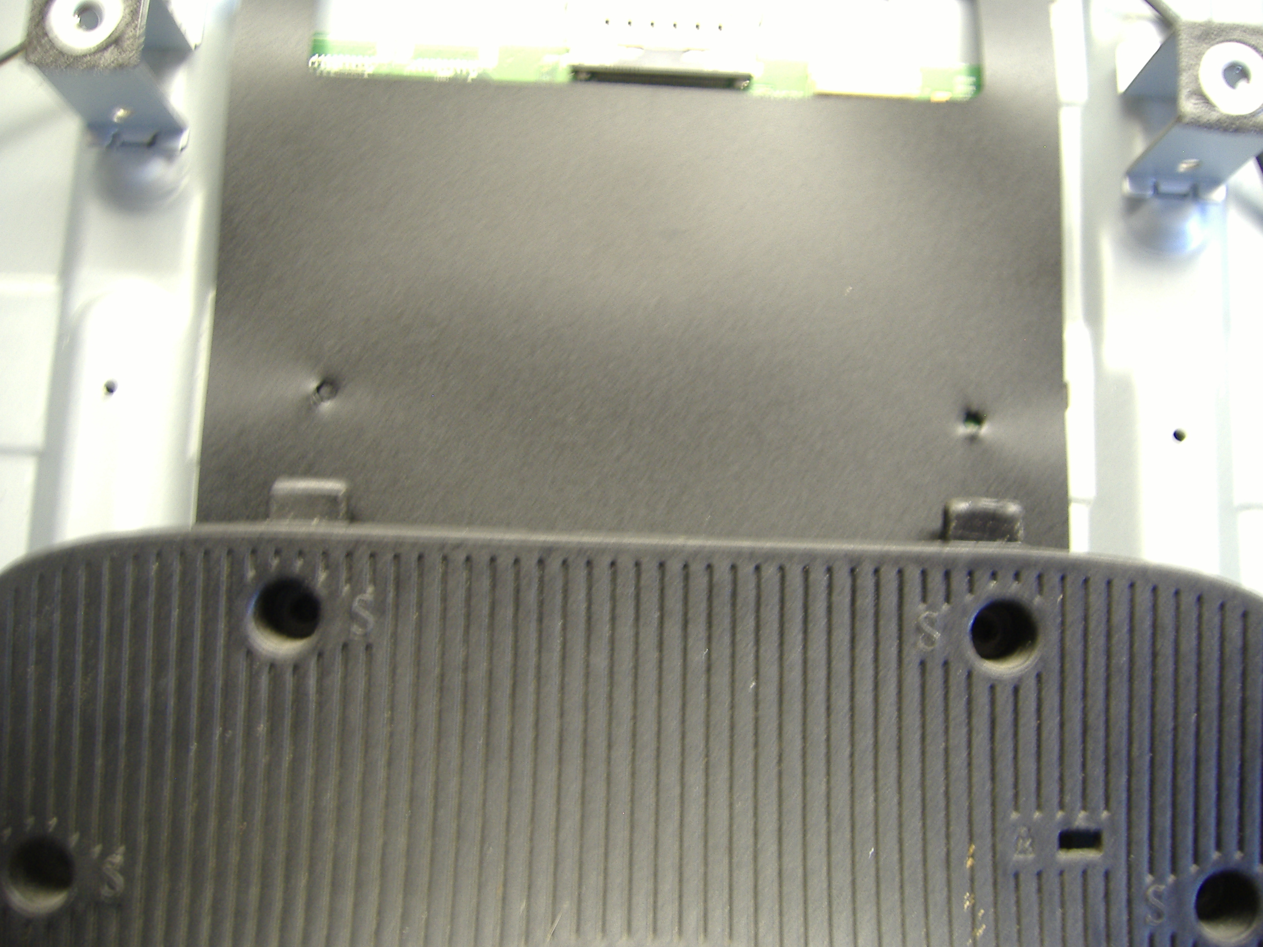

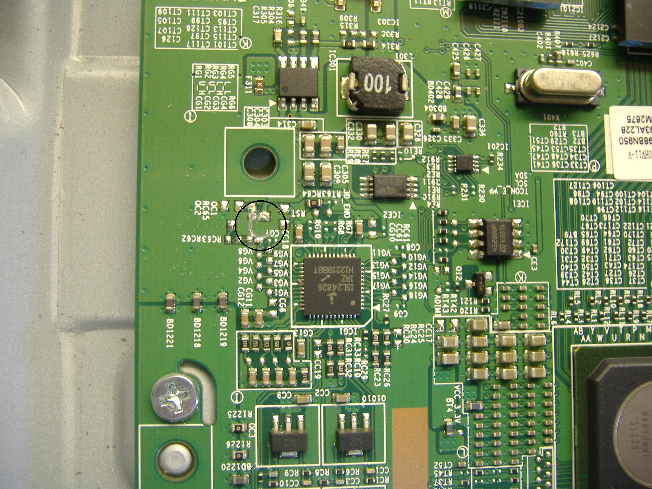

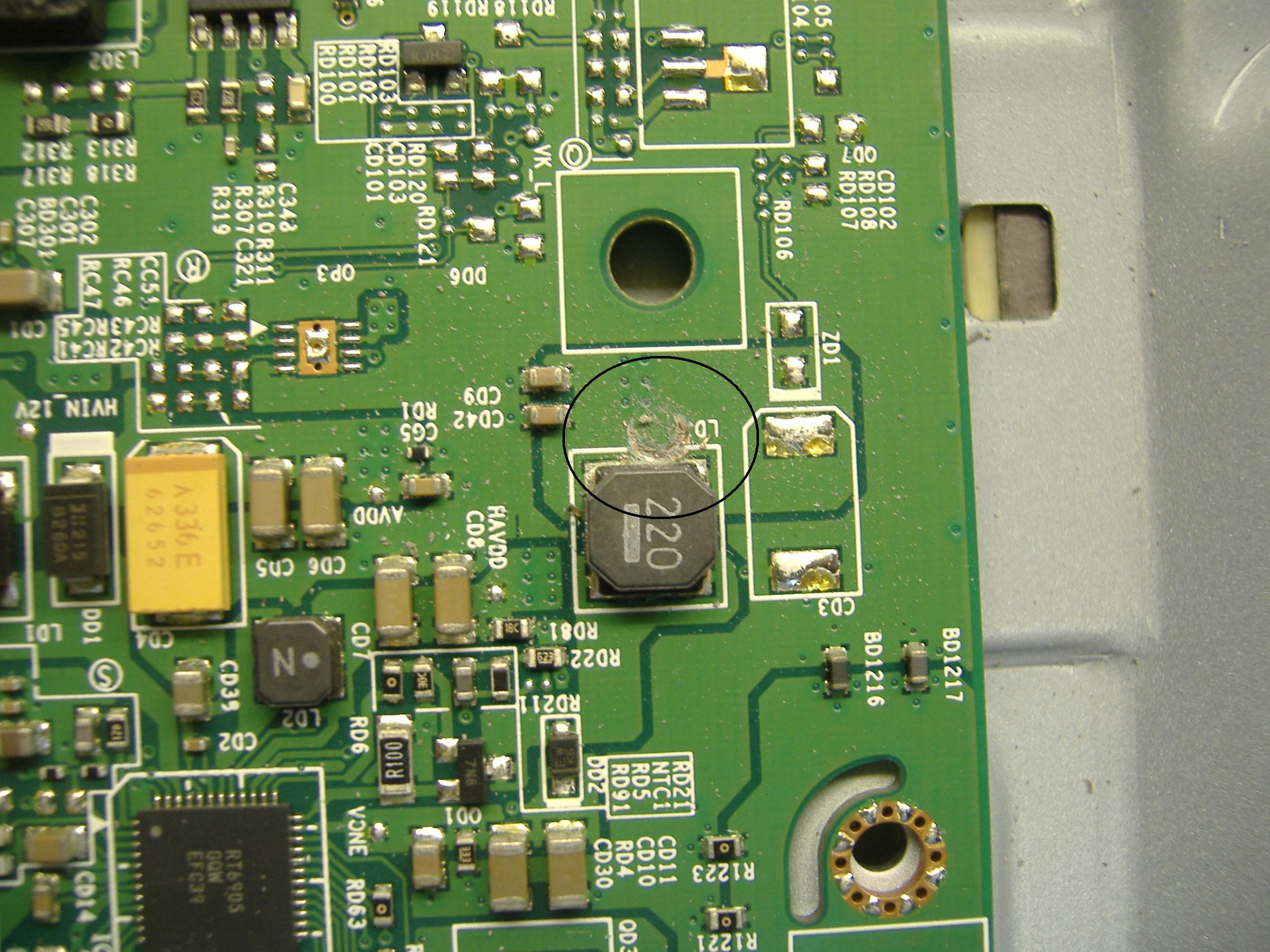

    However on re-assembly I noted two "pock" marks on the Tcon, that lined up with the holes for the Stand. (see photo).
    The Stand screws are not the originals, are long and obviously damaged the Tcon.

        Looks as though someone else has been inside and as you say used the wrong screws. The 3rd picture certainly shows that some of the tracks have been shorted to ground.

            The plate is missing. How did the TV even stay mounted on the stand?

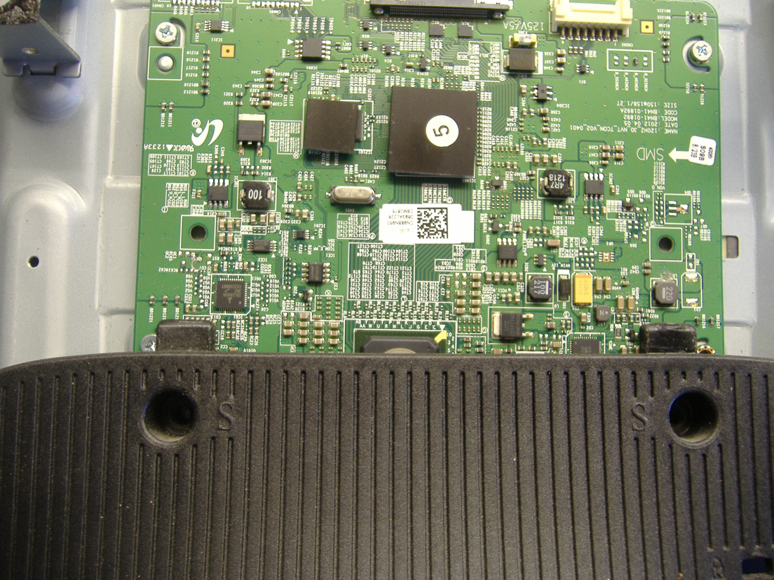

                Where's the cover for the T-Con, it's usually in a sheet metal can?
                Also, the T-Con should have had a sticker on it, Samsung usually puts it near the panel connectors?

                      That's what I thought, I've never seen an LCD with out a "can" over the T-con.
                      And the Stands always attach to a bracket arrangement that attaches to the main frame.
                        Hi Dick, yes, I should have included a photo of the screws, galvanised type screws that you would find on a kids play ground swing.
                        A bit dismayed that I had concluded that the panel was faulty, then again I was going on the person's information. Misled unfortunately.

                            I have seen this a few times now.
                            Worng stand screws going into t con
                            Key note
                            If the screws appear too long or not original ones.
                            Go straight to the tcon and look for damage
                            Very evident on some hitachi lcd
                            where there is few mm clearance with the original screws.
