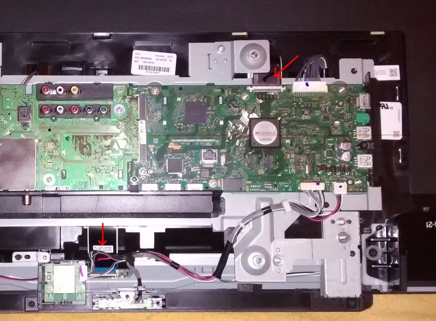

    Sony KDL 48W600B Picture goes away, sound and backlights still work.
    This one is a funny one, to me anyway.. The TV turns on and the picture is there for a couple of minutes at most, you can navigate to "Help" and shortly after that it fades out. You can continue to navigate as you can hear the "click" sounds as you navigate, the back lights are still on too but the picture is gone..
    I'm including the picture of the back opened up. It's not a closeup but let me know if you need one. And the line you see in the image is in the camera, not on the board.
    Any ideas?

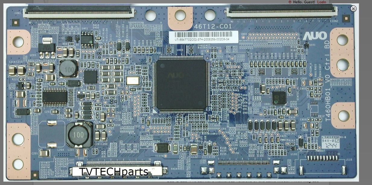

      Does this model have a Tcon board similar to attachment?

            I don't see a Tcon board in it. It looks like it feeds off the main board. I'll post another pic shortly showing a ribbon cable connection (both ends).
            I also need to make a correction on the model. It's not a KDL 40W600B but instead a KDL 48W600B. I know that may not make a lot of difference, but sometimes it does. Sorry for the confusion on this.

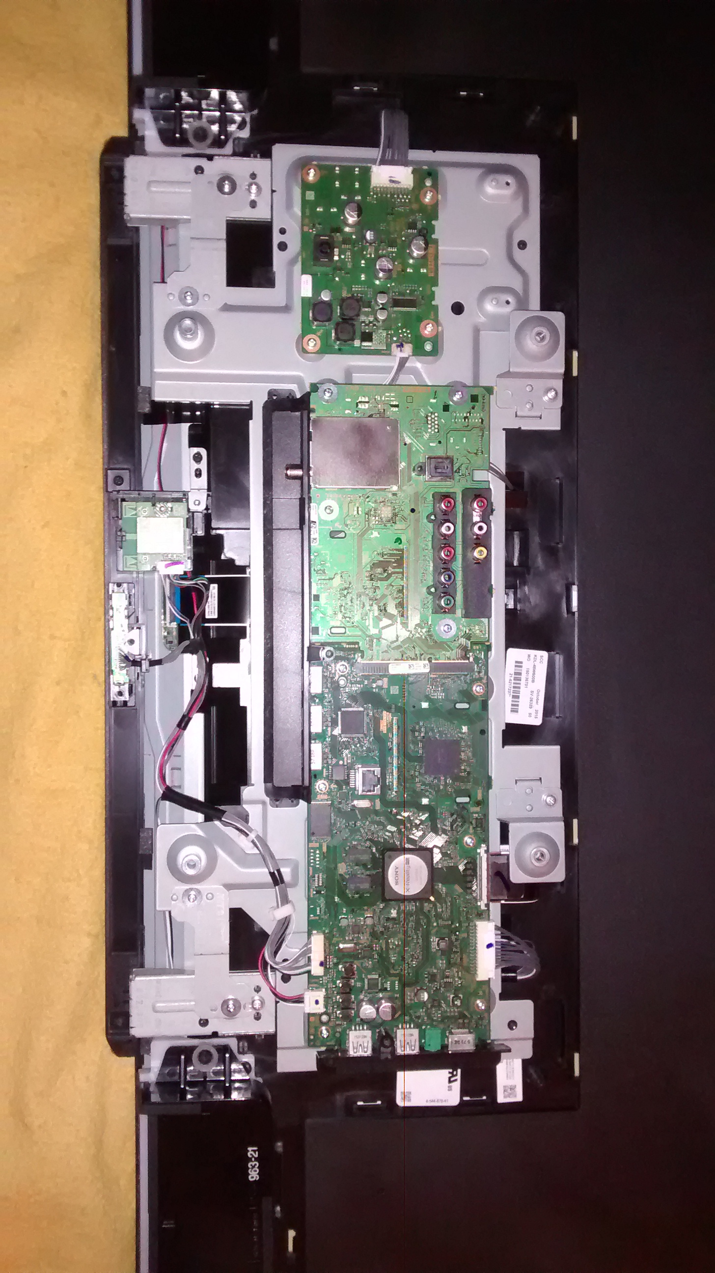

              Here is the only ribbon cable I can find. It looks to go from the top of the main board back behind or under the back of the main board, down to the other red arrow where it connects to what looks like a small circuit board that is about as wide as your finger.

                  To the RHS of the LVDS cable where it is marked F8001 there is a small black transistor/mosfet. Can you measure the voltage on the 3 pins with black meter probe to chassis when you have a display and after it fades away.

                    Is the gamma chip the one that says "Sony X-Reality Pro" on it? It appears to be heating up. Will try to cool it down or transfer the heat some way and see what happens.
                    I took readings before and after, here they are:
