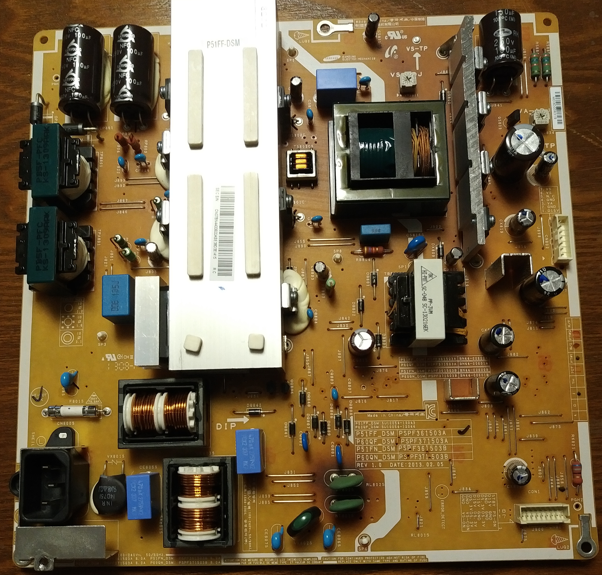

    Hi everybody. I recently acquired this 2013 Samsung Plasma TV, model PN51F5500AFXZA for free because it wasn't working. The red LED just continuously blinks when plugged in.
    The thermistors on the power board look cooked, with some discolouration of the PCB around them. I've attached an image of the board. The thermistors show as shorted when connectivity tested with multimeter.
    I tested all the diodes I could see, they all appear working, no shorts. No bulged caps. Nothing else looks shorted or burnt out. The fuse looks fine and tests shorted with continuity.
    Power board is: P51FF_DSM PSPF361503A
    Should I try replacing the thermistors? I found this part number for thermistor for this model: 1404-001224

    thermistors do run warm . they should lower resistance as they get warmer ..look up the spec sheets .. they probably start about 2.5 ohms at room temp.

          I wouldn't advise you run it, thermistor normally blows if there is shorted fets.

              Service manual which may be of help.
              Thermistor details
              Manufacturer Samsung
              Part Number 1404-001224
              Description THERMISTOR-NTC;10K ohm
                Re: Samsung PN51F5500AFXZA issue - Power board thermistors cooked?
                10K Ohms, that can't be right for the Inrush current limiter NTC, they are usually around 3~5 Ohms range..
                  is the inrush thermistor the black one next to power socket ?
                    It's the two green devices at the bottom of the picture in post #1
                      whoops yes .. black one is varistor ..i just found a schem but only shows one thermistor at 5ohms nt811s .. mustn't be correct schematic ..
                        That power supply is most likely fine. It rarely goes out. With power disconnected and voltages at 0v check the resistance between VS and ground. You may find it to be shorted due to a bad X or Y sustain. If not check the transistors on those boards for shorts to ground.
                        Also pictures of the back of the set would help.
