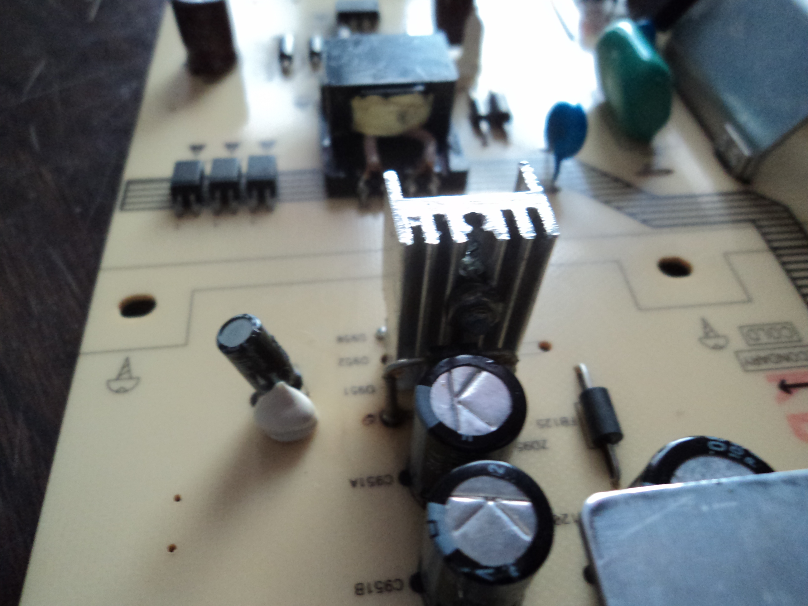

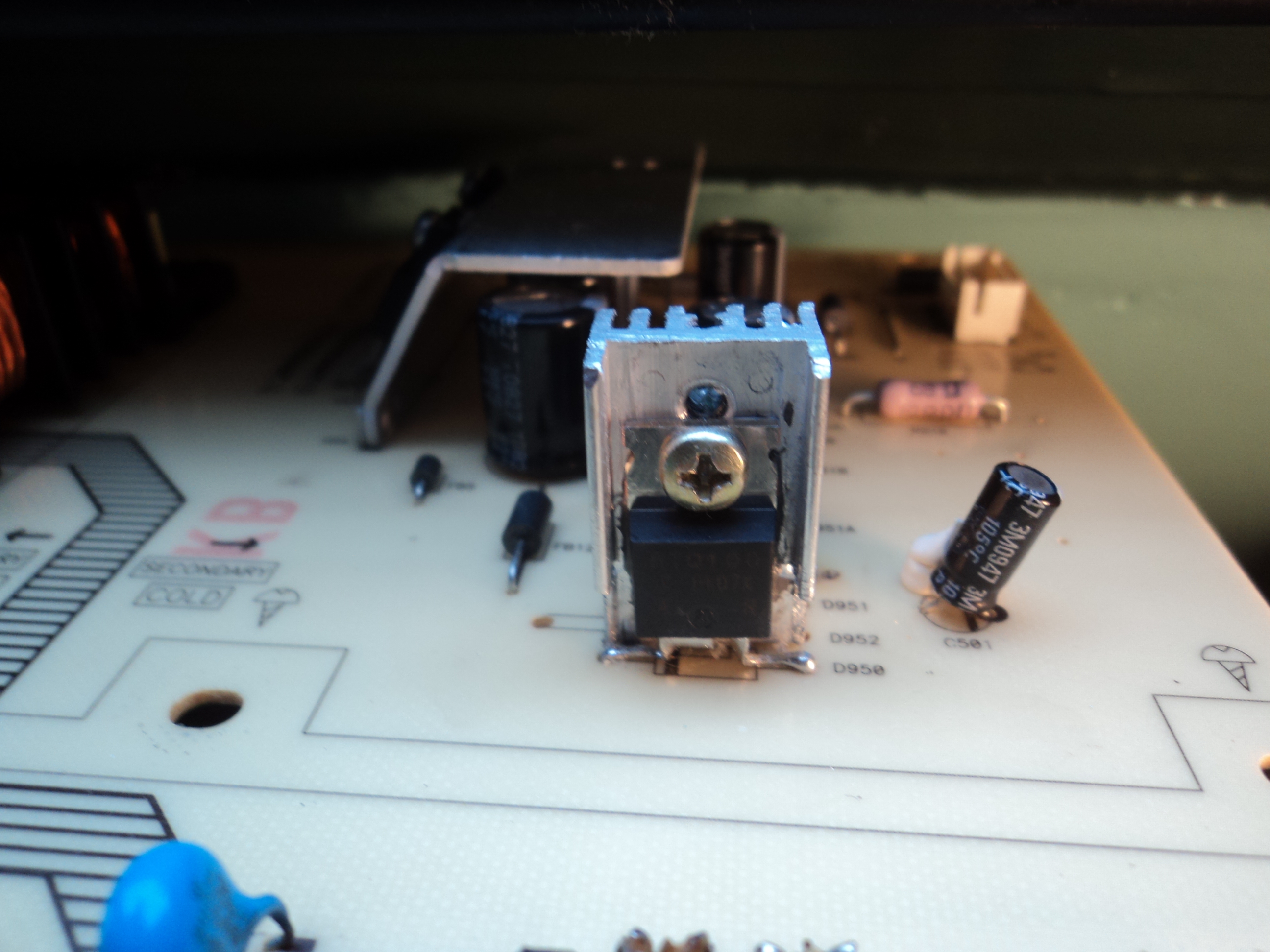

    Hi guys i trying to fix a Philips 46pfl5505d/f7 dead ,i found D951 short ,now i red in this thread link bellow, to add a T0-220 with heat sink in place of D950,D951,
    i have this To-220 see link ,is this a good one for this job? thanks
    http://www.mouser.com/Search/Product...4-APT10SCD120K
    https://www.badcaps.net/forum/showthread.php?t=48765

    what original part # is D951 in yours? Do you want to replace the SB260 with that?????
    Maybe read my post number 32 in that thread. Replacing a SB260 (60V, 2A) with a 1200V 10A Schottky isn't a good idea.

      thanks CapLeaker; I was going to replace D951 and D950 both SB260 with a single T0 220
      You think i should use 8TQ100 (8A/100V) TO-220 with heat sink instead?

        that's better... a bit of overkill (now that wont blow anymore), but good. Just be careful with the heat sink as it is connected to cathode of the diode.

            Hi guys; update and great success on the Philips 46pfl5505d/f7 repair and due this great Forum with the great tip on modifying and improving the circuit with the T)-220 to avoid future failure, see pic attach. thanks to all one more TV saved from the landfill.

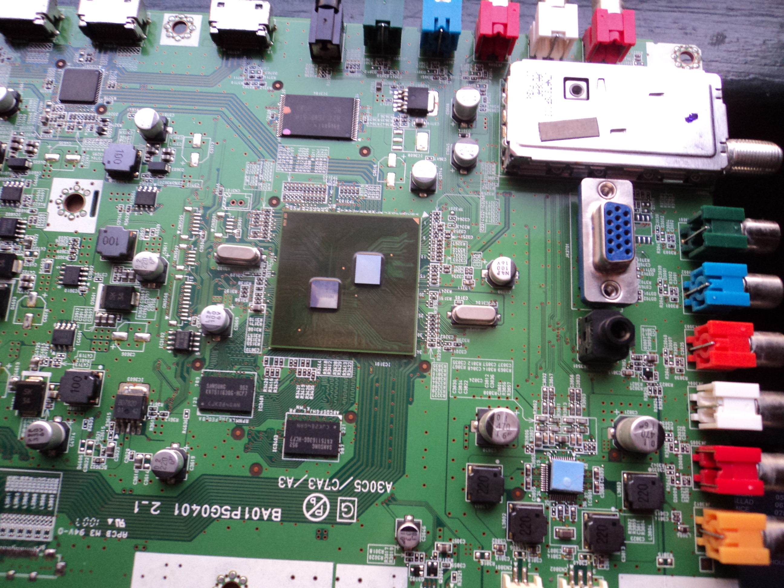

                    At least you got the PSU repaired. It looks about as mean as I had pictured it.
                    Now you have a main board issue? Can we have a straight shot, high resolution picture of it? Was that TV a lightning special or something?

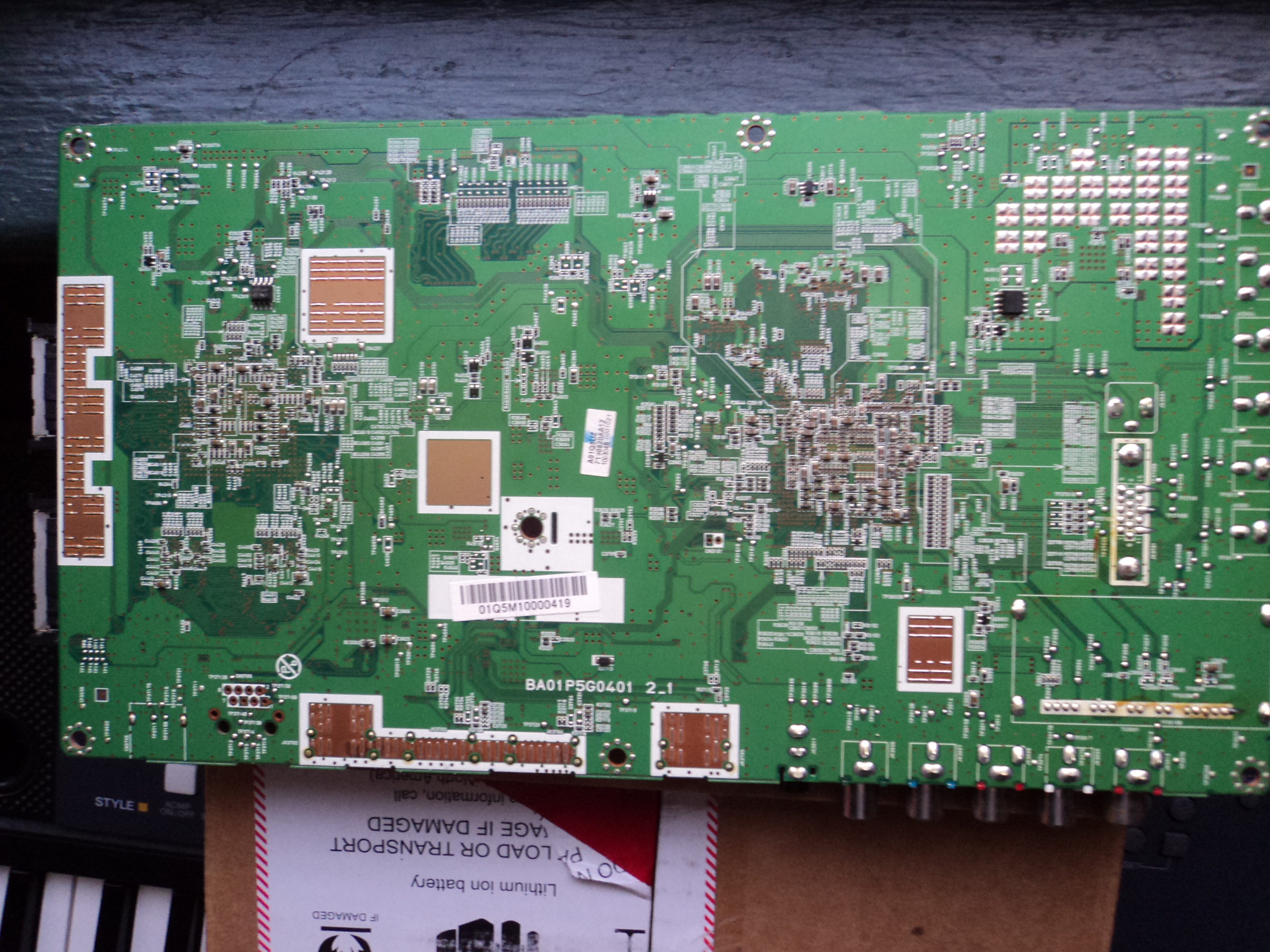

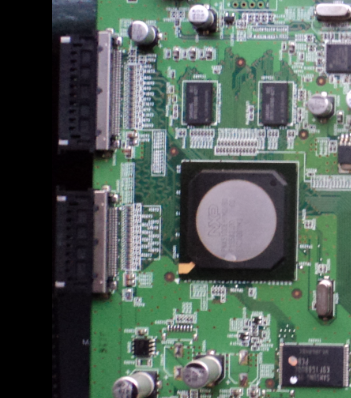

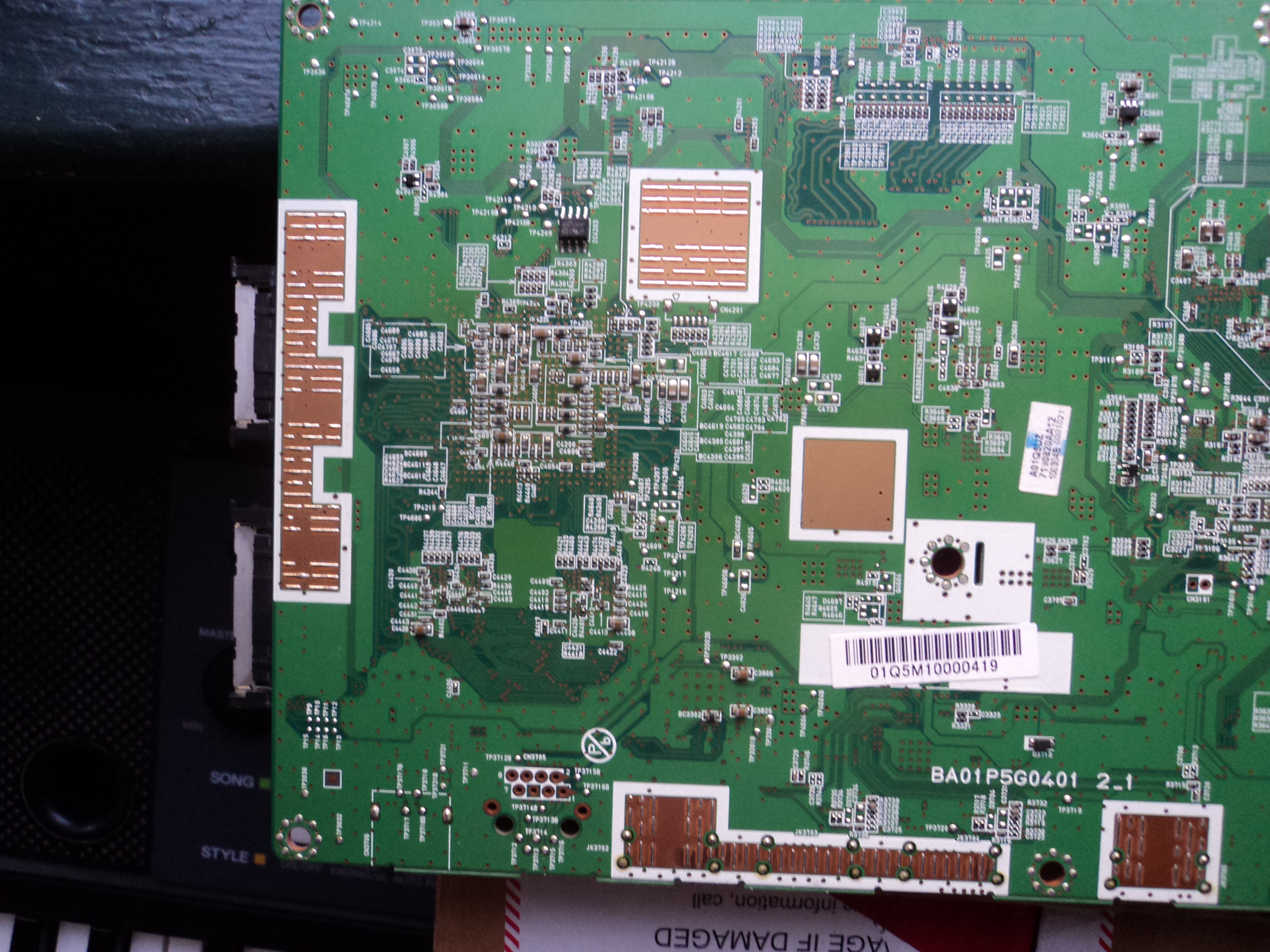

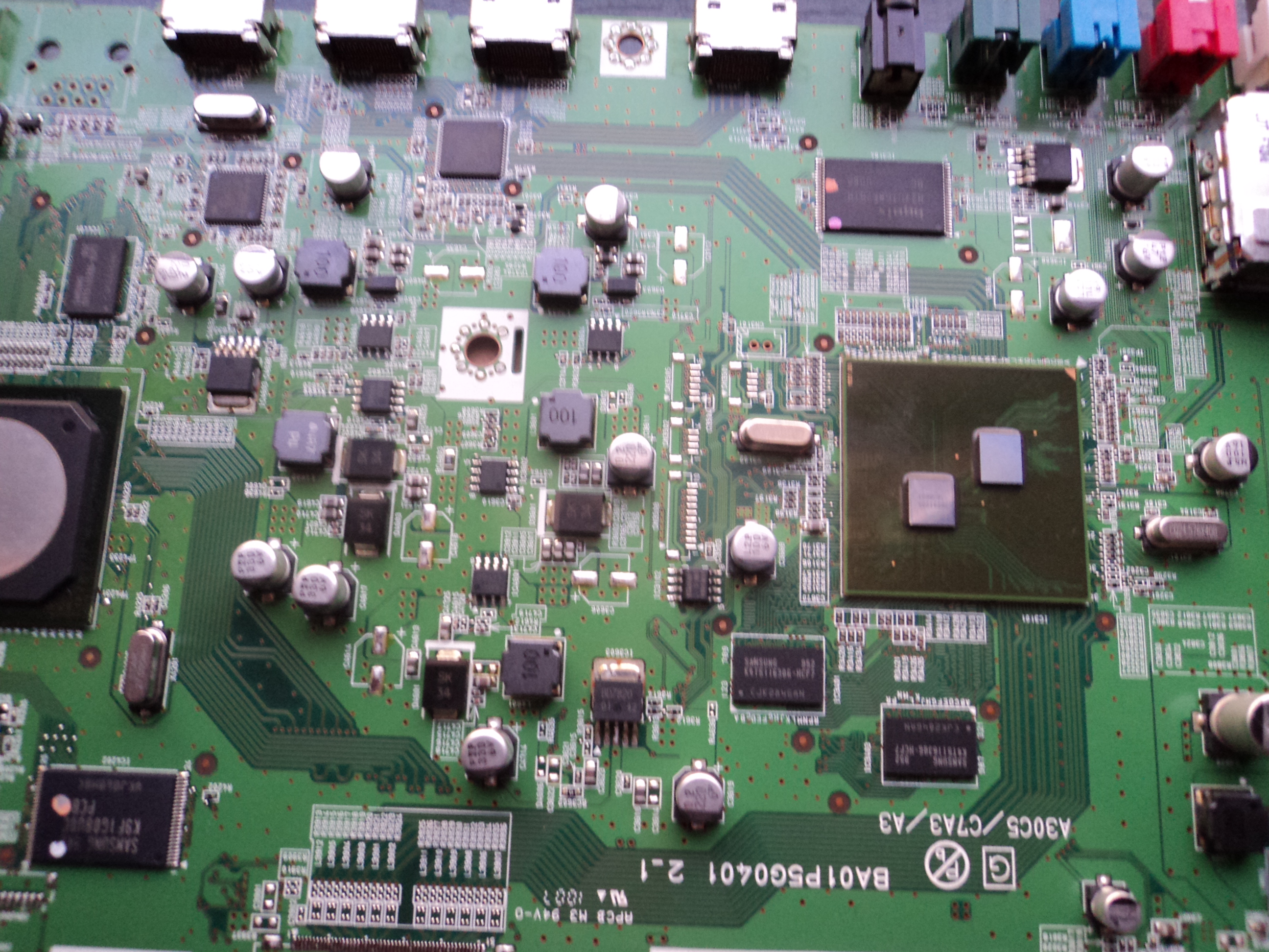

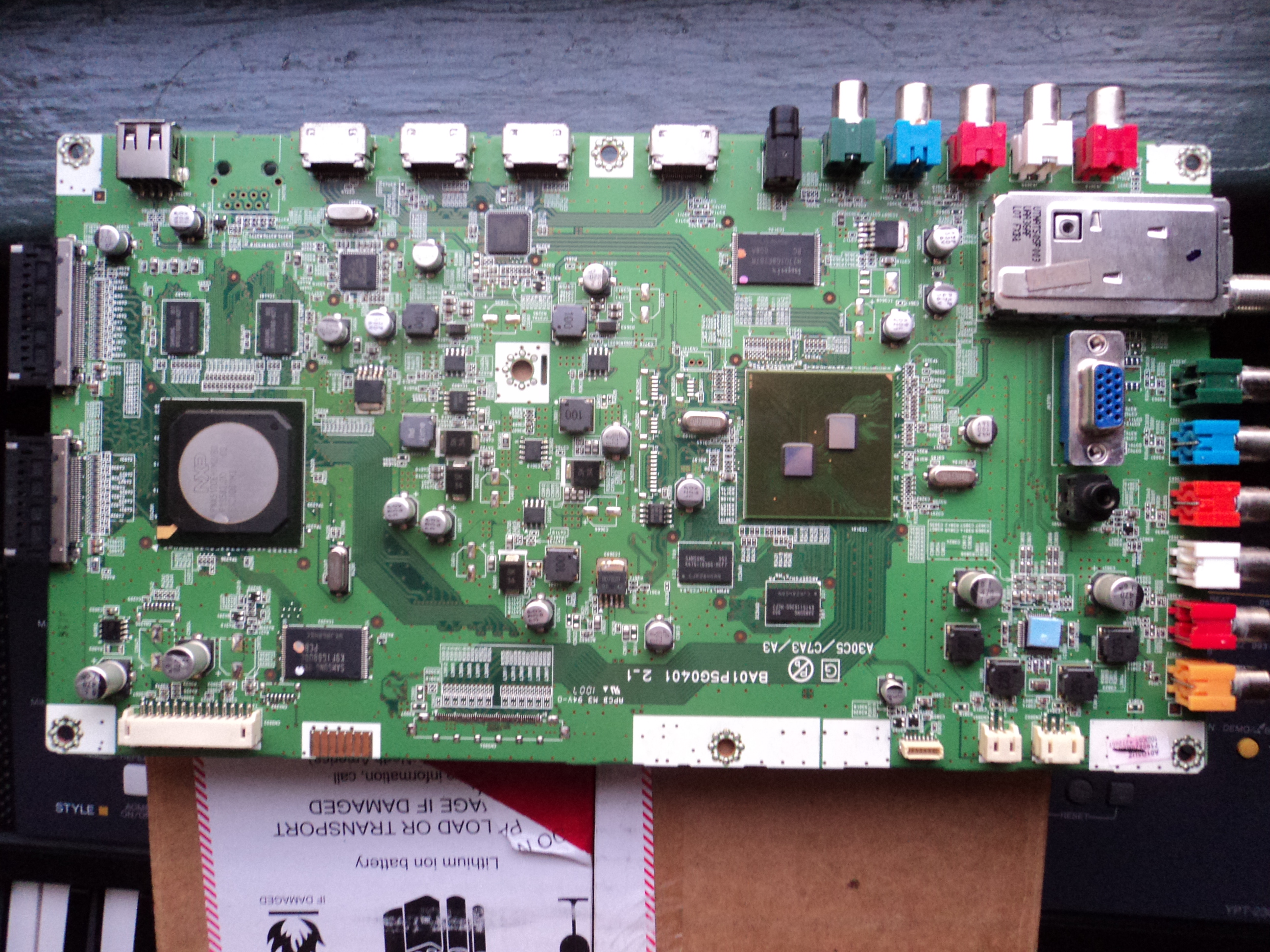

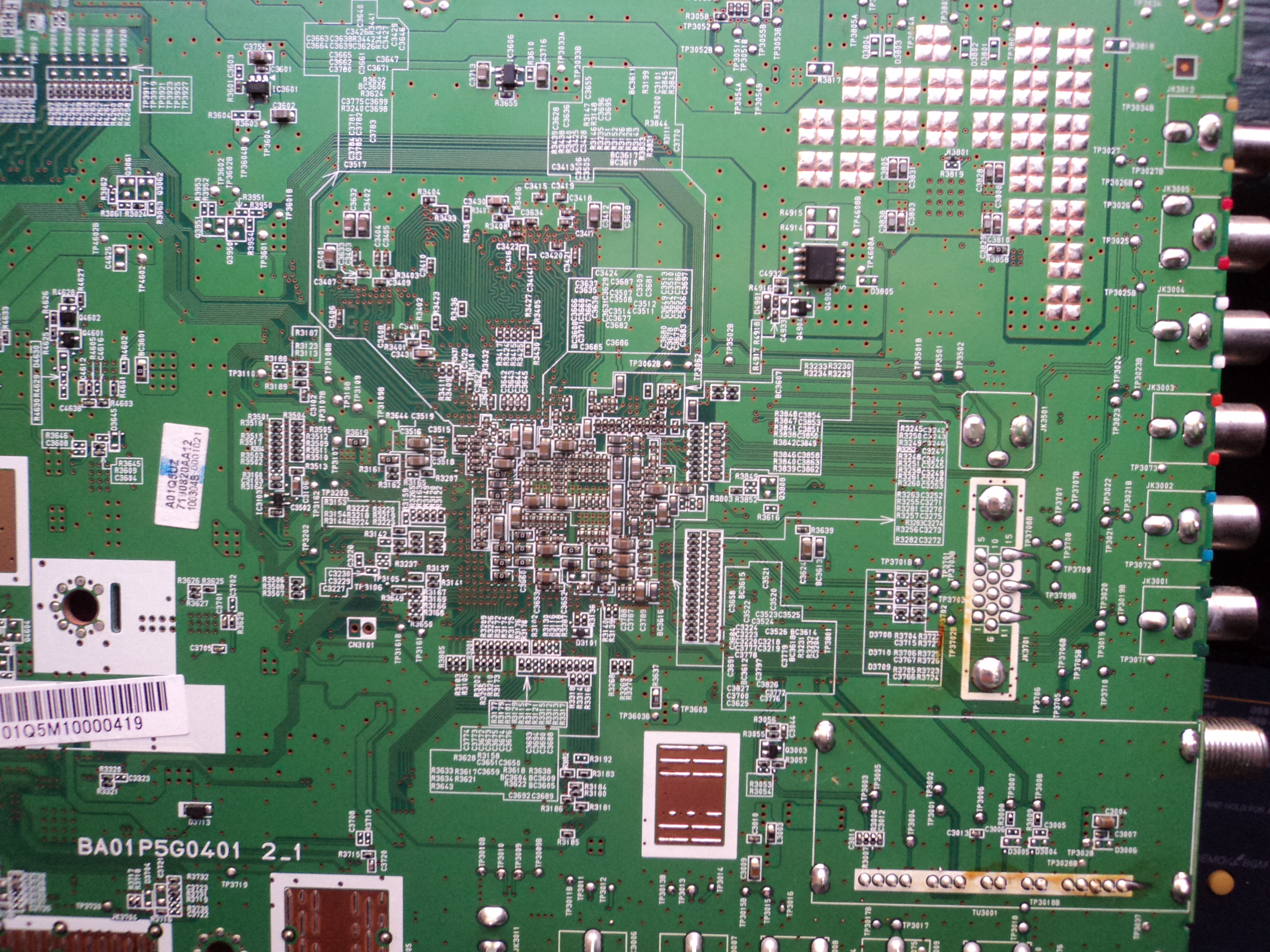

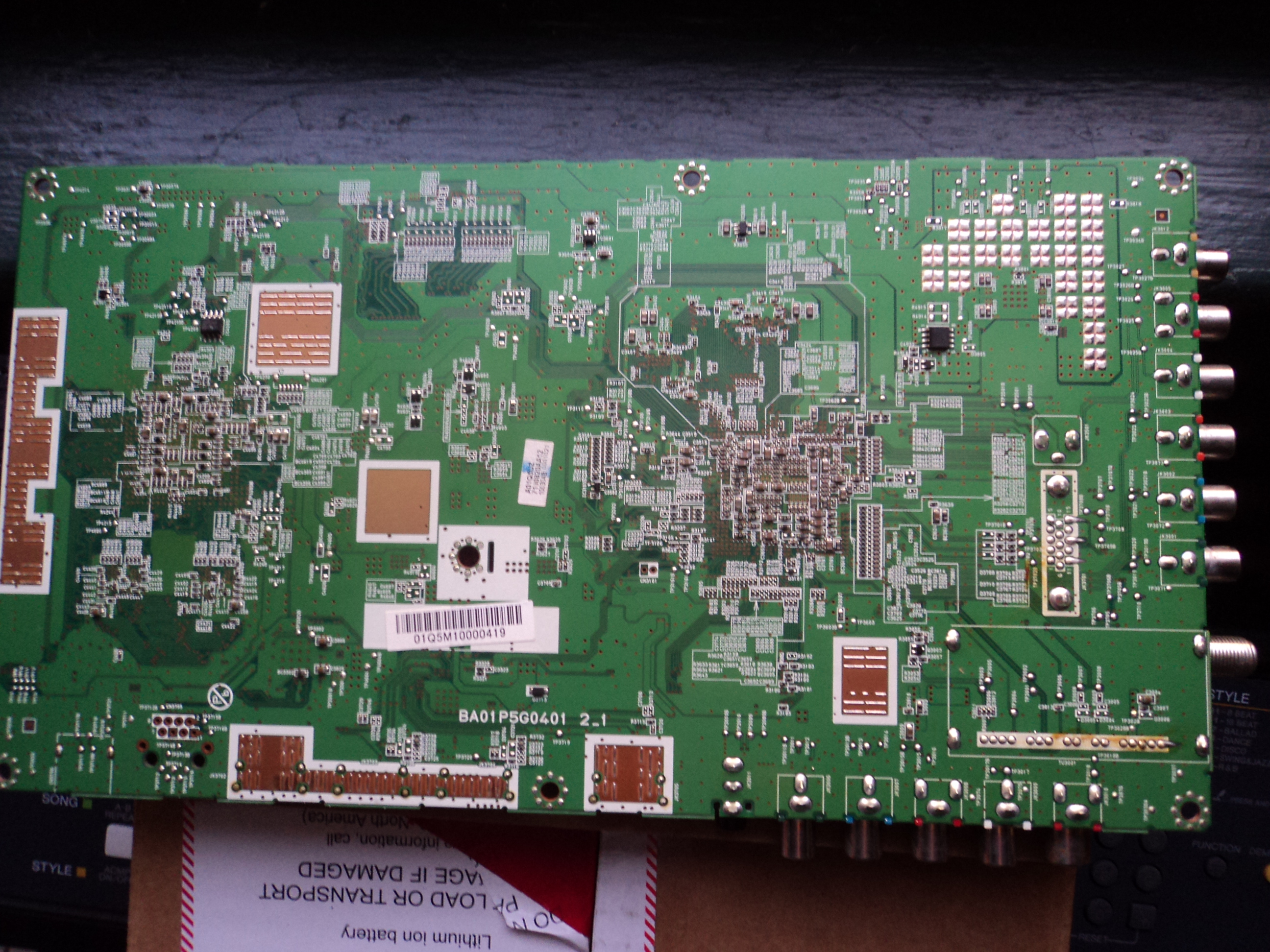

                                Thanks CapLeaker; i found this Main board on Ebay,see link; i think the e-prom is 16 leg, i don't think i can solder these back to the board,also can you please tell me how to remove the connection from the board, the plastic head,i disconnected the flex although same plastics peaces broke,as you see on the Ebay board it doesn't have that plastic end,see my pic attach.
                                I also don't know if i can trust this guy on E bay almost 100bucks for the main board is kinda steep
                                Note;at first i was able to get a few channels on TV mode from the OTA antenna,but after i re-scanned the tuner the tuner did not pic up no more channels therefore could not get any channels anymore,i'm gonna try to heat the BGA and see if hdmi input will show.
                                http://www.ebay.com/itm/Philips-40PF...3D142191856605
                                There are some pics of the whole board,not very good pic cause of my crappy Cam.

                                  Aaah! Weird why it would work once then not anymore. The EEPROM is 8 legged. I don't see any 16 legged ones there. They look like the 8 legged ones in the middle of the board where the screw hole is. I count about 7 of them on the board. However, all you can do is try to find it and freeze it with a can of air upside down, turn the TV on and see if all is O.k. Could be also BGA. Problem is I couldn't find a replacement EEPROM for it. Did you try a factory reset yet? For some reason if I read the whole thread it doesn't sound like an EEPROM problem to me, because the TV is responding and doesn't do any other weird shit besides not displaying anything.
                                  • dick_barton
                                    • Aug 2015
                                    • 6643
                                    • Wales
                                    Re: TO-220 job help?

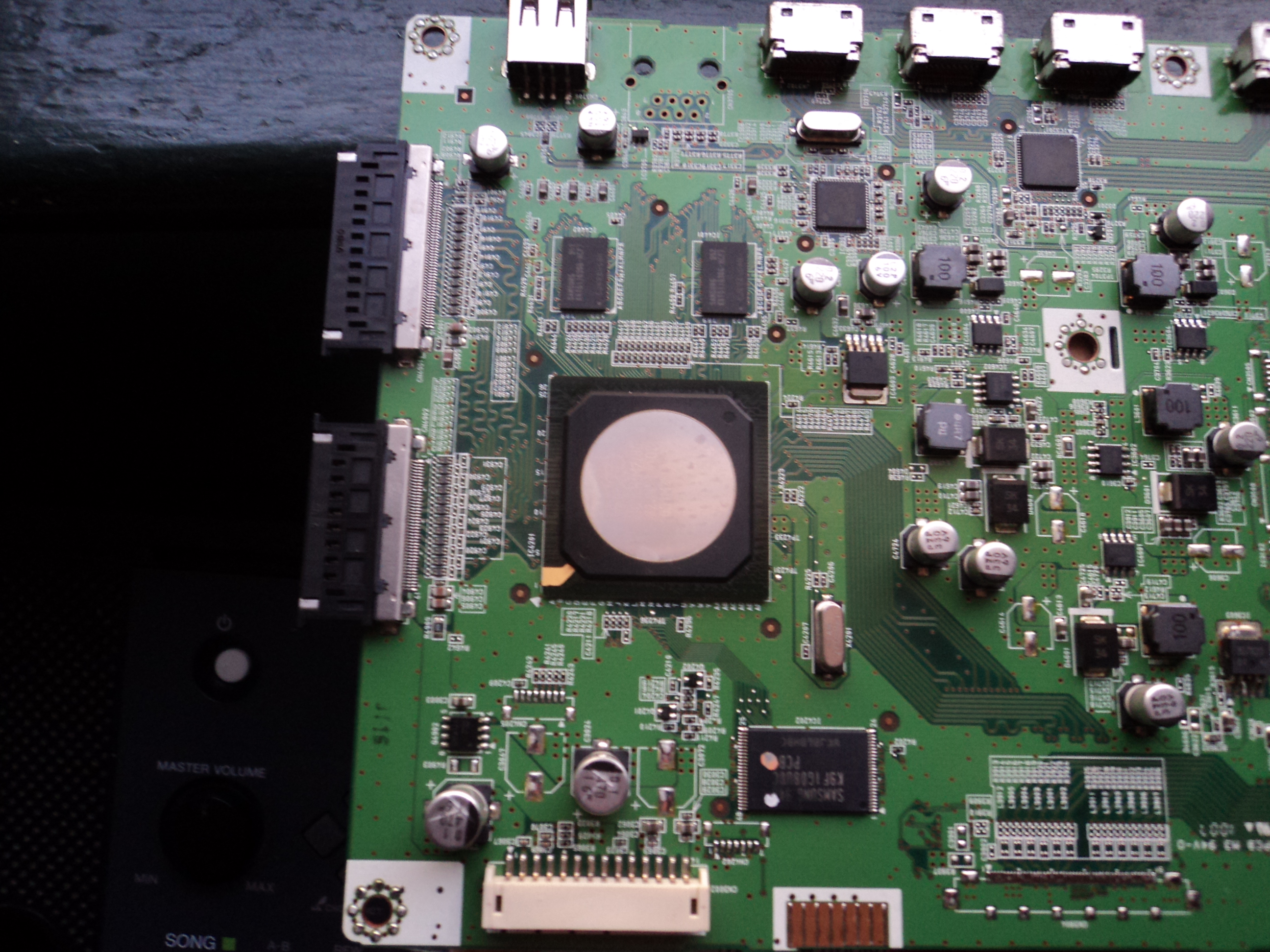

                                    Read the part number printed on top of the 8 legged IC and google them to find which one is the eeprom.
                                    What number is on IC3102

                                      Thank you guys; today i took out main board and used the Heating gun and heated up the CPU and the whole board, then put it back, for now the HDMI inputs are ok, i used my Roku to check,only the Outdoor Antenna,OTA chan won't scan channels,before i did a OTA rescan i had a few channels ,maybe i need to get in the service menu and set Factory default,i have downloaded the service manual from here,see link? .Also this Main board is a pain in the Butt to take out ,and can't check nothing with it in place all the Components are Hidden under the metal casing.
                                      The IC 3102 is AT 24C16BN-SH-T (Memory}
                                      i'm going to buy a original Remote control,hope i get one,and will keep you posted,
                                      if you guys have any idea why i can't get OTA channels when i rescan,please advice what could be,thank you all for your great help and thanks BadCaps for this great Forum.

                                        thats the eeprom
                                        But you don't have an EEPROM problem anyway.
