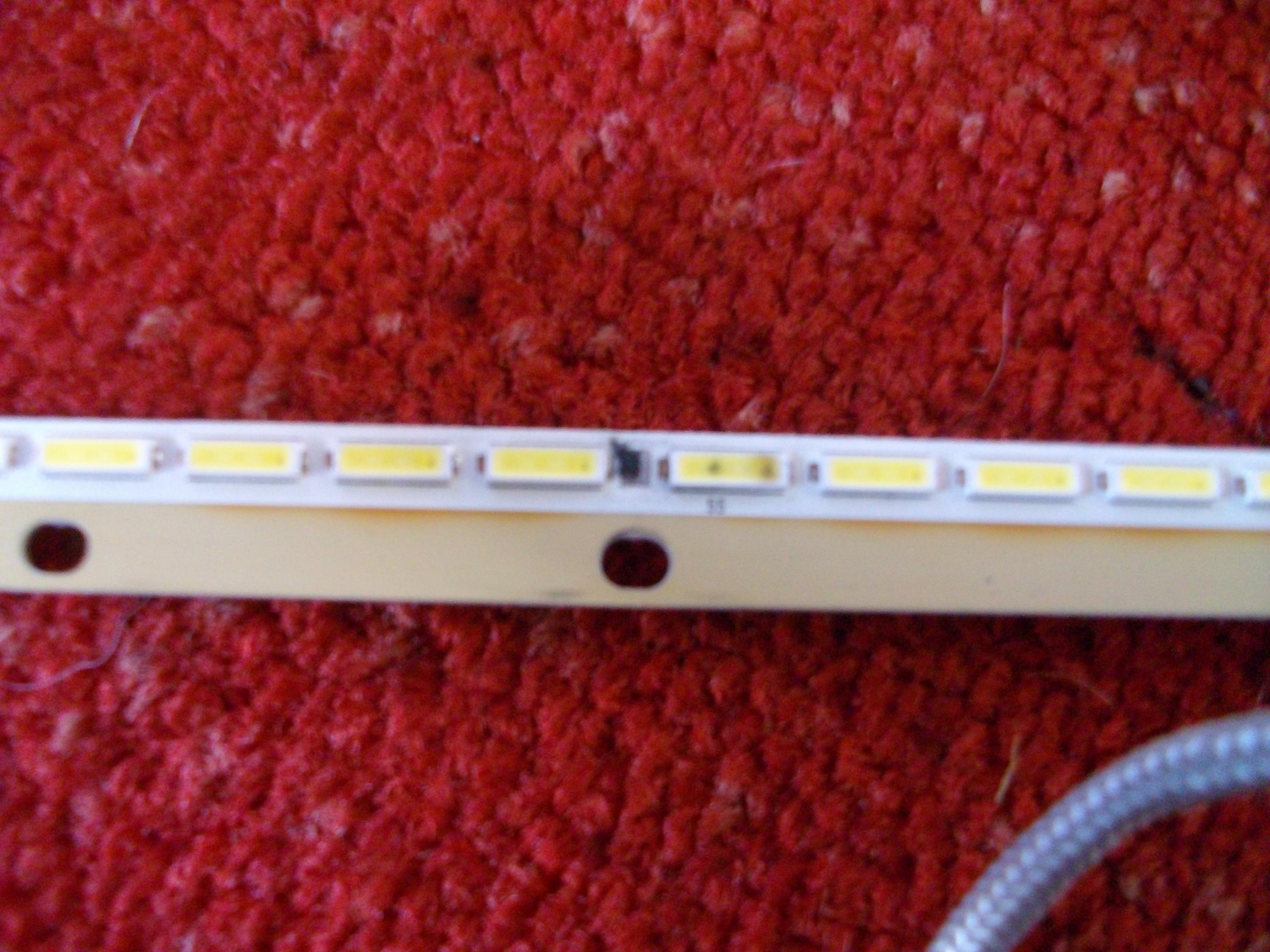

                Re: finlux 50fme242b-t flashing backlight leds
                Hi All
                Can someone advise me if the above backlights are repairable
                and what does it entail, there is one led out in the strip but
                there are 22 pairs that are reduced in brightness out of 72.
                There also seems what look like resistors blown off the board
                but not sure on that, any help would be greatly appreciated.
                Alan
                  Contact Microtech AV Services and see if they can help you identify replacement leds

                      Forgive my ignorance but is it the metal strip you heat,
                      to remove the led's?
                      Alan.
                        alloy strip on rear of LEDs, heat until you can remove LEDs without force, replace by dropping the new LEDs on to the pads using a little flux, and heat from the rear ( make sure to have the LEDs the right way round) Good luck Flocko
                          There is some that are not at the same brightness as others, do they need replacing as well.
                          Alan
                            There are two LEDs side by side in one case, if only one is working it will show as not being as bright, this is why using 4.5v to test them is useful as they do not burn your eyes out at this voltage, and you can see if only one half of the two are working (although they are working the shorted side will not lite ). If you have a lot of LEDs like these in any of the strings I would replace them as they will fail in time
                              What I mean is there is one case where one LED has failed,
                              there are 22 working with two LED'S but not as bright as the others.
                              hth
                                The part where you say looks likes blown resistors on the board is that the area where the leds are less bright?
                                  In the picture P#27 shows one of the area's where these have come from I
                                  am not sure what they are as it does not appear to be a circuit.
                                  There are five of these along the length of the backlight.
                                  The dimmer ones run the whole length of the strip.
                                    I wonder if they are protection zener diodes.
                                      Well when I say there are five, there was five (as they have all come off).
                                        your problem could be with the four string driver IC (MP3394S), take the time to look at its data and how it works, as for the crispy black parts they were diodes that stop the strings back flowing, but should work without them as the LEDs will do the same job
