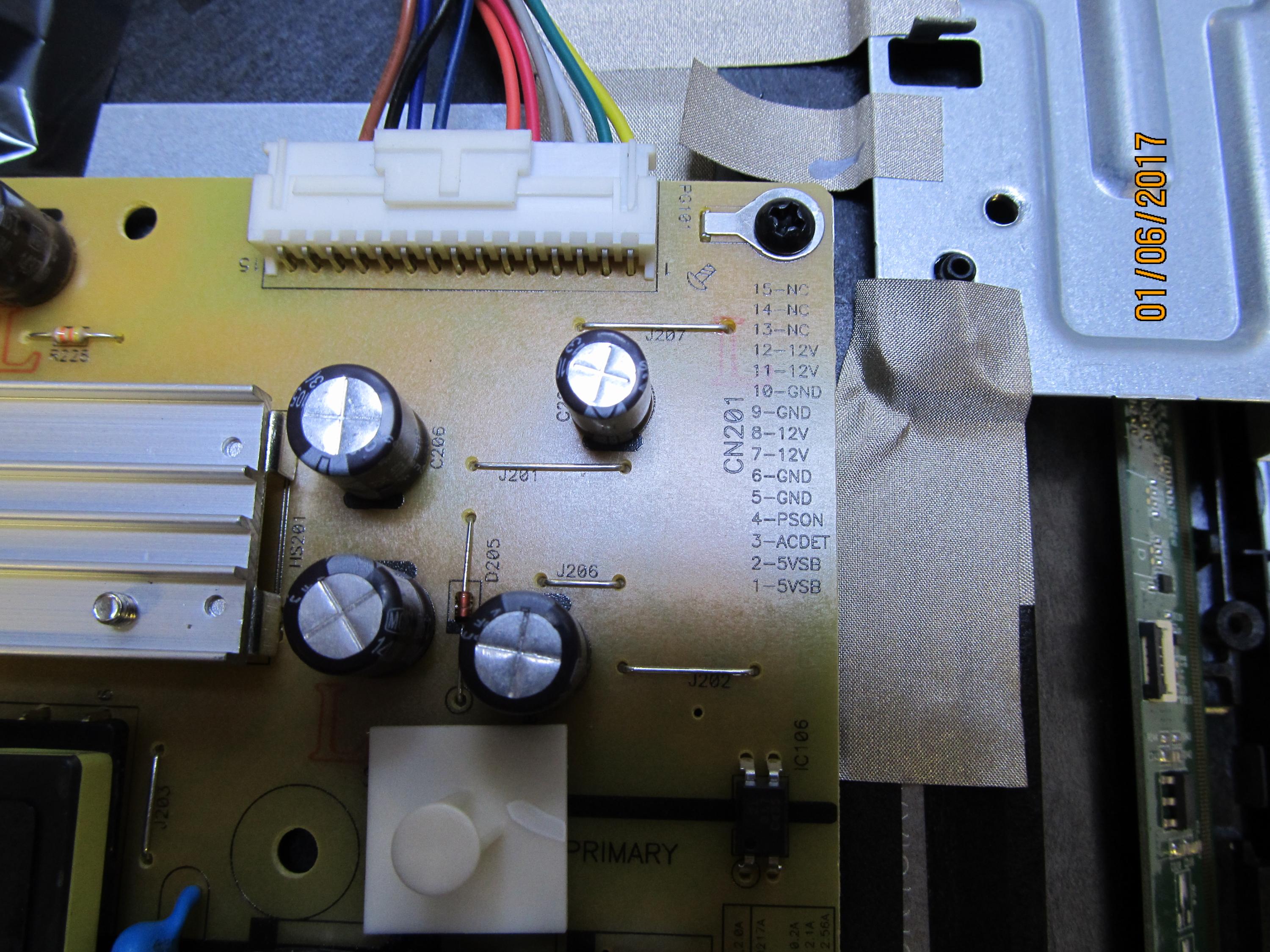

Vizio E400I-B2 powering on problem
    Re: Vizio E400I-B2 powering on problem
    OK, that means the 32VDC is normal then,, those caps are the filter caps for the output of the Boost converter circuit that boosts the incoming 24VDC to higher level for running the LED string, and you are getting about 8VDC on the Cathode side of each LED strings so it sounds like the MOSFET for each of the LED current return lines are not being turned on.
            I have the exact same results with the exact same model tv. I do not think the led's are the problem. I believe the main board is the culprit. I Checked voltages on cn201 both while on and while powering on.
            while on: 1 and 2 are 5v, 3 is 3.3v and all of the 12v are 0v.
            While powering on the 12v all read 12v then go down.
              I forgot to mention pin 4 is 0v while on and 3v when turned on.
                So you do have PS-ON (3 VDC) on pin 4 when TV is turned on but you are not getting the switched 12 Vdc, you have problem with the power supply.
                  Just tested all of the LED's and all lit up fine. I am leaning on a bad main board.
                    I get 12v when turned on but then it goes to 0v.
                      #30
                      If pin 4 3V is present and stays at 3V or so but the switched 12V drops out then you need to check that 12V section to see if it being loaded down, or bad parts, etc.
                        So you are saying power supply. I will check in the morning.
                          #32
                          We need good clear straight shot pictures of your power supply board top side and the bottom side.
                            or something connected to the 12V rail on the PSU loading it down.
                              Kind of good to know that I'm not the only one with this problem, but it also kinda sucks. Means there's probably a lot of others as well, as it may just be an inherent flaw with this particular model.
                              Maybe I should leave the picture taking to nwcs, since it'd seem my camera produces really poor quality results. if he can't get back to us with some, then I'll borrow a friends phone to take pics with instead.
                                #35
                                So did you at least check the resistance of the 12V pin against GND to see if it shows really low resistance?
                                    It has been off my bench for a while but I think it was the power supply.
                                      OK, I have three of these TV's in same issue. I got a used main board off ebay and still have same problem. I did check to see if there was anything displayed on the screen (hit the menu button and used a flashlight to look) and there is nothing. I have verified all led's are at least lighting and the measurements were taken off of the power supply.
                                          Sorry, I thought I had already posted the repair. On this model it ended up being the power supply had failed, just like budm had thought. I had a E420i-A0 with almost the same problem and it ended up being the main board.
