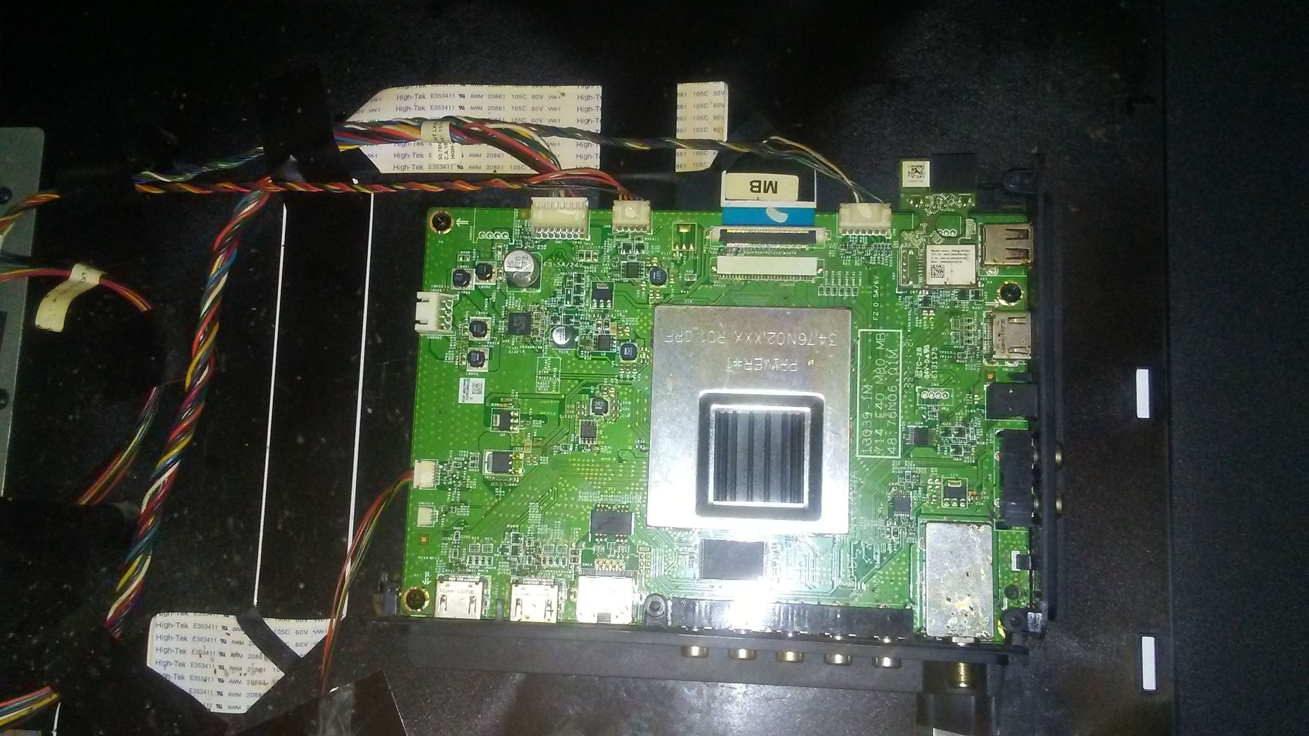

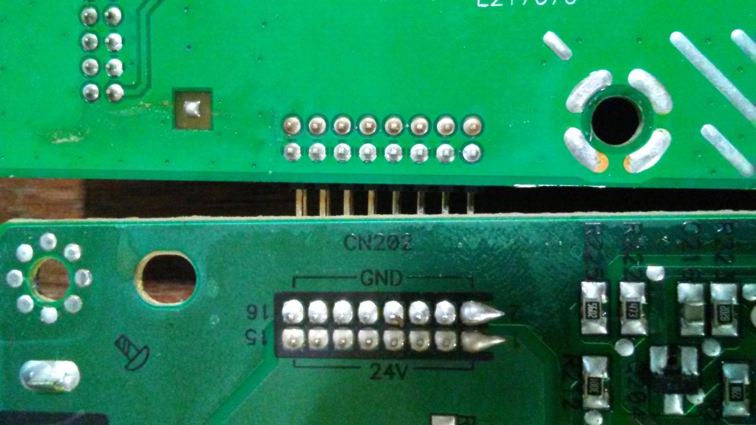

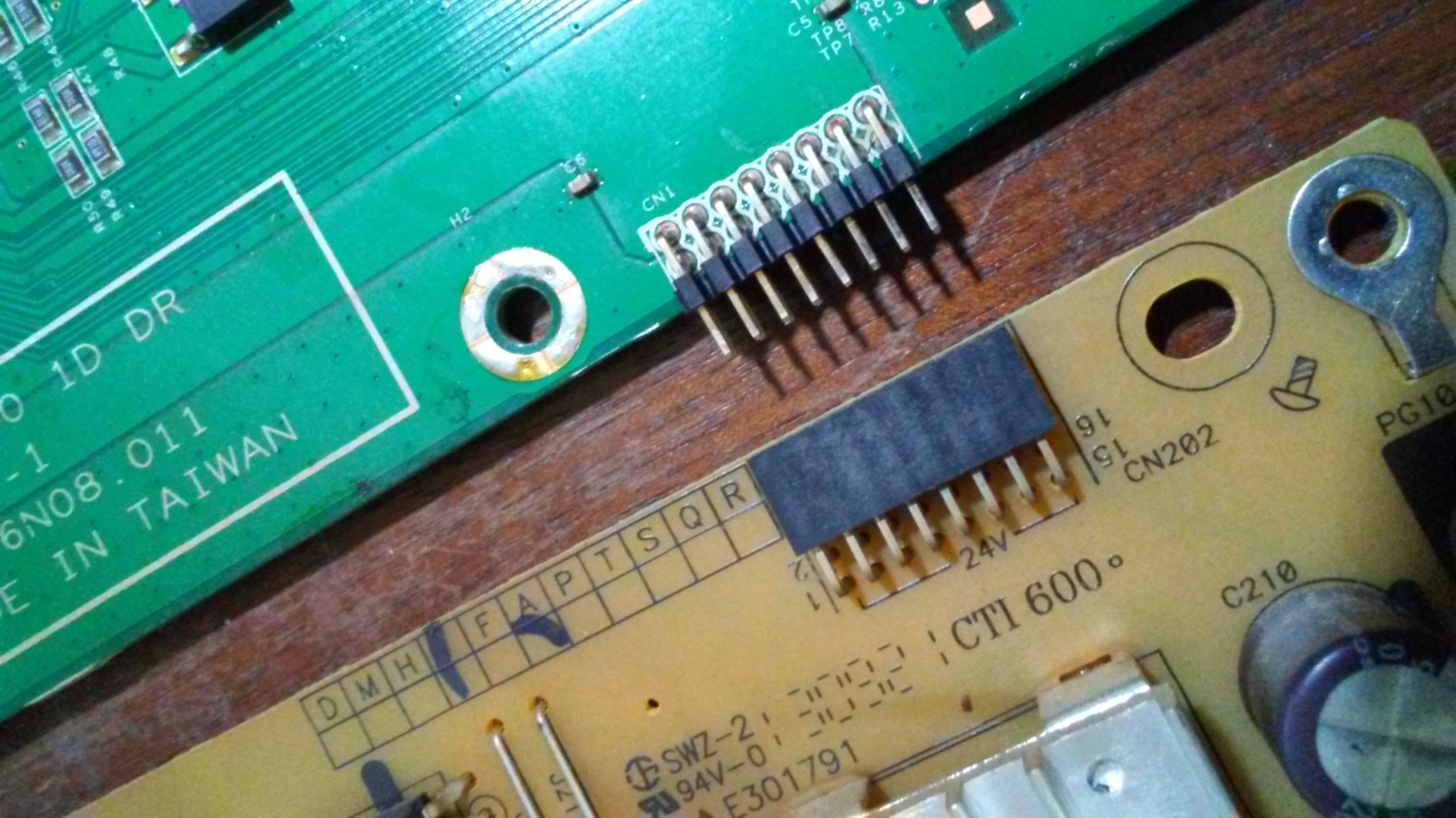

    Hello!
    A friend of mine had brought me a TV to look at, to see if I could figure out what was wrong with it for him. When hitting the power button, it will flash 'Vizio" across the screen for about 1/2 a second, and then go right back off again.
    I've already checked the yellow 5v wire going from the power board to the mainboard, and it's reading a solid 5v. So I'm trying to figure out how to proceed, in figuring out what the problem is. There is a very rapid "clicking" sound coming from the power supply board, but it's not very loud. Not sure if that's normal though, as I'm still not as familiar with this department as I'd like to be. And OH YEH, there was also a huge roach nest inside as well, although it seems to have been an old one, as (luckily for me) there wasn't a single live one. I'm going to assume, that the problem has stemmed from that in some way.
    I've checked the caps, and none seem to be bad as far as I can tell, but I've included some pics anyway. If you need better ones, please let me know.

    Usually, when it does this, it means that there are bad LEDs in the backlight. A lot of VIZIOs will apply power to the LEDs, which will trigger a fault condition if there are bad LEDs on the strips, which then results in the TV shutting itself down. I've seen this condition more than once.
    First thing, though, is to check the backside of the connector that connects the two boards together for fractured solder joints. These TVs have a bad habit of being shipped with broken joints.

      Hmm... the pictures are too blurry... but check the power on each string on the LED connector. It will tell you pretty quick whats going on. For now I am thinking bad LED's as well, or a bad joint on a connector etc.
        Hmm, well I've checked the backside, and the solder joints "appear" pretty intact. I've included pics also, just in case I don't know what I'm talking about.
        This is the first time I've ever worked with/on an LED TV, so I have absolutely no idea where/how to check that. Care to share any pointers on that, by chance?

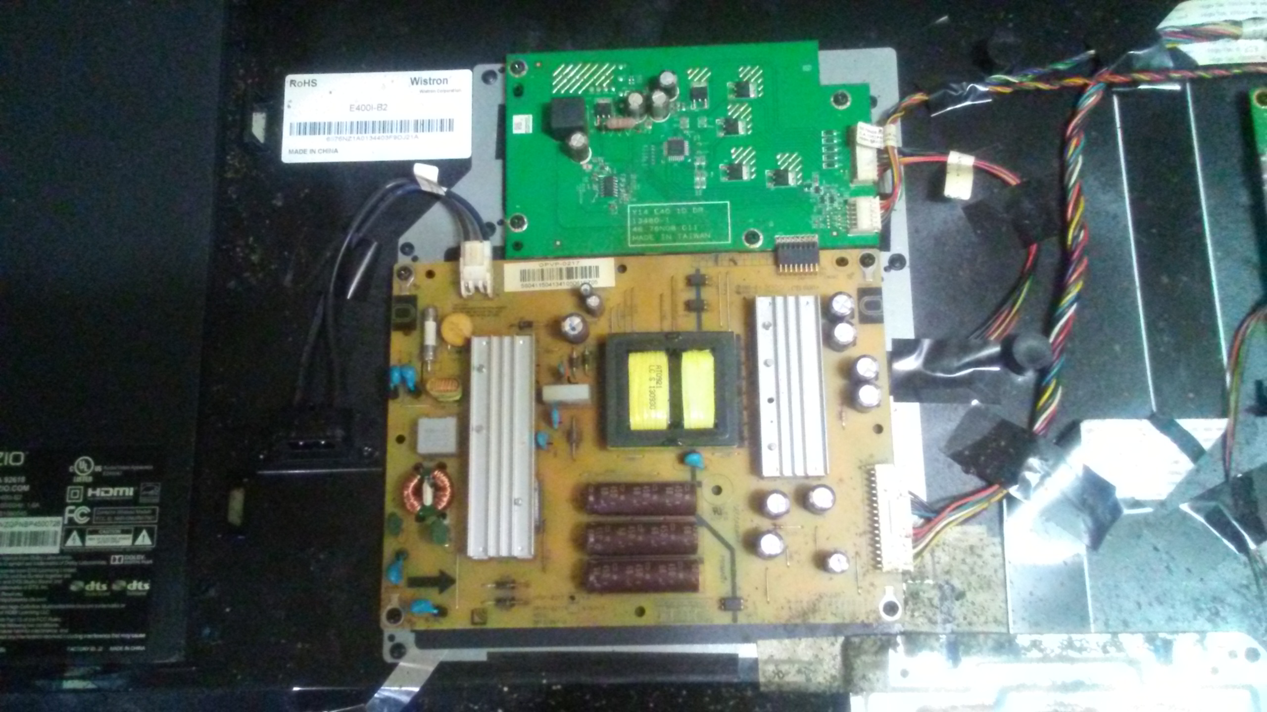

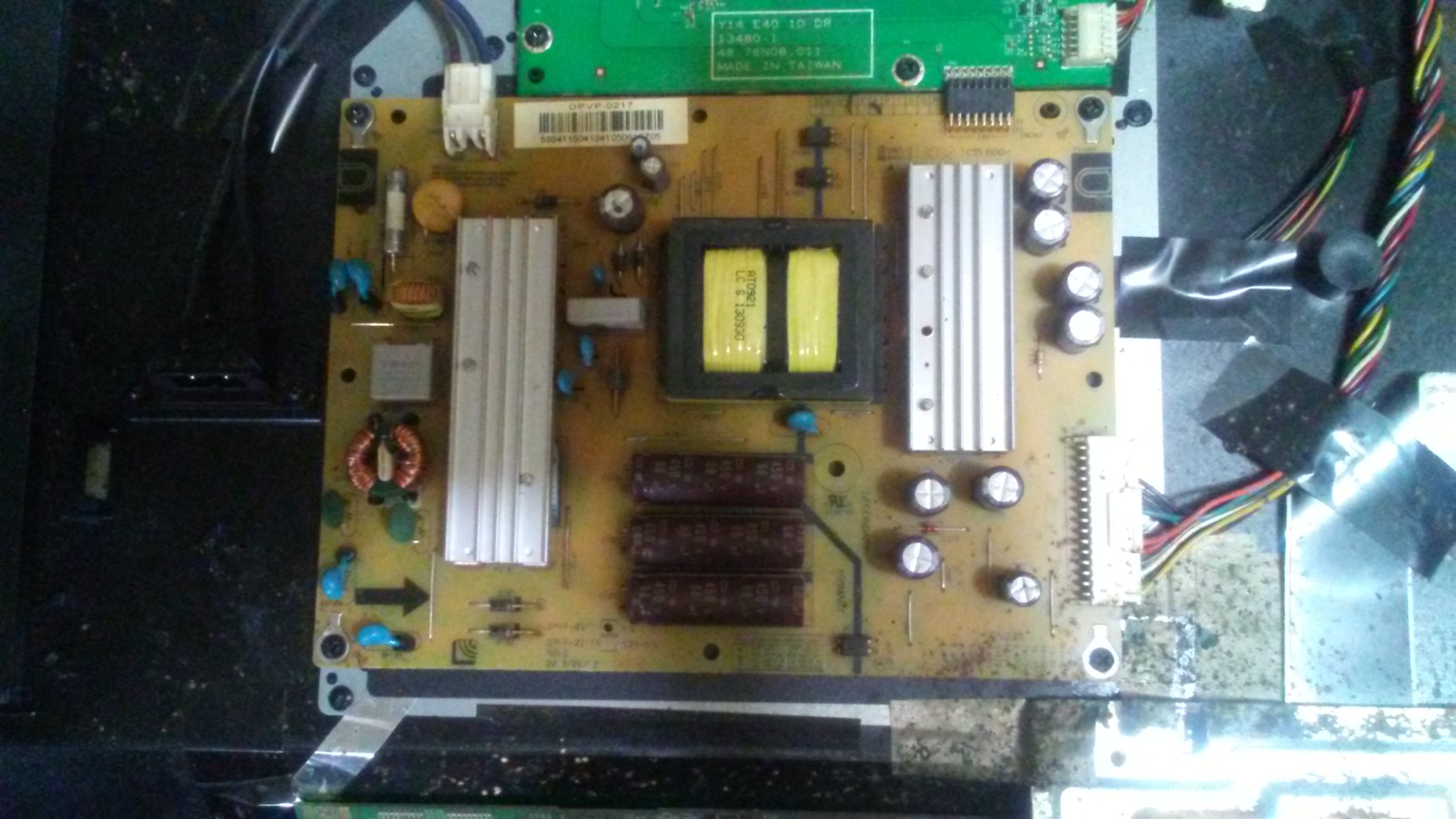

          The 24V on the PSU go to the LED driver board. That is the green board in post #1, second picture, on top of the PSU. That board drives the backlight LED's.
          There should be a connector with a bunch of red and black wires going to the LED strips. Each Red and Black wire power one string. For example: 4 red and black wires = 4 strings. You have to measure each string. It's a bit tricky, because you hafta power the TV on and measure the DC voltage of each string during the brief moment the backlights turn on. Post the result.
              Ok well, I'm just gonna assume that those set's of red/black wires, could instead equate to sets of "positive/negative" wires for my particular situation. Since this seems to be the wire array on my end, that you were referring to:
              IF I'm correct, would that mean there is 5 different LED strings? And as for testing those, could I latch the ground onto the frame, or would it need to be on one of the negative wires?

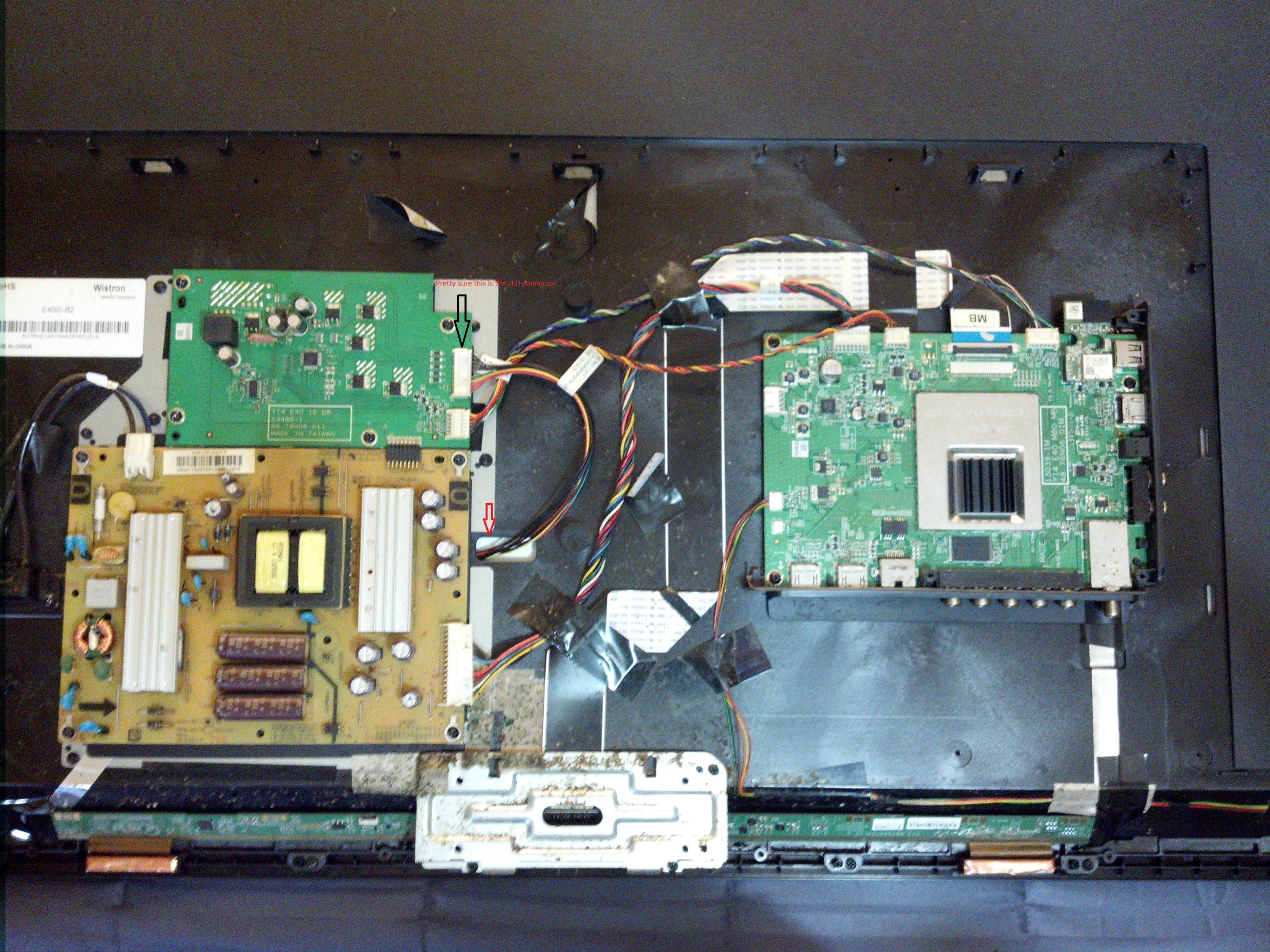

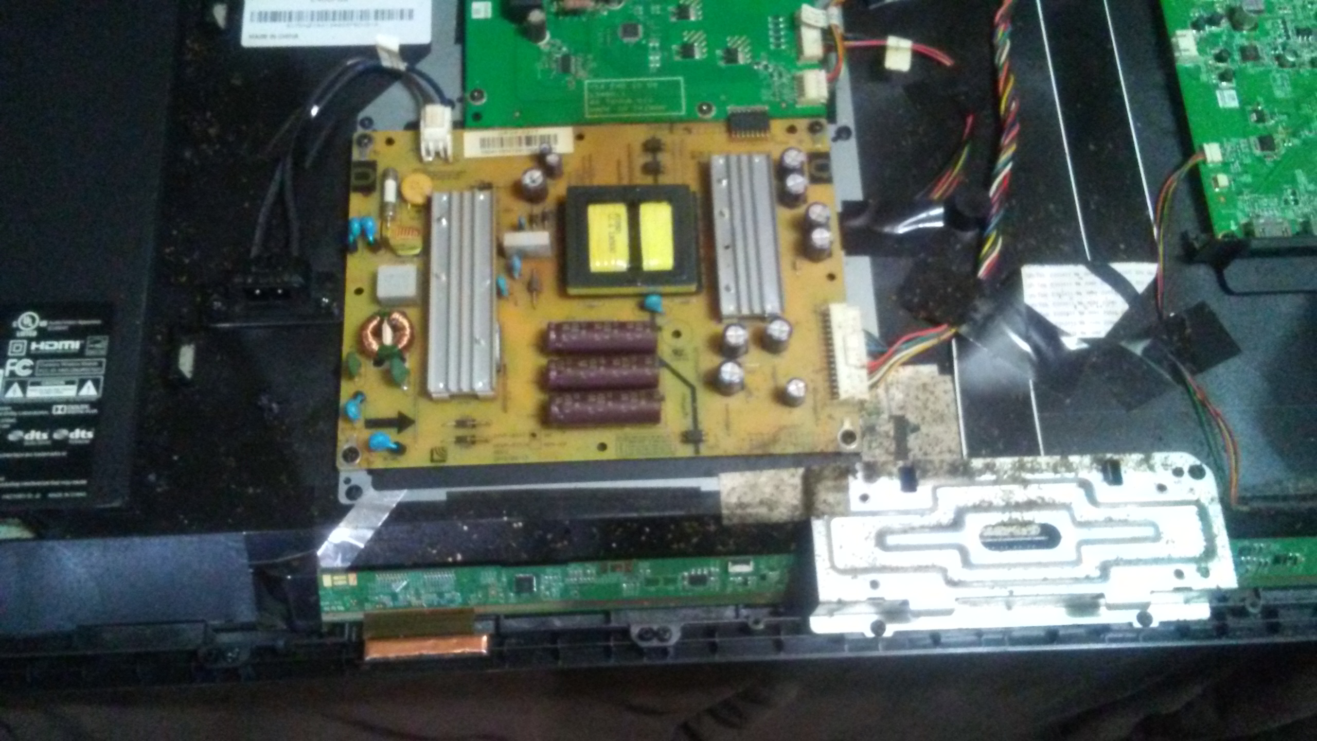

                Can we see the pictures of the whole back side of the TV so we can see how all the boards are connected together?

                    You most certainly can! It's not the best resolution, but for what you're asking I THINK it should suffice. Please let me know if not, and I'll do better.

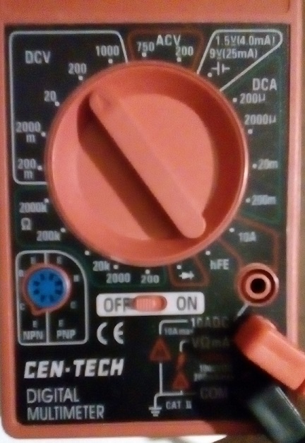

                          Ok, following your directions exactly, here are my results:
                          Moving from the outside black wire to the innermost-
                          #1: 8.20
                          #2: 8.27
                          #3: 8.40
                          #4: 8.39
                          #5: 8.18

                            8V DC? That can't be right. You have to measure these, while the backlight comes on for the 2 seconds before it turns off again. read post #5 again.
                            • TheCockroach
                              • Sep 2015
                              • 34
                              Re: Vizio E400I-B2 powering on problem
                              I did actually.
                              This was my process. I attached the black lead to the chassis, with a clamp (that even had rubber ends, not that that'd matter in this case), so that my hands could be free for holding the red lead and powering on TV at same time.
                              Then (with the wiring harnesses all attached) put the red lead on the back-side of the boards connector (aka, the metal post going from where each black wire connects to the motherboard. Then, with the red lead held there, I powered on the TV with my free hand. It would read just what I stated above, then go back down for a split second, and then back up to the same voltage. And I tested each twice, just to make sure.
                              Thoughts?
                              (I did exactly as he said in post #12, so if that's incorrect, please let me know)

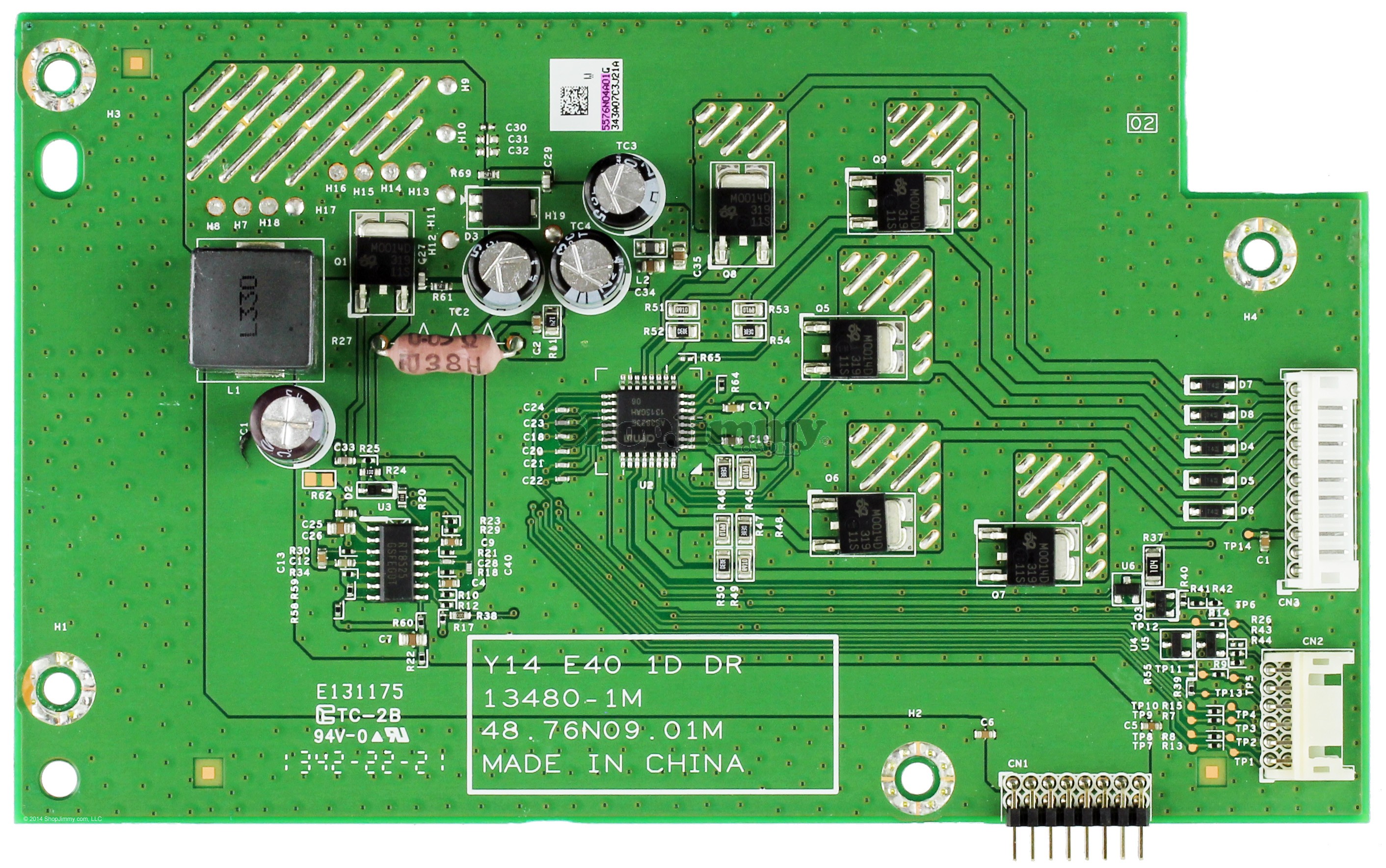

                                      What is the Voltage rating as printed on the cap TC2, or TC3, or TC 4?

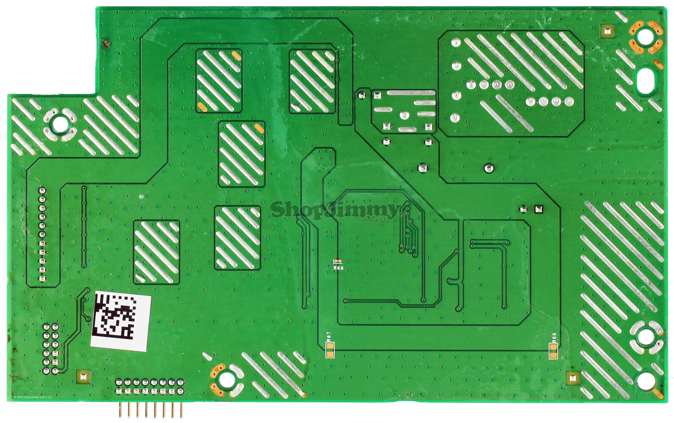

                                      Vizio 55.76N04.A01 (48.76N09.01M) LED Driver
                                      http://www.shopjimmy.com/vizio-55-76...ed-driver.htm#
                                      Pictures provided by shopjimmy.

                                        Hmmmm.. they're labeled as 50v 100uf caps, all 3 are.
