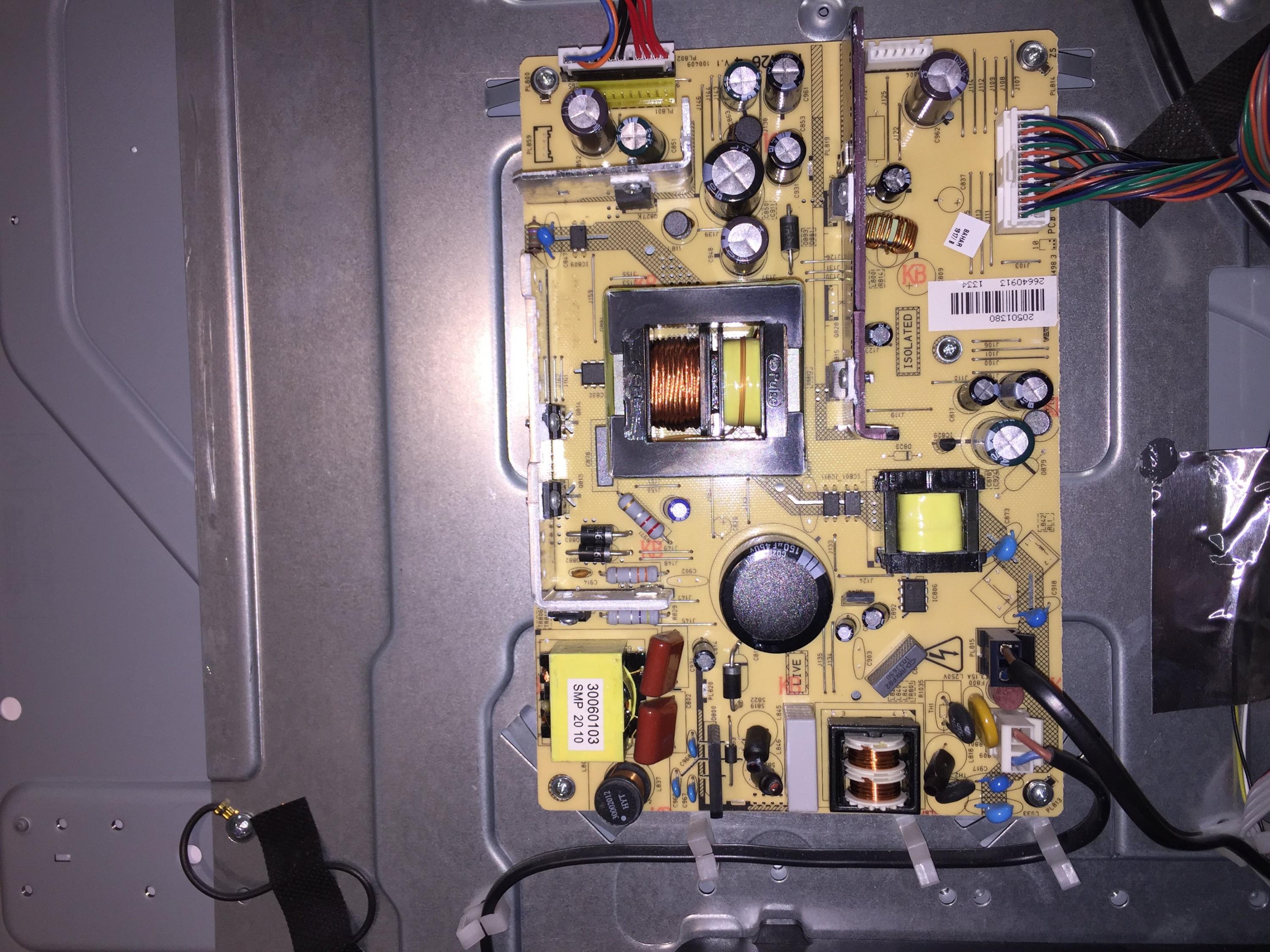

    Power Supply 17PW26-4 Seems to measure OK PL816:
    Pin 6 : ST_BY = 0V when powered on
    Pin 12: +12V OK
    Pin 14: +5V STBY OK
    Pin 15, 16: +3.3V OK
    Pin 18, 19, 20 : +3.3V when powered up
    Pin 11: +12V =OK
    Pin 13: 33V = components not fitted on PSU
    Pin 17, 19, 21 : +5V OK

    PSU board PL802:
    +24.33V to T-CON OK
    +3.33 BL ON to T-CON OK
    After pressing the On button, the front LED blinks about 12 times and then the backlight turns on. No picture or text on the screen but dim light blue glow.

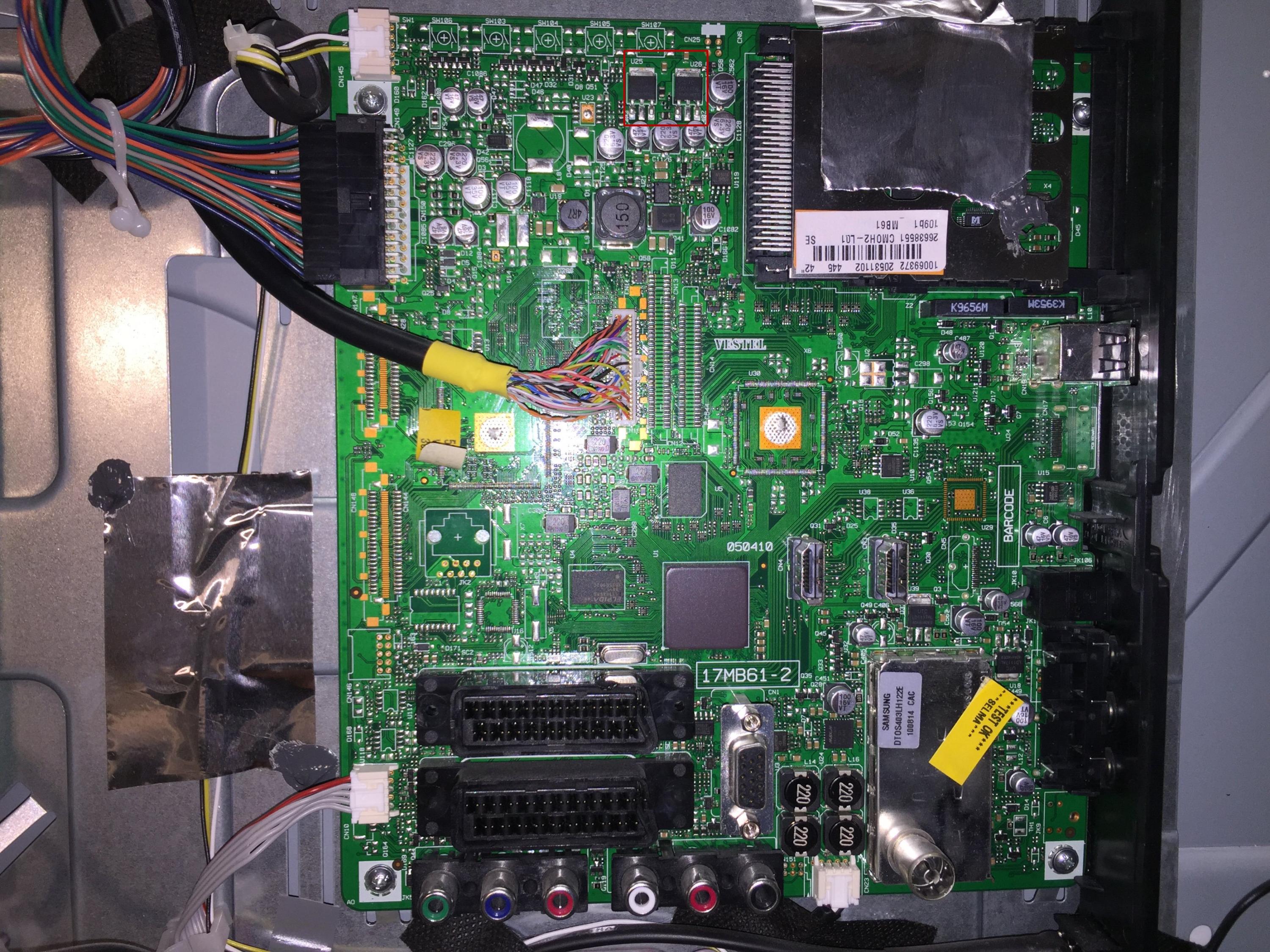

    Measured Voltages on U25 and U26 on the Main board as well:
    U25 : In 5.1V, Out 2.82V, Adj 1.57V (Strange output voltage?)
    U26 : In 5.1V, Out 3.4V, Adj 2.15V Looks OK
    It almost seems as if most is working and that there may be a bootup or firmware problem?

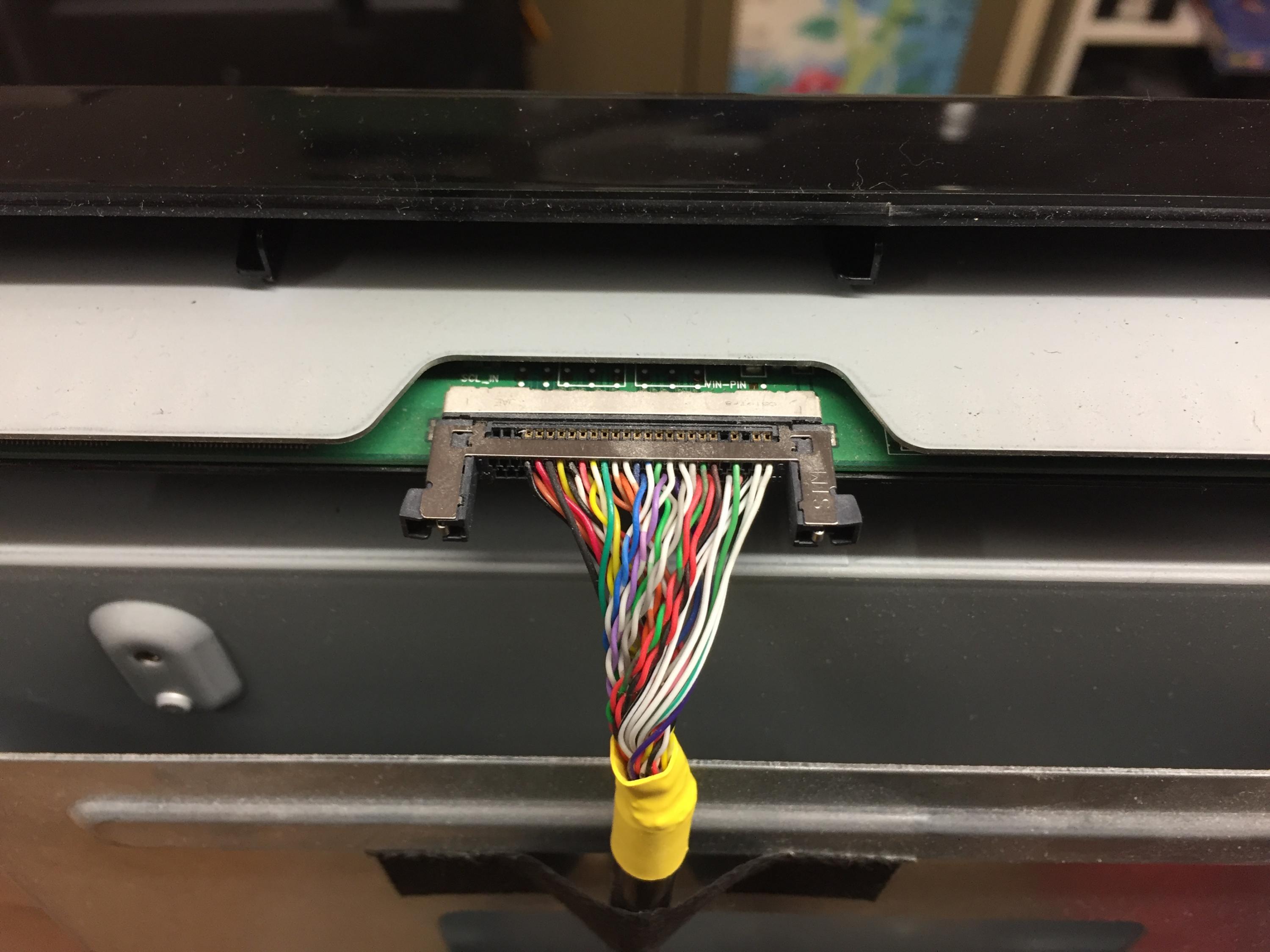

        Re: Vestel 17MB61-2 No picture

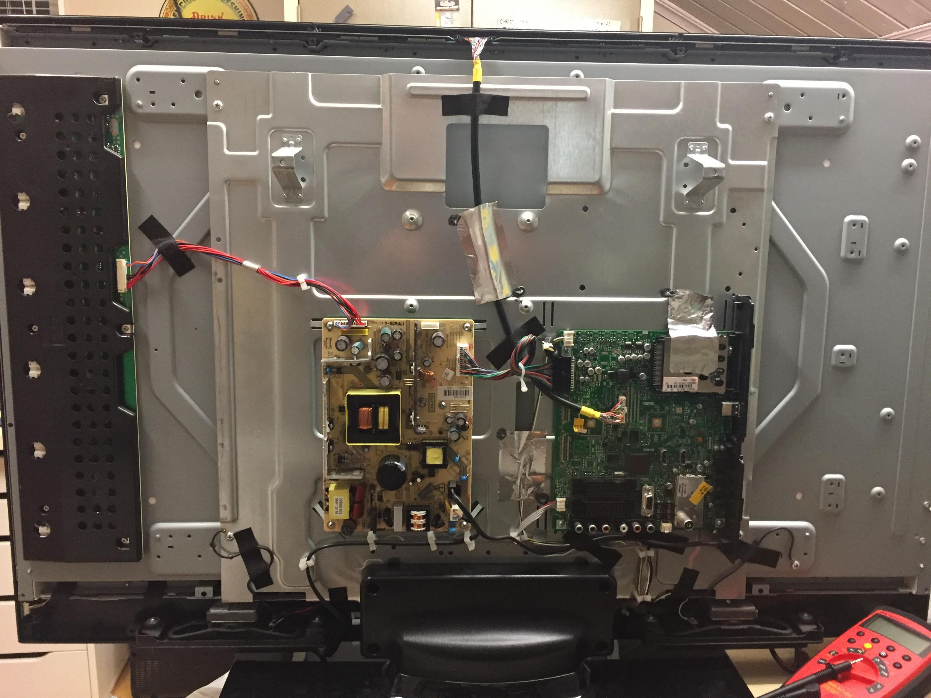

        can you upload a picture showing the whole of the back of the tv so we can see how the boards are connected as its sounds like you maybe testing the invertor board hence the 24v reading.
          +1
          Inverter boards normally at 24V. Tcon at 12V or less but often 12V.

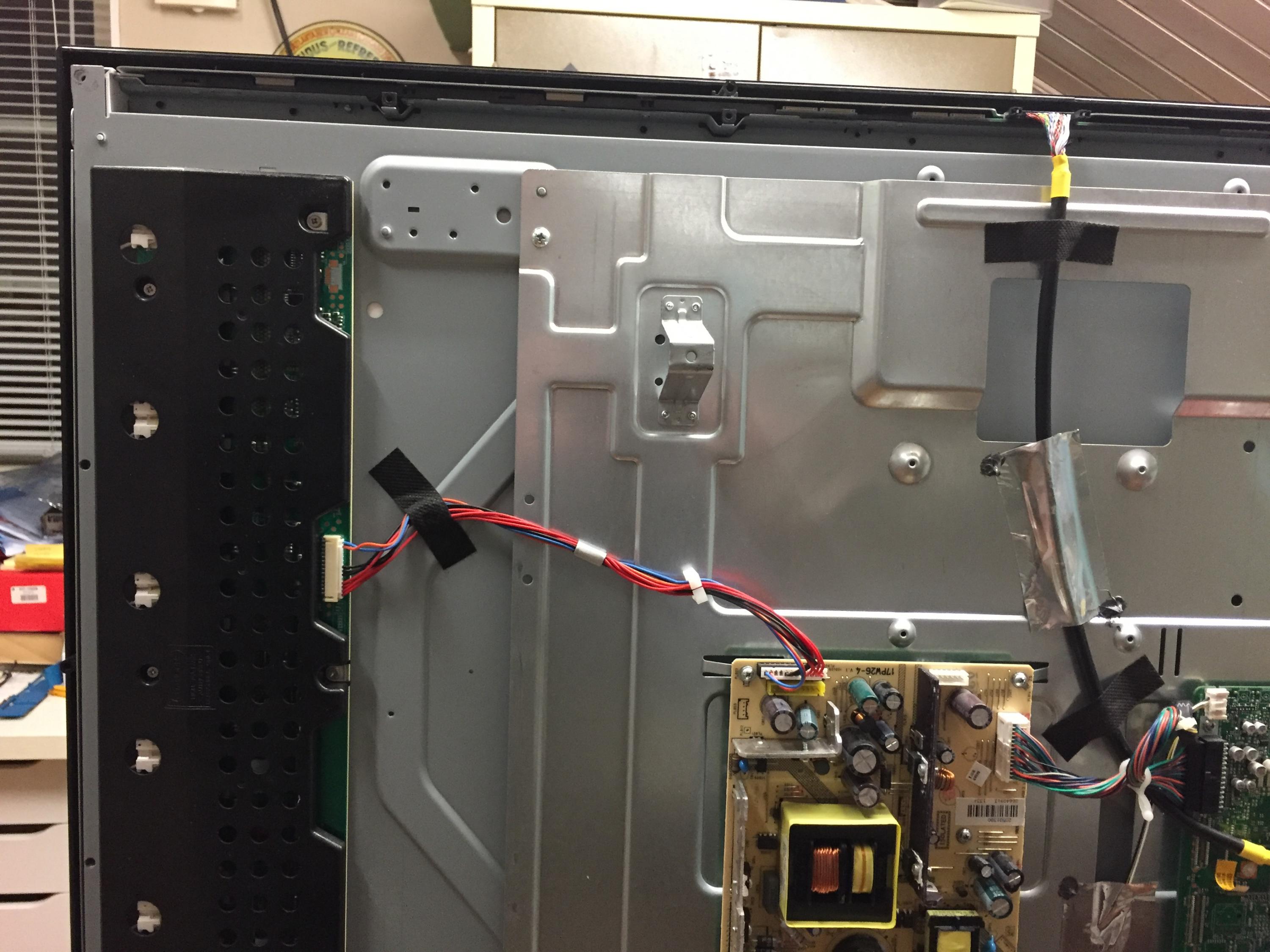

              Here comes the rear view pics... the +24.33V I measure is on the right hand 4 wires of PSU (maybe the same thing as the inverter board?) board PL802 which then goes to the board with the black cover on the left.
              Regards SA6BUQ Christo

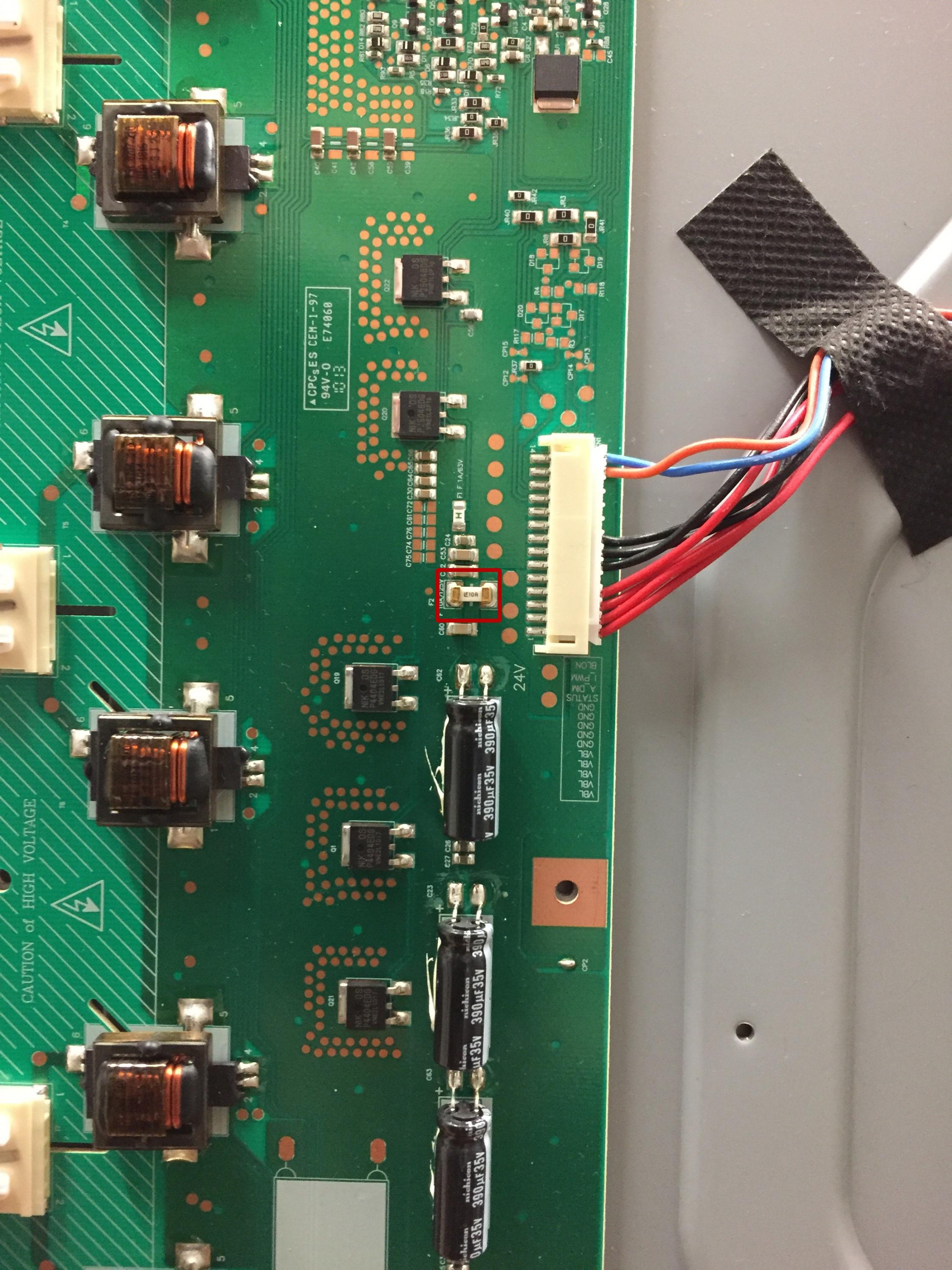

                ...I removed the cover and measure the 10A fuse...(marked in the red square) there is a label just below it showing 24V. Is this the inverter board or ?

                  Yes, that's your inverter board.
                  There are 2 fuses. F1 & F2. set off and use your meter set to ohms and measure across each in turn. They should both be short circuit (0 ohms).
                    looking at the pictures this set looks like the tcon is built onto the lcd panel pcb (bonded on the lcd?) post 7 picture 2 black lead from mainboard running to top center of tv im not sure how easy it is to get a picture of the area as on that board you will find another fuse to check.

                      Hej and thanks again, Dick I measured F1 and F2 and they both measure 0 ohms. When the set is on (with backlighting showing) i measure +24.33V on both. So they seem to be OK.
                          Mb does 75% of the timing processing for the Lcd hence more ic's on it, but board on Lcd just unpacks it all to the tab drivers.

                                The cable from the PSU runs to the backlight inverter board (not T-CON as written). There is no seperate T-CON (see post from vinceroger).
