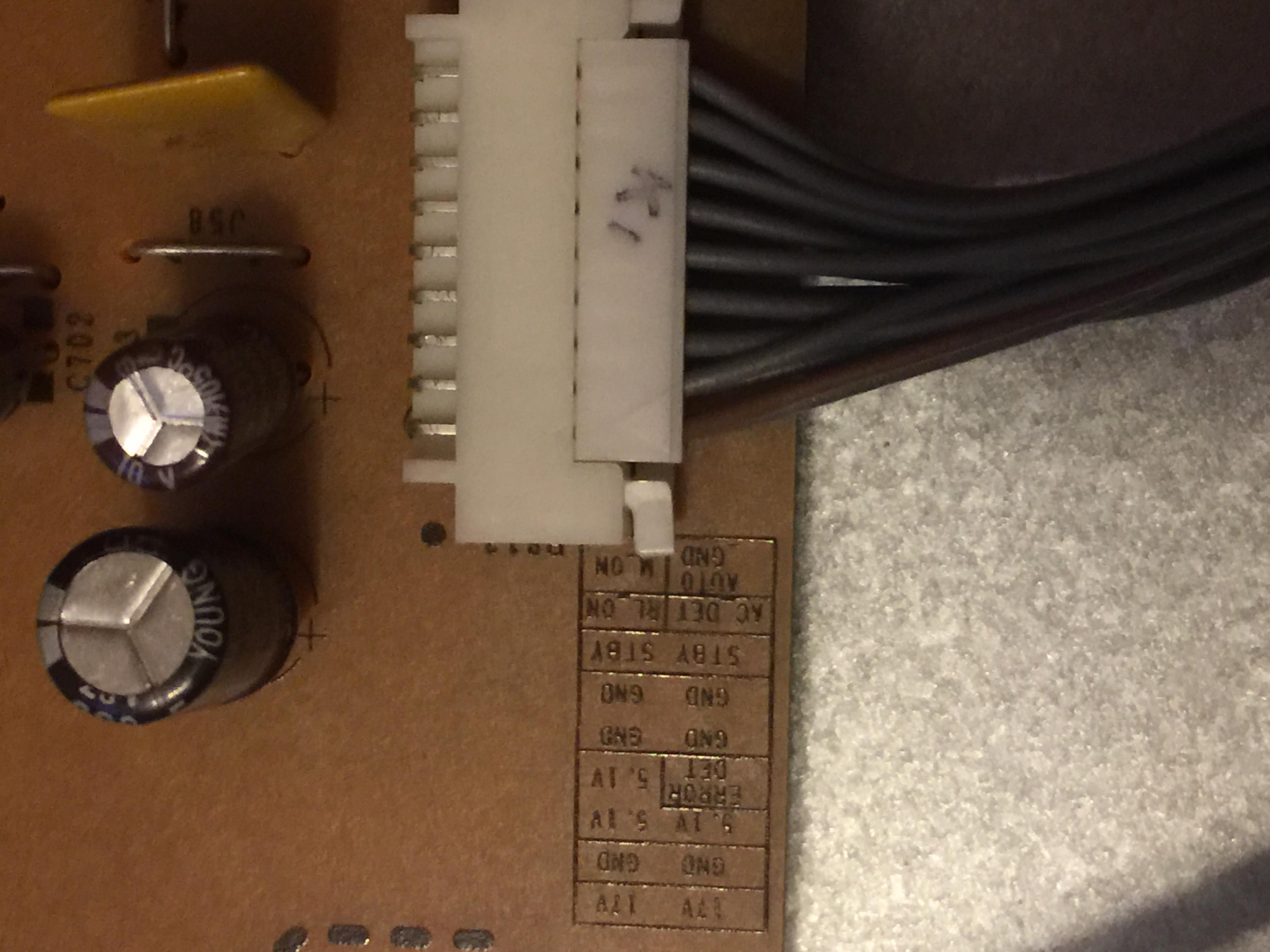

    there are 3 fuses on the power supply one to the right of the ic and diode you have replaced do all these fuses still test good?

      I just tested the 3 fuses again and they all Ohm out fine.

            ive just looked at a few photos the new diode you fitted by the ic some of the solder looks bad not flowed onto pcb? maybe re do the soldering and hopefully when that capacitor comes it will fix the issue but if it dosnt maybe re check all the power supply voltages and tell us what they all read as we may have to start back from basic voltage tests etc.

              Received the new capacitor (http://www.digikey.com/product-detai...583-ND/1647864) and installed. Still get nothing. No little board with the green light, nor clicking as it did previously.
              I tested the pins at the location in the pic and all got 0.

                so not even standby voltage? start from the begining and check you have ac voltage going into the board

                  I'm assuming that the AC voltage coming from where the plug in is, via the brown and blue wires to the red connector on the board, is what I'm to be testing?

                    yes test what ac voltage you have at that point

                      OK, I tested and one way I have 0.00 and when I switch the leads on the connector I get a varying .3 to .5

                        sorry i meant test the ac voltage with the tv plugged in just to make sure you have ac power to the board i think your voltage is 120v ac in your country.

                          That is with it plugged in to an outlet.

                            if thats the case the fuse in your power lead has blown

                              Is that under that silver box that is immediately below the black power cord plug in...where the brown/blue wires are coming out?

                                your in a diffrent country too me but where you plug the cord from the tv in to the wall socket is there a fuse in the plug part?

                                  There isn't a fuse in the cable at all. Where I plug the cable into the port on the TV it's contained in that silver box that is held by one screw (one seems to be missing) and I removed the screw and the underside of the box has a sticker that says Noise Filter on it.

                                    im not sure as usa is different to the uk so dont want to give you wrong advice but it seems to me you havnt got mains ac voltage to those wires on the pcb did you check across the brown and blue wires in ac mode? if so theres a break somewhere between your wall socket and that connector on the tv hopefully budm will see this thread and advise us more.

                                      Check the resistance between the LINE (HOT) prong of the AC male plug and the red connector with Brown wire, see what you get, then check the resistance between the Neutral prong of the AC plug and the red connector with the blue wire to see what you get.
                                      That female end of the power cord does not look like it is inserted all the way in.

                                        I plugged the tv in to the outlet and checked the voltage of the brown and blue wire via the pin slot in the red connector at the end of those wires.
                                        The silver box with Noise Filter printed on it does not look like it easily comes apart to check for any disconnected wires/etc. But if need be I can try to get in there.
