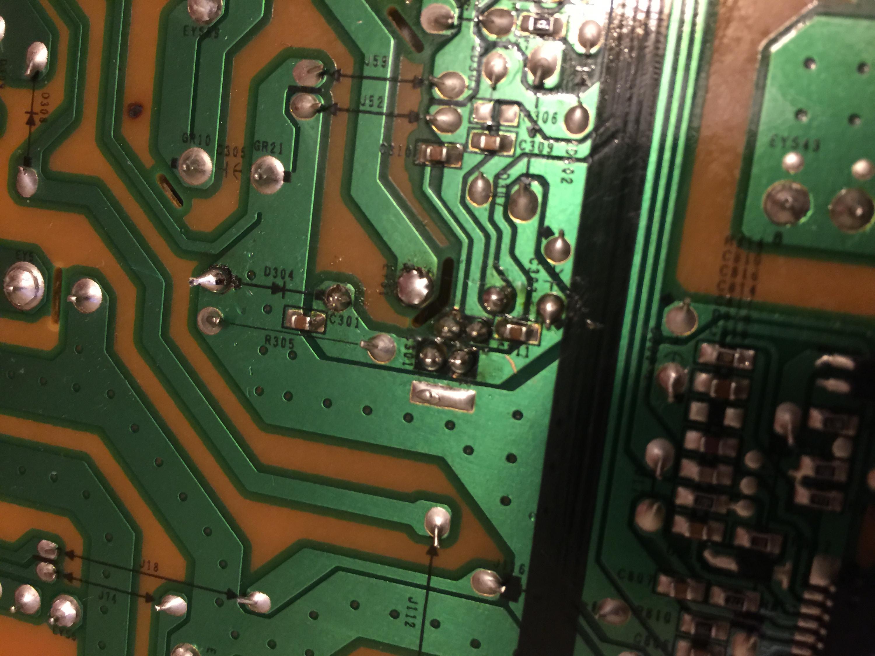

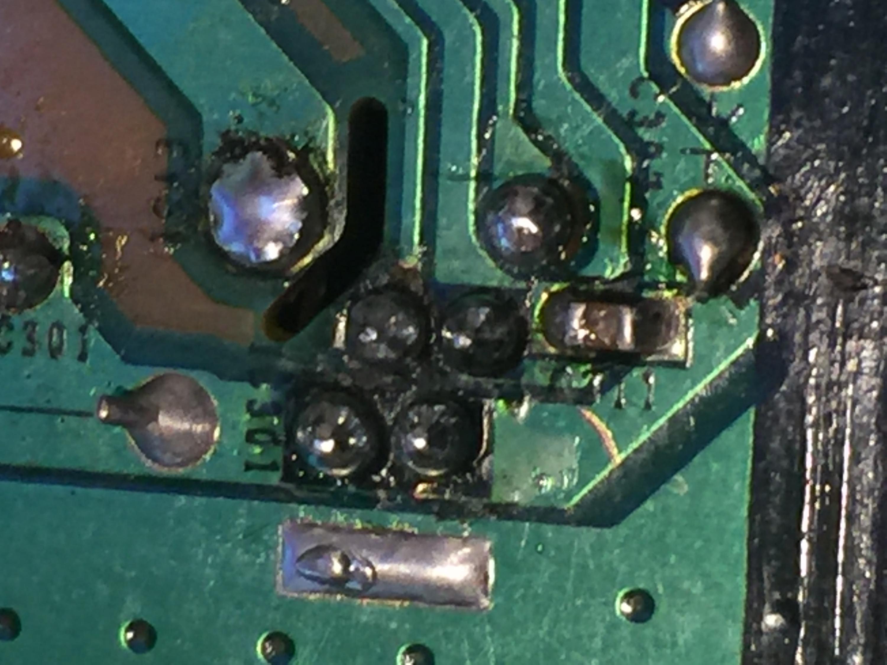

                  If you can post a picture of the soldered side of IC301 perhaps someone can spot any error.
                      Here is the soldered side of IC301. Thank you!

                                    Is that a slither of solder across those two pins or just the reflection?
                                    • jason424
                                      • Dec 2015
                                      • 187
                                      #38
                                      Re: LG 50PK550 clicking - plasma newbie
                                      I think just a reflection in that pic.
