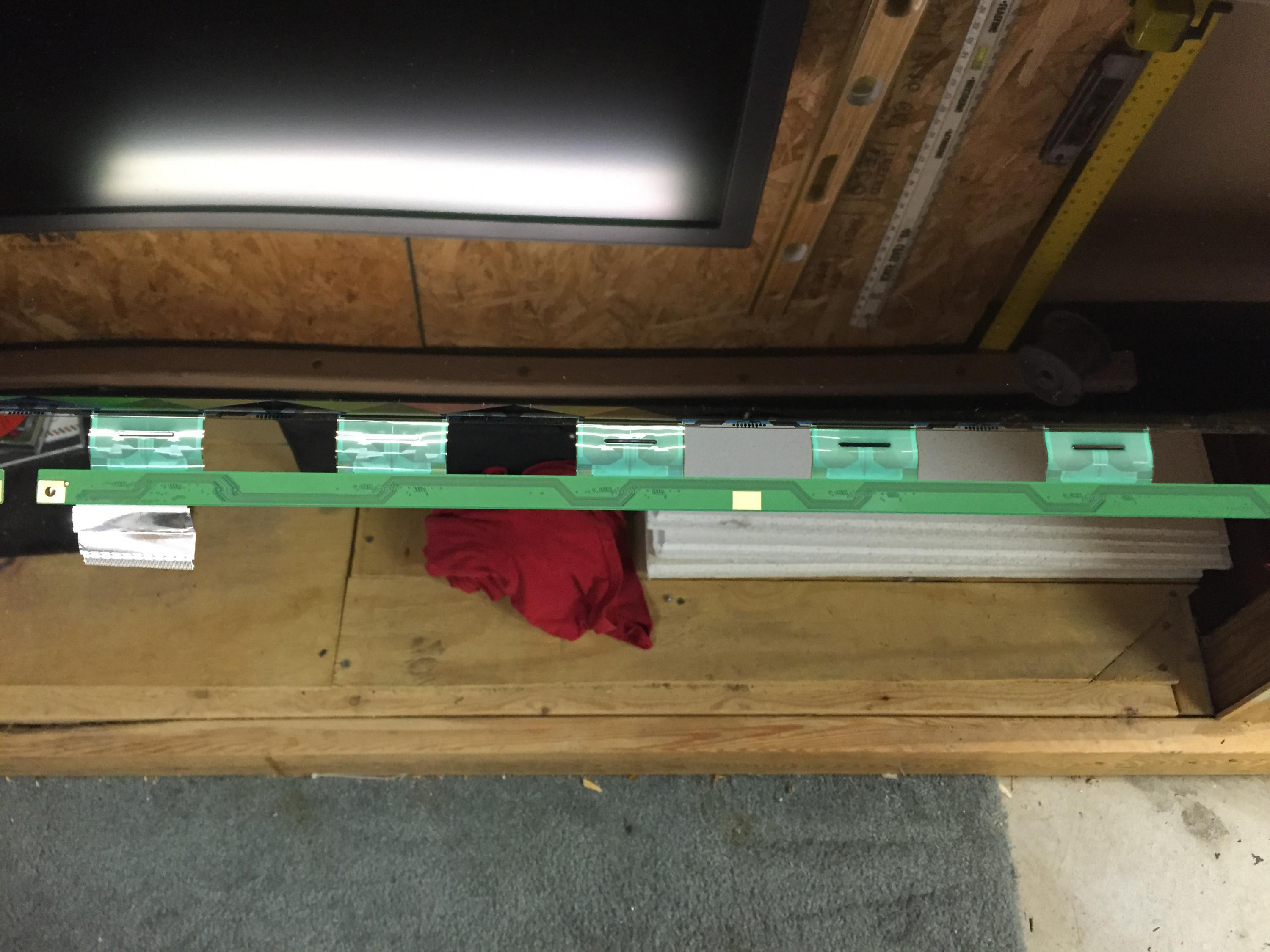

      Ok thanks. I know how to get to the top boards, I will have a look on YouTube at repair videos because there is a guy "norcal" and believe and I think I have seen him talk about replacing one of them.
      • Geniee33
        • Jun 2015
        • 45
        Re: Samsung LA46S81BDX/XSA - Lines after 5 mins, restart... fine for another 5 mins
        https://youtu.be/purk_SyiT44
        Hmmm guess not repearable
        I'm wondering if it could be the small section of ribbon from The t-con to the top circuit board.
        I will try switching the left and right cables to see if the problem follows the cables
              Yep, although i might spend some time online today looking if i can find the small ribbon cables that go from the IC driver boards to the t-con... because even if i lift the black tab on the t-con on the left ribbon, that side goes white and the other side picture returns...
              so i think its got somthing to do with the connection between that cable and the tcon.
              and because i had tried 2x t-cons in that TV, im my mind, its unlikely to be a faulty t-con connector... more the ribbon / pressure. but i agree, if i spray that cable with freeze spray while its faulting, and if it returns to working, i will be sure of that.
              Is it safe to spray while the tv is operational? because like i said earlier, if i turn the tv off and back on again, its generally working for a few minutes....
              Is the spray actually liquid? or just very cold air ?

                        At this point, i am thinking the issue is now down to
                        - LCD Panel bonds (the TFT driver chip)
                        or
                        - The flex cable that joins between the TFT Driver circuit board and the T-con board.
                        Last night, i got home turned tv on.... and of course when i want it to be faulty, it behaves itself.
                        I am wanting it to become faulty, then use the freeze spray just on the ribbon where it connects to the tcon to see the results.
