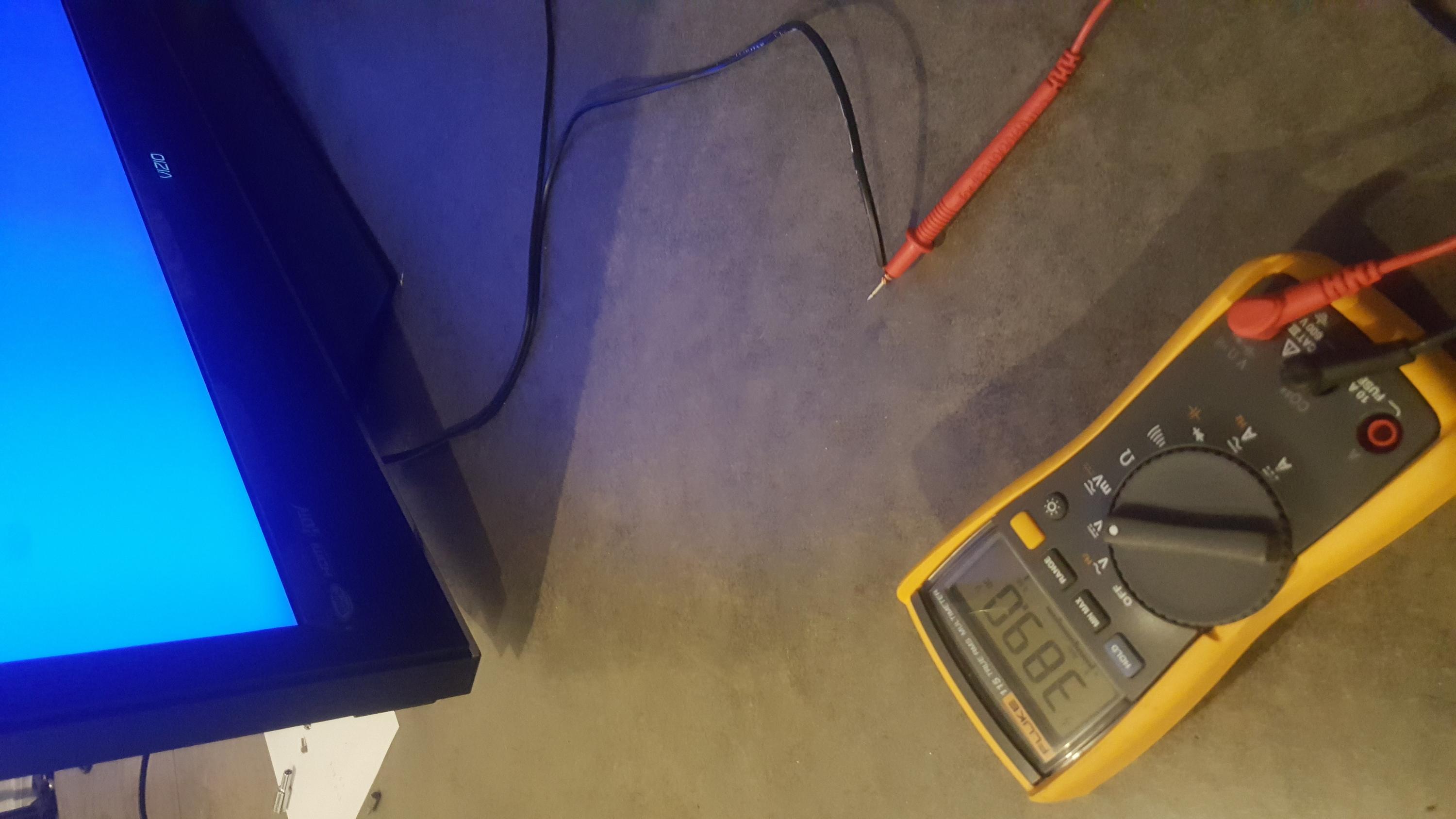

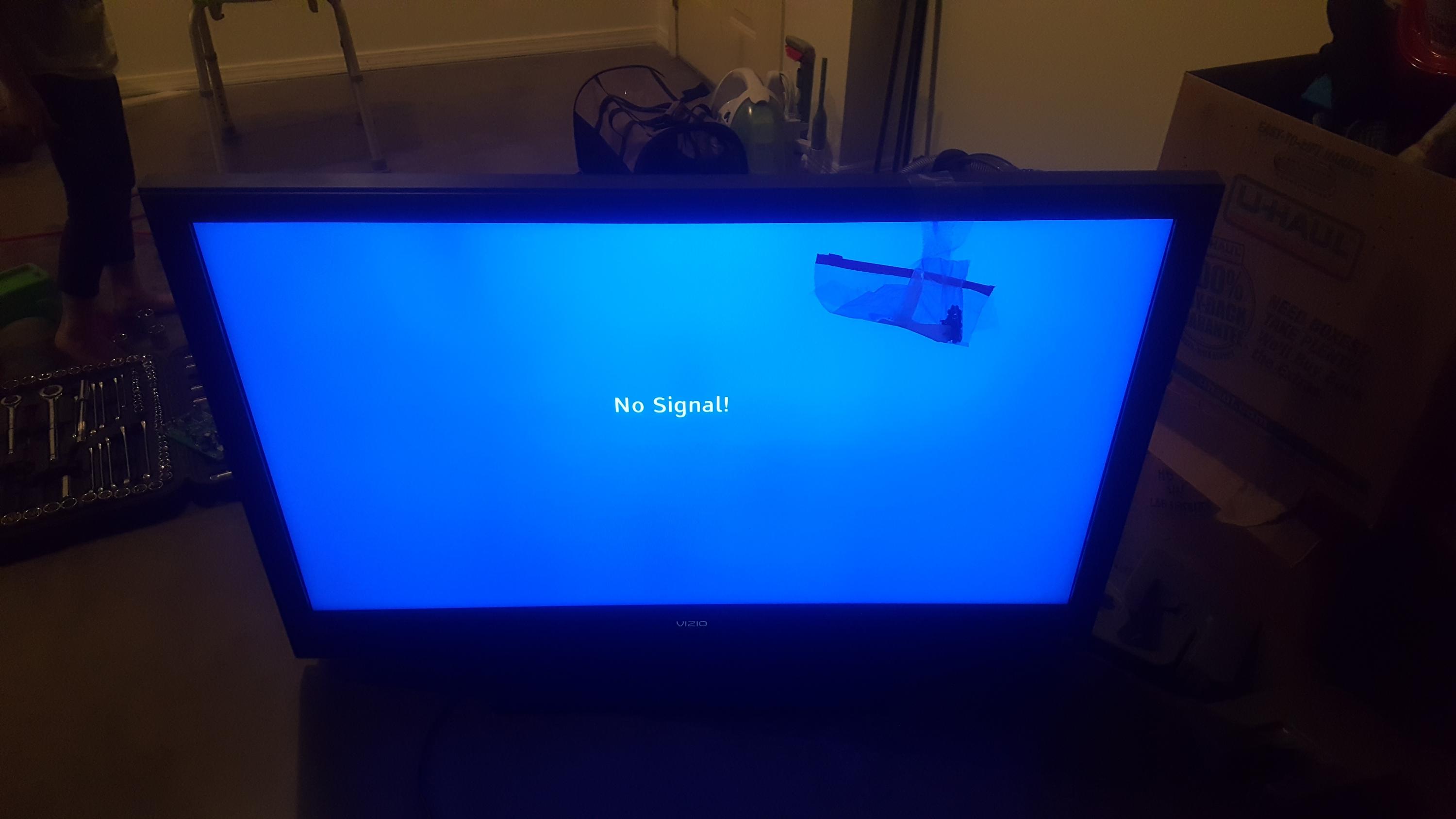

                  Hoooooly smokes look at that. Fixed. Not sure if it was the EEPROM though. Swapped out the main board with another one and bam! It works. Will upload the picture of the back of the main board on one IC. It looks damaged from the old board.

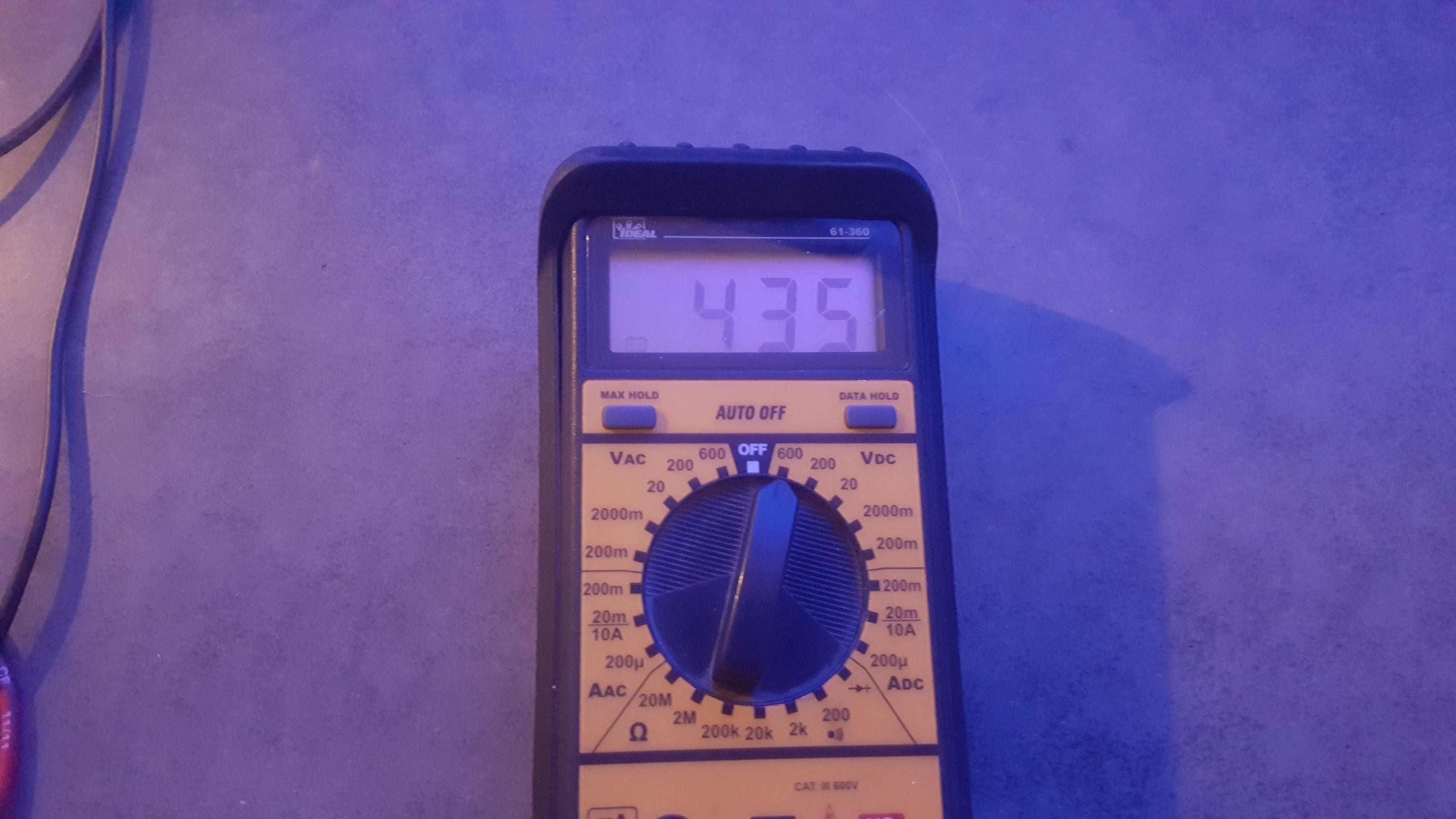

                  Sidenote: The main filter cap reaches 435vdc when the TV is on. I'm not sure if that's good or bad since the cap is rated at 390vdc. Any thoughts?

                    That is not good if your meter is showing that much Voltage, do not run it like that, the feedback in the PFC circuit may be bad.

                          BUDM, nvm. I just used my other multimeter to validate the 430 reading and it was flawed. We are sitting at a nice 389vdc now .
                            #53
                            Re: Vizio VO47L-FHDTV10A turns on and then off (3 seconds)
                            Good, the battery is probably low in the bad meter.

                              LOL. BUDM you are 100% correct. The battery is in fact low in the other meter.
