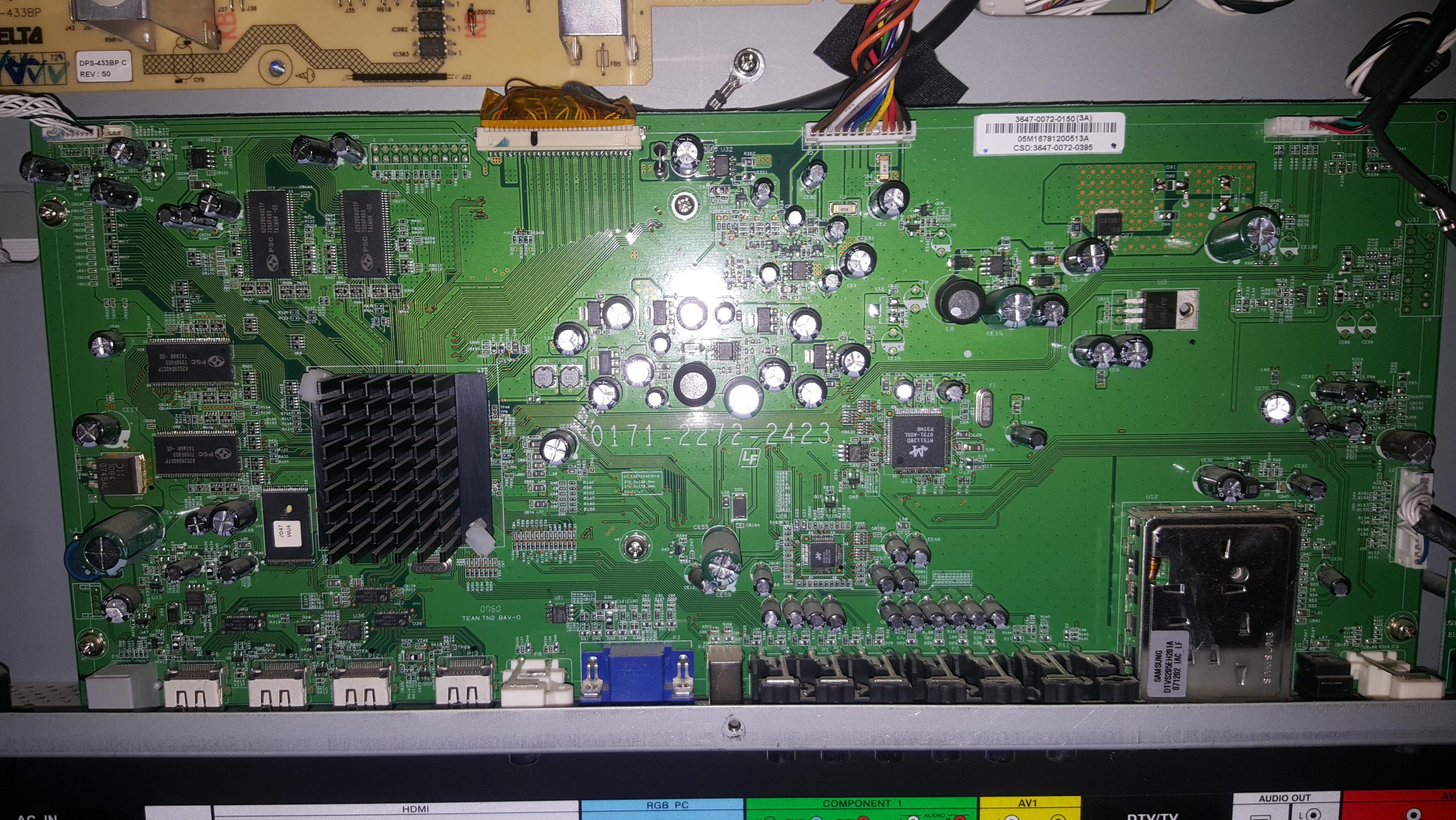

          So both fuses on the main boards are good?
          We need dcv reading of each pin of the connector of the power supply board that goes to the main board when TV is plugged into outlet but not turned on, and when the power switch is activated.
          You MUST pin down the pin name and follow by the dcv reading of each pin so we can see what are missing.

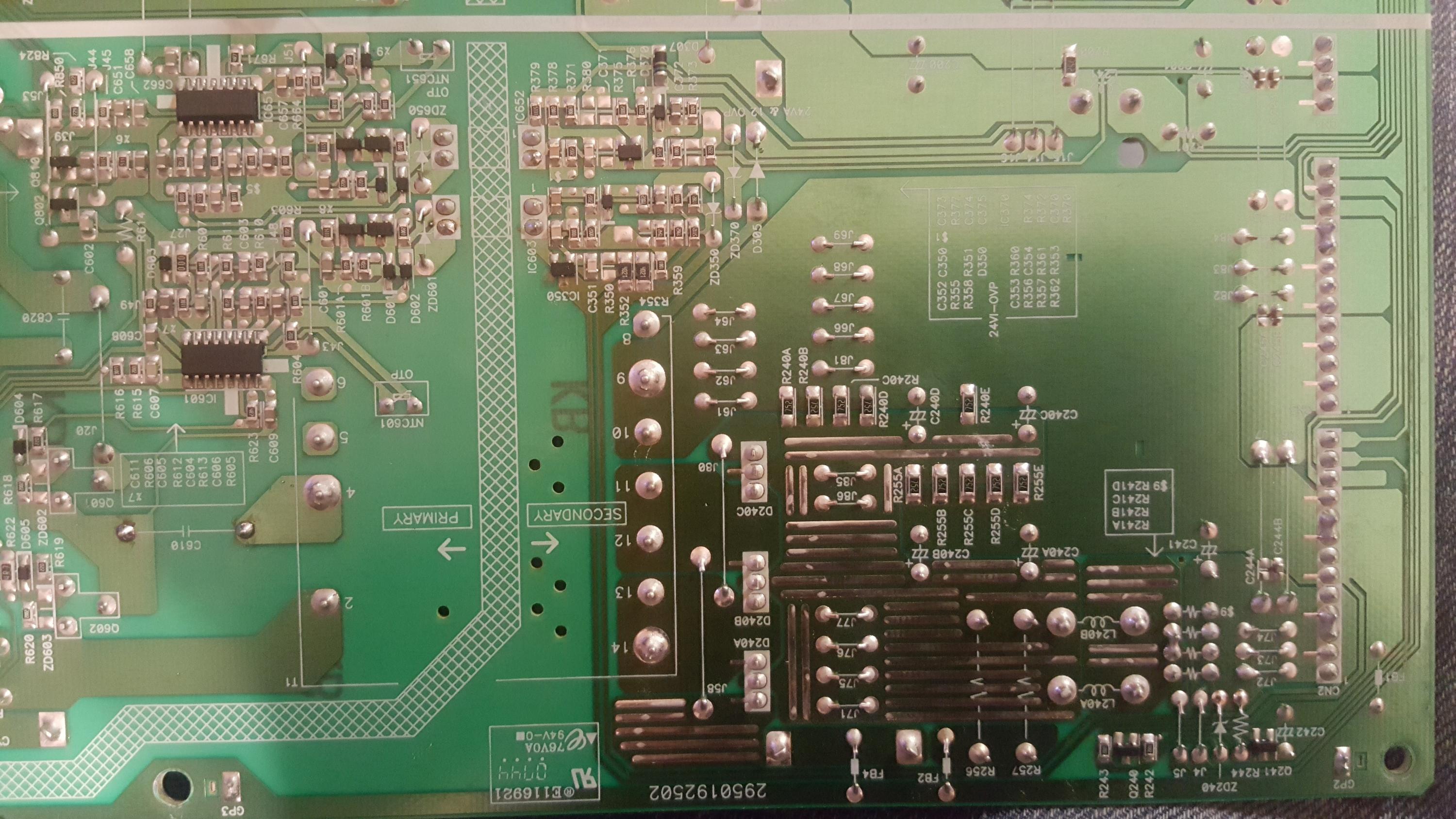

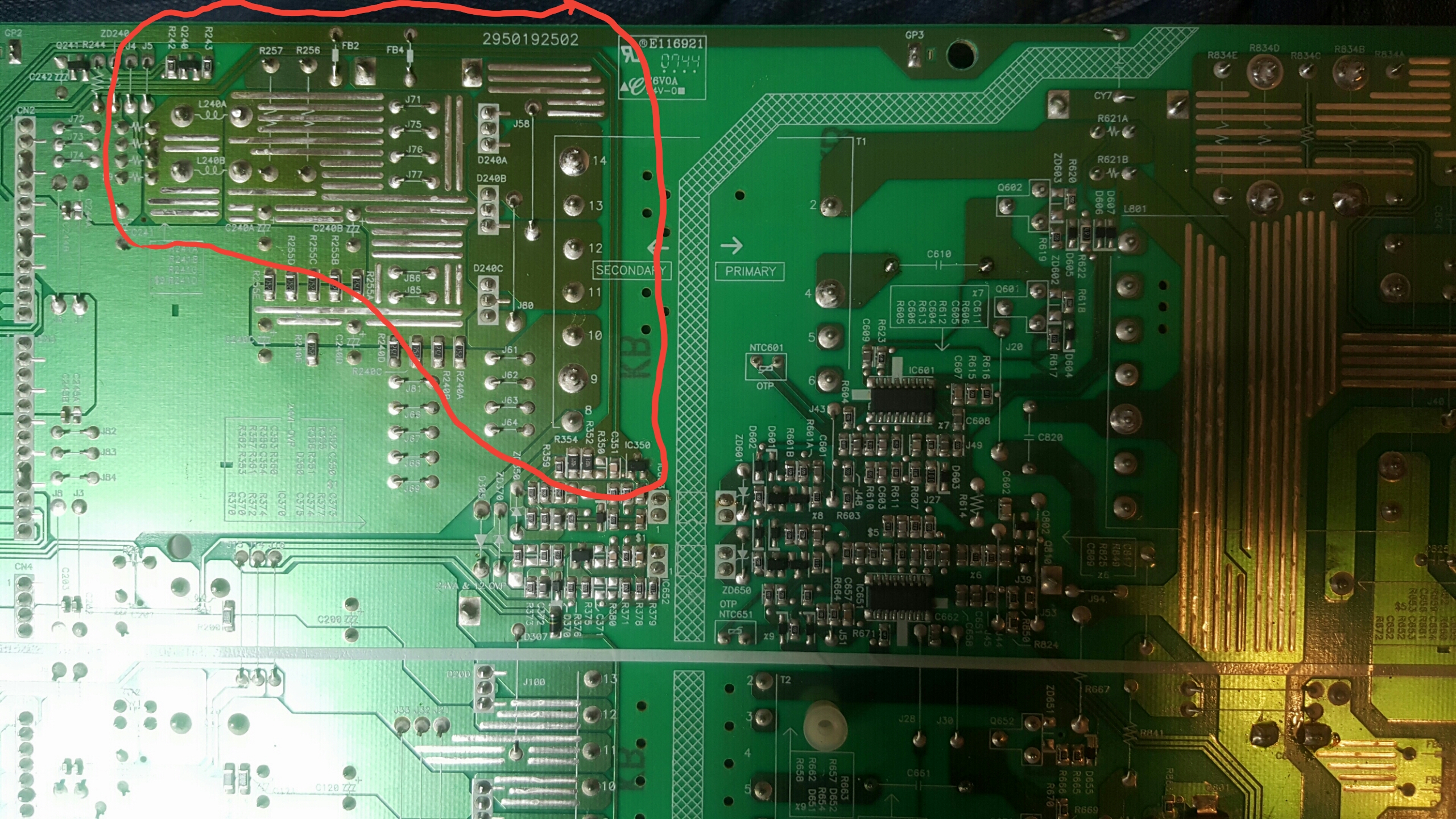

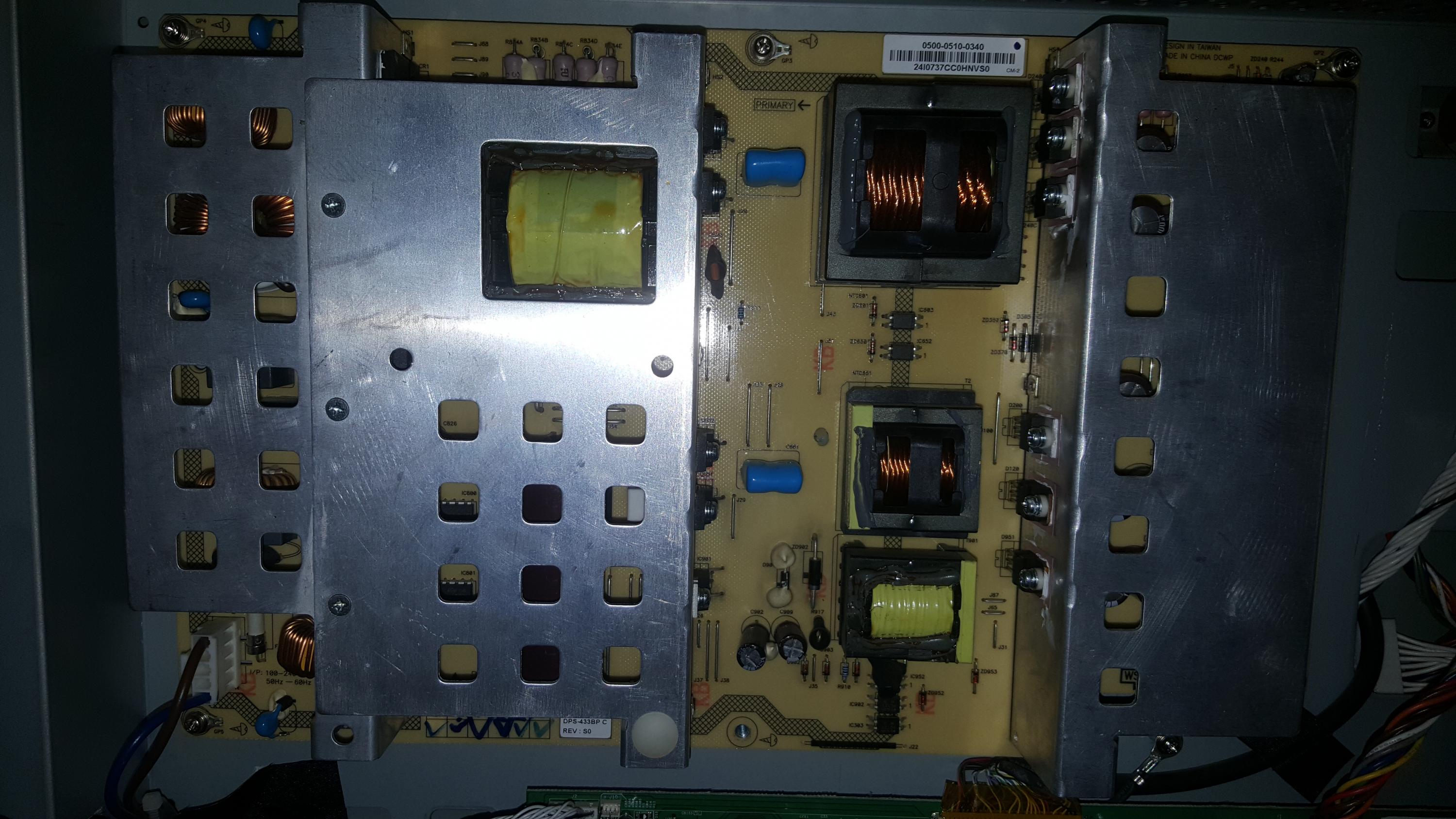

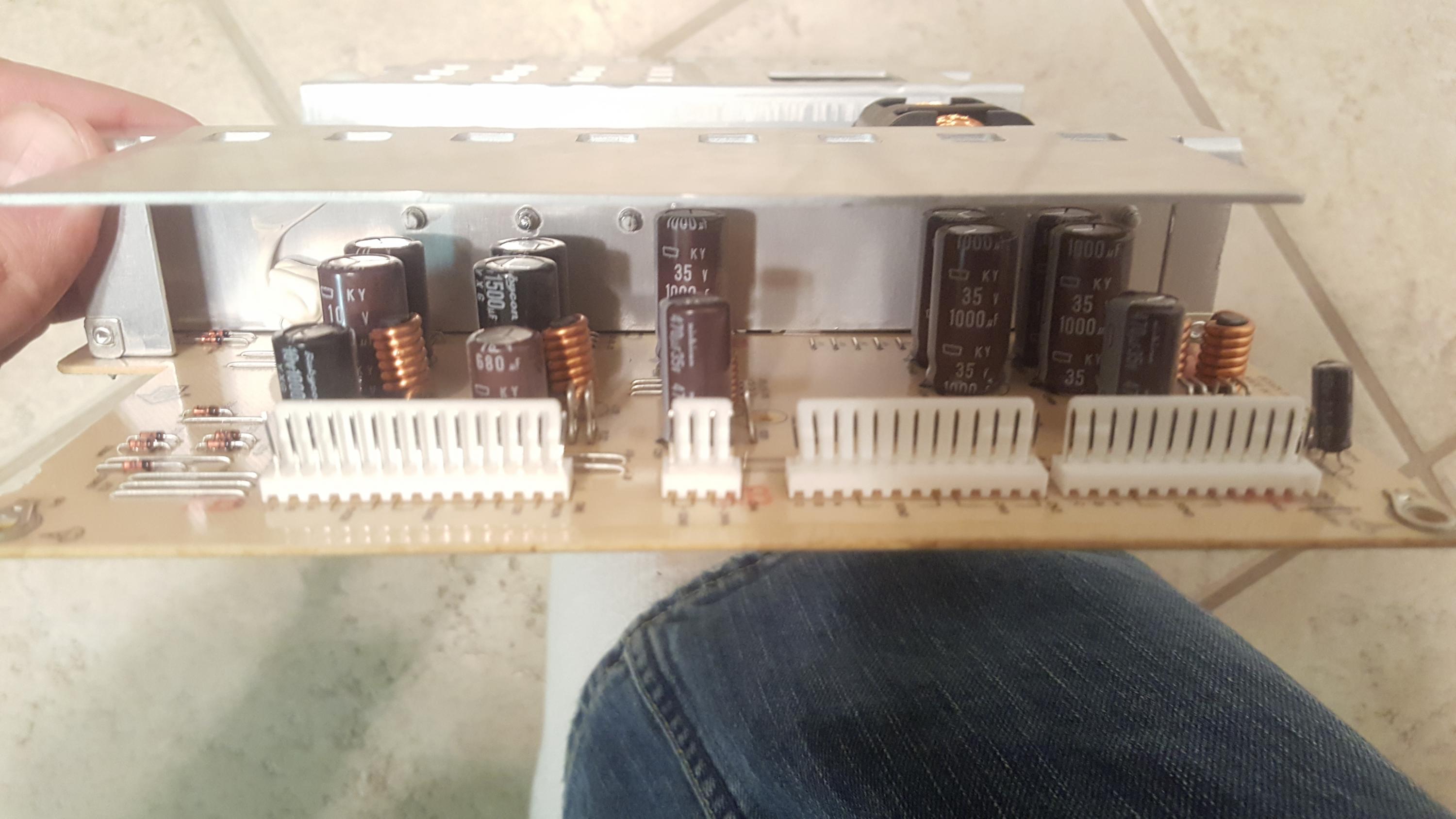

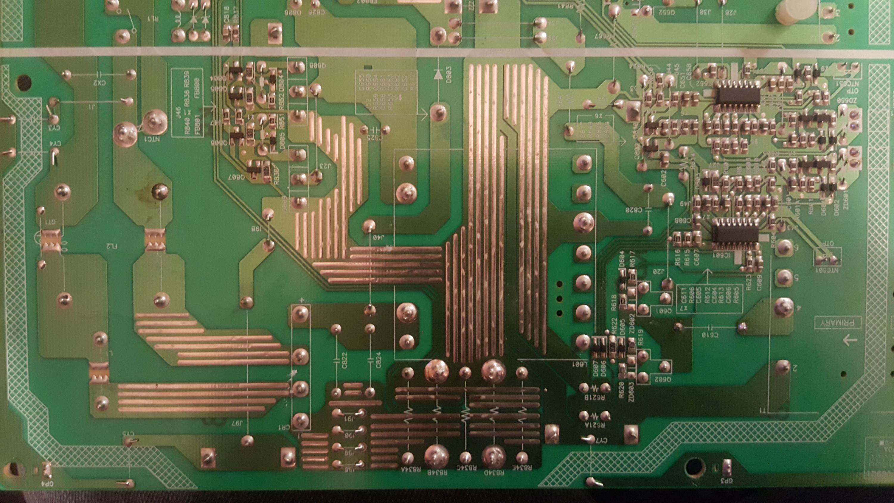

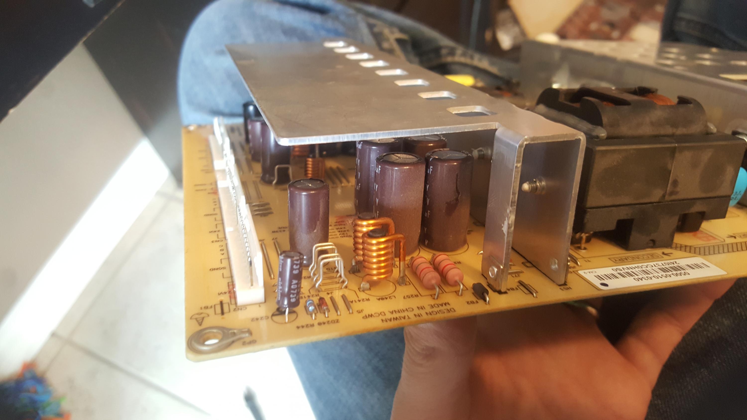

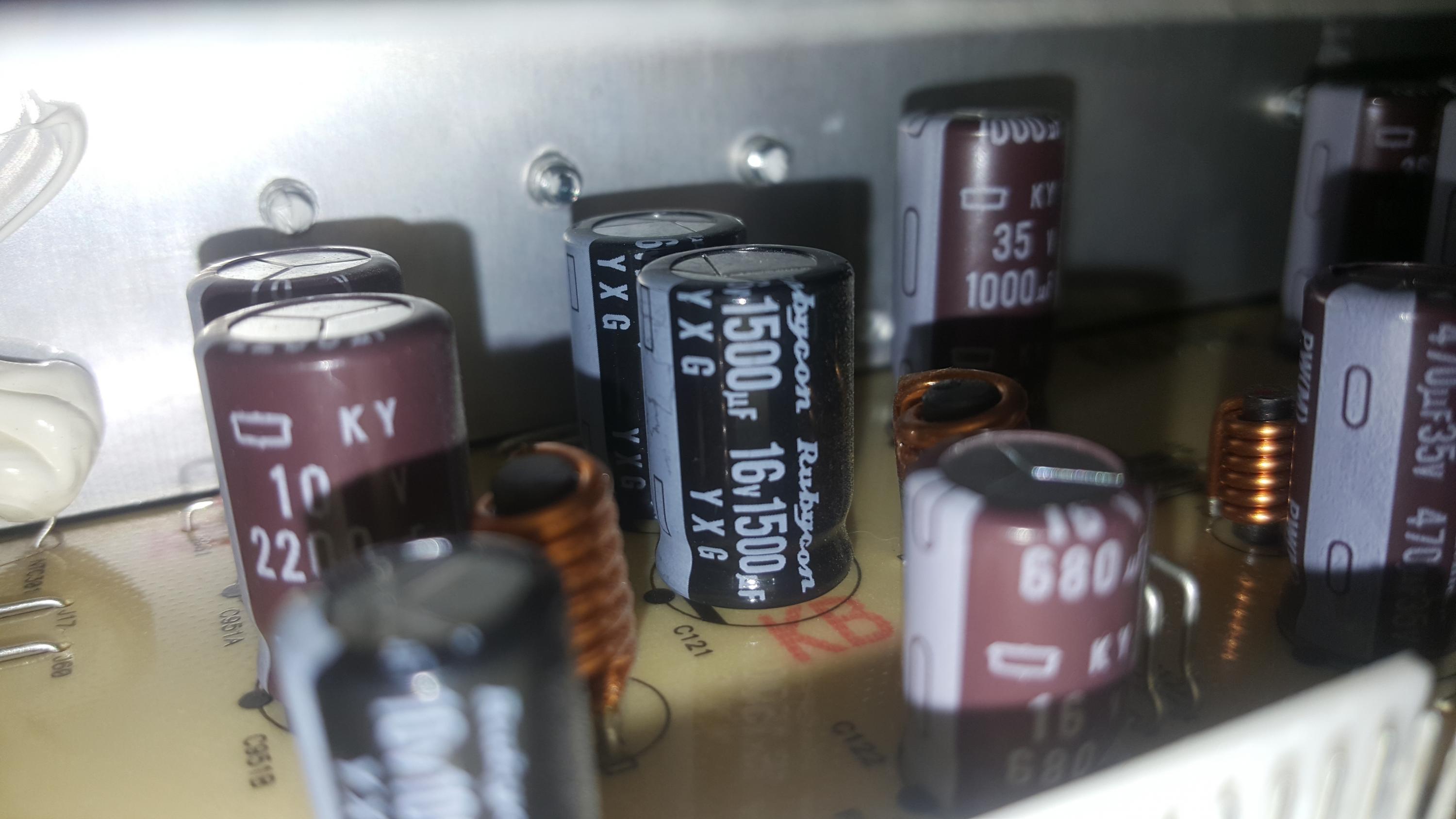

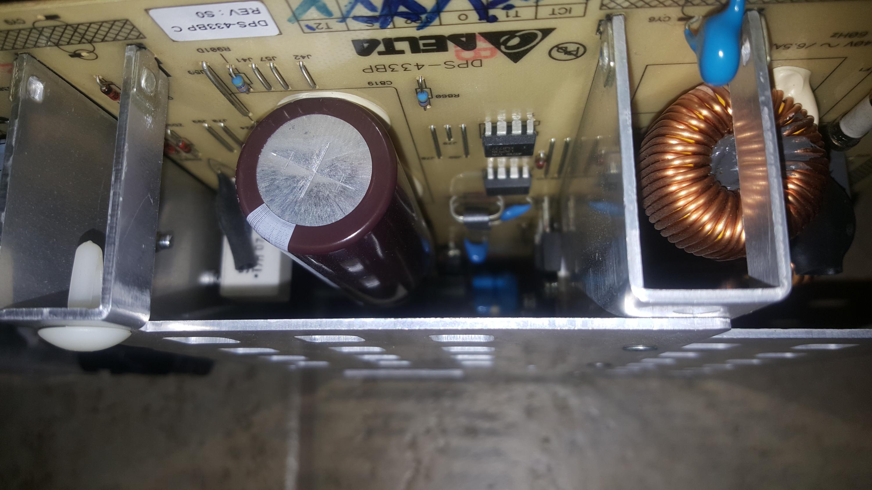

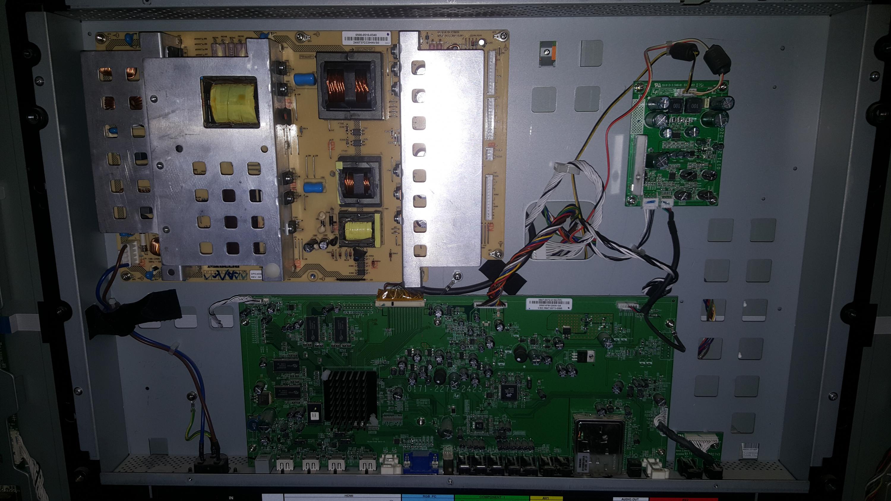

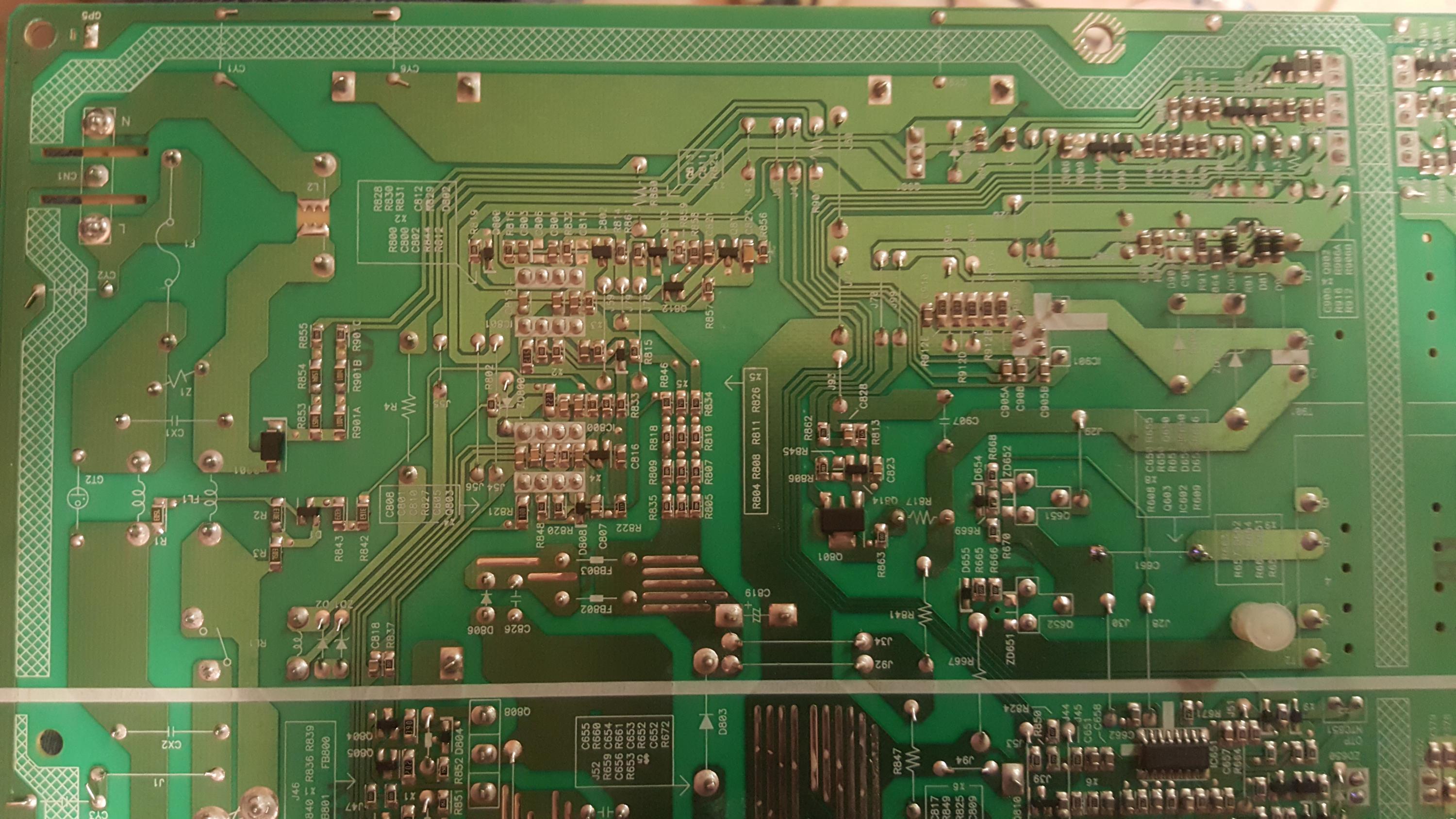

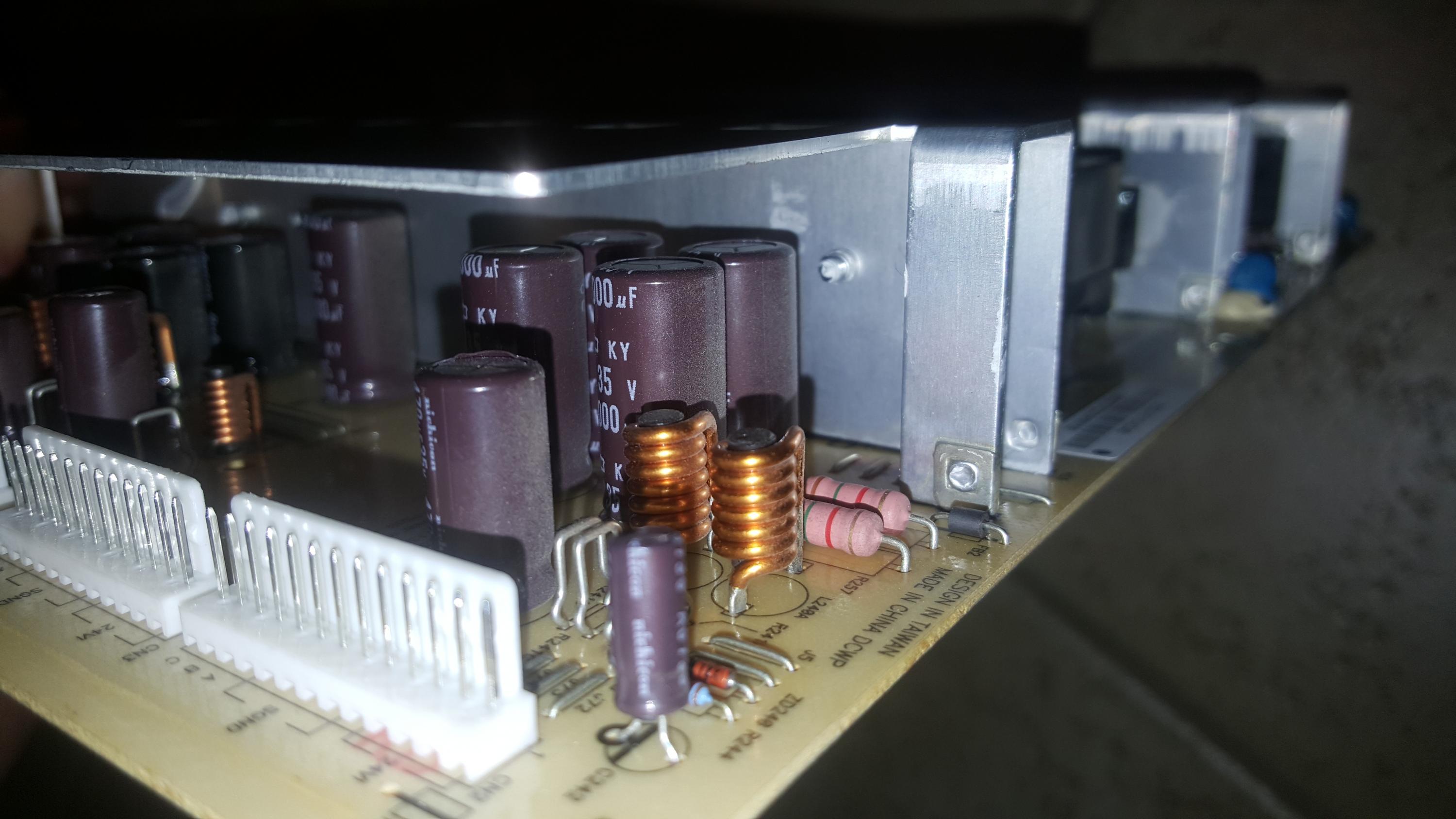

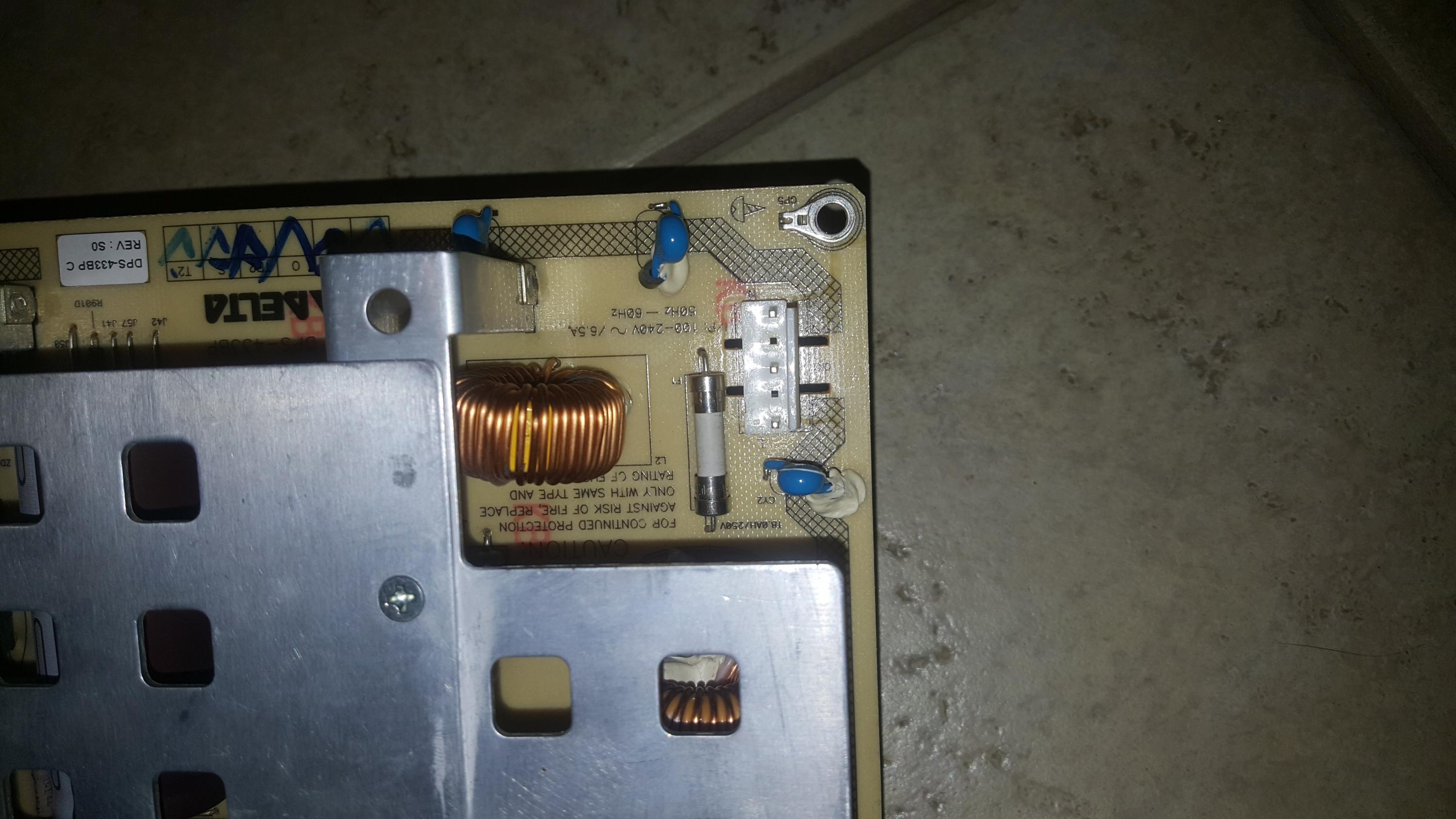

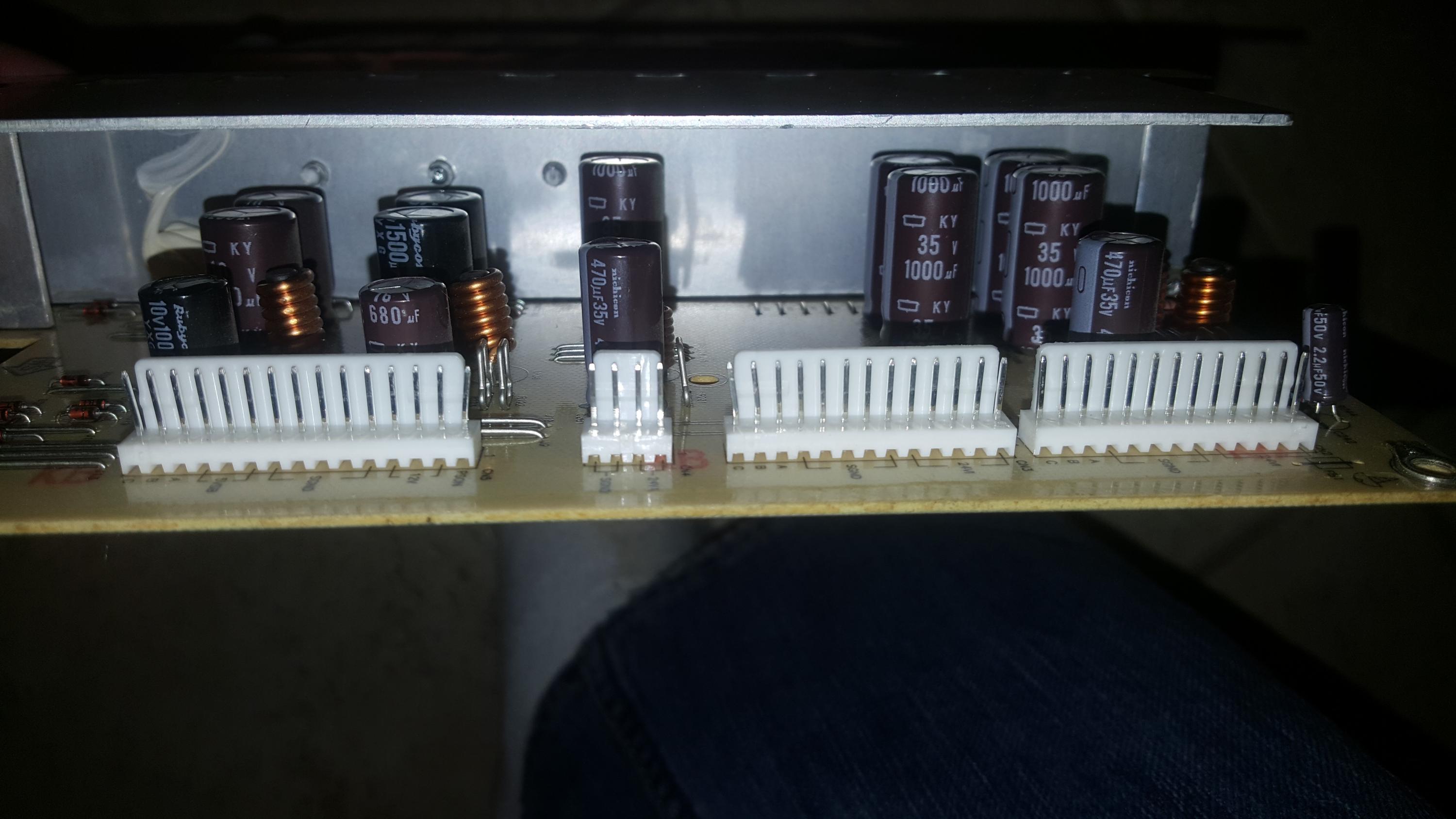

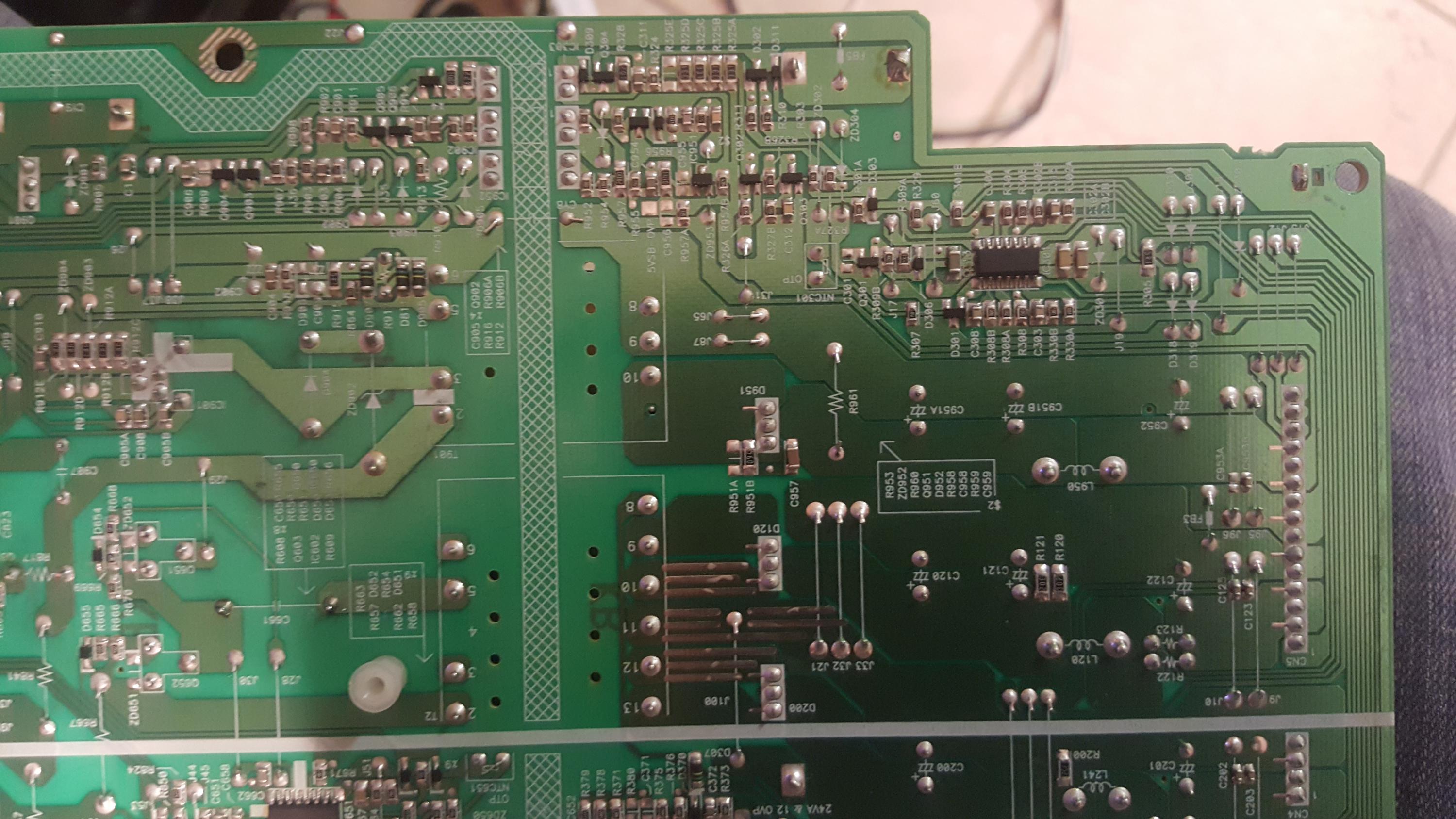

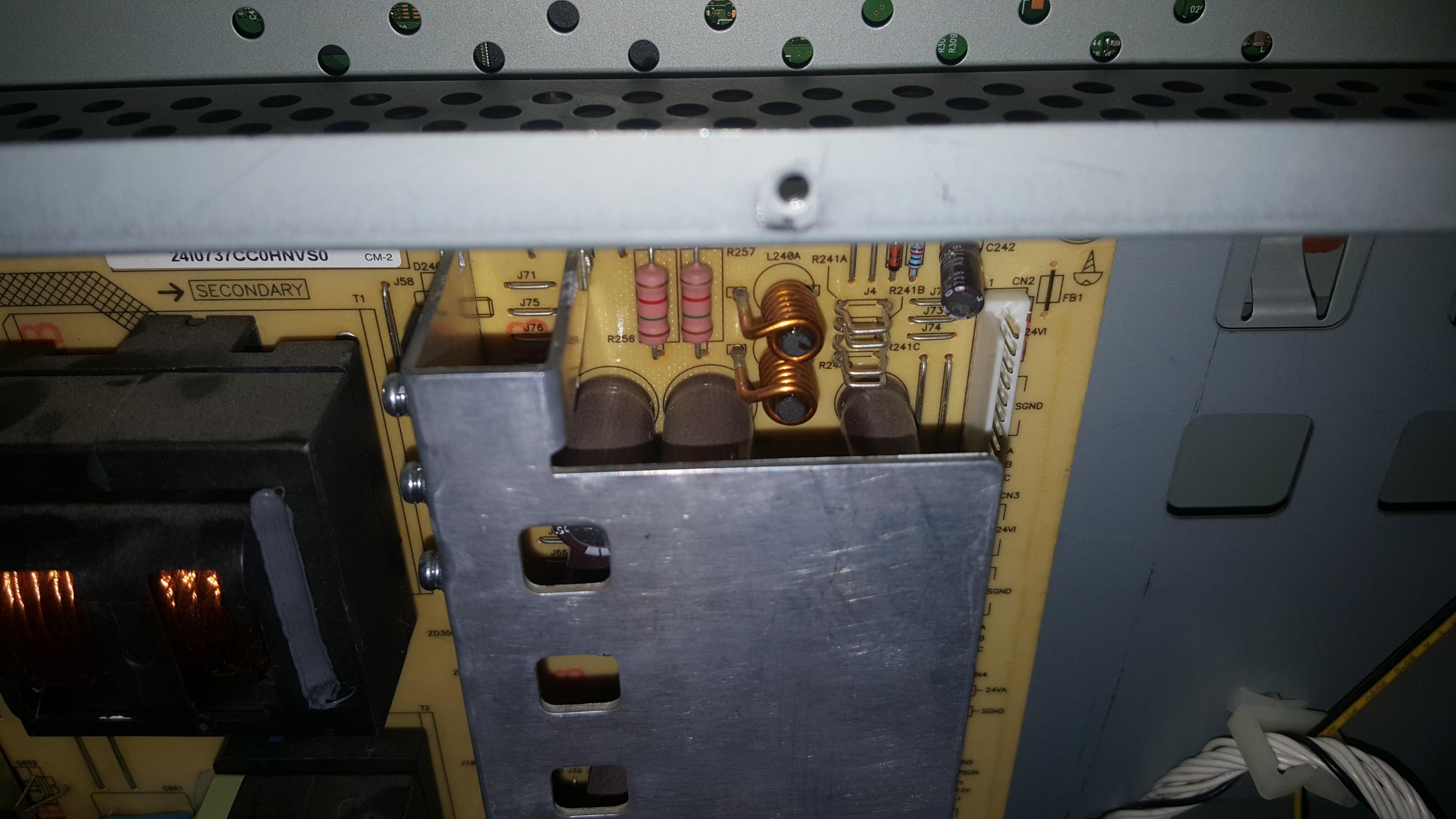

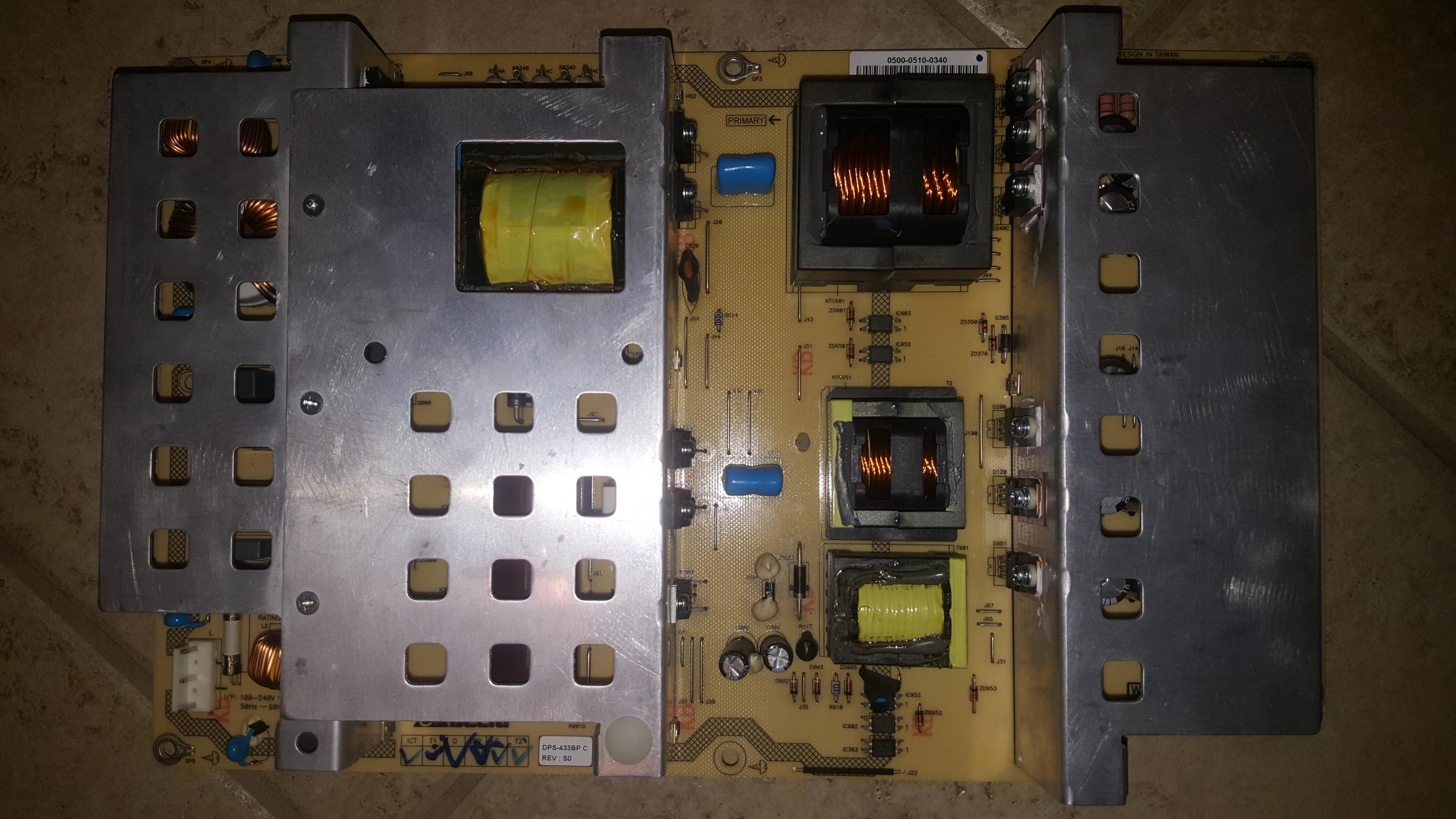

              So in the beginning the standby power supply was working and now it is dead, so disconnect the cable between the power supply and the main board to see if you will get the STBY Voltage back.
              We also need clear straight shot pictures of the whole power supply board top and the bottom side.
              • Naturallyk2
                • Nov 2014
                • 64

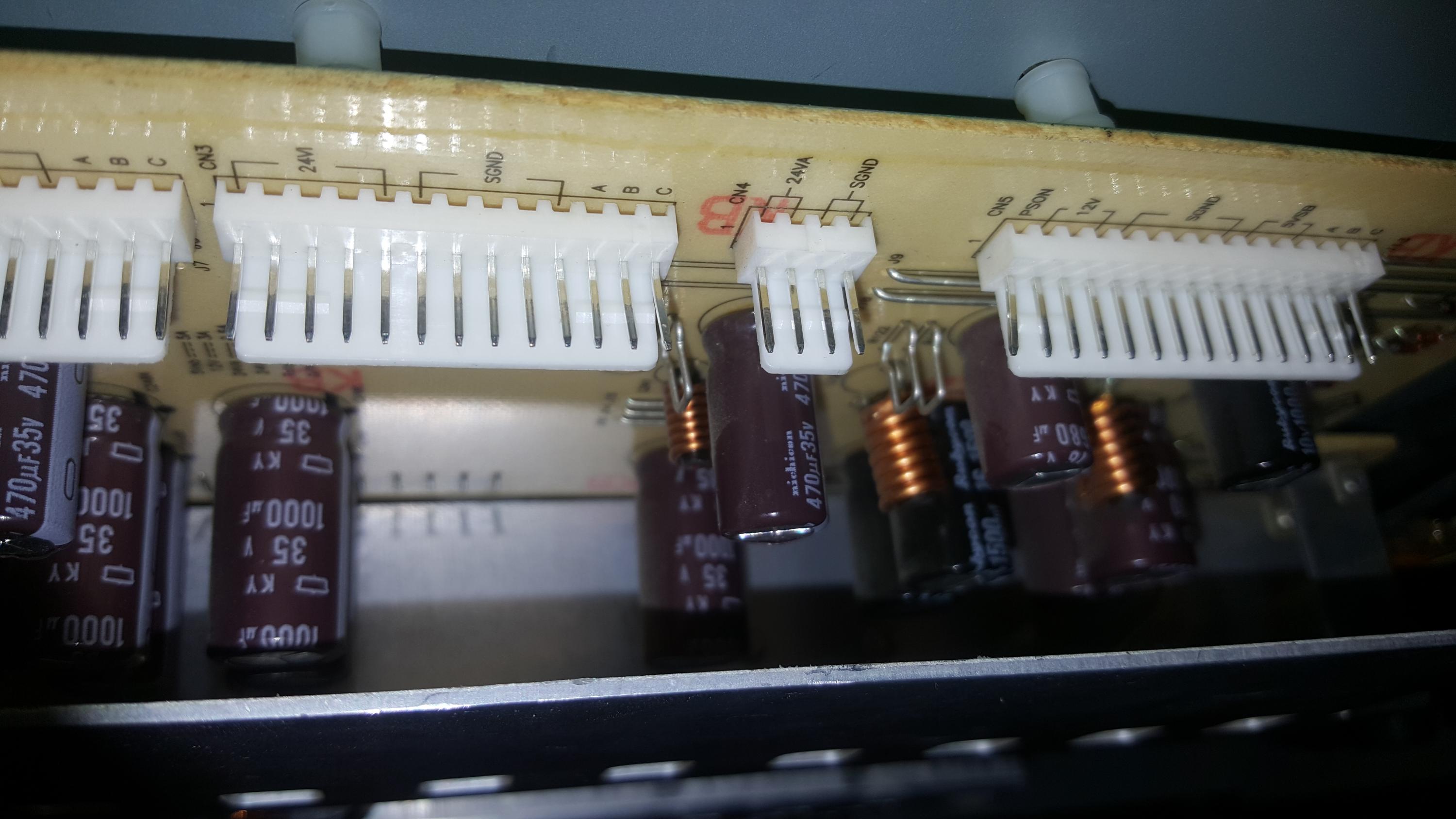

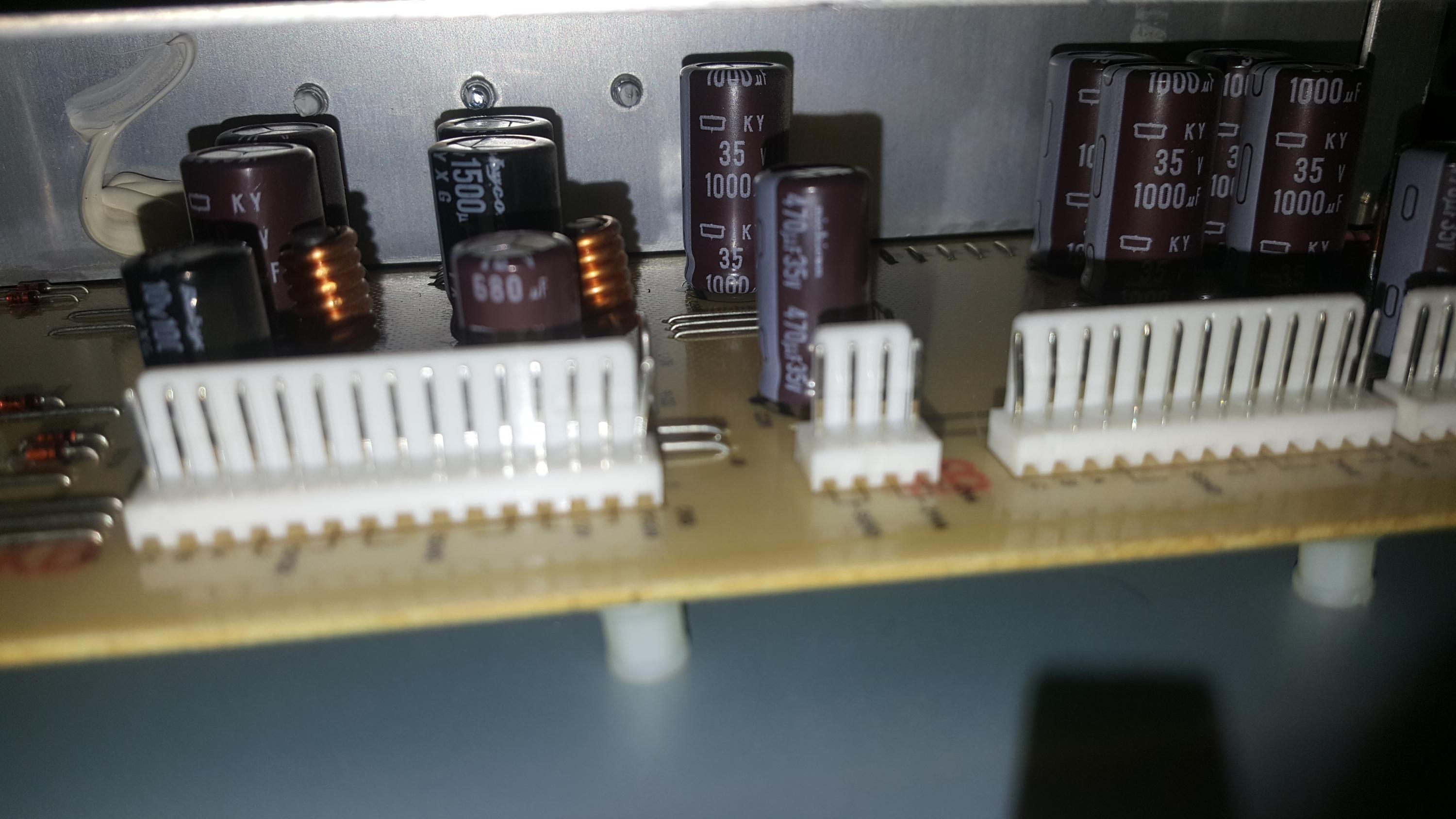

                Re: Vizio VO47L-FHDTV10A turns on and then off (3 seconds)
                After disconnecting main board from PS, the voltages still read 0v on Standby. Here are the pictures as requested. Do you want me to remove the aluminum cover from the PS for better viewing?
                • Naturallyk2
                  • Nov 2014
                  • 64

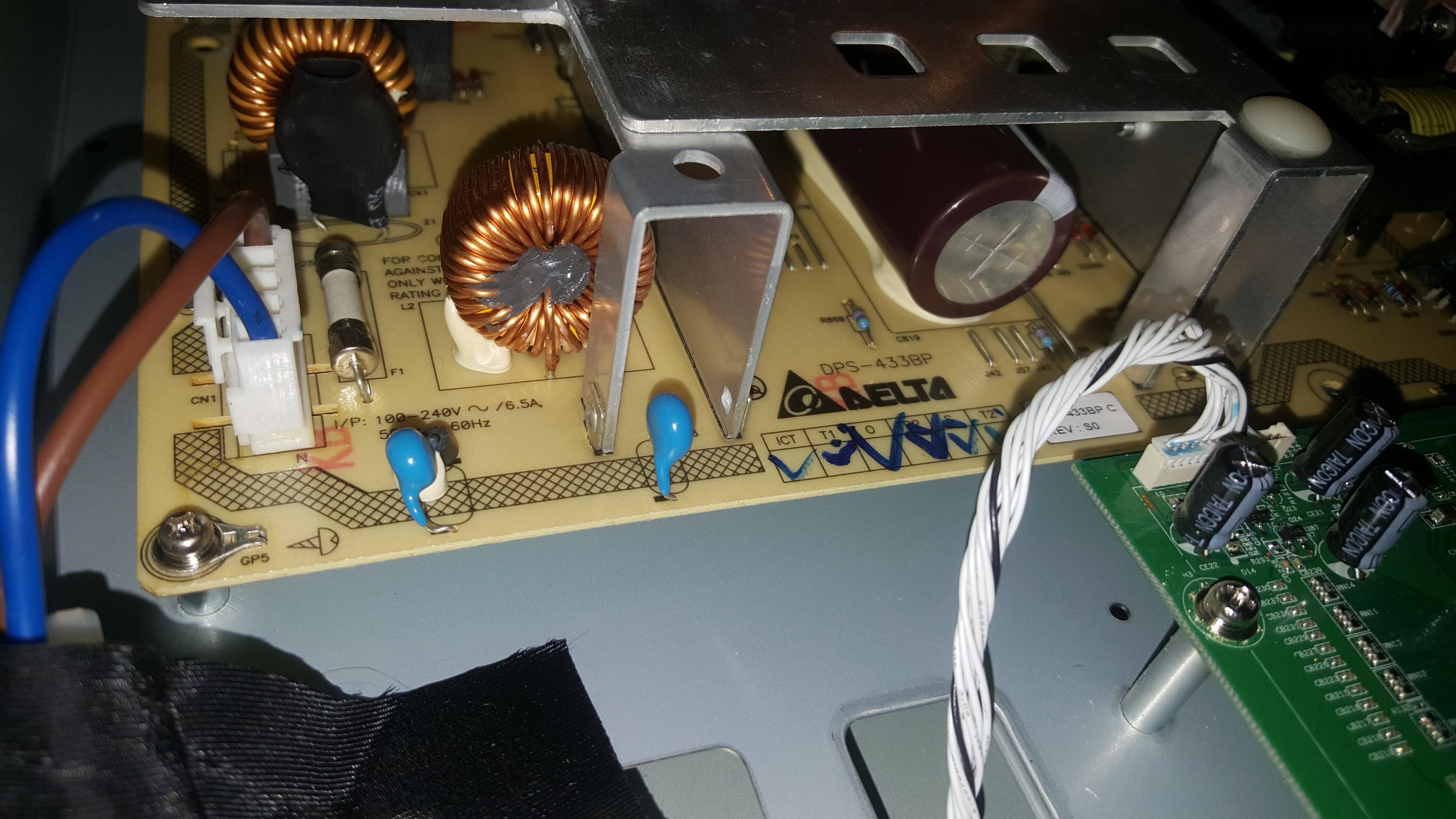

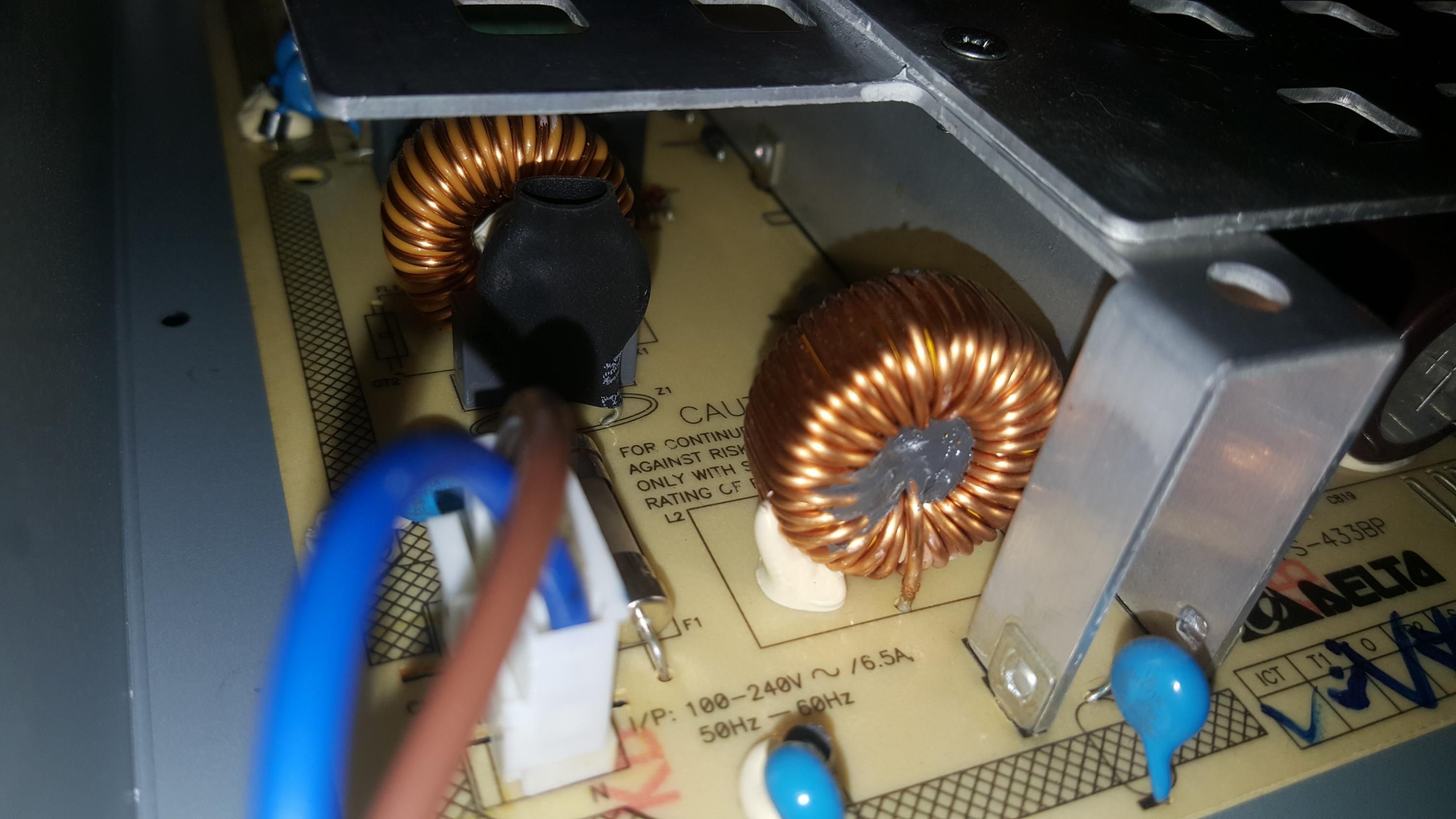

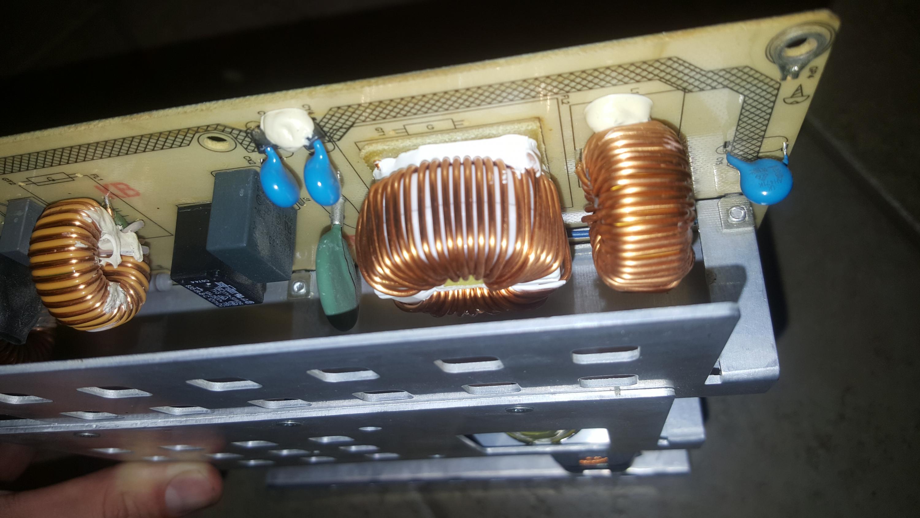

                  I noticed something in the photos I've uploaded. The the thermistor (NTC1) Large green looked cracked from its plastic covering. I removed it from the power board and found the resistance at room temperature to be 4 ohms. Any thoughts on this?
                    The printing on the thermistor reads as follows: SCK 0512 746
                        It's a 5 ohm, 12 Amp device.
                                    Btw, are you sure about the STBY pin and the 5Vstby pin? One is the same as PSON, and another is the 5V standby.
                                    Can you give me the pin name of the power supply connector that goes to the main board?
                                      Btw, I cannot read the P/N of the power supply board to get better pictures from shop jimmy.

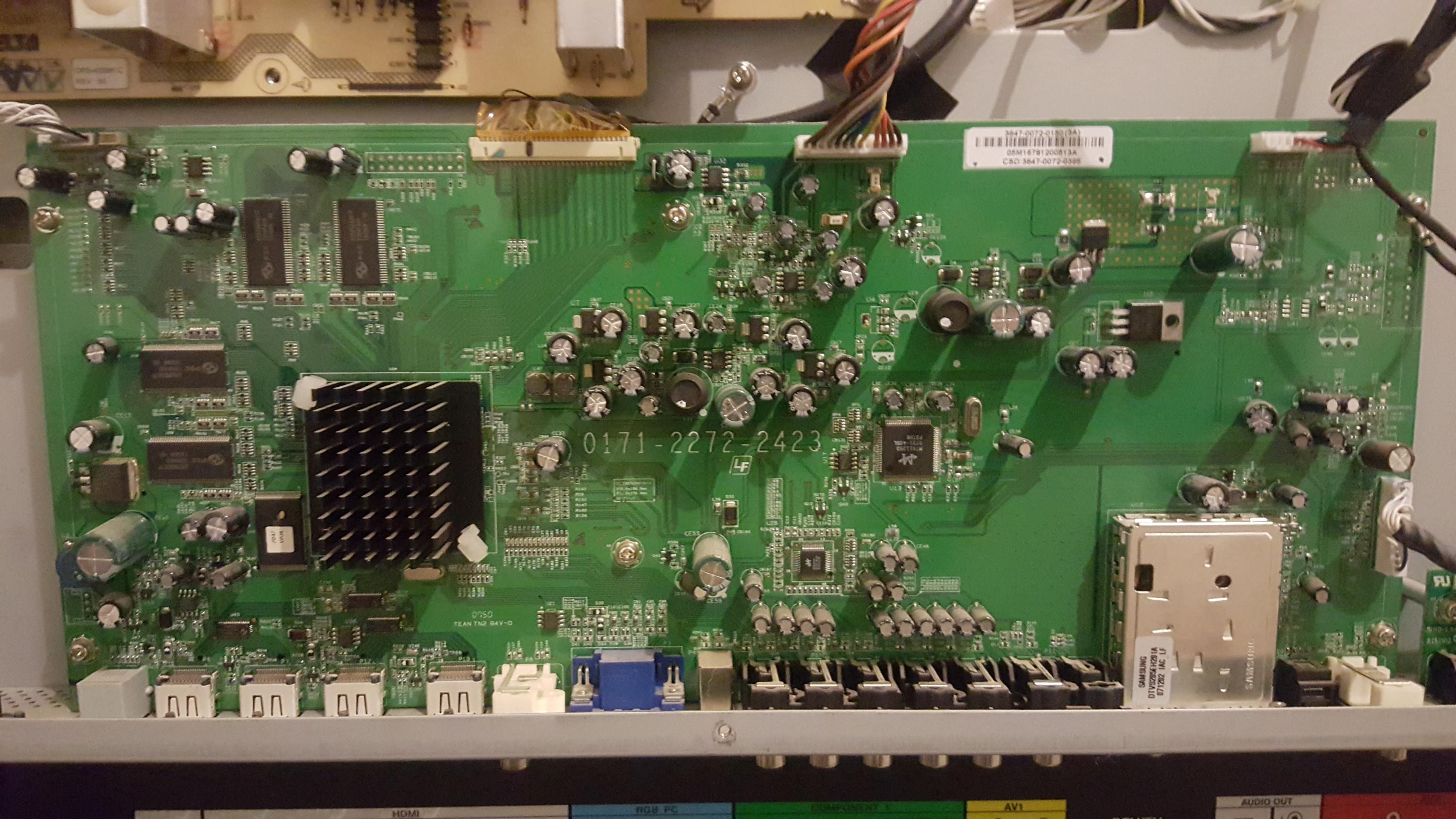

                                        Holy smokes just made a breakthrough. I guess redoing the soldering work on the ceramic cap on the main filter cap on the PS has now given me the ability to at least turn the TV on. The main cap reads 168 VDC off and 391 VDC on. Problem is, I can't turn the TV off once I press the power button. The backlights or picture does not come on on the TV either.
                                        BUDM, the P/N to the PS is DPS-433bp rev C . Will get you the reading off the main board now that I can actually turn the TV on.
